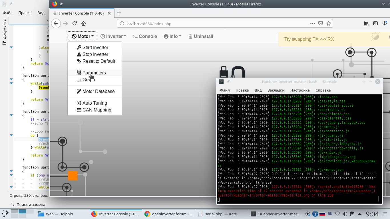

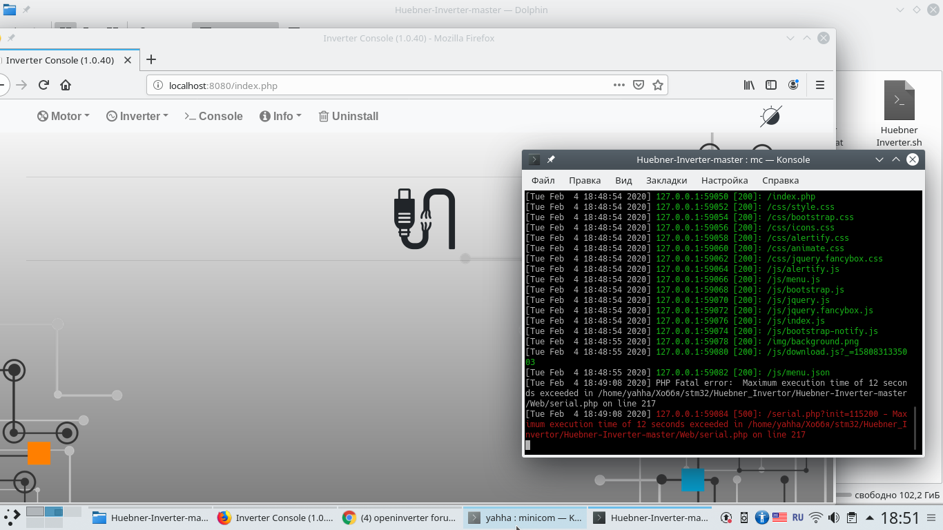

OK, I tried reflashing both bootloader and main code. I'm using the Windows GUI from STM, as you showed in your post, dima. It reported back that both hex files verified OK. But I got the same results. I even tried falling back to firmware version 4.10.R - same results.
When I run your batch file, here's where I end up:
And then it just sits there forever. I always end up using Ctrl-C to exit. One funny thing - in that batch file response you see the port status is 115200 and N81. But when I look at the port status in Device Manager, it says 115200 N82. Wonder why would they be different?PowerShell Version 5

Re: Serial Link not starting?
Wow this is a mystery ...can you re-download the newest build from github? The multiple COM should show manufacturer description now.
Maybe COM1 is the wrong com.

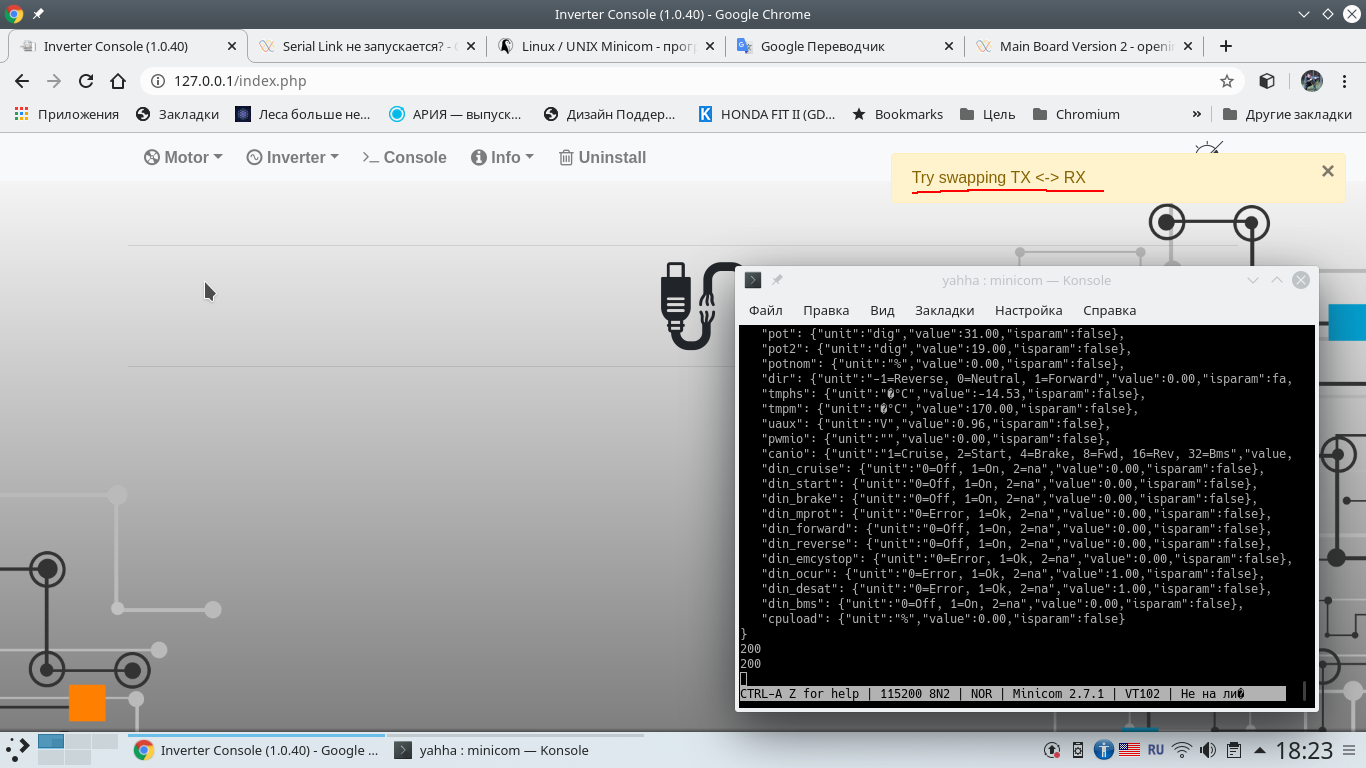

Ok, now I get itChazFisher wrote: ↑Fri Aug 23, 2019 2:31 am All right, here we go. STM32 Usart3-RX (Olimex J2-15) is connected to 9-pin serial pin 3 (RS232-TX). Usart3-RX (J2-14) is connected to 9-pin serial pin 2 (RS232-TX). STM32 Vss (J2-25) is connected to 9-pin serial pin 5 (GND).
Basically RS232 outputs a positive voltage for "0" and a negative voltage for "1". You can see the negative voltage is clamped by the ESD diodes, the positive voltage is clamped by some other component to 6V. I hope nothing get damaged. If you still have a blink LED you should be alright.
So what you want is a TTL level (3.3V) serial adapter. Or a wifi module.
