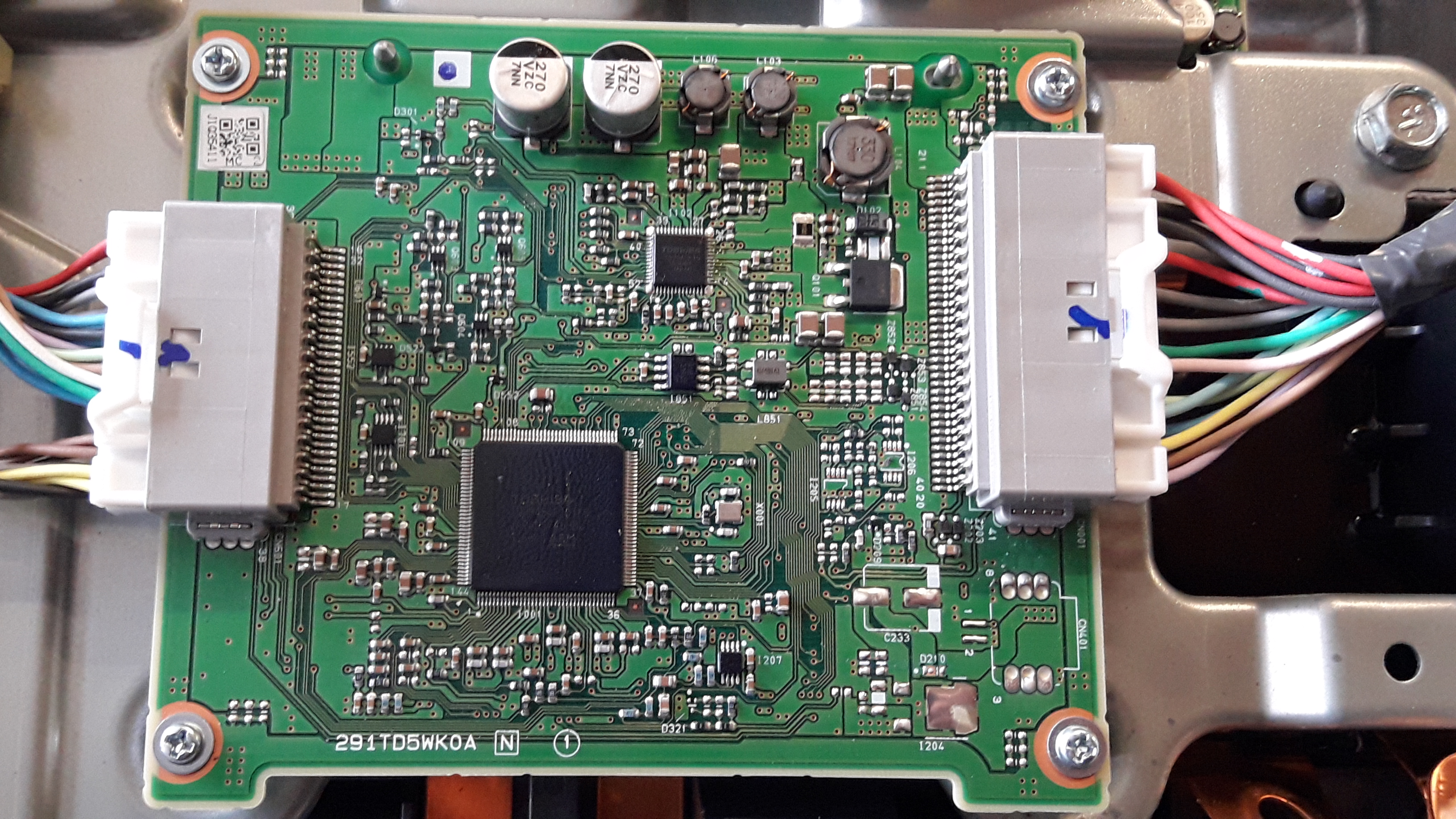

Edit, found a picture of the Nissan controller (credit boekel @ electric car forum) that was clear enough to see pin labeling.

From this image of the 32 pin connector I can see terminals 5, 12, 15, 21 are empty. It looks like positions 31 and 29 are empty as well. From what I'm seeing pin 13 is missing something and also not labeled in Kelju's schematic. Its a grey wire like pin 28, so I think that's 1 missing 5v.
I'll make sure 5v is where it should be on the adapter board, kind of sounds like this may have been an issue from your link / previous digging. Maybe one of the tiny fuses blew during testing?
Thinking of fuses, you want all the fuses on the adapter board removed, (from Kelju's design) correct?

Adapter board so far:
I chose to go 4 layer because of how tight this is and the original design reference images. Bottom layer is connected to the 4 mounting holes along with the plane ring around the outside on top like the Nissan board. Inductor footprints around the outside, will set them to dnp. Should make for a nice shield.
I did mostly 0805 sized components so they can be swapped if necessary. Also this still has some 0R resistors where they were in the original. Can drop these once we know things are working / connected correctly. Some unknowns still there.
Added solder jumper CAN resistors on the adapter board. 60ohm - 4.7uF to gnd - 60ohm with a solder jumper for each resistor to can lines. If this is the can end point it should help people use CAN correctly, easily, & filter some noise which will hopefully reduce struggles across the disciplines & forum support. Footprint for a can TVS right next to Nissan connector too.
I drew up the Nissan connectors but the dxf / footprint looks off from the first attempt board. I copied the same sketch / dxf, not sure how it happened or if it's an issue yet.
I also extended the pads to help with hand soldering.
I have the 2x05 old WiFi / comm header in currently. Not sure of use cases people might have for it. Planned to just leave this unpopulated.
I set the ESP32 boot delay R & C to the commonly recommended 10k resistor & 1uF. Not sure how / why 4k7 / .1uF was chosen but can easily switch back.
Also added the 499R inline to esp32 TX line from the datasheet "to filter 80mhz harmonics".
Broke out unused pins on a 2x05 footprint with labels.
I added notes in the schematic on what pin names were to help cross reference the mini main board and Kelju's schematic.
Added short traces with vias off the unterminated Nissan connector pins if we need to connect something along with a 4 pin header top right.
I have some cleanup to do before asking for others to check it. I'll hopefully post it in the next few days.
If anything jumps out to anyone please feel free to pick it apart with some ideas how to fix it.
I think I'm moving the contactor fets to the top right and moving stuff up top to the left to make room.

I would love for someone or a few people to look this over, done in KiCad 6. I think I'm done besides cleaning up part numbers, checking the dip switch footprint, rotations, gerbers, etc. I feel like I can't see straight at this point.
I added an 8 pos. dip switch. Could potentially have all 8 on one analog pin but it starts to get tight. Need to discuss implementing this, if its on the mini mainboard or adapter boards, and implementing it elsewhere if it makes sense to keep it. Thinking is the dip switch can go away once addressing is defined, or half could go away to leave 4 option settings if it helps, or switch to solder jumpers.
To make the R-2R thing work with JLC inventory its 3 components instead of the 1 R-2R for 4 positions, so 6 components + dip switch, 2 analog pins. There's an unused position on one of the resistor arrays, I shorted across the resistor to make routing cleaner and easier, I know this will likely throw anyone looking for a loop. Blue circle and blue T shape. Schematic is ugly because its all squished on one page.
There's a separate 20k resistor (R11) like R1 below. Doing this,
The connector pokes through in a decent spot on the i3,
mini mainboard,
and this Gen 3 leaf board.
Definitely need to verify the 32 & 40 pos. Nissan connector footprints too.
Please critique, ask why did you... poke fun, whatever. A bunch of other info in the few previous posts too.
