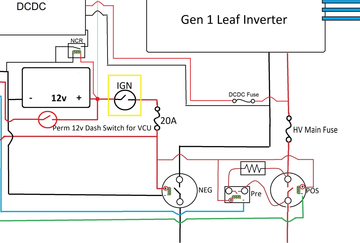

I have had similar issues in the past with mine. When DCDC is already active, I have found the precharge never completed as the DCDC takes all the juice so the inverter never reaches HV preset. In this situation, I never blew the resistors. I did blow them when I had the DCDC polarity the wrong way around. 2 seconds after I closed the contactors, the PCR went pop. Once I fixed the human error, all good.
Here is my setup from when I got things set up first for ref. I would check that all your Leaf PDM wiring follows the layout Are you connecting this with the service disconnect out? That should be the last thing you put in place. I cant see why it is going 'live' at the point you are doing up the final HV fixings and the PCR is going pop. Something very wrong there. Are you using Damiens Leaf VCU? When it comes to timing as you mentioned, timing should only come into place with the settings you have in the VCU (Damiens or Johannes') and you trigger the Neg and Precharge contactors followed by the Pos main after you reach HV preset
