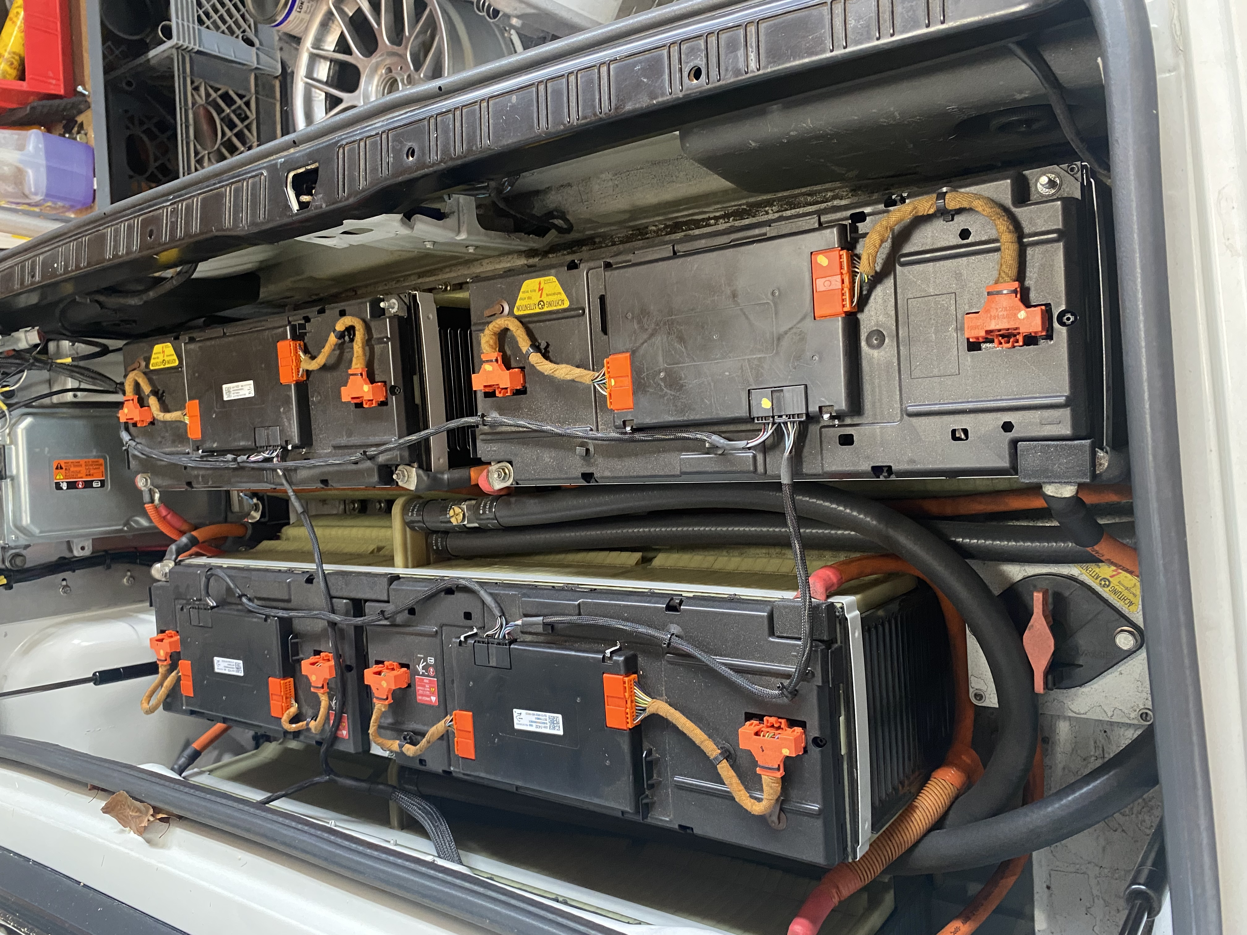

For the last 3 years Ive been running 2 full Chevy Volt packs with each module in parallel. In that time I've only taken the pack below 50% charge a handful of times. Since I have the car apart to redo the cooling system, I've been on the fence about pulling some of the modules out to drop some weight off the car and get some usable trunk space back. Im not sure whether the reduction in weight and will be negated by reduced current capability from a performance standpoint. Curious to hear others thoughts.
The options Im looking at are..
1: Just leave well enough alone.
2: Leave the 2 med sized modules up front, and keep one large one in the trunk to bring max charge to 420v.
3:Pull out one full pack and leave the other as standard 400v.
The primary upside is that I’d get this trunk space back.

Re: Battery opinions while I have the car apart?
Alternatively, given the Chevy volt modules’ tech is circa 10+ years old, are there other options on the market that fulfil the range / weight / price / form factor / amperage discharge criteria, without spending mega bucks?

What capacity do the two Volt packs have? And at what kind of voltage drop are you looking under WOT?
Two volt packs is 32kwh. I'd have to see if I took any notes on voltage drop. its been a while since I paid attention.Golf_mkIII_E wrote: ↑Sun Feb 13, 2022 7:14 am What capacity do the two Volt packs have? And at what kind of voltage drop are you looking under WOT?

I know I am late to the party, but one of the reasons I steered clear of the Volt pack was because of the different sized cell modules (yes I know that's super dumb, please talk to my OCD side, I'll hold) anyway having two packs gives you at least two of the same size, so I would hodge podge something symmetrical and allow the car to dictate what fits where, so not so much range or performance based, as fitment and weight distribution maybe, just sharing my thoughts, that's al
