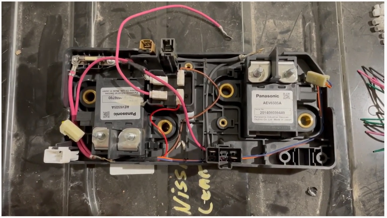

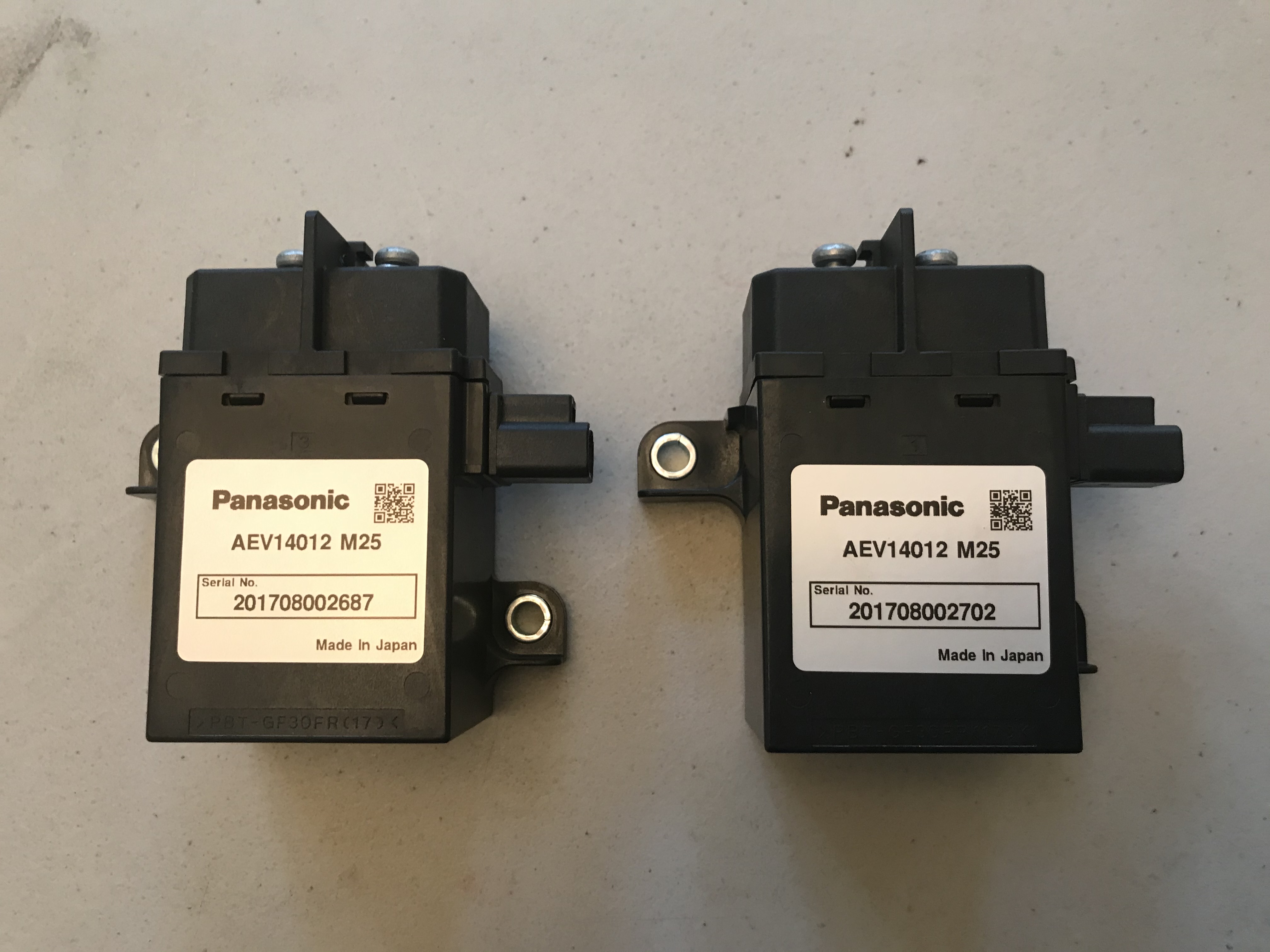

I recently tore into bits the BMW 530e Safety Box (ie pre charge circuit container) and found two Panasonic AEV14012 Relays/Contactors call them what you will rated at 400 volts (I'm fine with this spec) but only 120 amps, if I am reading the specs correctly on Digi-Key
I realize there is a big Info on BMW hybrid battery packs? thread and the answer may be buried in it somewheres, but this is more of a general learn me something question. How can this be? I know gals are pulling more current in their conversions than 120 amps through these contactors, upwards of twice as much (think pairing them up with the Lexus GS450h transmotor). So what prevents these from arcing or welding themselves shut? Please take it easy in your explanation as I am a total novice and any time I think I know something I get [ahem] a little shocked.

Re: Newb Asks: How can a 120 amp Contactor carry more current?

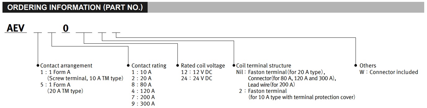

may be answering my own question here, but I think it's a good exercise and still hope to have someone else chime in
SPECIFICATION per Panasonic's Website
Item - - - - - Performance characteristics
Terminal Type Screw terminal
Coil Terminal Structure Connector
Rated Coil Voltage 12V DC
Contact Capacity 120 A
Protective Construction Capsule contact
Operating Function Single side stable
Operate (Set) Voltage (at20°C) (Initial) Max. 9 V DC
Release (Reset) voltage (at20°C) (Initial) Min. 1 V DC
Rated Operating Current [±10%] (at 20°C) 0.353 A
Coil Resistance (At 20oC) 34Ω
Rated Operating Power (at 20°C) 4.2 W
Max. applied voltage 16V DC
Contact Arrangement 1 Form A
Contact Material Copper alloy
Nominal Switching Capacity (Resistive Load) 120A 450V DC (Carry, 38mm2 wire)
Max. Carring Current 120A Continuity
225A 3 min.
400A 30 sec. (38mm2 wire)
Min. Switching Load (Resistive) 1A 12V DC (at 20°C)
Contact Voltage Drop (Initial) Max. 0.03 V (by voltage drop 6 V DC 20 A)
Insulation Resistance (Min. MΩ)(Initial) Min. 100 MΩ (At 500 V DC, Measured portion is the same as the case of dielectric strength.)
Dielectric Strength (Between Open Contacts) (Initial) 2,500 Vrms for 1min. (detection current: 10mA.)
Dielectric Strength (Between Contacts and Coil) (Initial) 2,500 Vrms for 1min. (detection current: 10mA.)
Operate (Set) Time
(At Rated Coil Voltage) (At 20oC) (Initial) Max. 50 ms (without bounce)
Release (Reset) Time
(at Rated Coil Voltage) (at 20°C) (Initial) Max. 30 ms (with no coil protective elements)
Shock Resistance: Functional For ON: Min. 196 m/s2 (half-sine shock pulse: 11 ms, detection time: 10 µs)
For OFF: Min. 98 m/s2 (half-sine shock pulse: 11 ms, detection time: 10 µs)
Shock Resistance: Destructive Min. 490 m/s2 (half-sine shock pulse: 6 ms)
Vibration Resistance: Functional 10 to 200 Hz, 43 m/s2 (detection time: 10 µs)
Vibration Resistance: Destructive 10 to 200 Hz, 43 m/s2 (Time of vibration for each direction; X, Y, Z direction: 4 hours)
Expected Life: Mechanical Life Min. 2 x 105
Expected Life: Electrical Life (Resistive) 30A 450V DC, Min. 1,000 operations
Expected Life: Switch-Off Life [Forward direction]:
1,200 A 300 V DC, Min. 1 cycle
120 A 450 V DC, Min. 50 operations
[Reverse direction]: -120 A 200 V DC, Min. 50 operations
Expected Life: Inrush Current (Capacitor) 120 A 20 V DC, Min. 70,000 operations
Conditions Ambient temperature: –40 to +80°C
Humidity: 5 to 85% R.H. (Avoid icing when using at temperatures lower than 0°C.)
Weight (Typ.) Approx. 400 g
Inner Carton (Pieces) 1
Outer Carton (Pieces) 20
Usable Voltage Range 10 V DC to 16 V DC

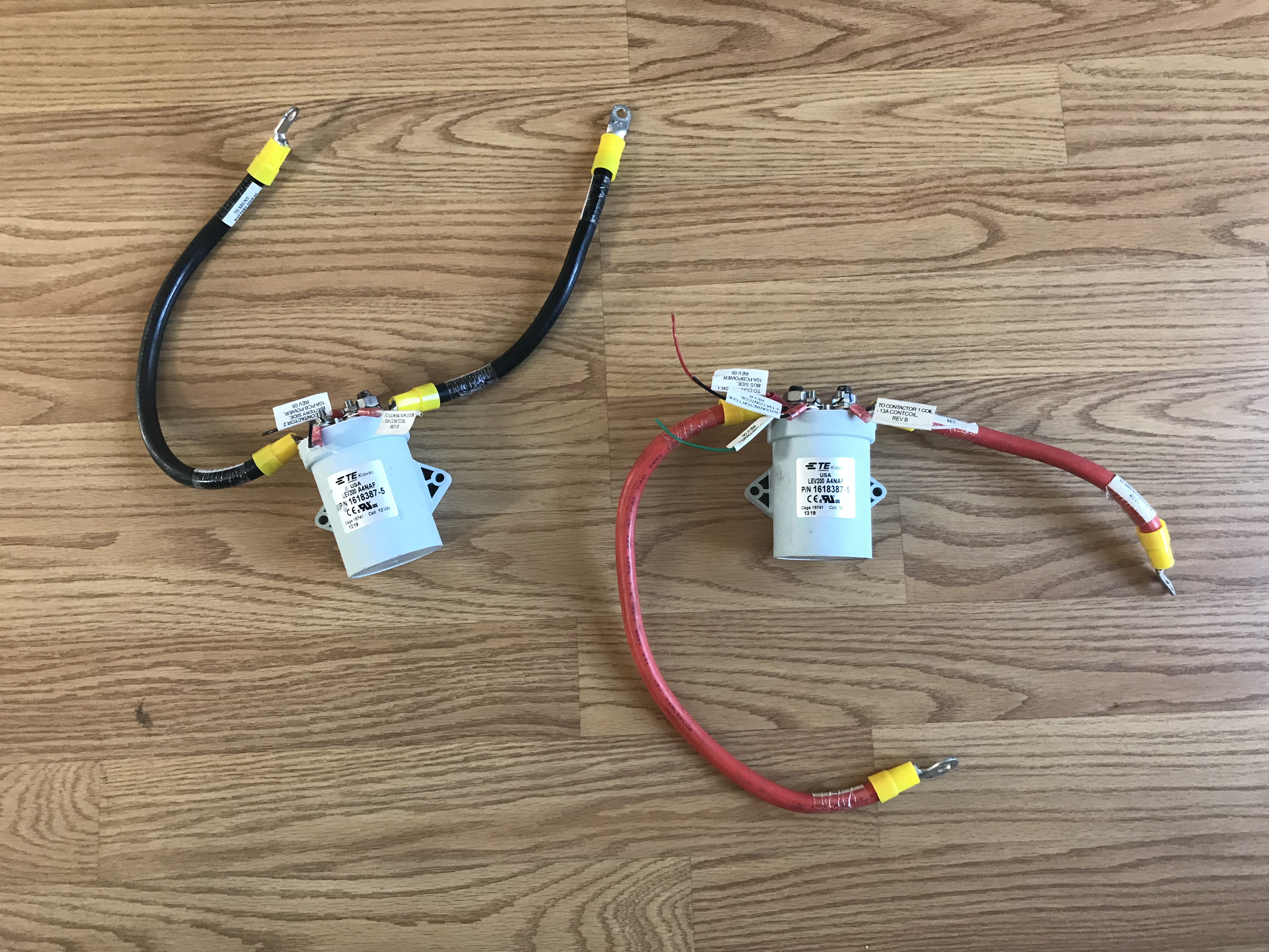

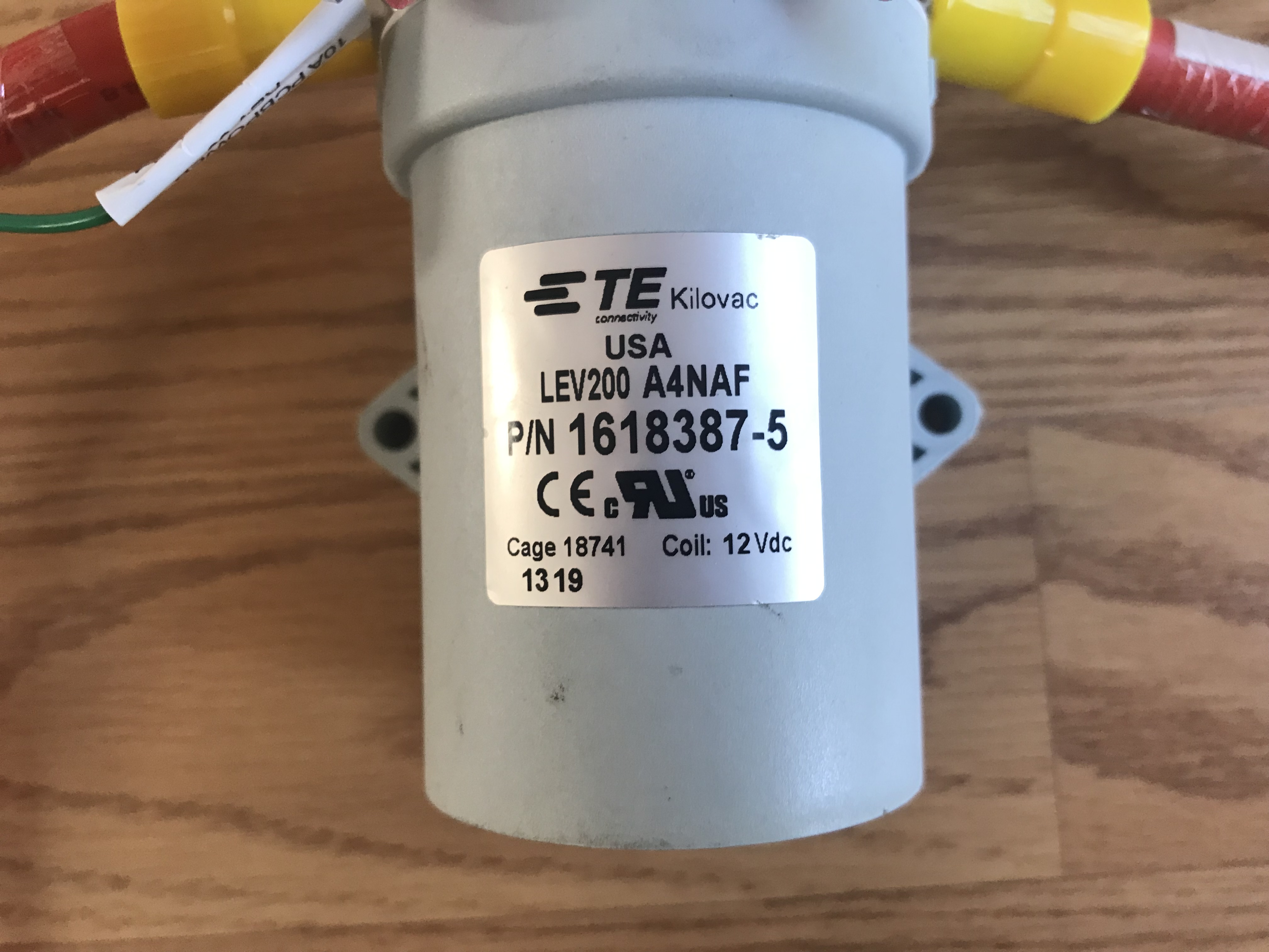

thank you, I just picked these LEV200 A4NAF part # 1618387-5 up on eBay, $30 bones each I could not pass that up, I know nothing about contactors, aside from the fact that Kilovac ones are good, welcome any thoughts
LEV200 = 500+ Amp
12-900VDC Contactor

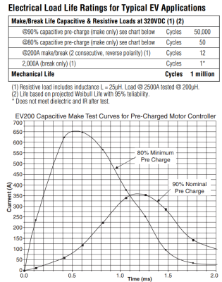

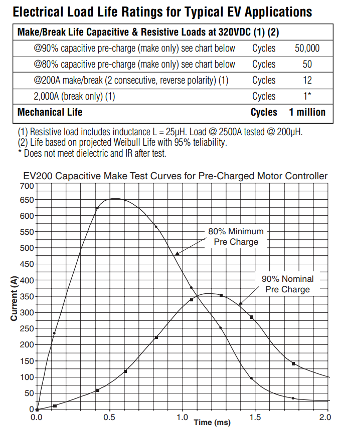

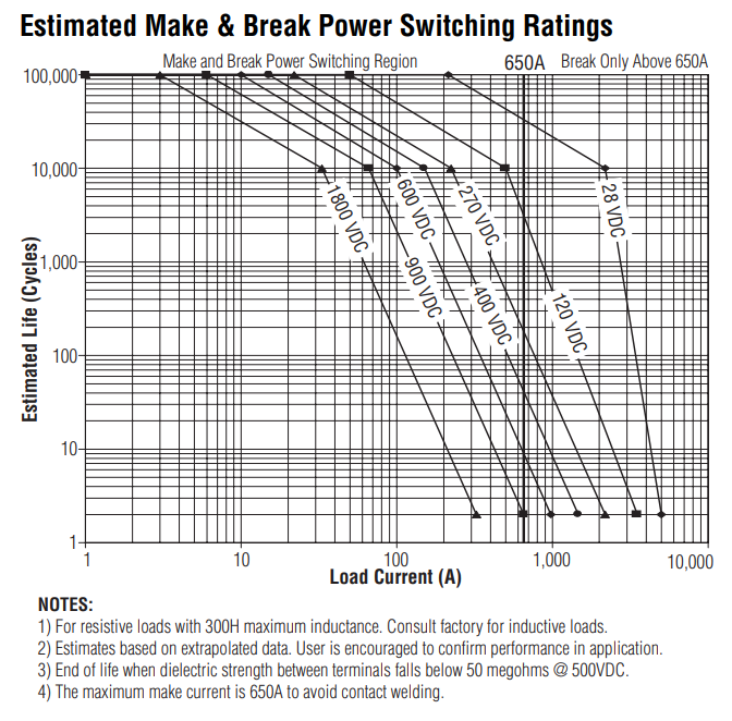

I posted about this a bit on the DIY EC forums.
Because you can buy EV200 contactors from batteryhookup.com for $12.50 (Christmas sale), I was figuring that was so damned cheap I'd just use them for almost everything I'd need switched rather than go with some elegant solution. Some people were pooh poohing using a physical contactor rather than a solid state relay, and I asked what I should buy instead that's even in the same price ballpark, but got silence.
Here's the charts...
They're spec'd for 500A continuous, but 2000A interrupt ONCE.
A 4000w heater or A/C at 200v would be 20A, and would be off-the-chart 100,000+ cycles. Perhaps 300,000 or so. Getting pretty close to the mechanical life anyways (springs/levers wearing out around the same time as the pads).
Otherwise, the chart's there to make a decision on the lifecycle of the contacts.
