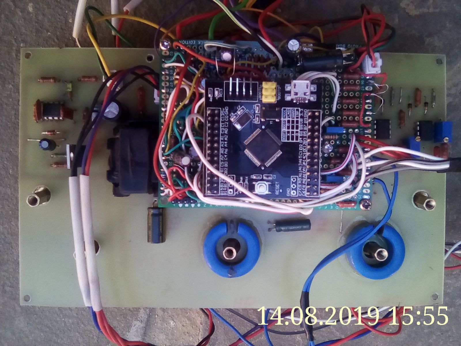

Good evening! I'm new to the forum soldered the inverter version 2, I want to use it on karting. The engine is mounted 1.5 kW capacity of 940 rpm, 50 Hz, rewound to the frequency of 100 Hz with a voltage of 60V, lithium titanate battery 40 amp hour 51вольт. There were several errors, one of them is associated with the encoder, gives an error but the engine is spinning, I do not know what the problem is, but I would like to know the conditions of error registration on the encoder, made it to 60 teeth, using a single-channel optical encoder. frequency limited to 80Hz on the engine. Transistors are 4pcs in parallel IRFP3077

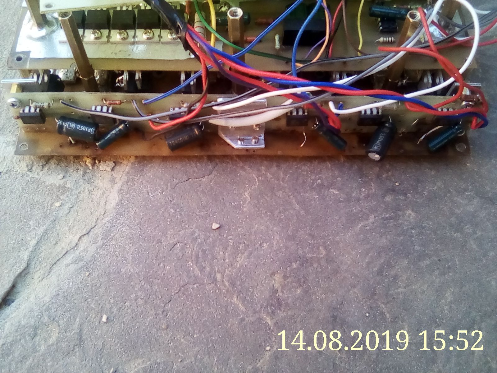

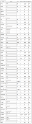

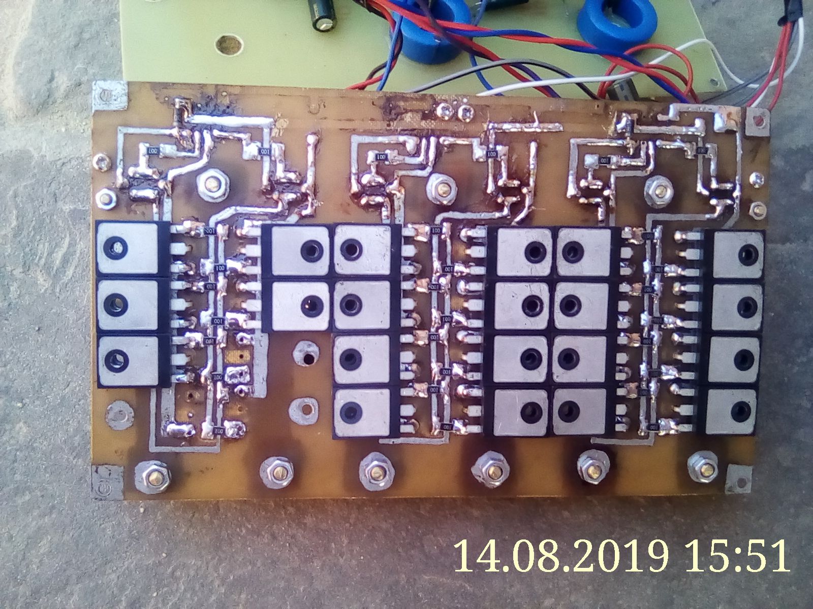

Can you post a picture of your power stage and your parameter settings (json-file from web interface)?

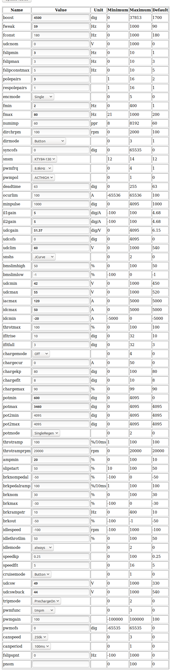

Good evening, I took a picture of the inverter and could not how to get the json file, made a screenshot of the settings from the web interface

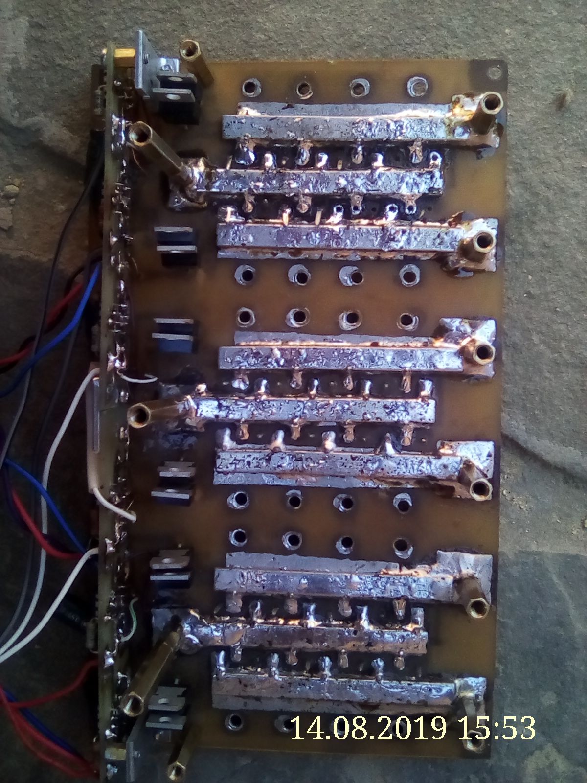

The photo shows 4 parallel transistor and repeaters tip41 and tip42 after hcpl3102, instead of a contactor I am using the electronic key 5 PCs transistors irf3808, they are included instead of contactor

Nice styling
But,

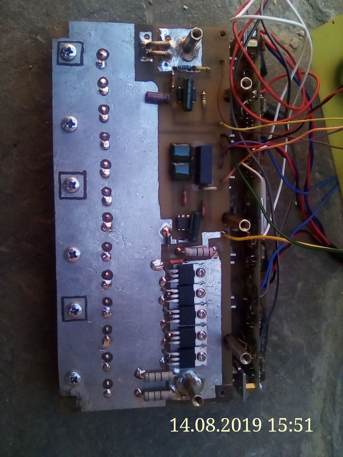

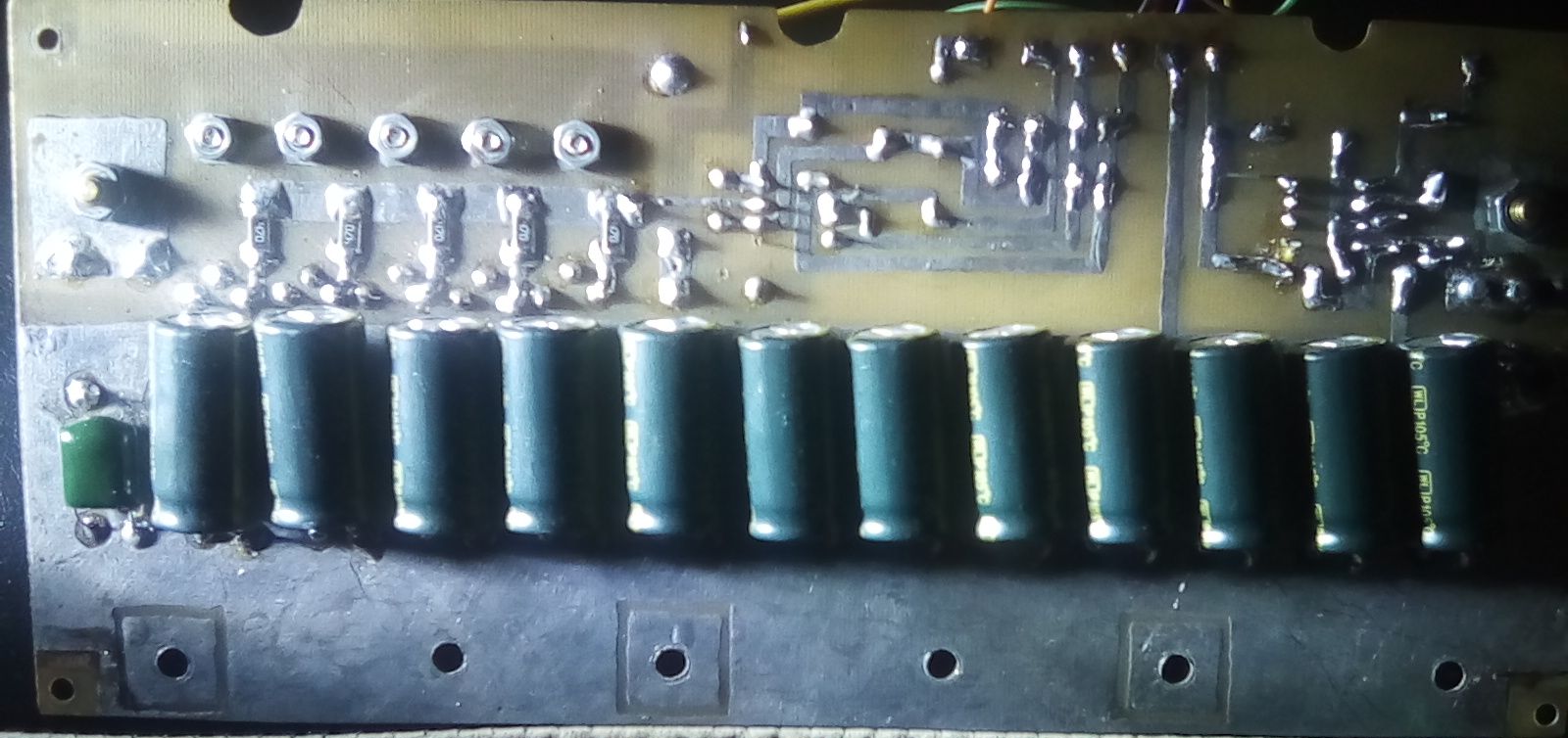

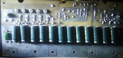

1st issue: I don't see a bus cap anywhere (maybe you just removed it for the photos)
2nd issue: heatsinking? (removed for photos also?)
3rd issue: you're running 75V Mosfets at 60V bus voltage. You want like 40% margin, i.e. 100V parts
Your MOSFETS are dying because of over-voltage, not over-current.

1. Capacitors on the other side of the board, shot in the evening so the photo is darkened
2. unscrewed it from the radiator to change the punched transistors, the radiator measuring 120mm by 200mm, height 8mm
3. I use 75V transistor MOS transistors, but I have a 51 volt bus voltage. Is the motor able to raise the voltage on the batteries more than 51 volts since the inverter is loaded with batteries? Does it open the contactor when releasing the accelerator pedal? Although I have field effect transistors instead of a contactor through which the voltage should flow back to the batteries.

This power bridge used to be designed for other inverter, so these boards still have extra elements

Ok, good.
51V is still sort of tight for 75V parts. The voltage will rise as soon as the motor goes into regen. The contactor is not opened during normal operation.
