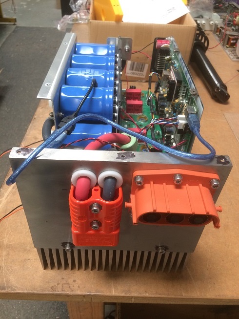

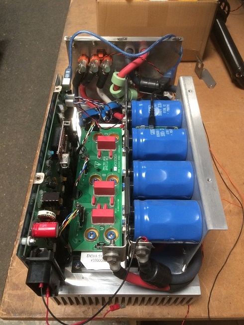

Just adding my inverter build project to the forum.
Hope you like the inverter set up, crammed as much as possible onto heatsink which was a challenge.
Uses Enova power stage, Damiens CombiV8 control/driver board and Johannes Olimex board and WiFi with programme.
Used industrial plugs and sockets as necessary to allow quick disconnect if I need to alter/repair off the car.
Next stage is to fit a cooling fan, metal cover and sort charging socket which will be part of the inverter as its the easiest point to connect to batteries as they are under the car !
Hope you like it :-) Peter

Yes very nice! I assume DC input is an Anderson connector but what is the three phase one?
Peter
Posts: 321
Been thanked: 9 times
Re: Inverter hardware build
Post by Peter »
Hi Johannes. The three phase is an industry standard plug/socket arrangement for EV use. Cost around £120 !

Peter wrote: Mon Jan 14, 2019 12:34 pm Hi Johannes. The three phase is an industry standard plug/socket arrangement for EV use. Cost around £120 !
https://uk.farnell.com/amphenol-industr ... dp/2580203
Must have come down in price. I just visited that link and they're £33 now.
