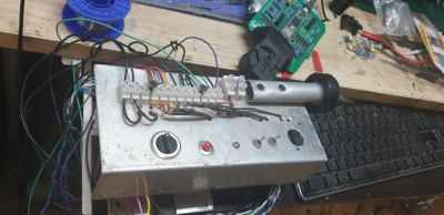

I have my car simulator setup now. Several switches and buttons with a thumb throttle.
I cant seem to get VCU to start generating 0x286 and 0x285 messages.
I can get into VCU state 4. I thought here it starts the drive process.
How is that particular process setup?

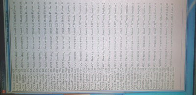

The problem is we are not generating a torque request as the Readpedal routine is not generating one.
From the de-bug screen I can see the it's failing the comparison test probably because there is a pot on only one input - ideally you have a dual pot pedal in which one value is 2x the other, (like a VW pedal)
Of course we can modify the code to remove this check for bench testing, but obviously I could not recommend to drive using only a single pot.
for testing modify the readPedal() function to something like this - I've not checked if this works - or even builds!

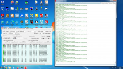

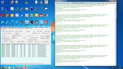

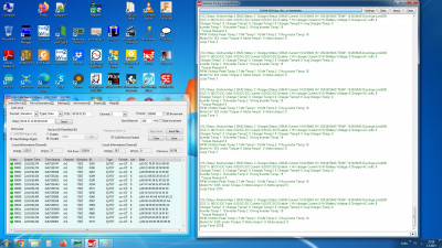

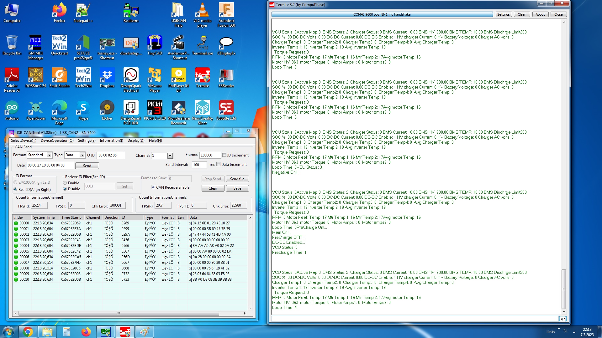

Well here are some of the screens for CAN as well as serial. You can clearly see that now as i have dual throttle connected correct telegrams will start. But i still dont get the electronic hum that i get using DUE code. Throttle press wont start anything.
Which pedal pin should be higher ADC1 or ADC0?
tnx

Still no torque request being generated by the pedal, until that happens inverter is not going to be enable and 0x287 B6 will stay 0x00
ADC1 is should be high and is used to calculate.
It might be worth commenting out the comparison check as I mentioned above it's something that can be tuned later.
