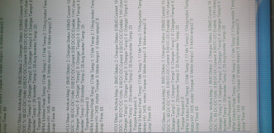

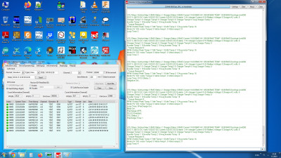

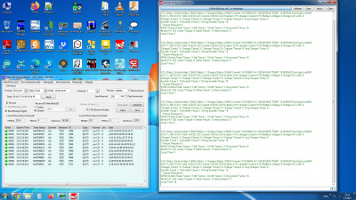

Well here are some of the screens for CAN as well as serial. You can clearly see that now as i have dual throttle connected correct telegrams will start. But i still dont get the electronic hum that i get using DUE code. Throttle press wont start anything.
Which pedal pin should be higher ADC1 or ADC0?
tnx

Still no torque request being generated by the pedal, until that happens inverter is not going to be enable and 0x287 B6 will stay 0x00
ADC1 is should be high and is used to calculate.
It might be worth commenting out the comparison check as I mentioned above it's something that can be tuned later.
