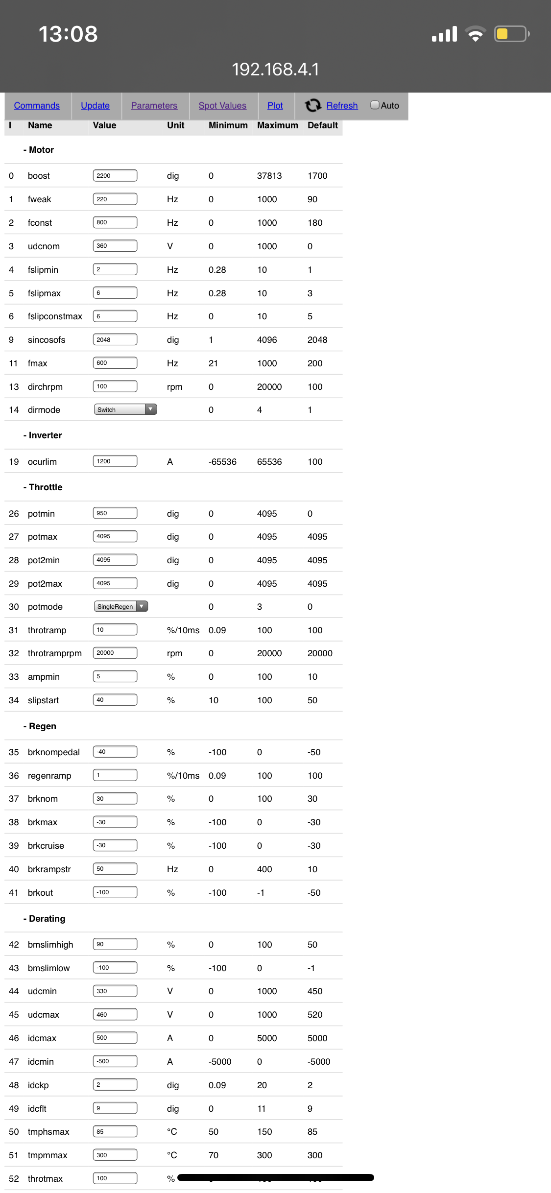

My dumb arse can’t figure out why...
I was able to successfully precharge twice, I then made a HV box with much thicker wires. And the first time I tried to precharge it blew up the resistor I had been using.
I then used a kettle and it still fails to close the main contactor. (But it boiled the water so it was working)
It just opens the precharge one after 5 seconds.
I’m using a Vauxhall ampere battery, at 362v at the moment.
And a Tesla SDU.
My parameters are in the screenshots I couldn’t get them off the inverter on my phone.
The error code is 500 Precharge stopped.

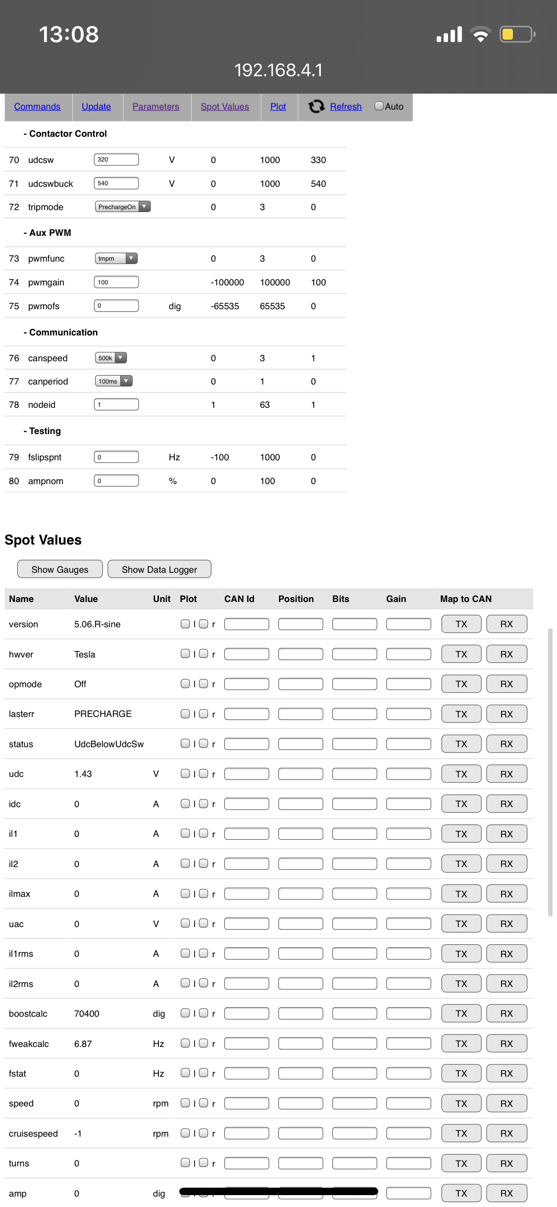

Update!!
I have since put a voltage tester either side of the main contactor, and the voltage doesn’t rise, (the delta stays 360 volts) but the water in the kettle sizzles a little so current is flowing?
So that’s why the precharge fails...
but why is the voltage not rising at all across the main contactor?

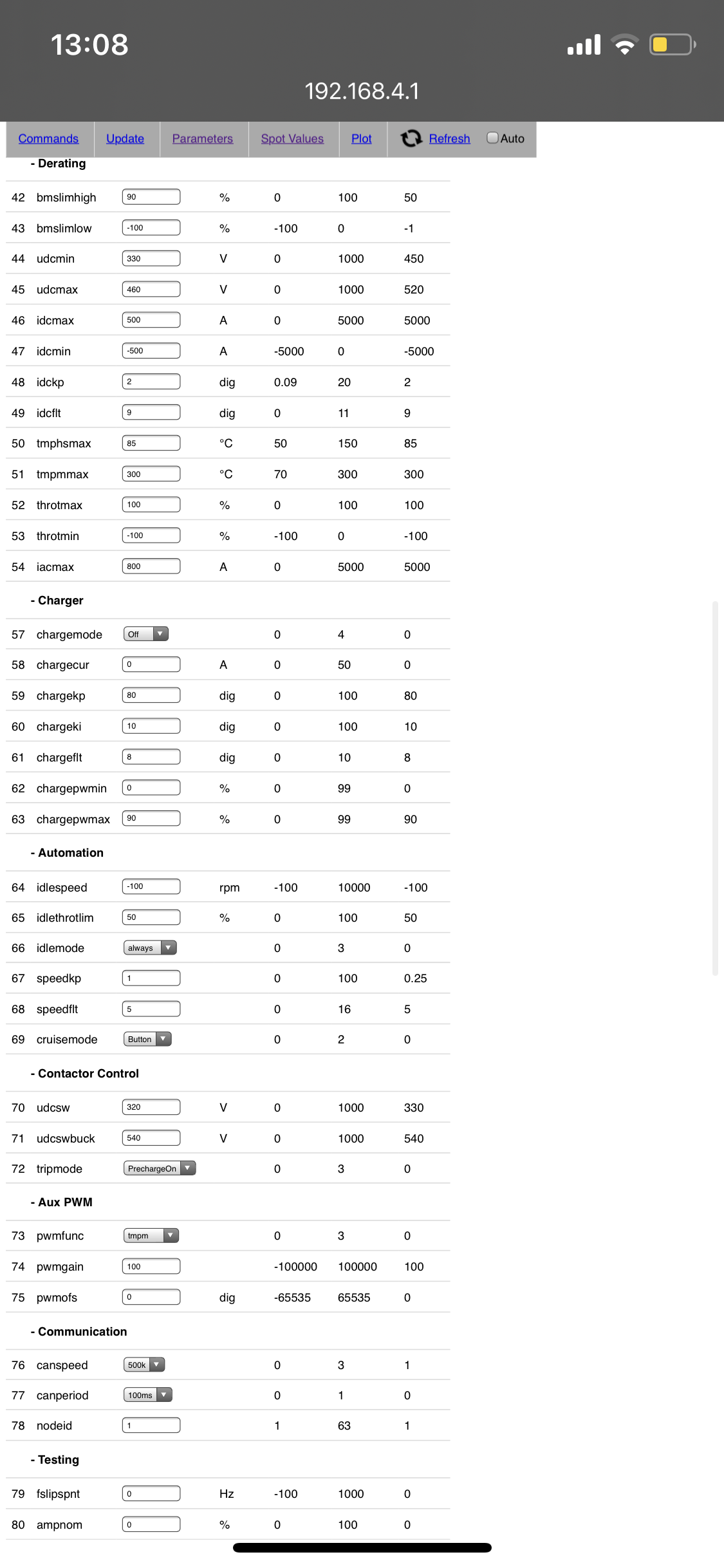

Precharged fine at 12v.... tapped the ‘start’ wire to 12v and the main contractor clicked... is that it? Is it okay? :O ??
Is it just my settings are wrong?
I changed udcnorm to 11 from 360
Udcsw to 10 from 330
Can I test the throttle a little with 12v or is that a bad idea?

Set udcnom to 0 and set Boost at 6000 or possibly more as 12v is a low voltage.

Setting udcnom to 0 stops the software from altering settings according to what the udcnom voltage is set to and what the battery pack is actually at. Therefore allowing Boost to be what you set manually without being changed by pack voltage. I was concerned because the boostcalc in your data showed 74000 which is too high by far.
ev340
Posts: 39
Joined: Sat Mar 20, 2021 12:06 pm
Re: Failing to precharge
Post by ev340 »
Peter wrote: Sat Jan 01, 2022 6:14 pm Setting udcnom to 0 stops the software from altering settings according to what the udcnom voltage is set to and what the battery pack is actually at. Therefore allowing Boost to be what you set manually without being changed by pack voltage. I was concerned because the boostcalc in your data showed 74000 which is too high by far.
Oh wow... that’s a lot...good spot thank you! I guess I’m going to have to really learn what all the parameters do and interact with eachother. Because I totally didn’t see that as an issue.
The database isn’t very in depth.
