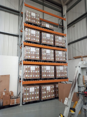

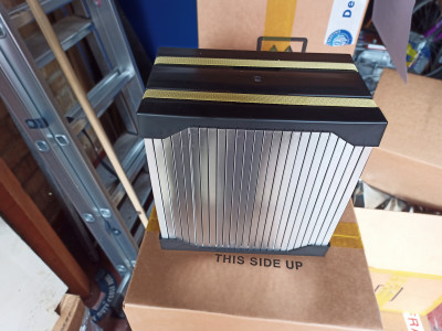

I've just got back from picking up some of these cells. http://www.ebaracus.com/sites/default/f ... asheet.pdf
The company I got them from has a surplus of unused, boxed cells, approximately 50,000.
How they came to me, two of these to a box: I checked the voltage on the cells in the one I opened - all 3.74 or 3.75 V per cell.
If any one is interested PM me and I'll give you the guy who's dealing with them's email address.
NB. I have nothing to do with the company, just passing on something that others may find useful.

Re: EIG C20 cells (UK)
I got 500 for a 36kWh 100S5P pack. They did still have some bus bars for joining the cells into packs, but it's a case of once they're gone they're gone I think. I took the last joining plate for the bottom of the packs and will have to get some more made up from it. They were making 10S5P modules for their project cars (I have a couple of photos of the modules in my project thread).

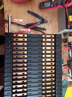

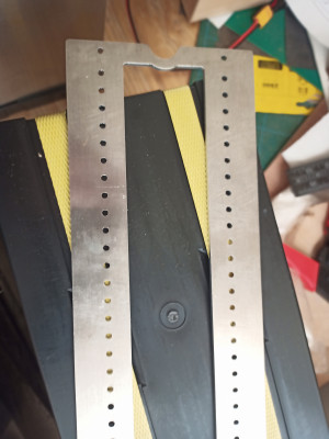

Can you make some closeups of your bus arrangement so we can see how the cells are connected?doobedoobedo wrote: ↑Wed Aug 07, 2019 10:42 pm I got 500 for a 36kWh 100S5P pack. They did still have some bus bars for joining the cells into packs, but it's a case of once they're gone they're gone I think. I took the last joining plate for the bottom of the packs and will have to get some more made up from it. They were making 10S5P modules for their project cars (I have a couple of photos of the modules in my project thread).
I mean are those threaded M5 holes or just normal 6mm bore etc...
tnx
Sure, I'm probably going to build up a pack tomorrow now I have my motor spinning.
They gave me the busbars and fasteners which I'm pretty sure are M3, I can reverse engineer the bus bars and put up CAD drawings if you need them, I need to get some for the ends anyway.

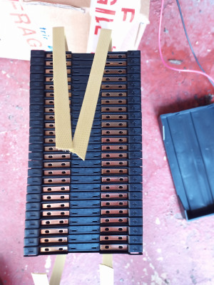

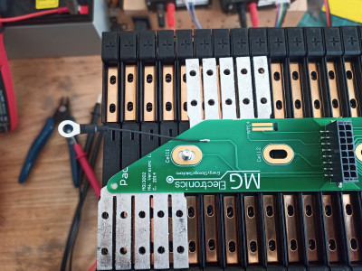

OK, didn't make up the pack, but took some more pictures of the hardware they gave me.
This was the last one of the bottom cell joiners they had, I need to get 9 more cut, happy to put up drawings once I've got all the measurements, all holes are low clearance for the M3 tapped holes in the bottom of each cell. The top of the cells, there is a channel either side at the top for 6mm rods to help compress the cells. Each contact has two connectors tapped M3. With one of their bus bars, I'll need to get the +ve/-ve ends cut myself. Again I'll put up drawings once I've got full measurements if people are interested. And with one of the BMS PCBs they threw in with mine.

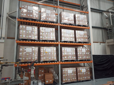

Just letting you all know that they need to get rid of their remaining ~40k cells in the next few weeks and are very open for negotiation.
I’m getting 1 or 2 thousand cells. My transport will also pass through NL, BEL, Ger, Poland and Baltics should anyone be on the way and need transport.

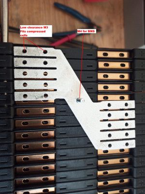

Does anyone have the bus bar drawings for these cells still? I'd be interested in 5p, 7p, 10p or such. Thank you!
doobedoobedo
- Posts: 264
- Location: UK
I've attached a FreeCAD file of the bus bars I have (supplied with the cells, so they're the ones the manufacturer was using). Reverse engineered with calipers to the best of my ability. The centre hole is tapped M4 for BMS attachment. They're 3mm aluminium. The cells have to be quite heavily compressed for them to fit.
Thank you.
So the terminal connectors on the cell side are not Copper then and are safe to put together with Aluminium?
Also do you feel the heavy compression could be an issue?
doobedoobedo
- Posts: 264
- Location: UK
The contacts on the cells are copper coloured - so probably copper. Do you think the Cu/Al interface will be a problem?
As for the compression - No I don't think this would be a problem, in fact it's a good thing. Cells like to be compressed in high current situations. I mentioned it because the bus bars have no chance of fitting without compression.
