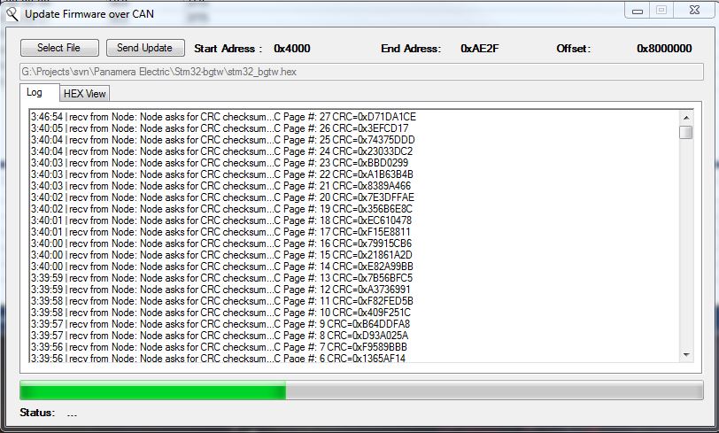

As per title!
Couldn't find anything available so took the bootloader from Johannes and modified it towards a CAN version.
Build a GUI and the rest is history.
The CAN Interface used is a profi one from PEAK Systems.
https://www.peak-system.com/PCAN-USB-FD.365.0.html?&L=1
Didn't optimize yet for performance or size.
Currently 1 msg per mS (8bytes).
+/-8K/sec.
Update:
Currently the size needed is 0x2000 (8K) so we need to modify the LD files.
I'm thinking on a solution for that.

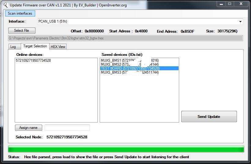

Ok made the tool stand-alone.
Node selection works.

That looks very nice! Would the GUI also run on Linux?

Yes; Later versions have that ID for exactly that purpose and the reset could be in the BMS firmware not in the bootloader.
The GUI can decide who to let go into user app and who not.
If you need todo multiple BMS boards i would do them one by one and keep others waiting. You can then release them all at once or one by one. I expect a small program so it won't take the world.
If you have Todo allot of boards i would broadcast the data and enable those devices who should write along. The ones who fail CRC could simply stop. This way I bet you don't over complicate and it will work. CRC never failed.

Include in step 1 6 bytes of chip unique Id.
Now on boot the GUI gives lots of chips. You can self compose list of who is what.
Insert wait loop for can msg if nothing boot user app.
If received 'W' with 6bytes equal Id rerun said loop.
If received 'AA' with 6bytea Id proceed.
Now on boot GUI can show all and if no choice is made it sends to all of them W with id.
Now user selects Id. That one receives AA. Now you have 2 choices keep others waiting..send W and their ID or don't do anything and they will boot user app.
Now Dave's case is solid and johu can control what to update and what not. In step 1 one byte is left. Could be used as device description. ...
