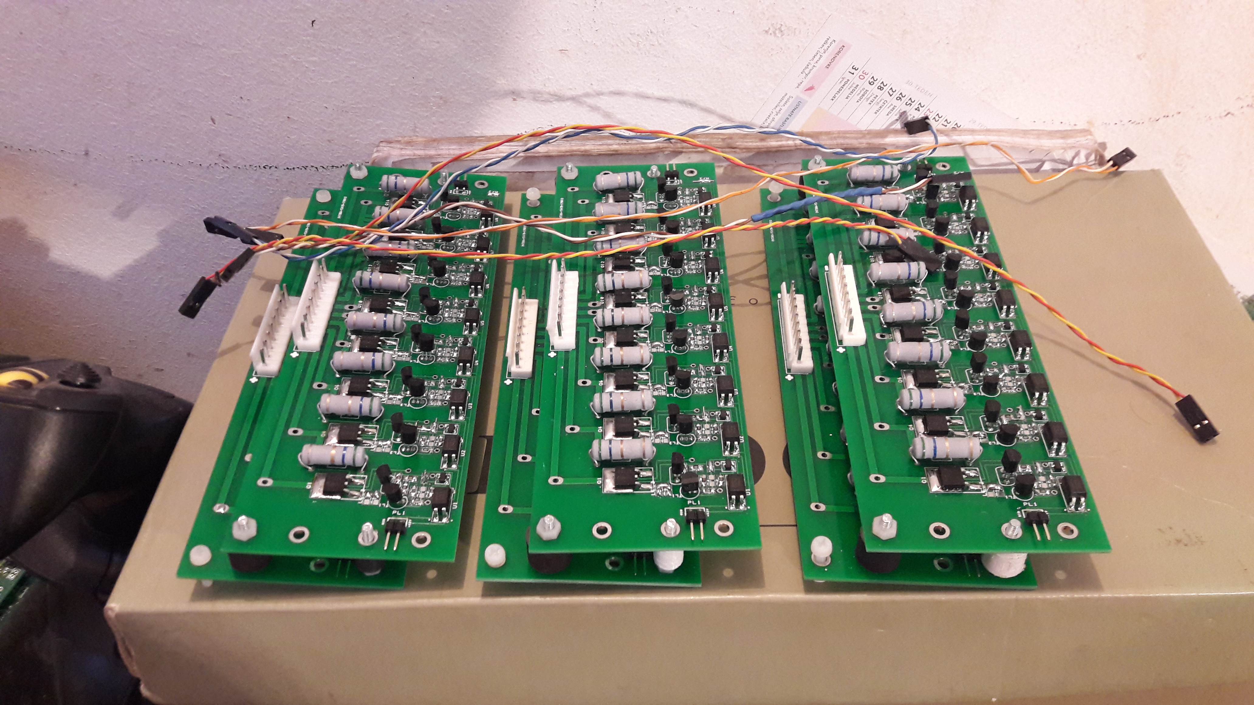

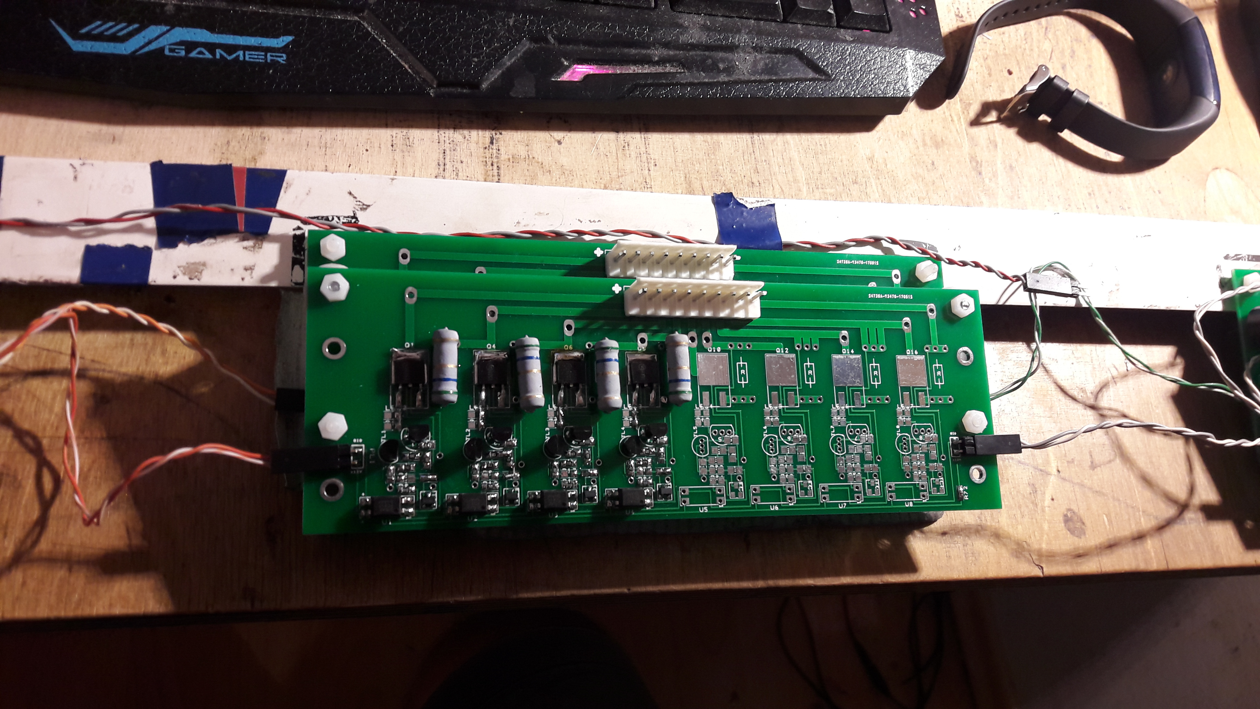

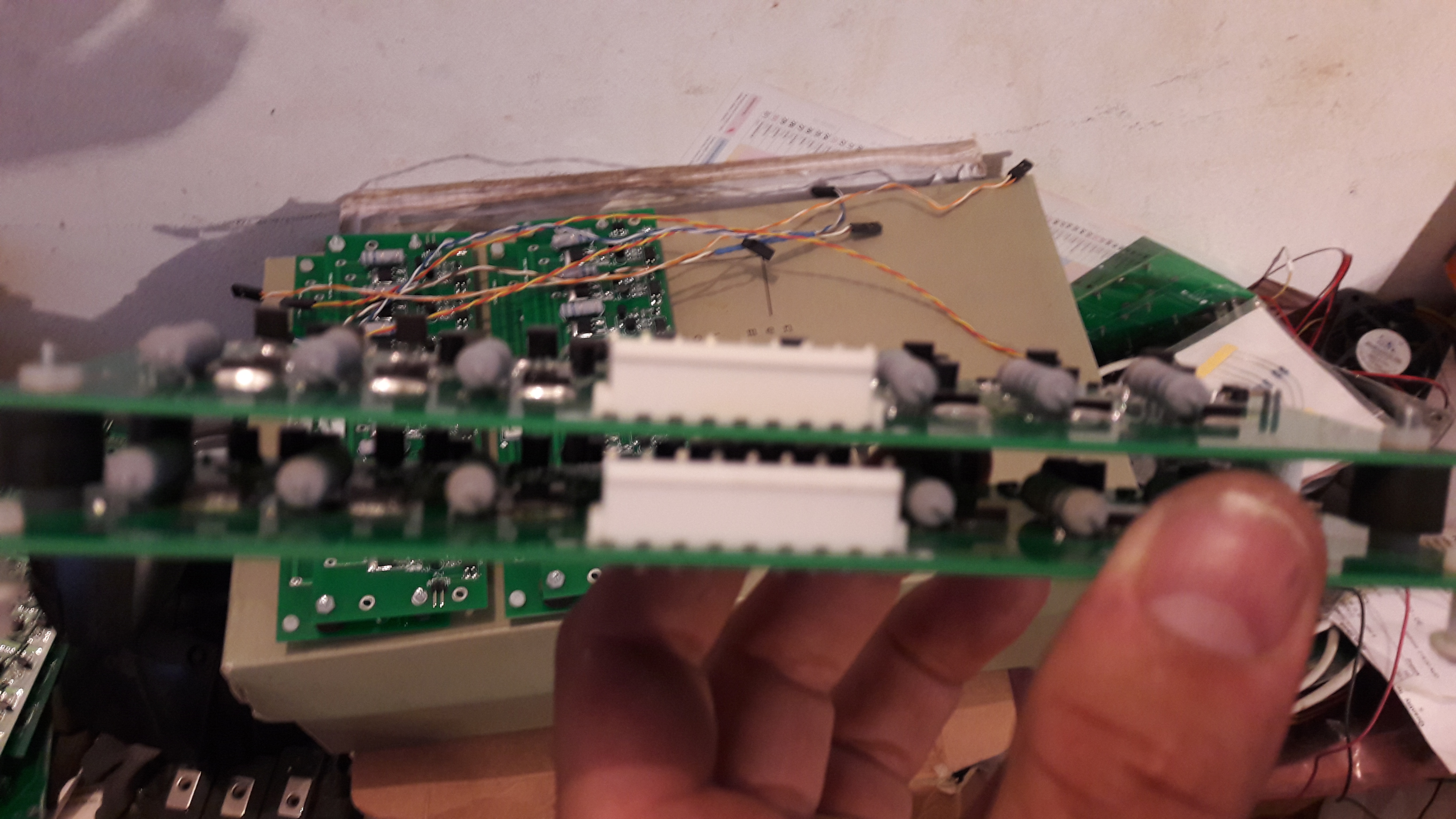

Here are 8S modules of this BMS. Each module is connected through opto to others and is active high. So if a cell passes 3V LED on my dash will lit and i will have to slow down and find an AC source...
Later on i experimentally connected top balancing connection to reduce the charging. Also i will have to redesign opto signalling to active low. It will be more failsafe that way.
