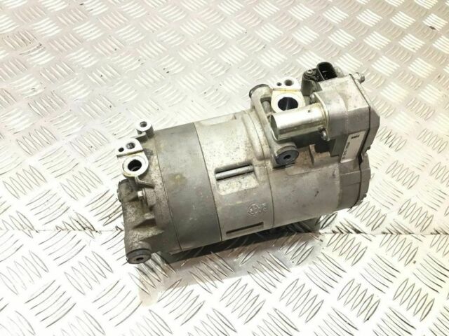

Hi All,
Has anyone tried to control the electric aircon pump from a BMW i3 or PHEV.
it can operate between 200v and 400v and runs on a lin bus.

came across this manual :)
Sanden-Electrical-Compressors-2021.pdf
(2.24 MiB) Downloaded 391 times

Very nice! That manual says can or lin. I wonder if it's model specific or if they're all capable of both.

andrewjenkins34 wrote: Sat Dec 25, 2021 8:39 pm Very nice! That manual says can or lin. I wonder if it's model specific or if they're all capable of both.
They seem to be listed under different part numbers so i would assume they cant do both.
i have sent messages out on all 64 channels and got the following replays
8e, ff ff ff ff ,71 enhanced
1F, 00 00 00 04 44 80 20 38 ,BF enhanced
F0, A1 04 83 A0 3C C5 30 3C ,D6 enhanced
