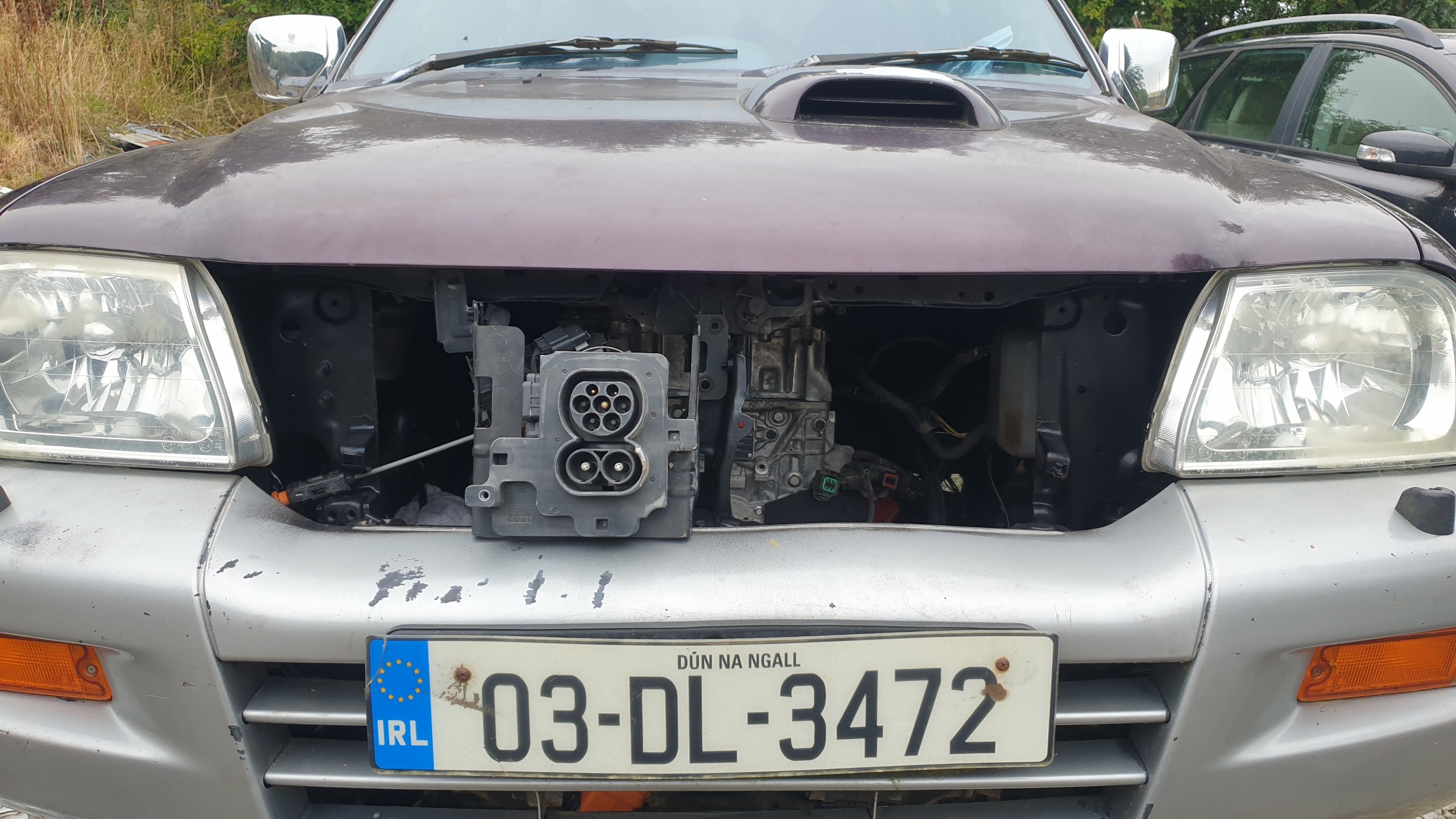

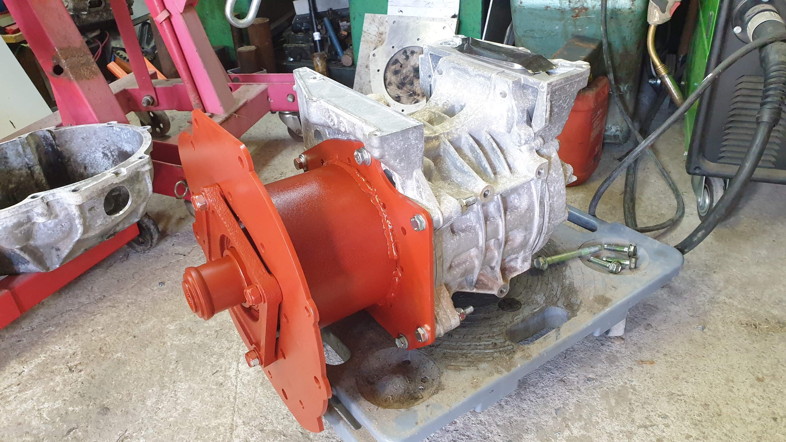

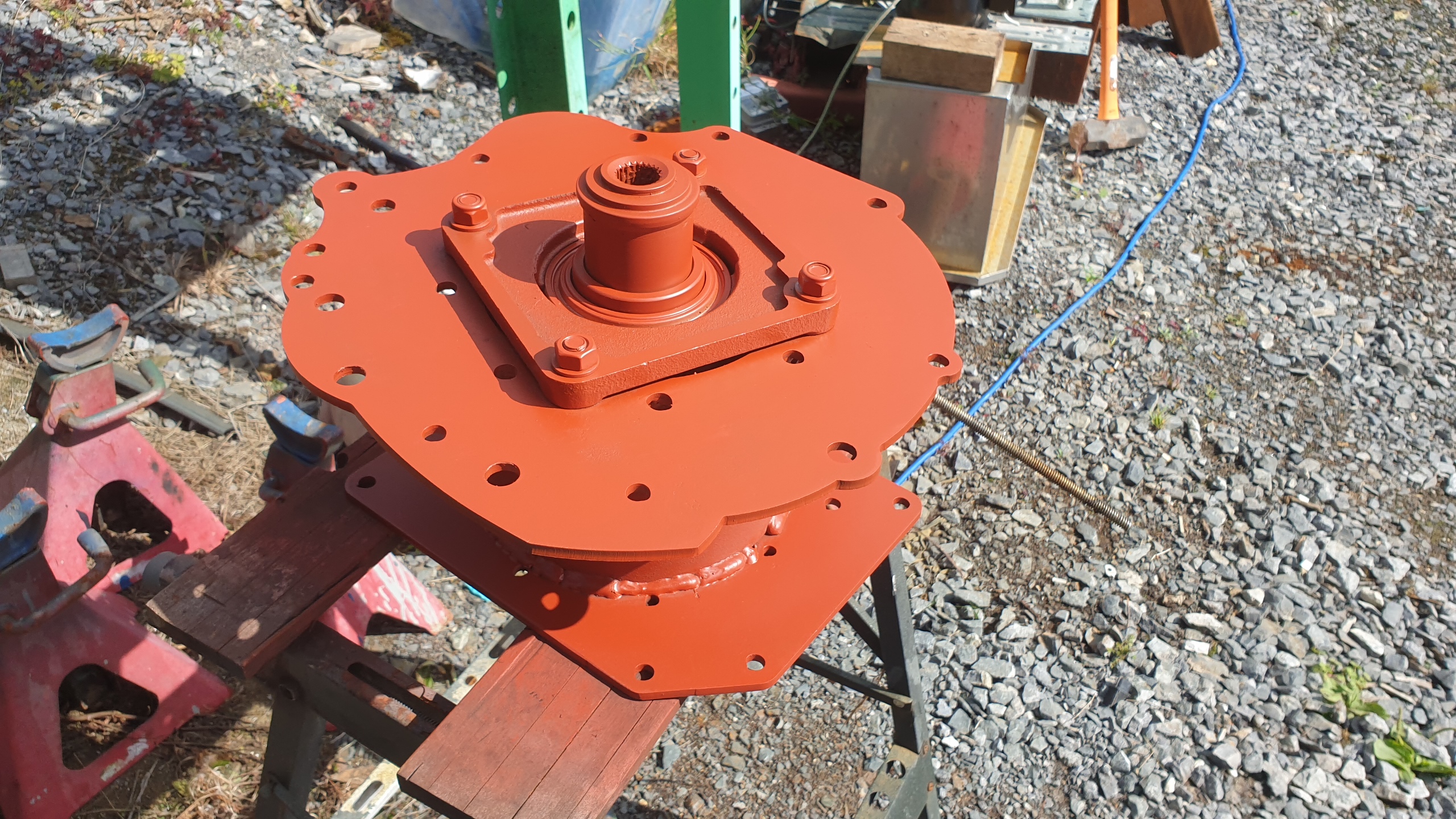

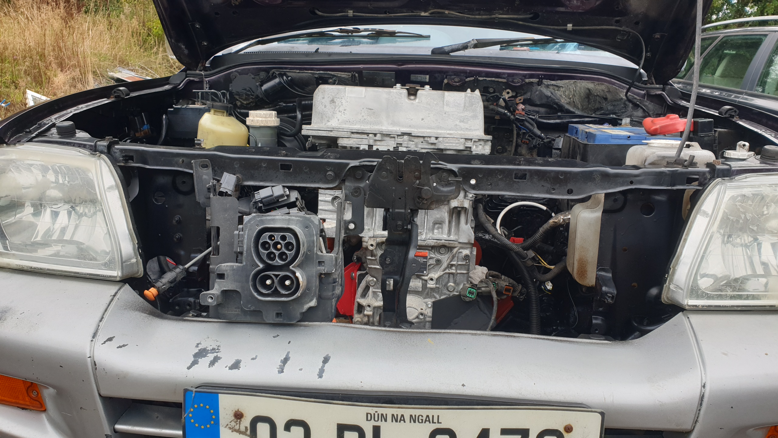

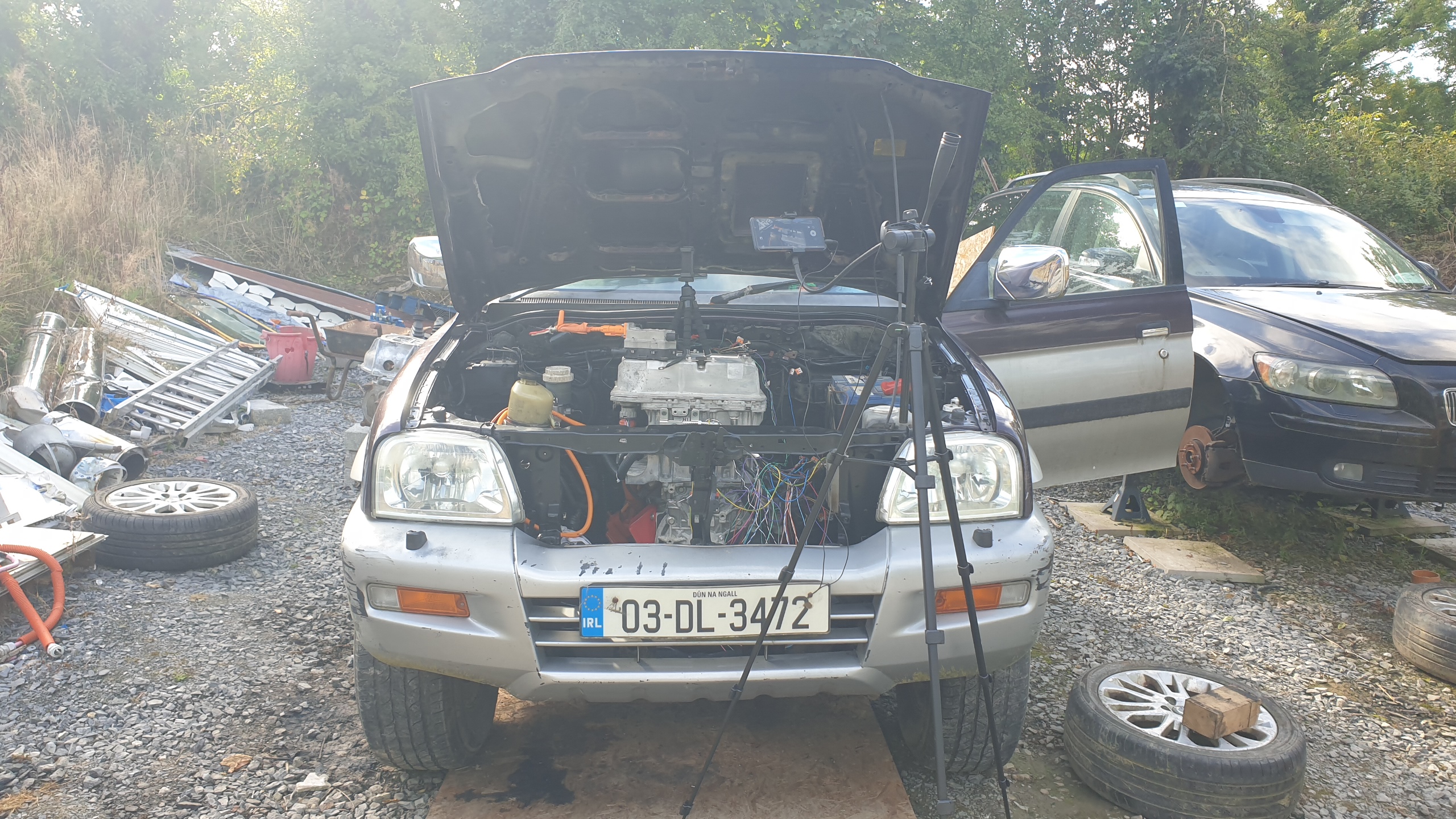

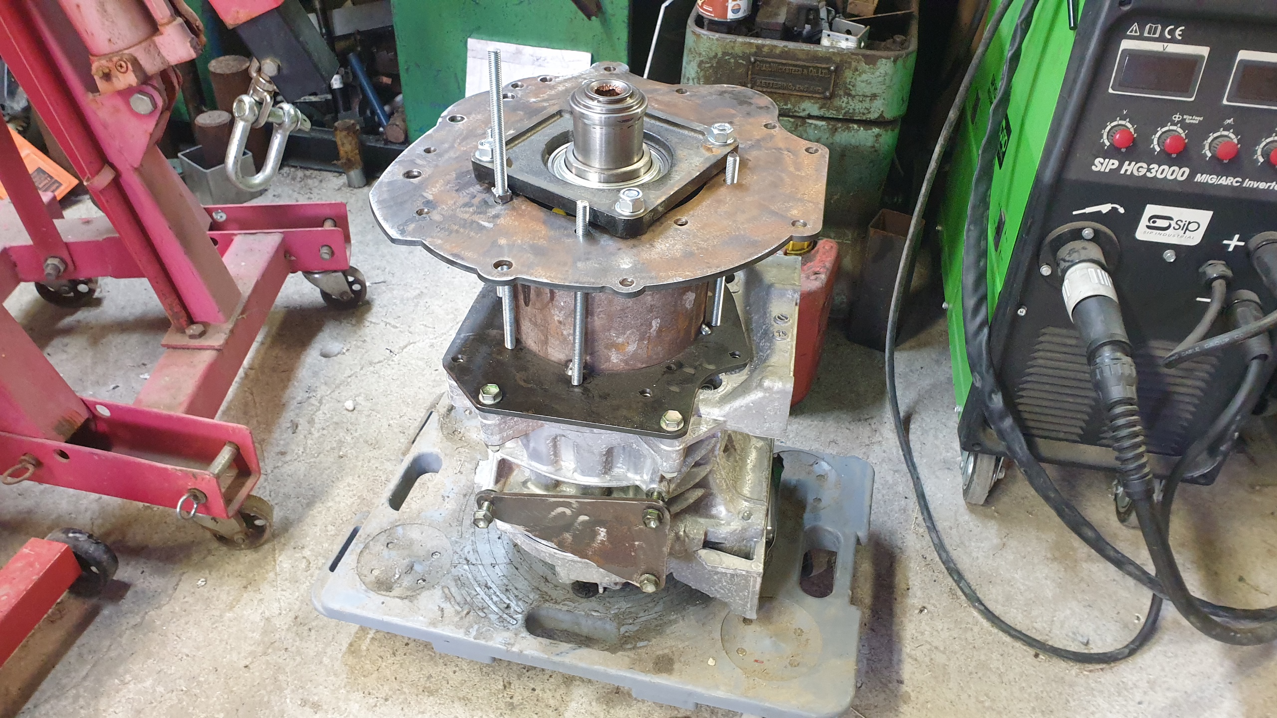

So time for a truck update. Short version : its running and driving around the property as a work truck and I hope to have it road legal in the new year and on the road.
Powered by a 110kw Nissan leaf stack with PDM and a 24kwh leaf battery.

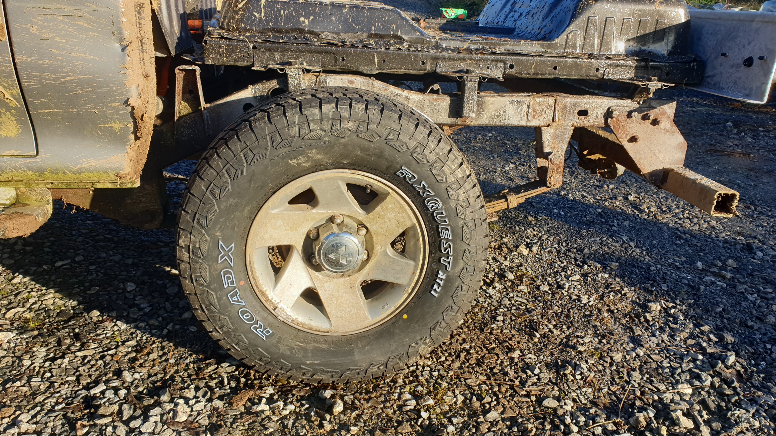

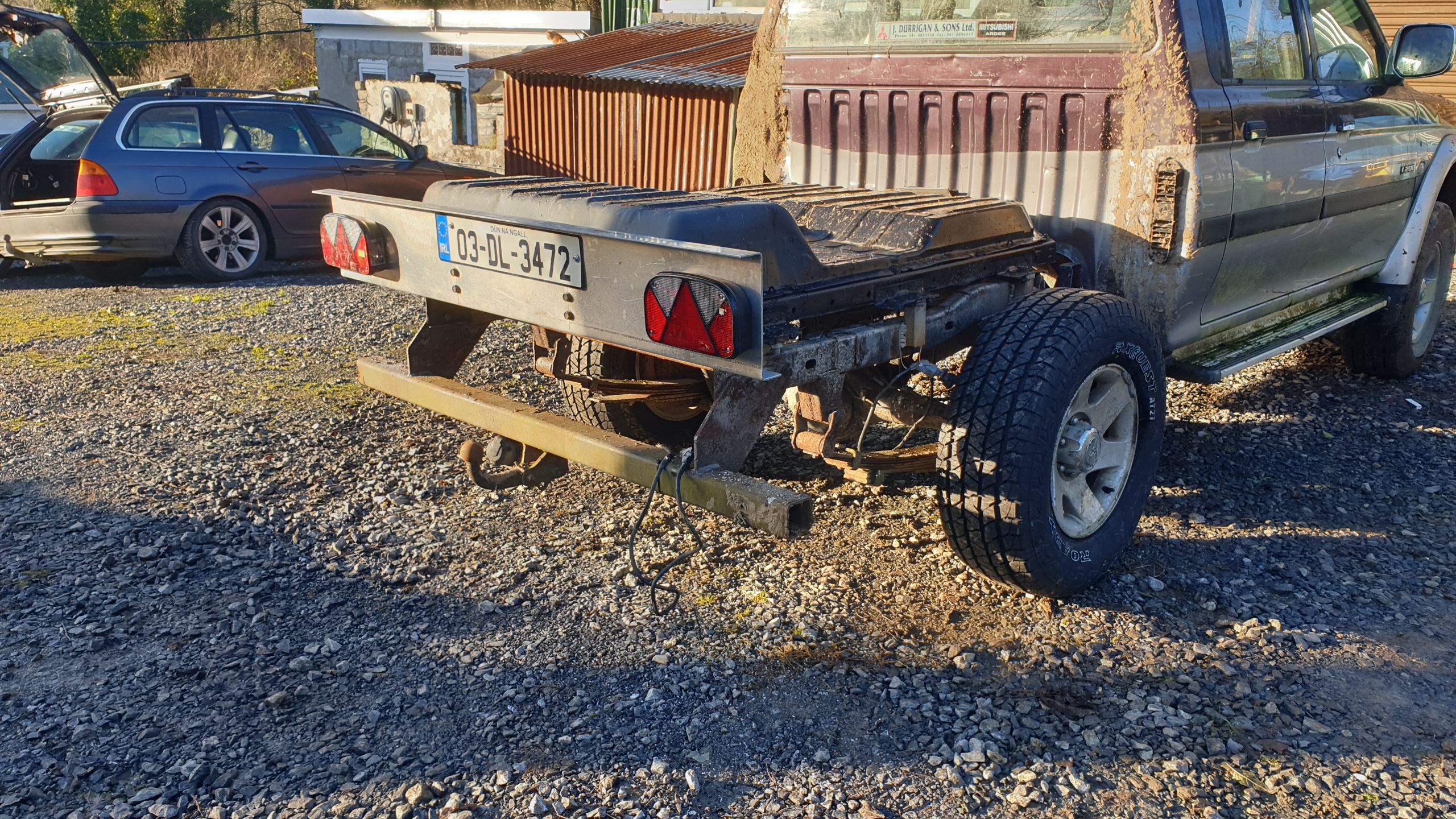

Getting some good work done hauling trailers of logs so I splurged on a new pair of rear all terrain tyres. Also working out some rear lights.

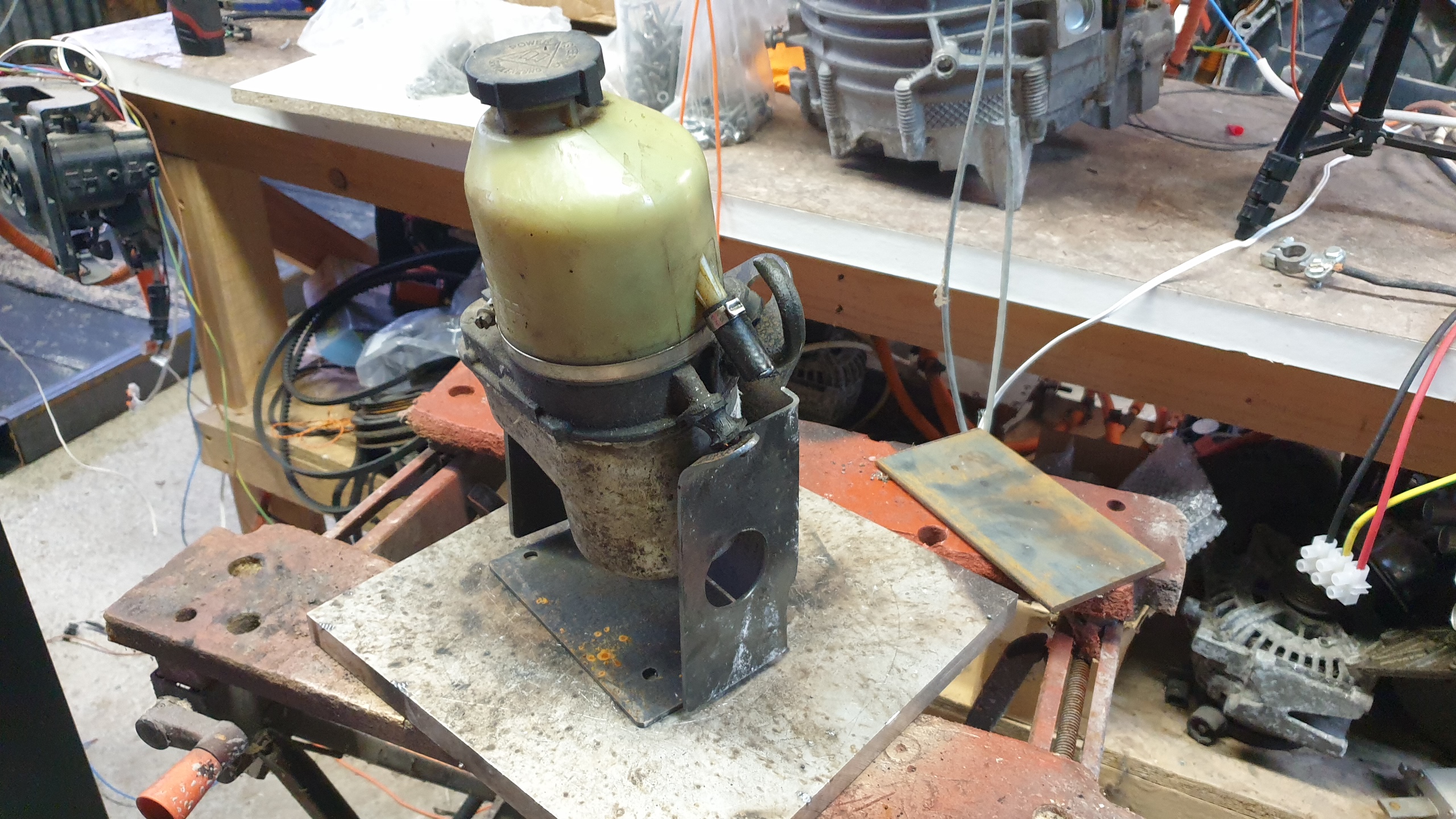

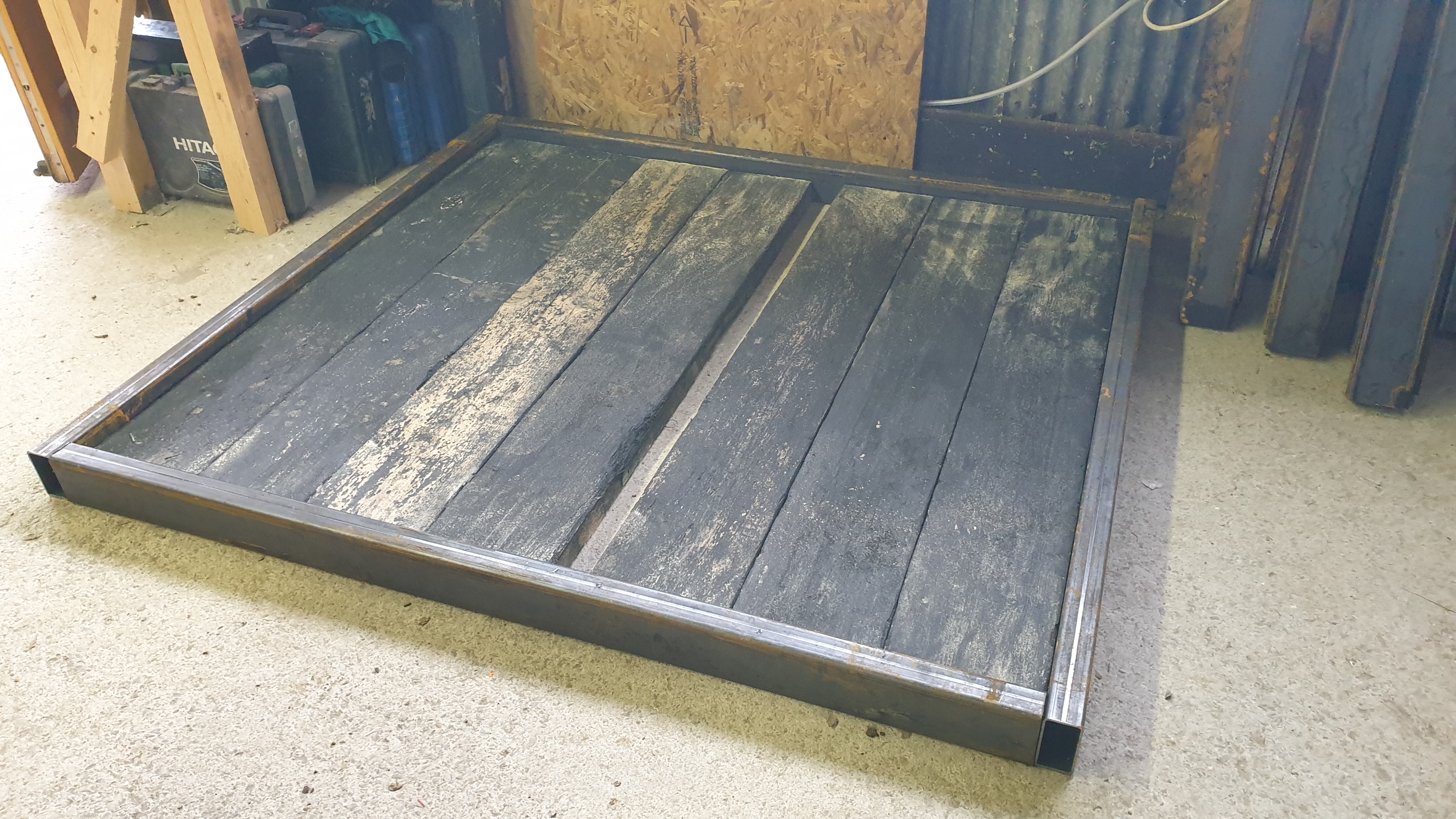

New flatbed bed under construction using a frame of 100x50x3 steel and end of life scaffold planks.
I've been learning Freecad slowly thanks to having a 3d printer and also trying my hand at some sheet metal design as I have someone with a cnc plasma cutter nearby. My first attempt at a bracket for the power steering pump. Dont laugh too much:)

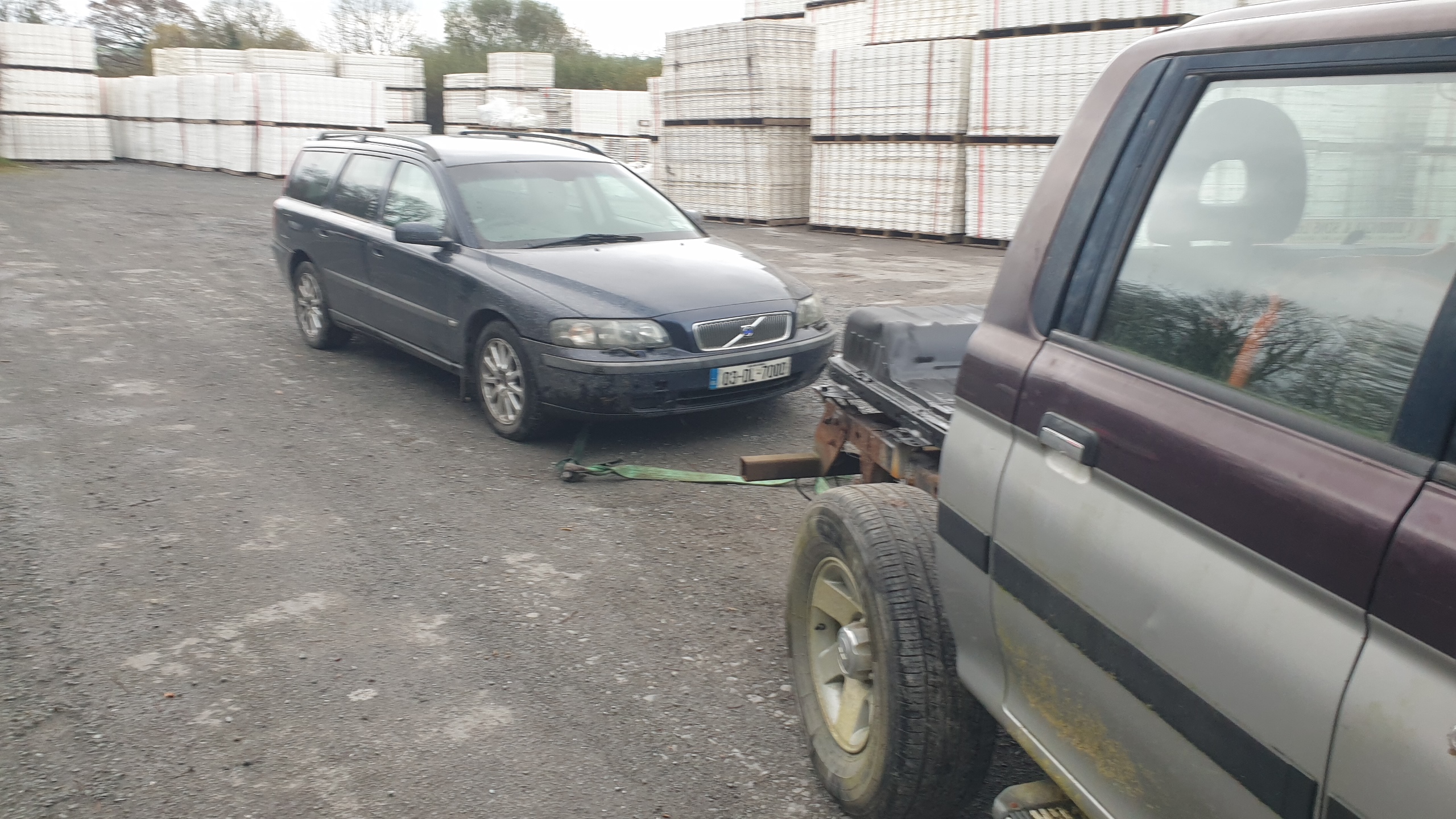

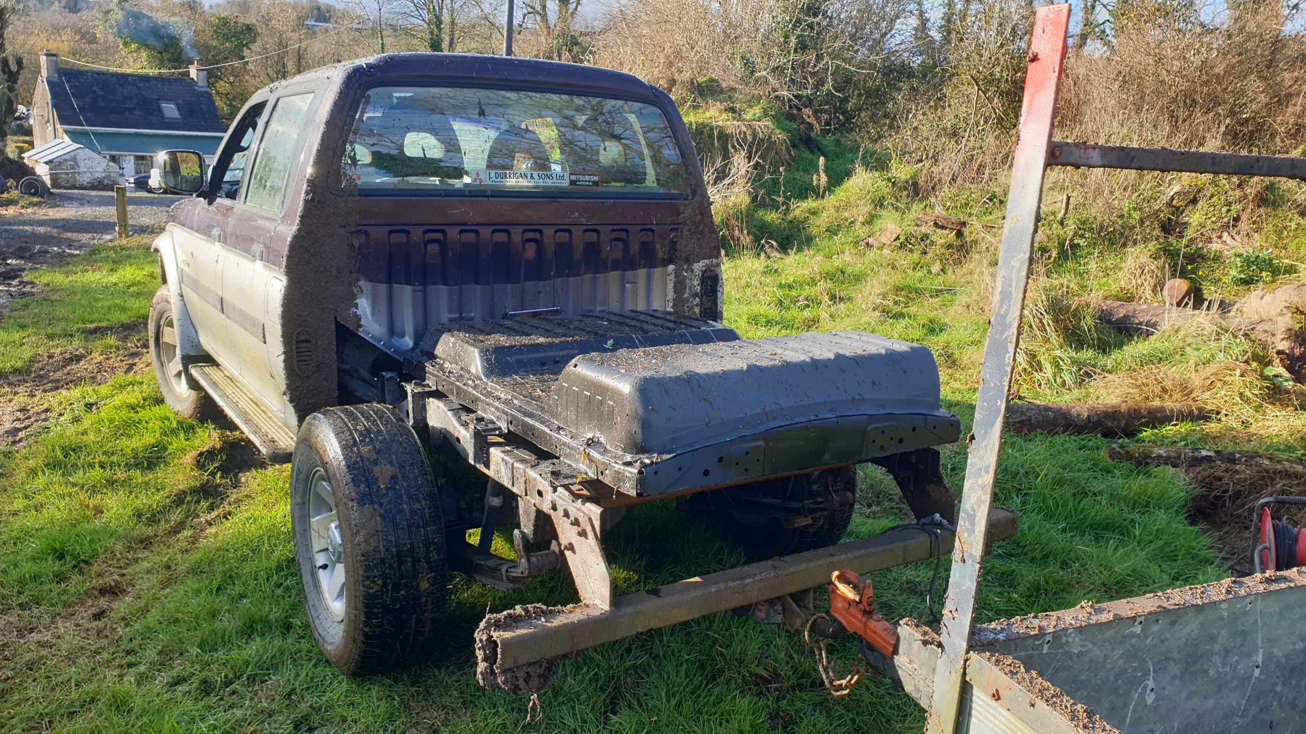

It even towed a new project car from a yard across the road where it was dropped off by transporter.
