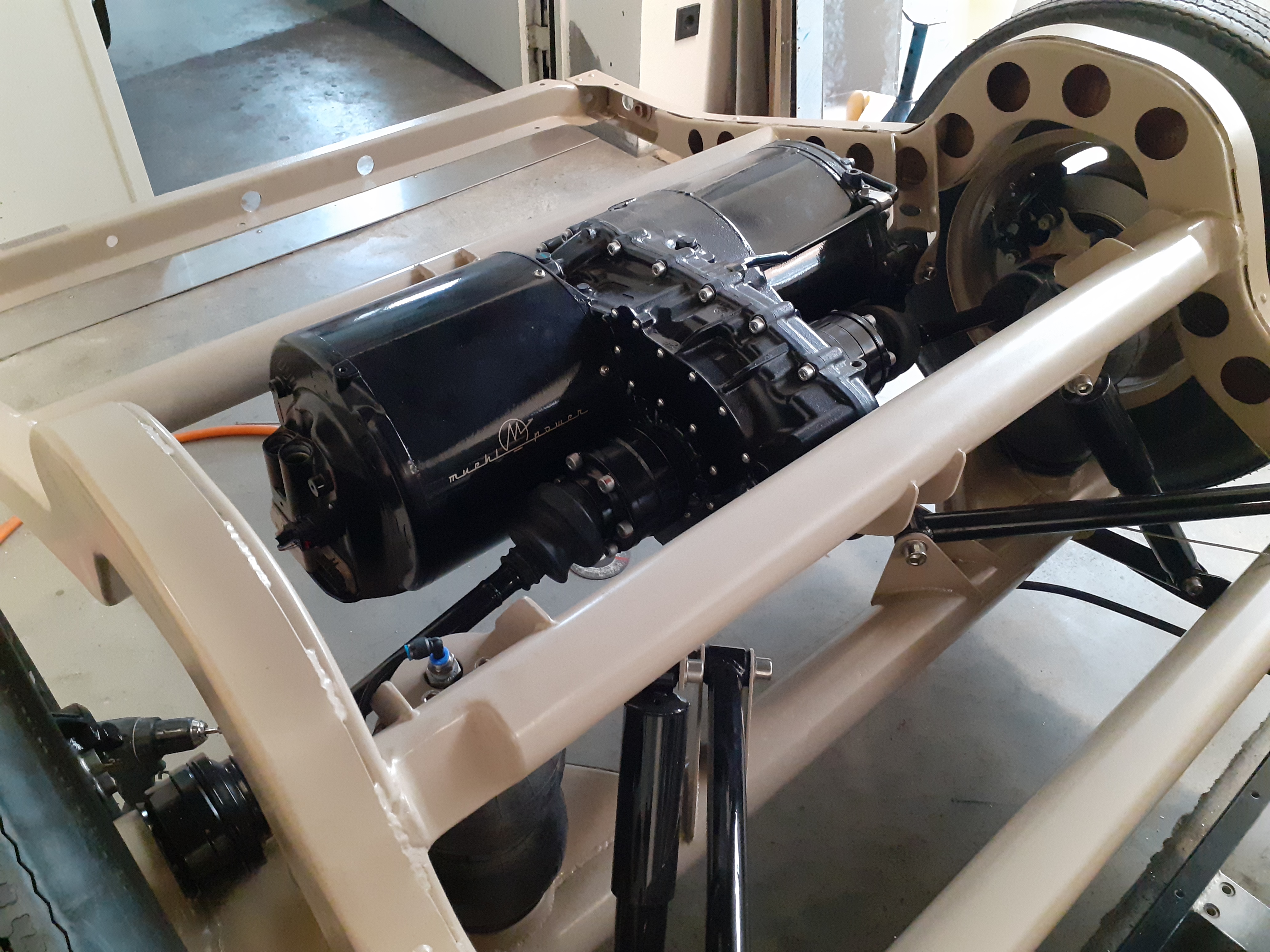

Are pins 19 and 20 in the ampseal connector accessible at the logic board level? It seems the connector that brings the rest of the signals out is fully populated. I would like to bring out the swd connections to be externally accessible. I had a wifi upload failure and appear to be dead in the water without doing an ST-Link udpate. I'm in a particularly good mood since that means dropping the motor out of the car to access the board and I would like to never have to do that again for this reason.

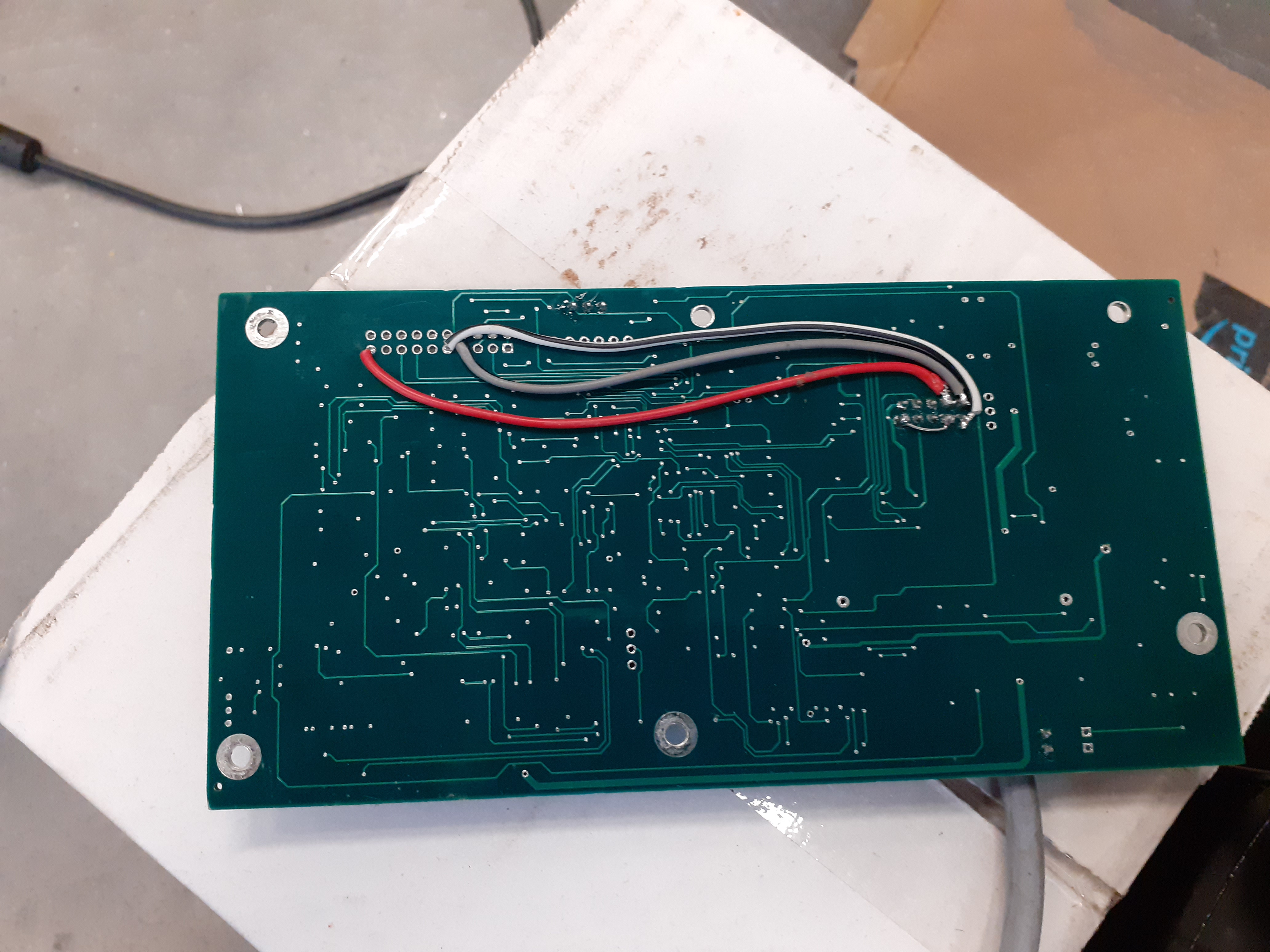

I made an extra molex connector on my LDU, where the serial and the programming port are routed out. The wifi module is mounted on a plug and is now outside the housing.

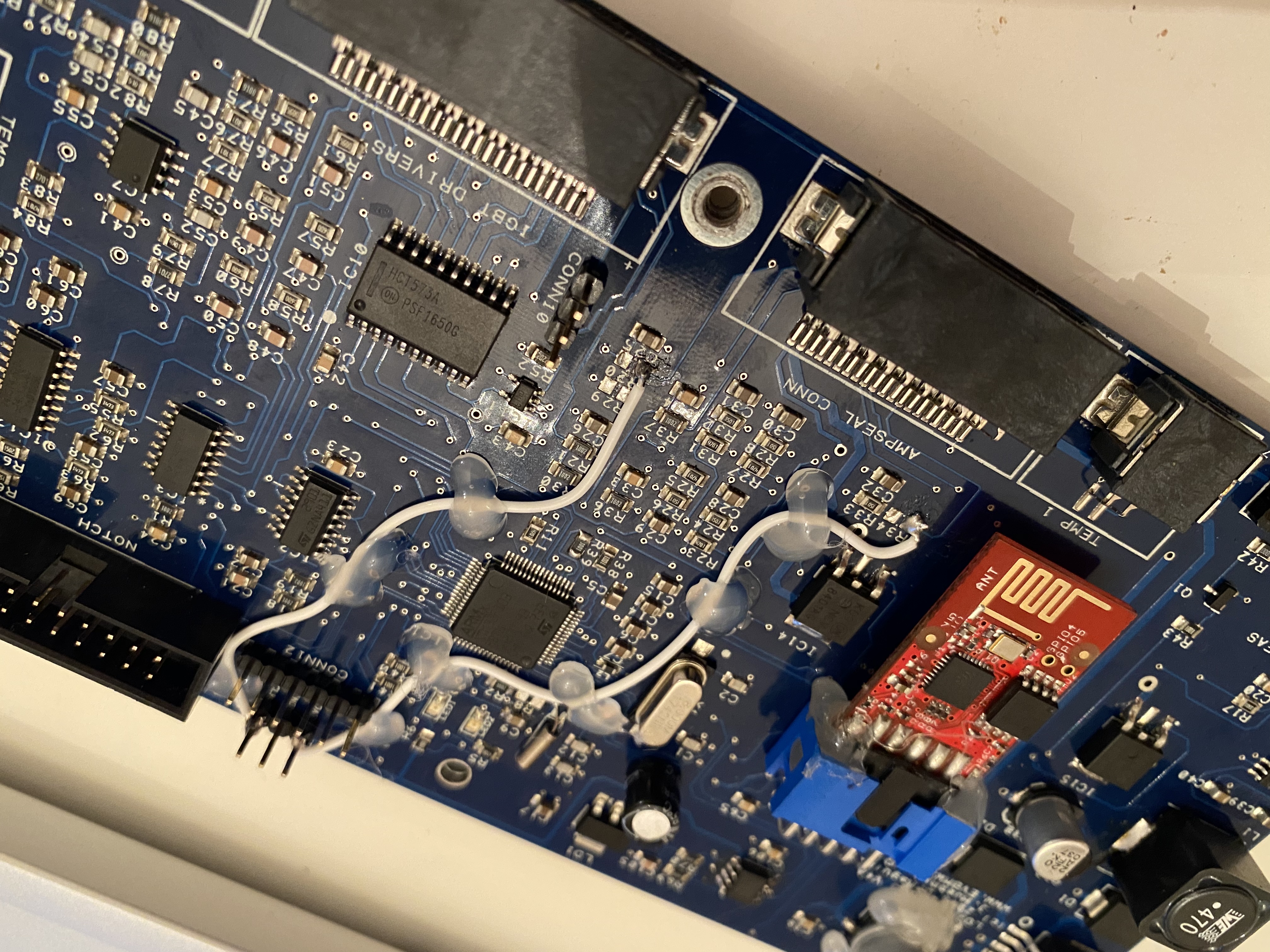

I think the most reversible, least hacky way to get SWD signals out of the case is going to be to re-purpose the cruise input, and brake press input by removing R26/R27 and R6, then jumping off the resistor pad closest to the input over to the the SWDATA and SWCLK pins. Im doing brake pressure, cruise and brake input all over CAN now so I can live without those.

If you look at my picture of the back of the board, you can see that I have put SWDIO, SWCLK, GND and 5V on unused pins of the WiFi module. So you could also supply the board with 5V via my external connection, the 3.3V is generated from the 5V

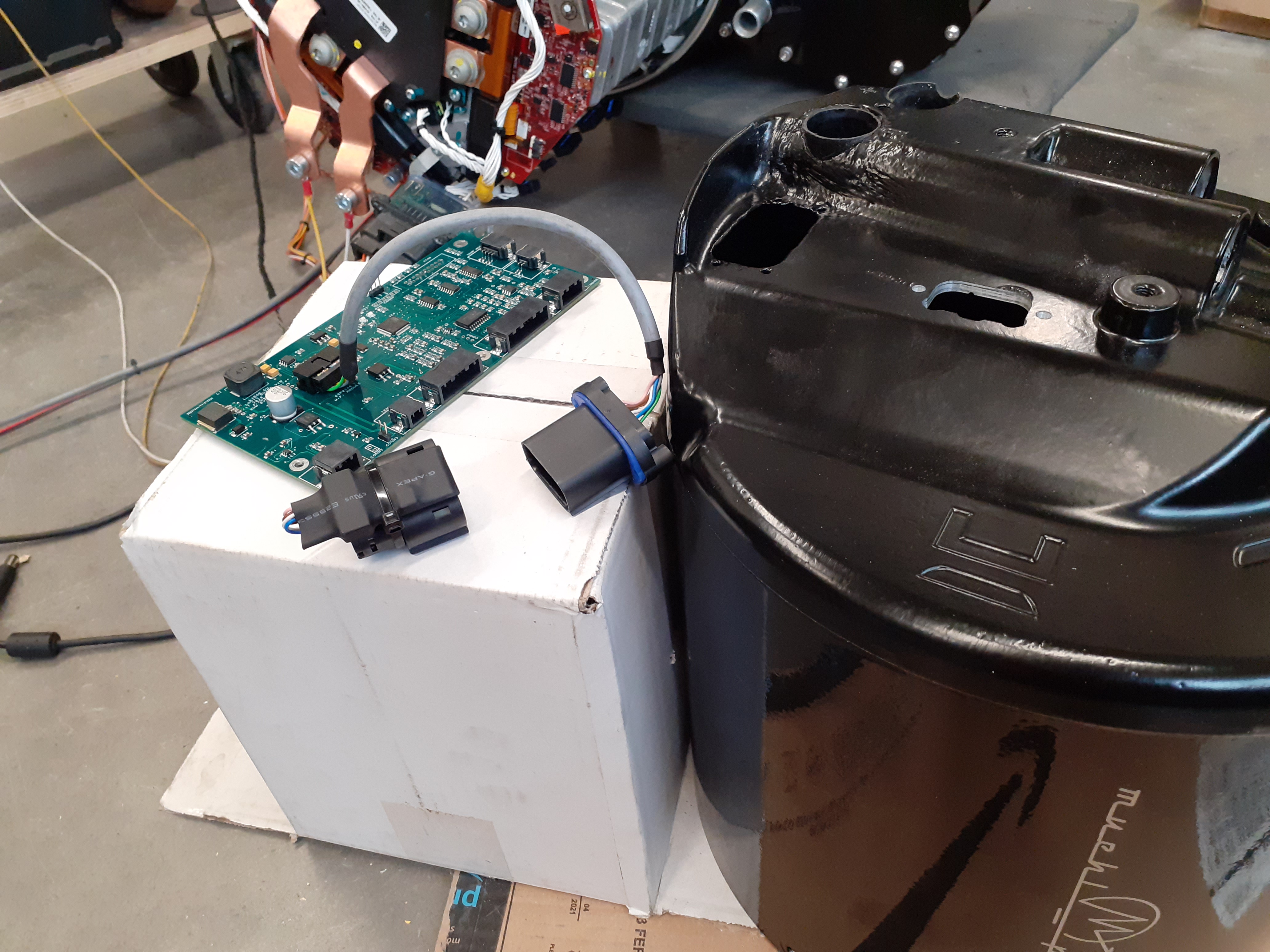

So I finally had a chance to drop the drive unit and pull the board. Connected via SWD and did a memory compare to both the previous good running bin and the one I was attempting to flash. There was a mismatch on both. Reflashed via SWD and parameters reappeared on the WiFi. I was also able to flash over WiFi as well. Did the below mods to bring data and clock out to the connector. Now if I get stuck, I can attach gnd, 5v, data, and clock to the stlink with a spare connector.
