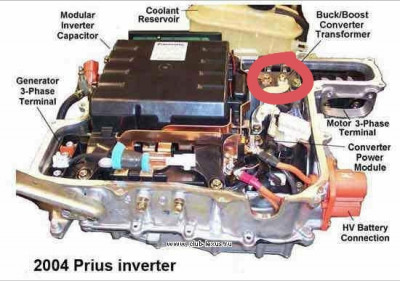

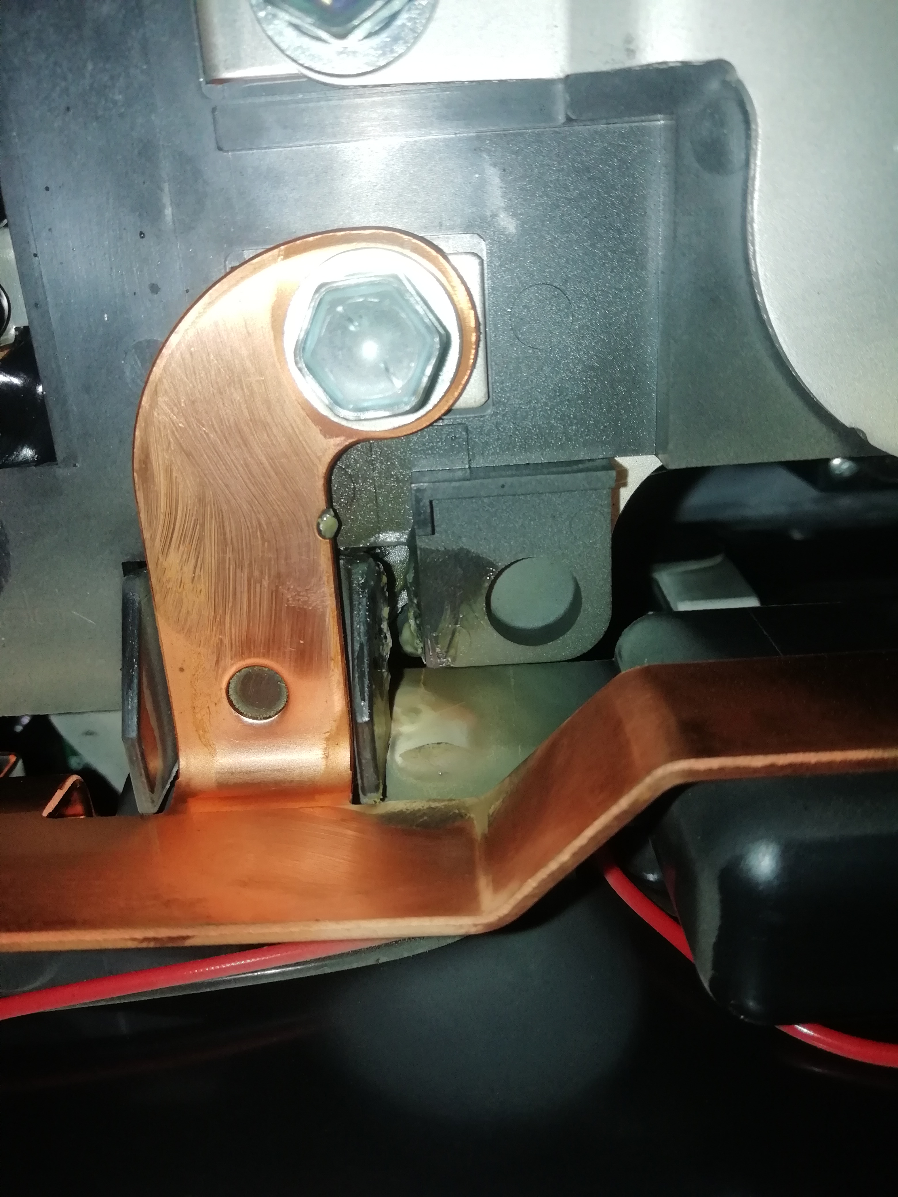

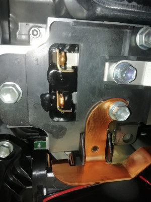

I checked the web-interface again when the main contactor is disconnected randomly, each time there is an "overcurrent" error. Then I opened the cover of the inverter and visually inspected the strange state of the compound of the step-down / step-up transformer and next to it there was a trace of the breakdown. The bolt pressing the copper bus was loosened and perhaps this was the cause of the breakdown. I have a spare Gen2 inverter on the shelf, I connected it and the current error no longer appeared and the contactor itself did not turn off. This is already a good result. It's just a pity that I have no more spare Gen2s left
.What is a damaged transformer for? Its use in the inverter is strictly mandatory, maybe it can be repaired?
