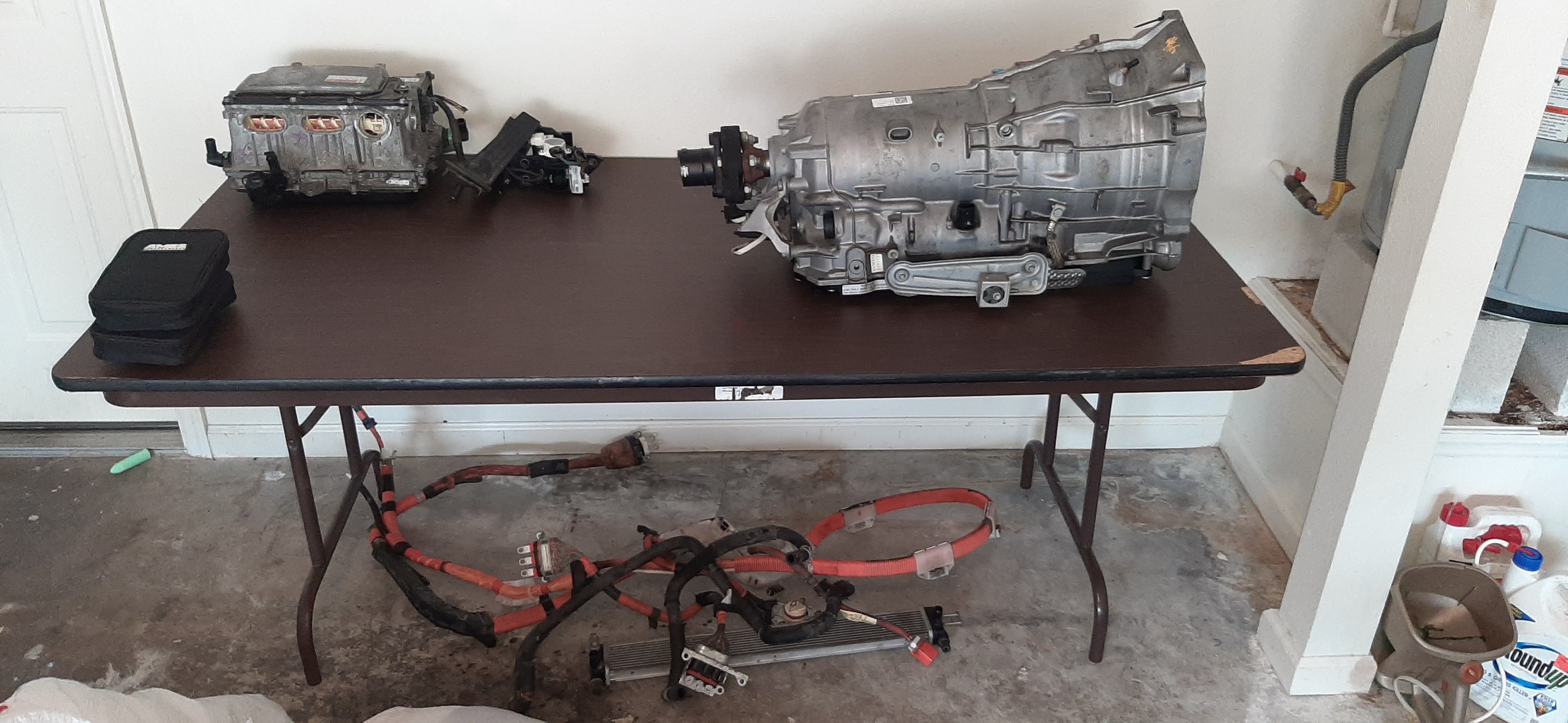

Hello all,
I'm looking for some input and to find out if I'm crazy or not.
I would like to purchase a salvage 330e or other BMW PHEV for the purpose of making a standalone hybrid that could be placed behind an ls1 or other ubiquitous engine. My thought is that the engine and the motor would be controlled independently and don't need to know that the other exists. This would be very similar to the Shadow Drive system offered by Vonnen for Porsche cars with the added benefit of a modern 8 speed transmission.
The goal would be to install into a 50s or 60s large American car.
Outside of the donor car, what would be needed to at least run the motor?
Thank you for your help.

Making a hybrid is one hell of an annoying challenge. you could setup the engine as an independent part and the motor control as an independent part but will have to make a module that would operate as a transition between the two. that module would also need to send control signals to the gearbox to select and change gears.
you would be looking at a
hope that helps
- standalone ecu ideally with DBW
- motor inverter
- gearbox controller
- module to transation between the two units
hope that helps

Hah! What you need is to think in reverse. Dont try to convert the car to EV! Try to add an E motor to the unpowered rear/front axle.andrewjenkins34 wrote: ↑Sat Sep 04, 2021 12:32 pm Hello all,
Ground will take care of your drive/regen connection between axles.
I suggest Outlander rear motor and inverter with CAN bus controler which will receive signal from throttle pedal.
I dont know where you will put the battery but those cars were big! You could take a FWD car and put Outlander rear axle in it

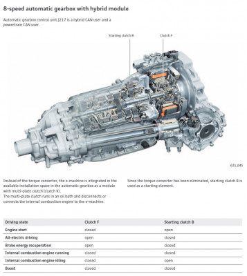

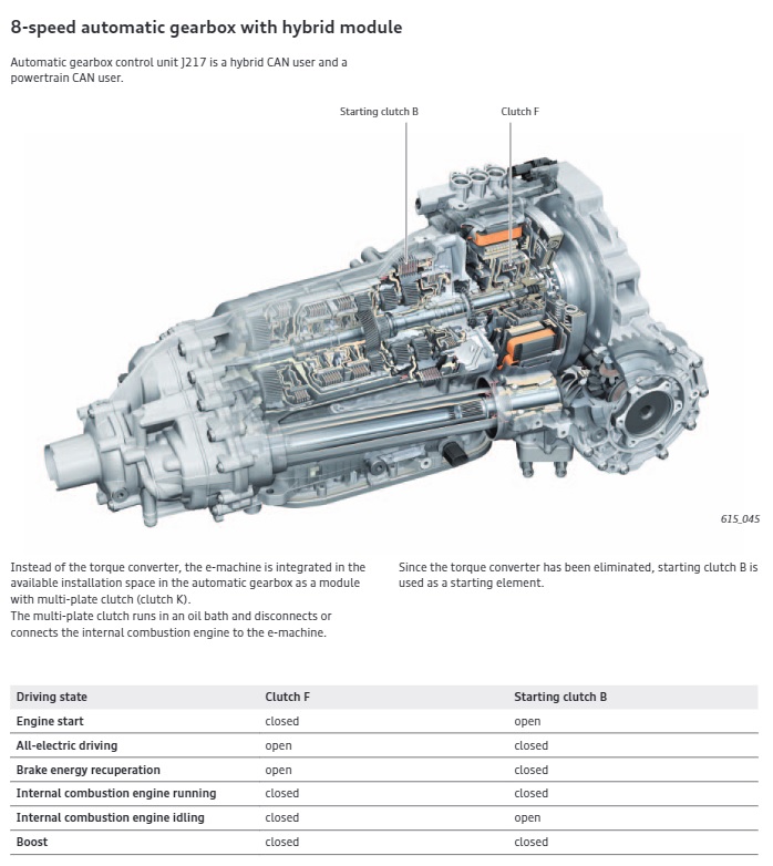

I cant speak fully for the BMW side as i work more on VW/Audi (below an example of audi hybrid 8sepeed gearbox)
when it comes to a hybrid manufactures have gone many different methods of control. some making the engine ecu decide when the transition happens some leaving the motor inverter. lots of test have been run on the engine and motor to make sure the swap between the two are as smooth as possible.
the main thing is manufactures don't like sharing with us there CAN Bus data. meaning we have to reverse engineer all the signals and find out what they mean and which ones control components.
if you are using the bmw gearbox, typically the gearbox control unit is built into the gearbox. you would need to learn that CAN BUS signals are transmitted to/from the gearbox for it to select gears and transition between engine and electric motor. this is getting done on the BMW thread BMW ZF GA8P75HZ Gearbox Hacking.
The transition device (can be STM32, Arduino, Rpi, ect) connects before the ECU, inverter and gearbox would have to take in the pedal input and essentially match the engine output to the motor output before you start actuating clutch's to swap modes. sounds simple really isn't.
As for less hardware unfortunately. you still would have to remove the mechanical power steering pump as that would stop working as soon as the engine is switched off. electric power steering and vacuum pump would need to be fitted. A/C you could have mechanical or electrical as its not always needed.

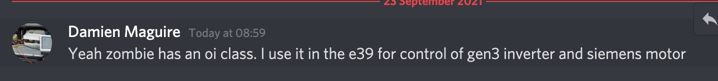

Is this the kind of project the Zombieverter VCU could handle?
Instead of worrying about transition while driving, would it be easier to just have the different modes selectable from stop?
Thanks for pointing out the need for electric pumps while in ev mode, not sure what I was thinking.

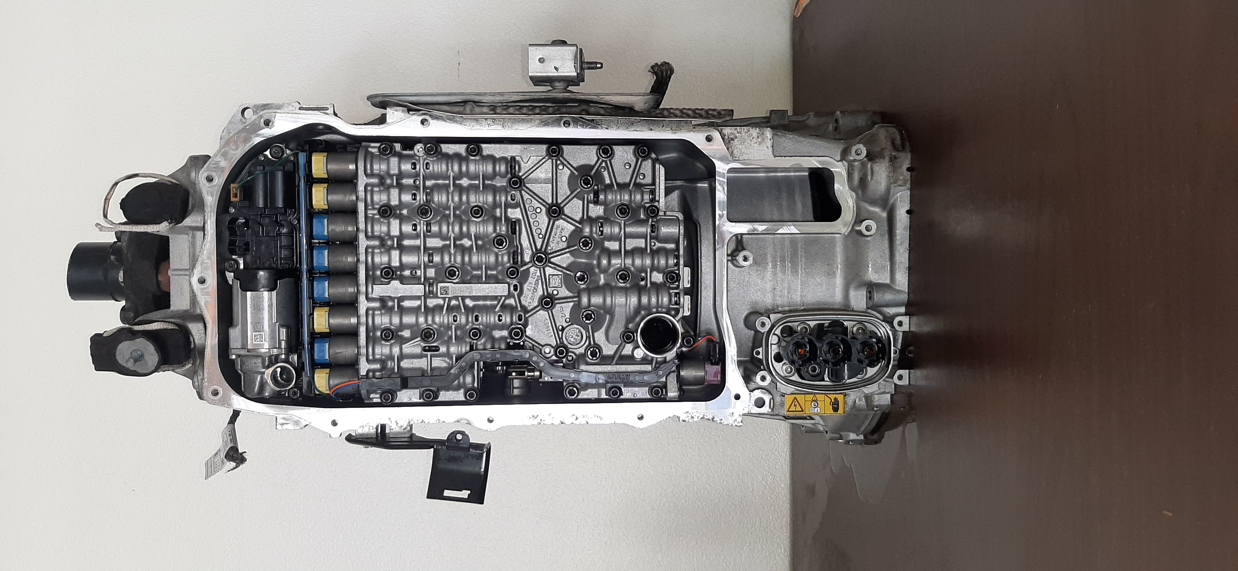

I'm in the middle of this right now with a GA8P75HZ from a BMW 330E, any info on the motor is scarce and ZF are tight lipped, we are using the original BMW battery pack, Standalone engine management, separate TCU and a VCU to control the inverter and BMS.......LOTS of CANBUS, main issues so far are getting a "torque model" style output from the ICU ECU to feed the VCU and getting any information about this damn motor, I'd like to run a PM100DX for ease of integration with the VCU but i'm open to suggestions if anyone has any?
Thanks,
Kieran
Thanks,
Kieran

Sorry I didn't make that very clear, Not looking to run too much of the OEM electronics, battery pack will be broken down into its 5 individual modules and probably managed with an orion bms and valeo charger, TCU is an aftermarket controller, still up in the air on which inverter to use(We don't have the OEM unit) I was looking to use a Cascadia PM100DX but they aren't being very helpful in identifying if they can work with this motor. Anything useful I might know I'm happy to share though.

Would it be possible to mate the GS450H (or GS300H) transmission to e.g. an LS1 engine? For example with the zombieverter for the transmission and a Holley LS EFI system (or something like that) for the LS1 engine? Or even better (/cheaper), the zombieverter also for communicating with the engine? (zombieverter communicating with the stock engine ECU)
I can imagine that this would make things simpler instead of using a standalone hybrid, but it might also make things more difficult. Hard to tell for me as I'm also new to all of this.

Unfortunately I don't think it is a Remy unit, If you'd like some more photos let me know, Would I be way off in assuming 8 Pole pairs and IPM? The actual ins and outs of motor specifics are very new to me.

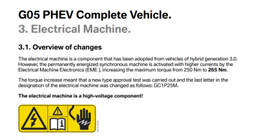

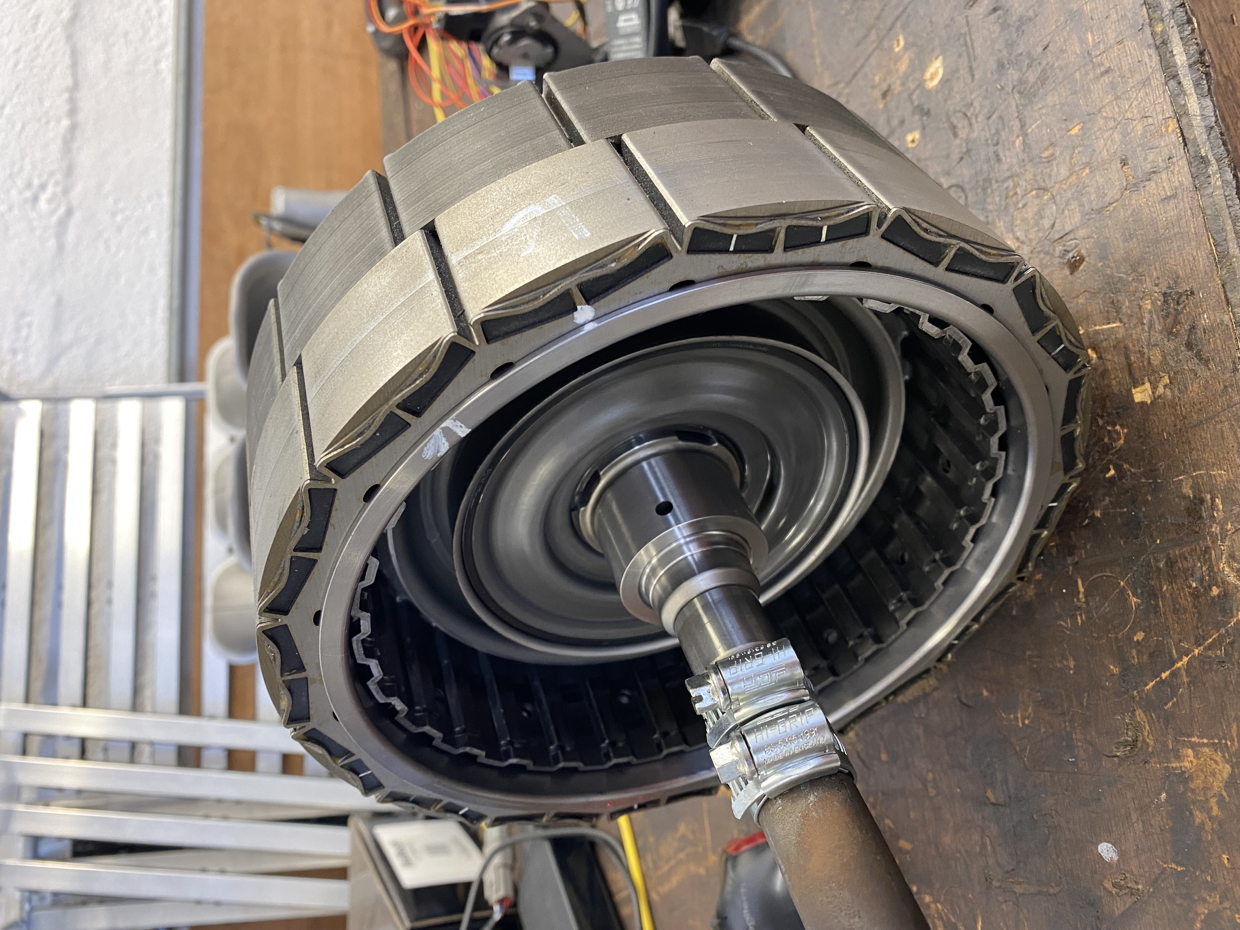

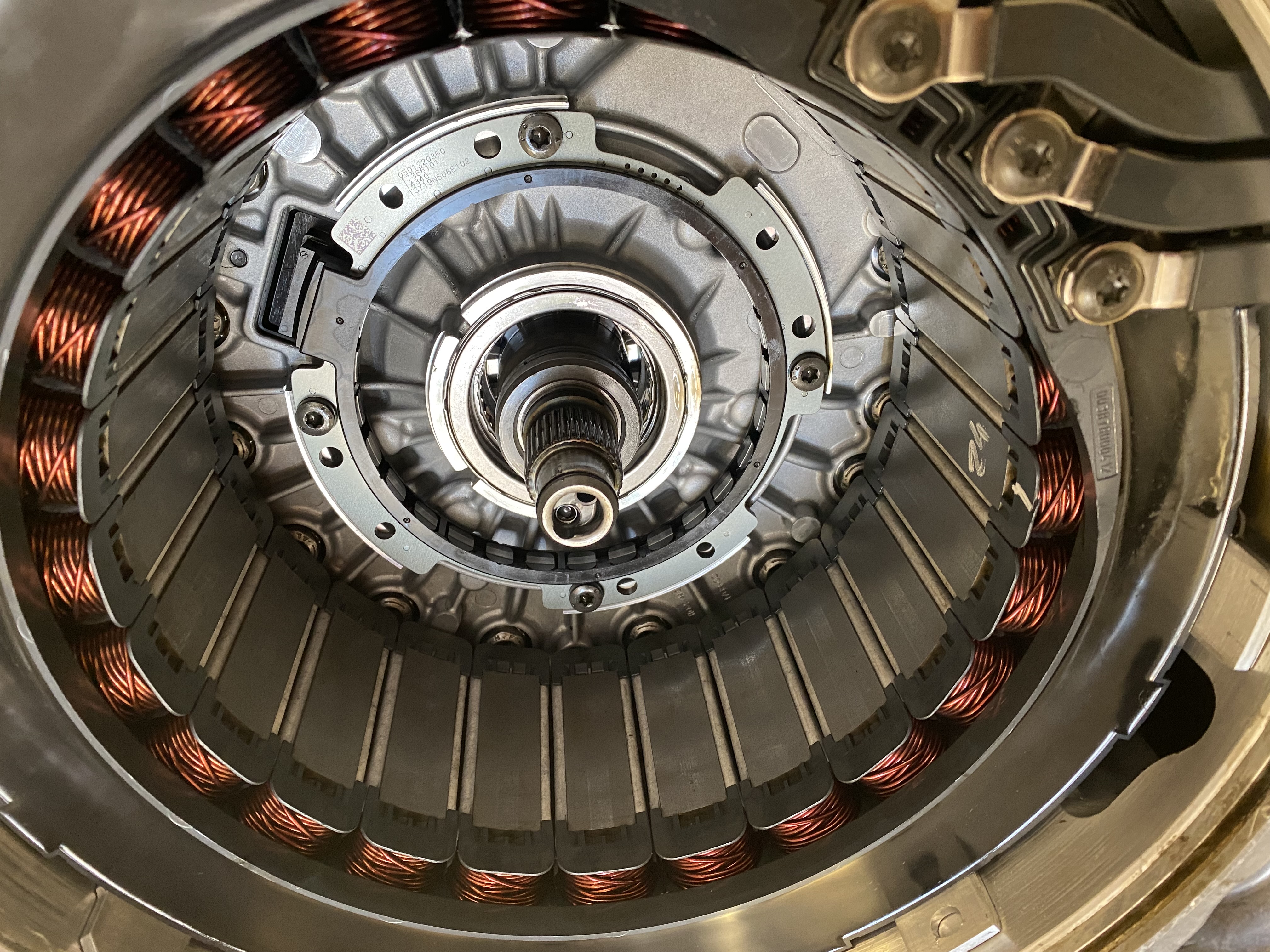

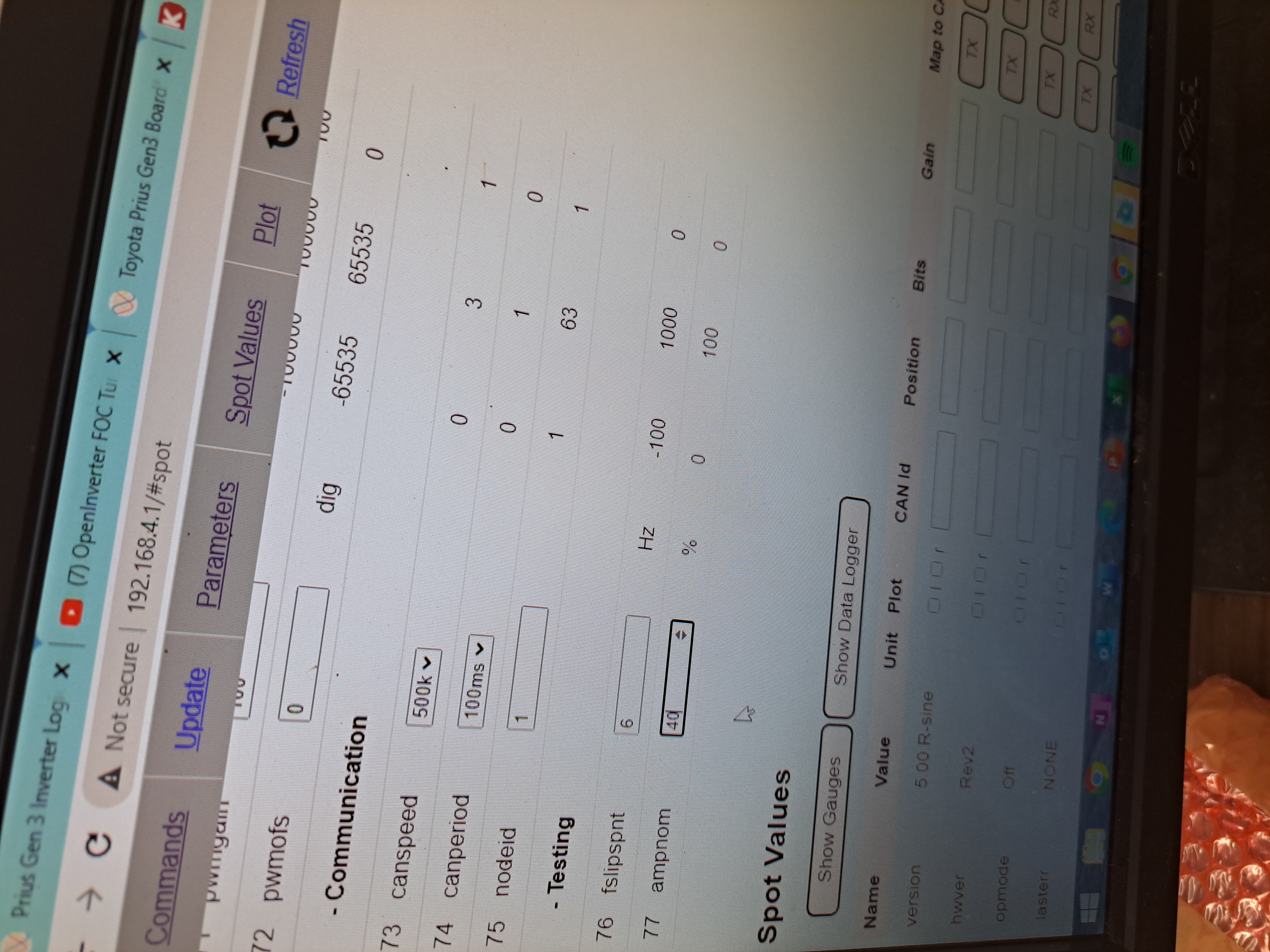

Is anyone willing to share a bit of knowledge about what would need to be found out about this motor to find a suitable inverter? Cascadia have come back to me with a list of
Is the motor SPM or IPM? Looks like its IPM from what I can Gather?
How many pole pairs? Out of my depth Rotor has 2 Rows of 16 poles? And stator has 24 slots?
How many pole pairs is the resolver? 28 Poles/Slots? (My electric motor terminology is terrible) with 8 peaks on the encoder rotor? This is a SIN/COS encoder but I don't know the standard exciter voltage.
What is the peak and continuous current rating? No Idea....I believe it's an 80KW peak output motor
What is the battery voltage? OEM 5 module BMW pack has a nominal voltage of 293V, a working range of 224-332V and 26Ah capacity according to BMW data
any help would be much appreciated!
Re: 330e Hybrid Swap

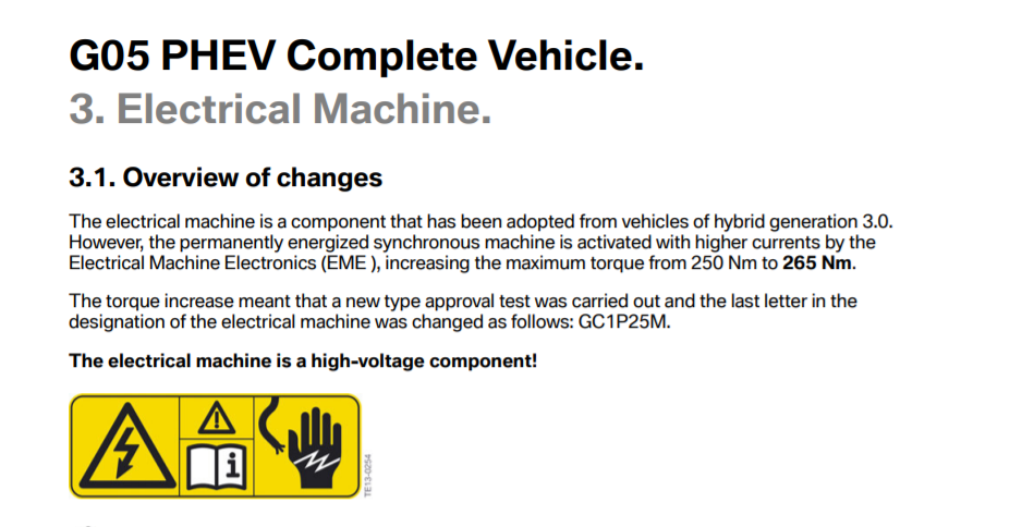

Found this interesting little snippet from BMW PHEV GEN4 document, Battery voltage has increased to 354.2V Nominal, 269-403V range

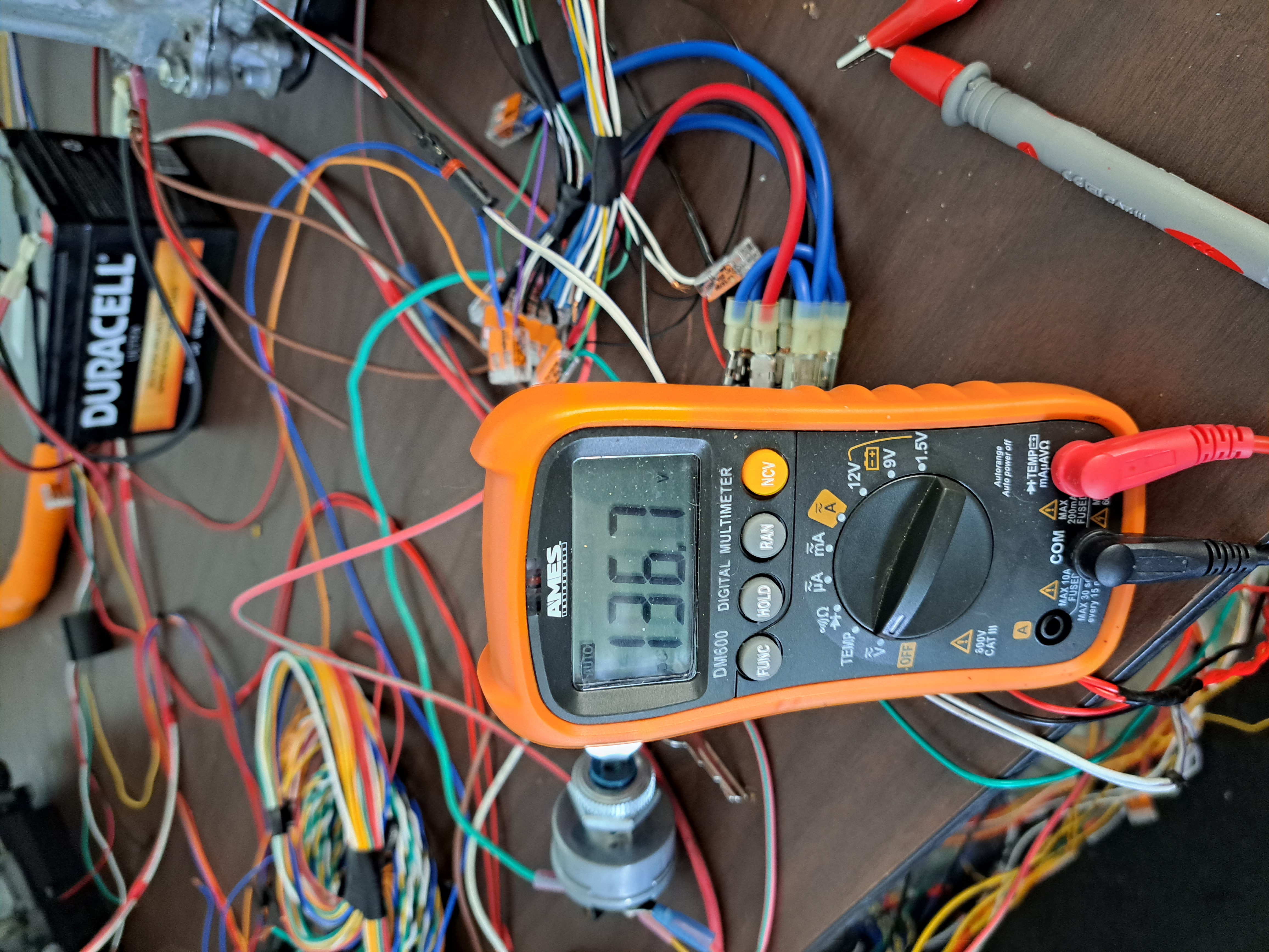

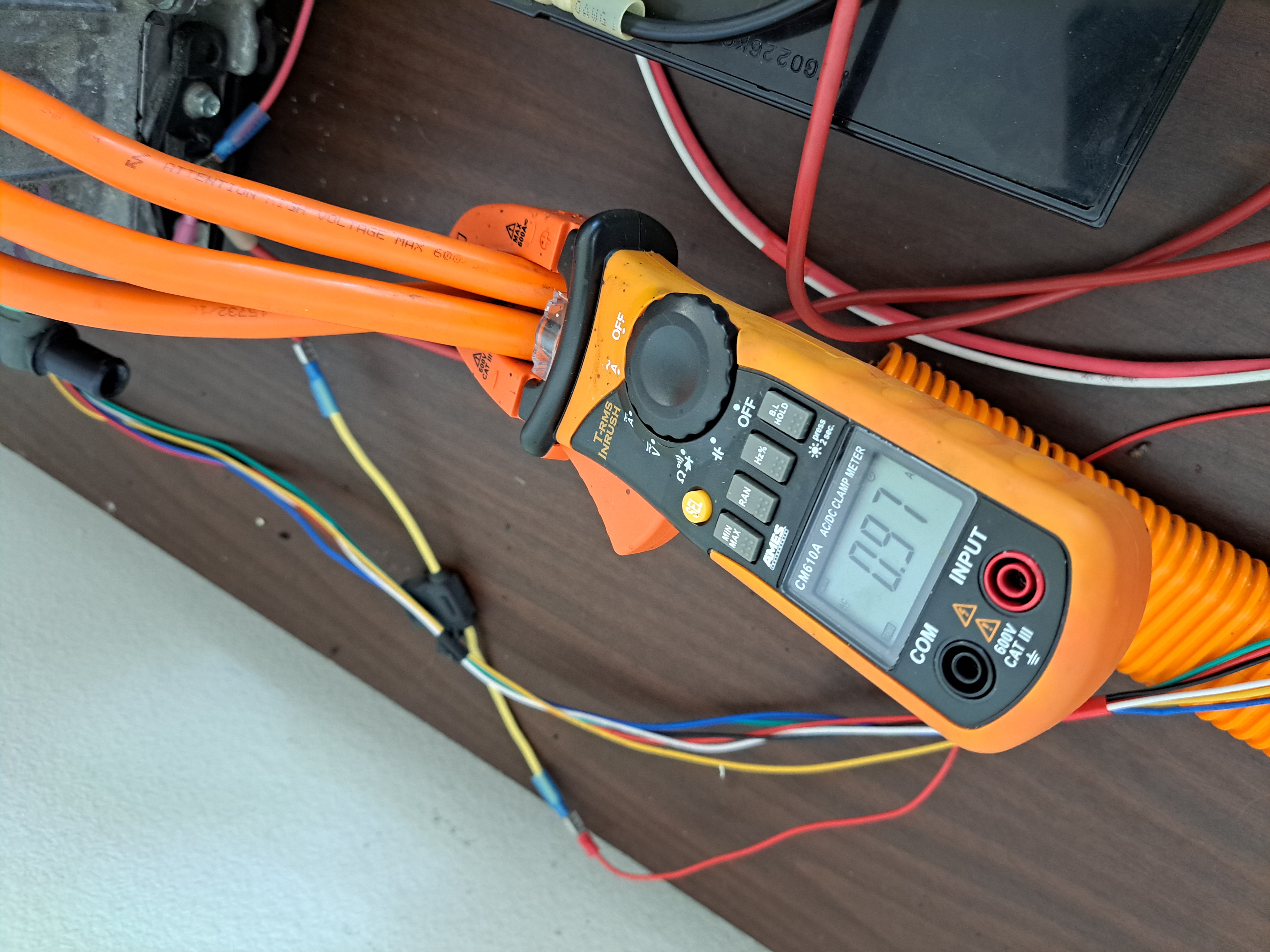

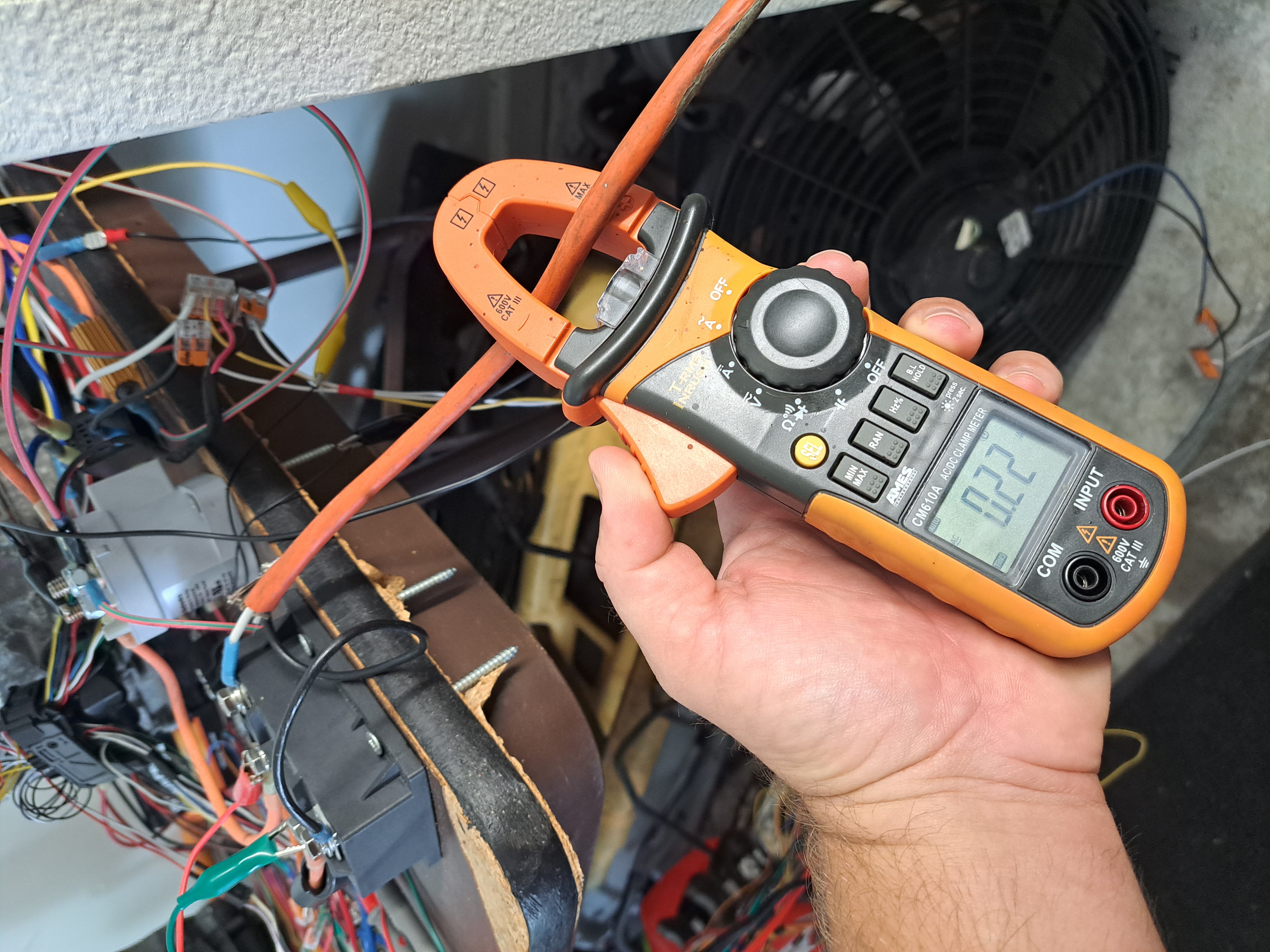

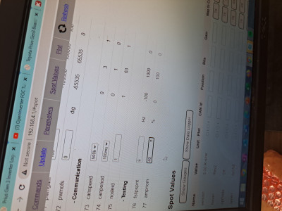

I have mine spinning with Johannes' board and a Prius inverter now, only at 100V at the moment but looking to get the main pack connected soon
