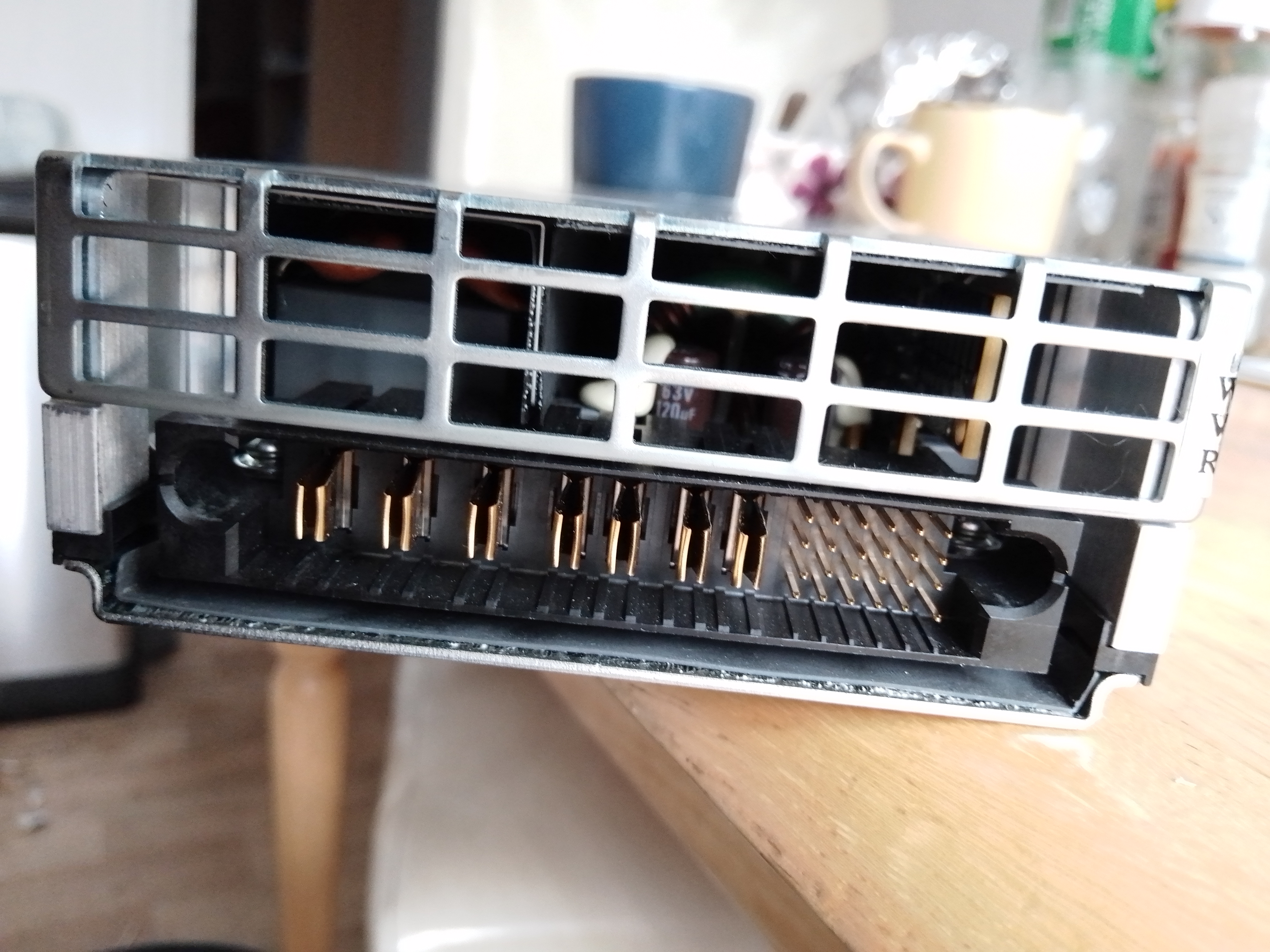

evMacGyver
Posts: 166
Has thanked: 72 times
Been thanked: 11 times
Re: 3000W Flatpack2 HE 48V chargers spotted on Ebay for £15
Post by evMacGyver »
Found this: https://dokumen.tips/documents/flatpack ... ifier.html
"Mating Connector P/N: 51866-048LF"
This worries me a bit "Isolation 100 VDC – output to earth", was thinking stacking many of these but this is less than other models..

thornogson
Posts: 61
Joined: Sun Mar 15, 2020 10:04 am
Location: United Kingdom
Post by thornogson »
this is the connector at the back
https://www.digikey.co.uk/en/products/d ... 2AzEAugL5A
and I think this is the plug for the back of it
https://www.ebay.co.uk/itm/114232204542 ... SwxbJex8Us
As I now understand it , the cases are all earthed via the 240vAC hookup and all + and - terminals are 'floating' , ie not tied to ground , so put them in a cage together and earth it and link + and - to your hearts content , but don't take my word for it !

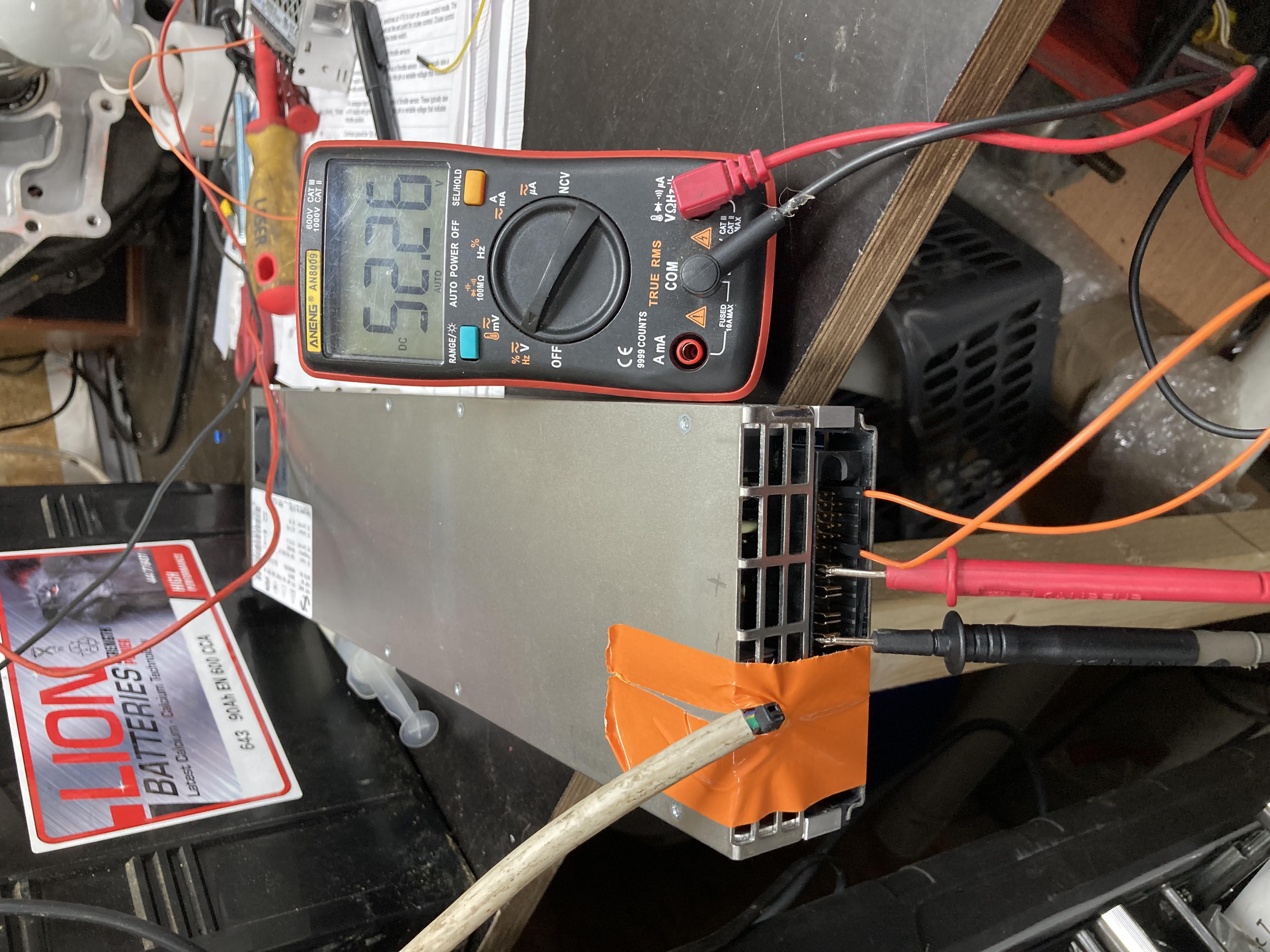

Been reverse engineering these things, this works but is crude , I’ll post my voltage findings when I’ve written them up . I’ve got 4 in series now giving 200+v dc . What could possibly go wrong!!

thornogson
Posts: 61
Here’s what I found poking around with a voltmeter with the unit switched on . Perhaps some of you CAN savvy people can tell what’s going on and how to control a number of these chained together
