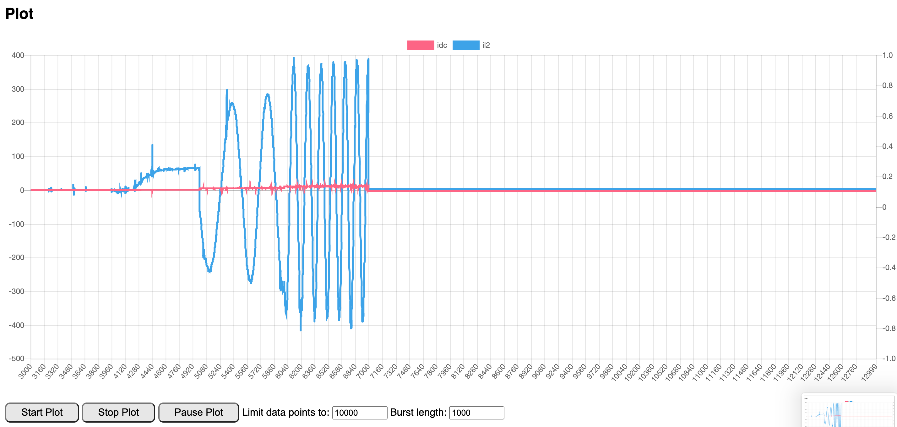

Re: Current limit parameters
Gen 3 prius inverter, ocurlim set to 900 but this is stopping with OVERCURRENT, any hints as to why?
- params (4).json
- (1.25 KiB) Downloaded 123 times
I checked the Parameter database and one user has the idc set at +/- 5000A and ocurlin = 300A as well as throtcur = 1.0A/% (as do I) with success.
I'll do some more faffing tomorrow. It's nice and lively with higher throtcur, but only goes for 1 second before bumping off. Setting of 3.6 I can put foot to floor, 3.7 cute out, but my de rating parameters are lower than overcurrent, that's what I'm failing to understand, why it's not derat8ng instead?
So what you need to understand is the desat circuit in the inverter is analog. The STM32 is obviously digital. An analog circuit is thousands of times faster. So by the time the mini Johannes brain sees the current limit the Toyota engineers have shut you down, gone home, had a cup of tea and are catching up on the latest episodes of world's fastest electric car.
Gotcha, Toyota says no. So he'll let me have 360amps with a smile and a wave but 370 is a big no without bringing in mg1 too.
Hopefully not going to quickly find out the front outlander motor is too weak for the job.
