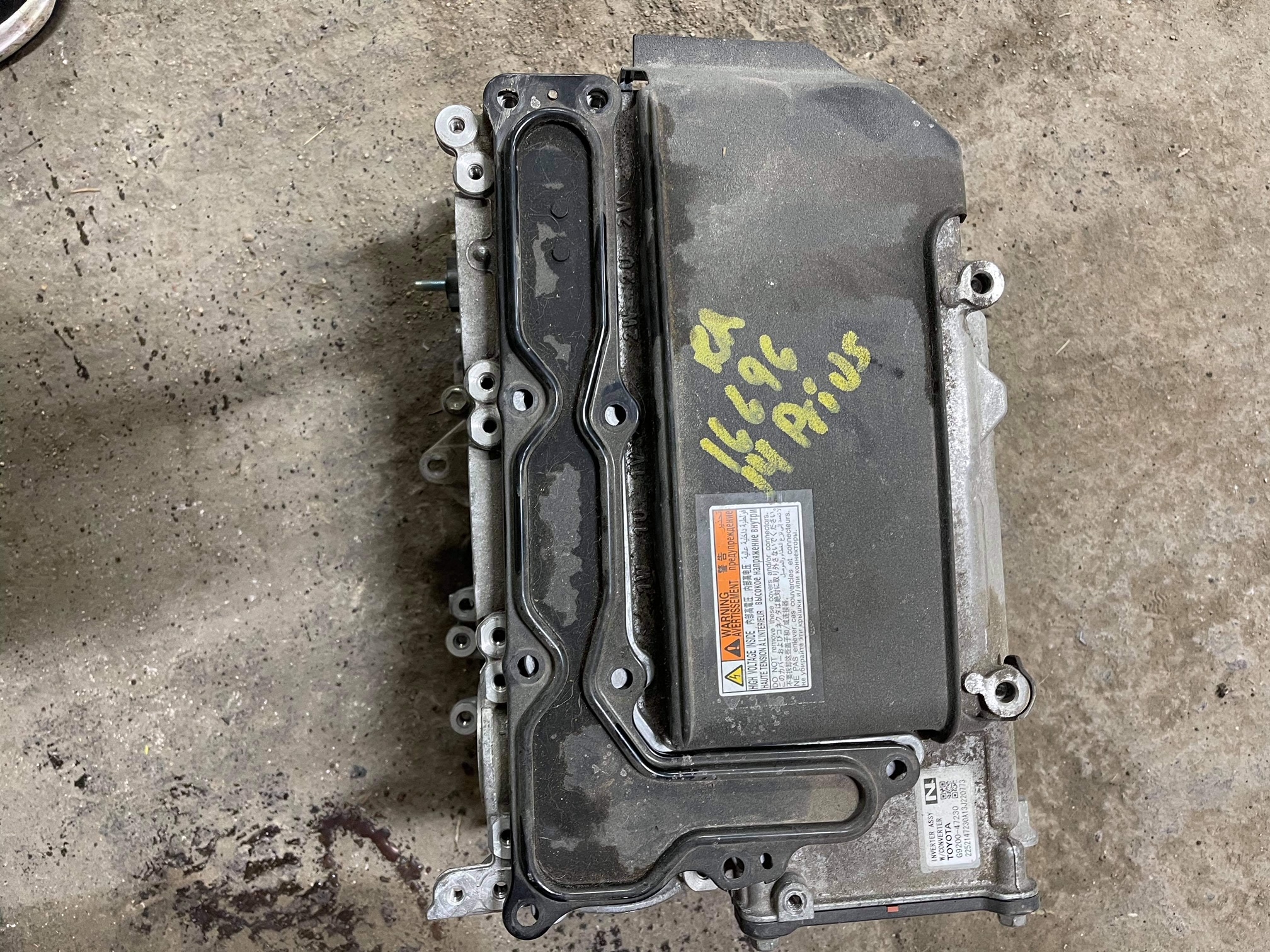

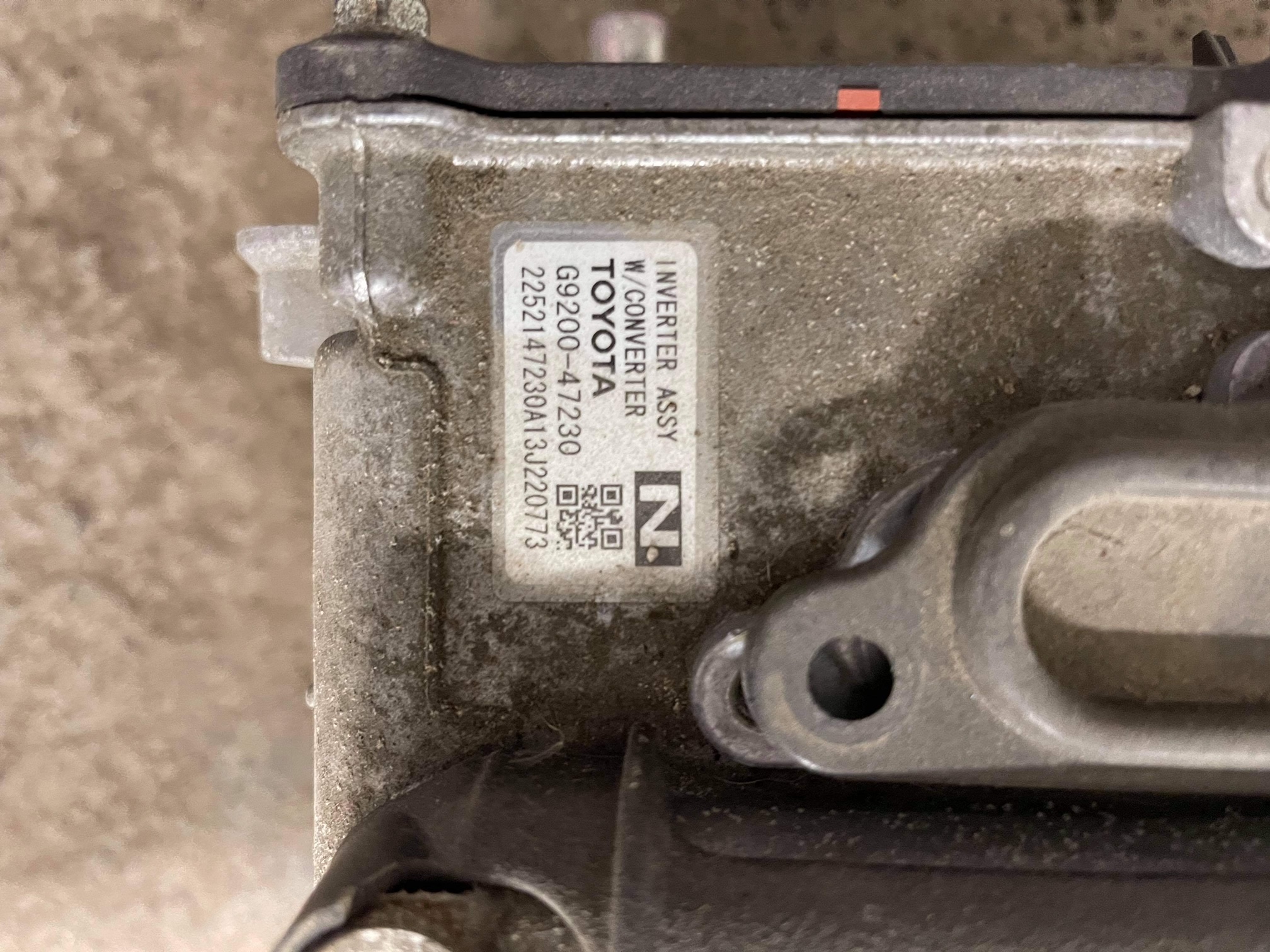

Hello does anyone know if this 2014 Prius inverter P/N (G9200-47230) compatible with the V1c board it not listed on the WIKI under Toyota part numbers. I believe it is just want to confirm before buying. thanks

If I recall correctly, the important numbers are on the control board inside.

I have the same inverter and the v1d small board fits in nicely. Thus, I think that the v1c board is too big.

I've seen this info in other threads as well. 2010-2011 use the "large" boards, everything Gen 3 after that uses the "small" boards originally for the Auris/Yaris. V1D (I believe) is specifically for dual motor where V1C is for single, and they're both available in small and large designs. Single motor will be a bit cheaper.
FWIW, the small board inverters seems a hair cheaper to buy used.
