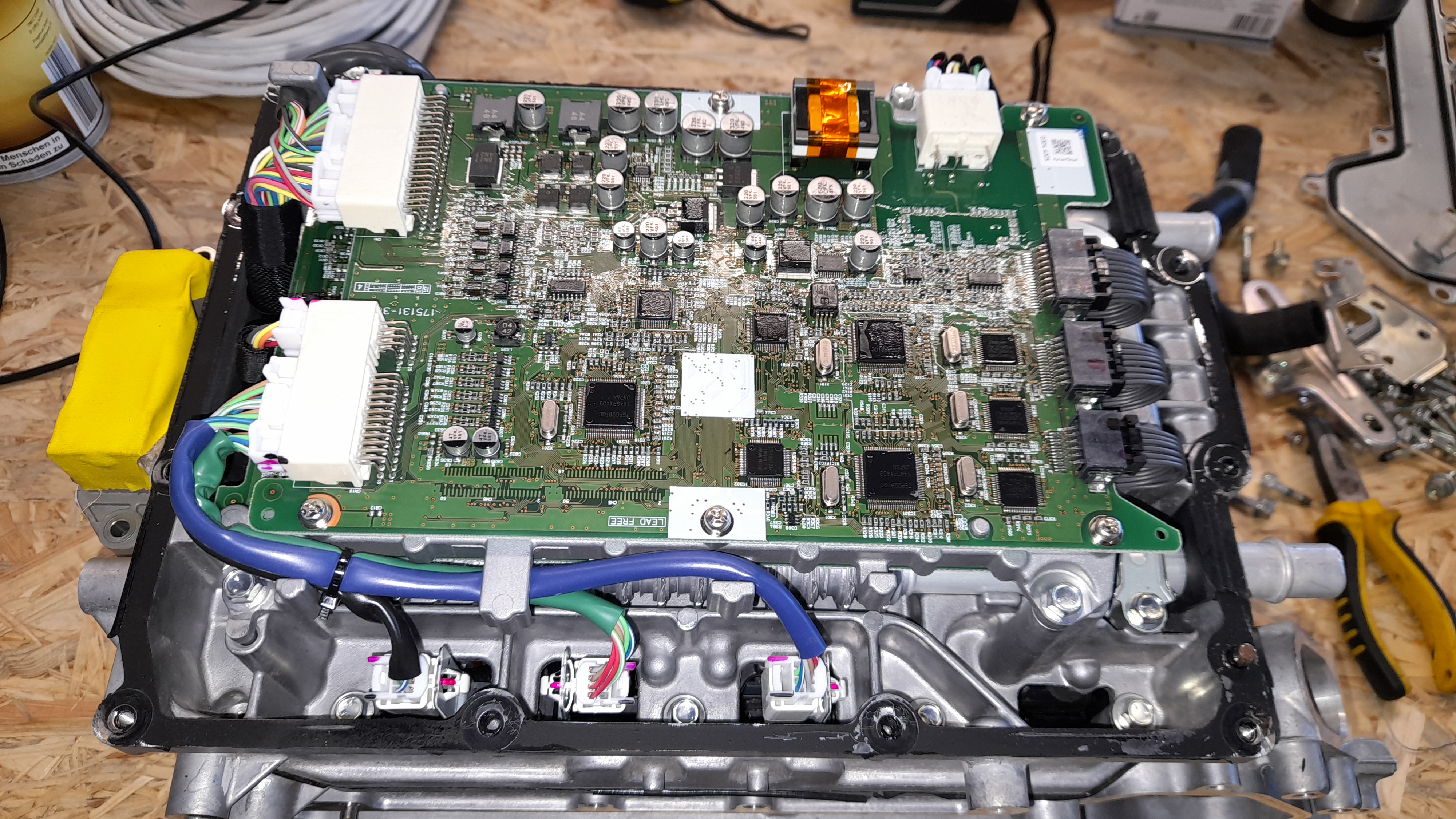

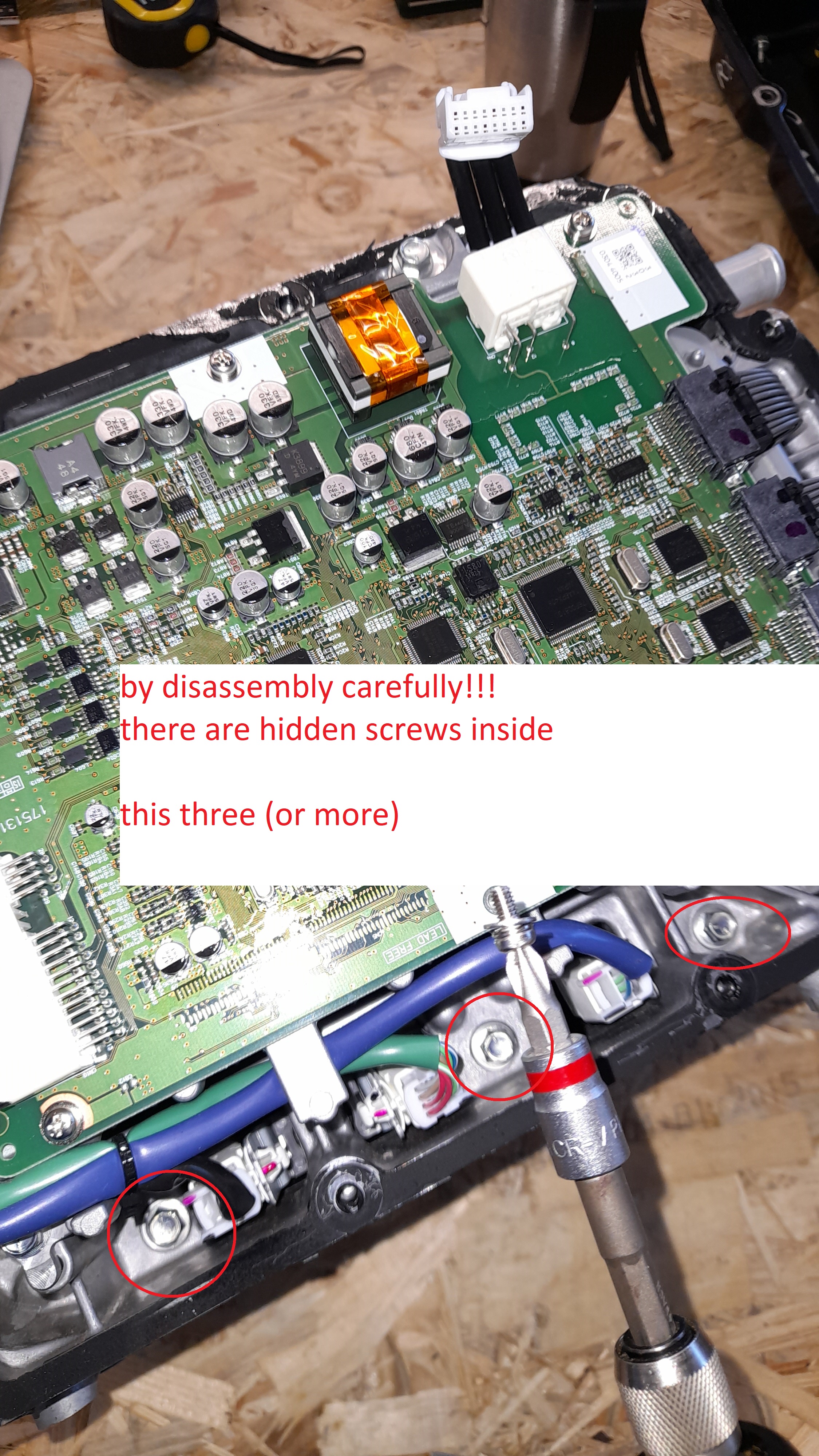

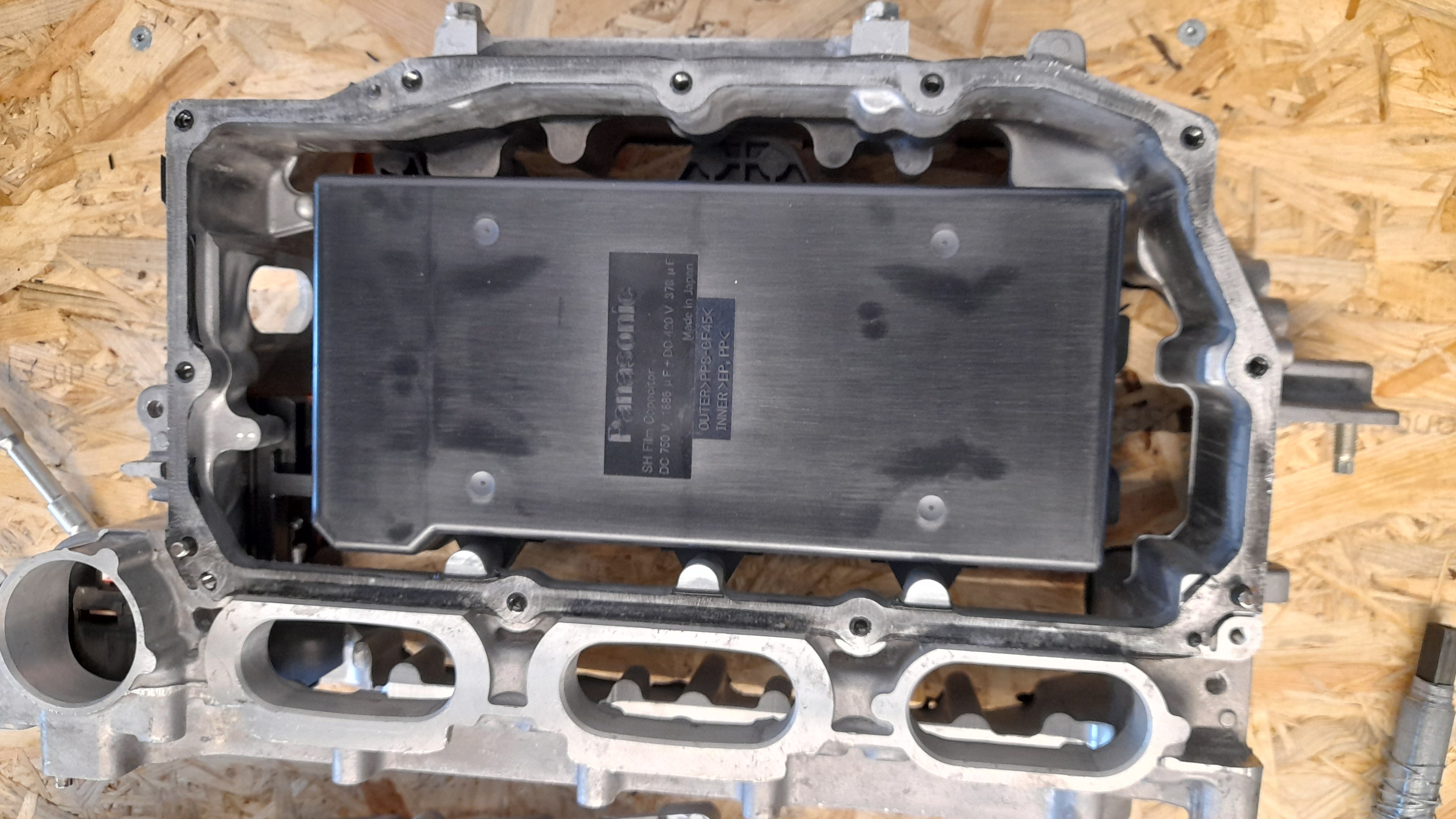

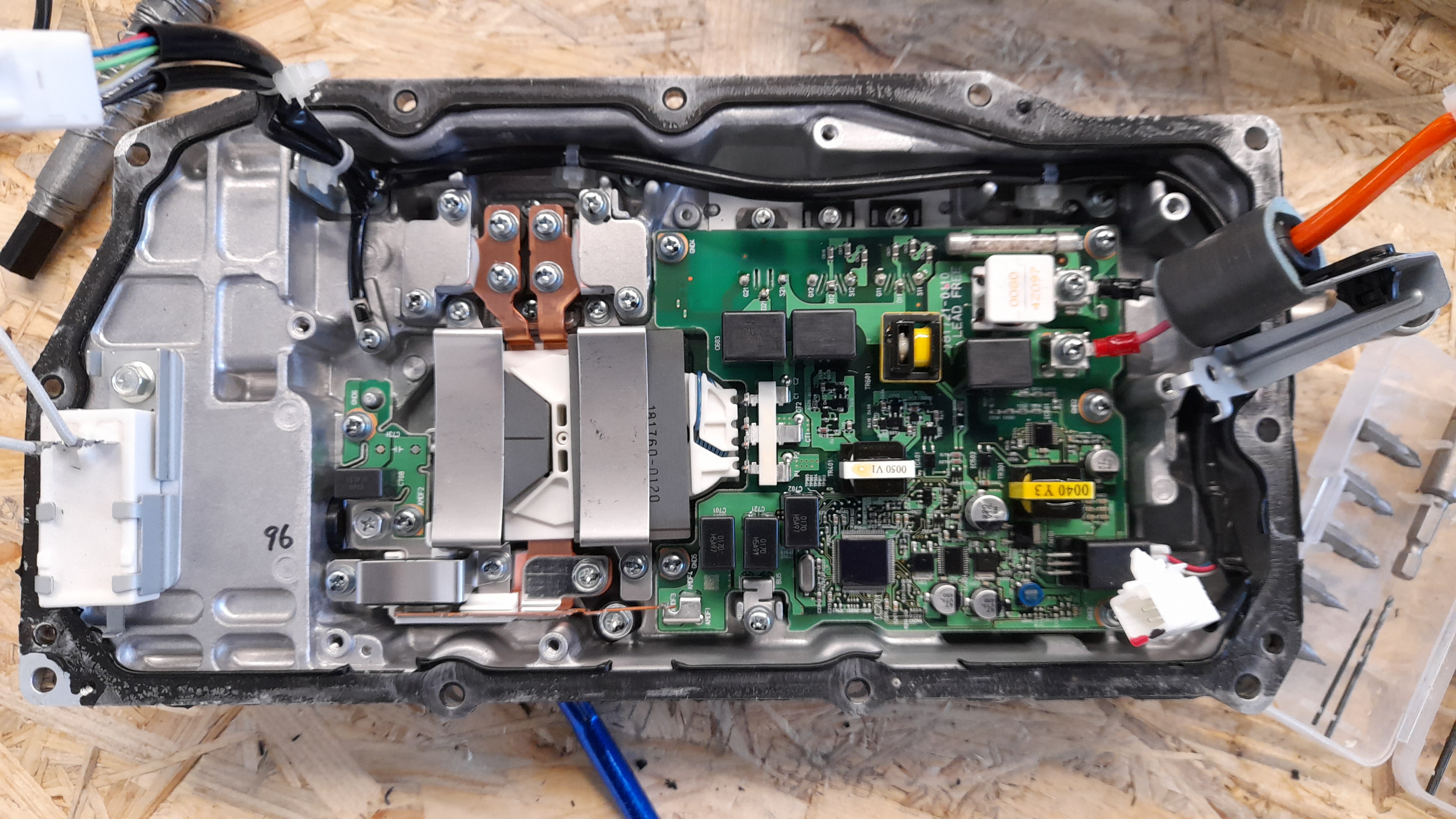

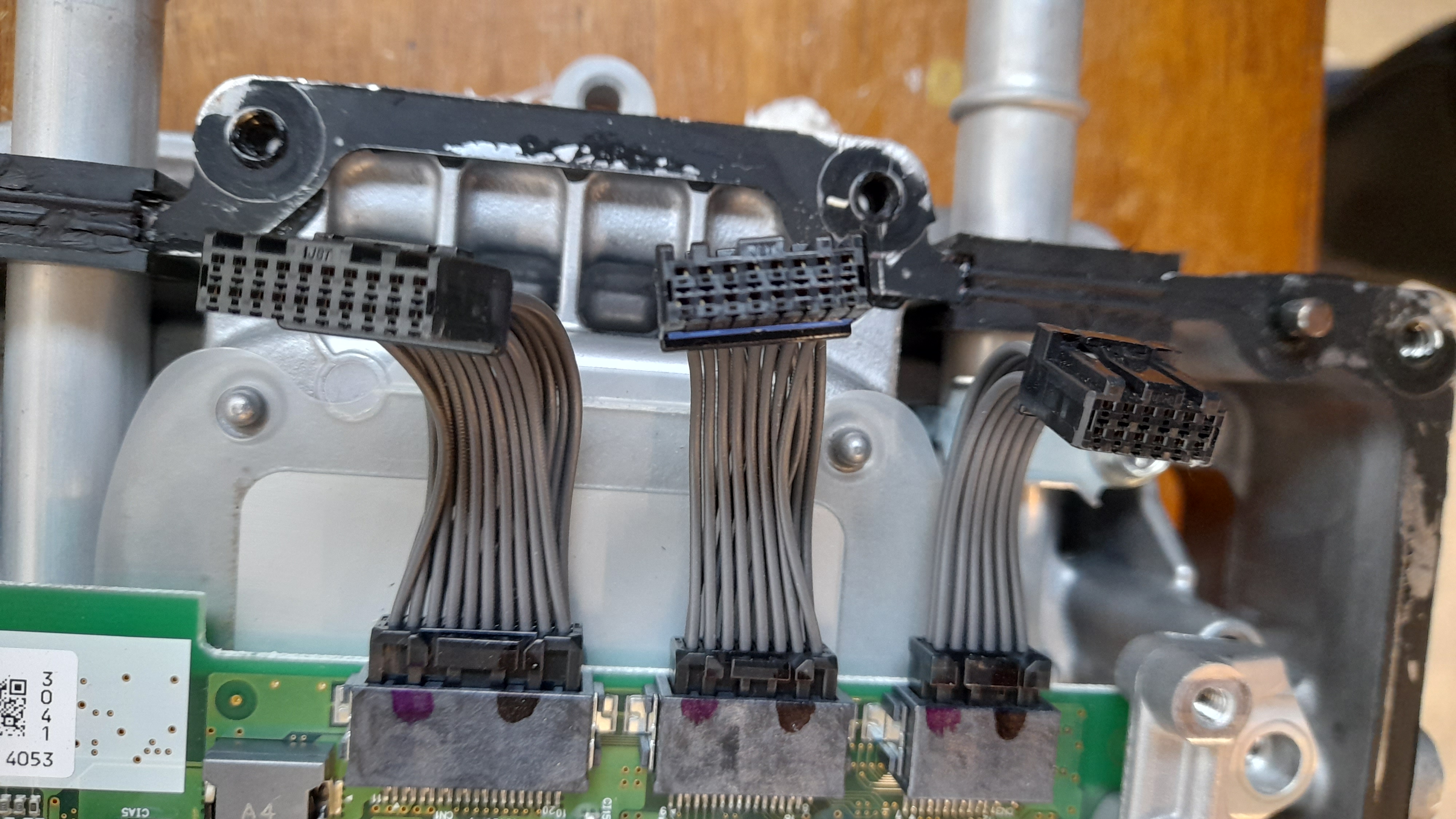

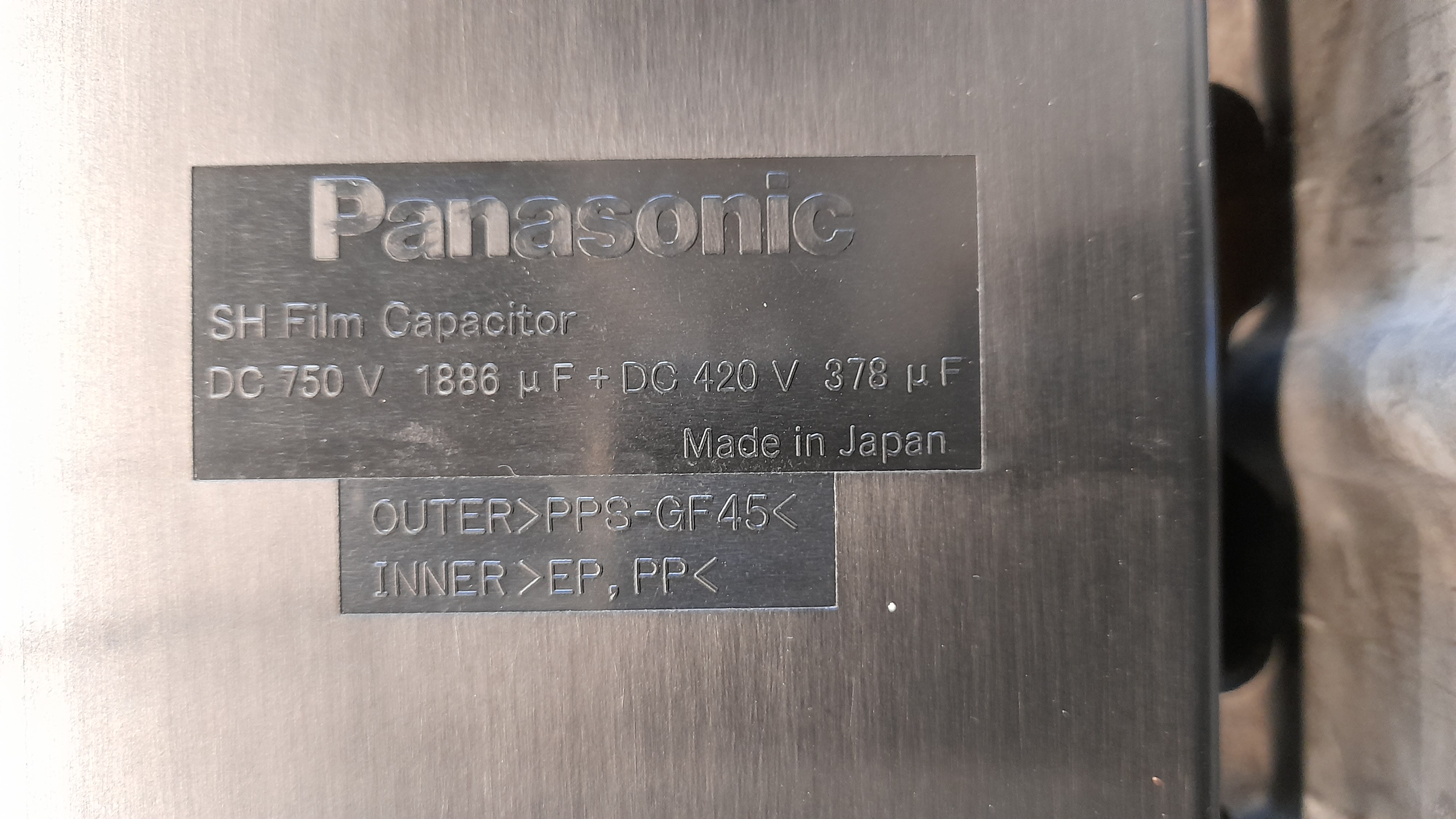

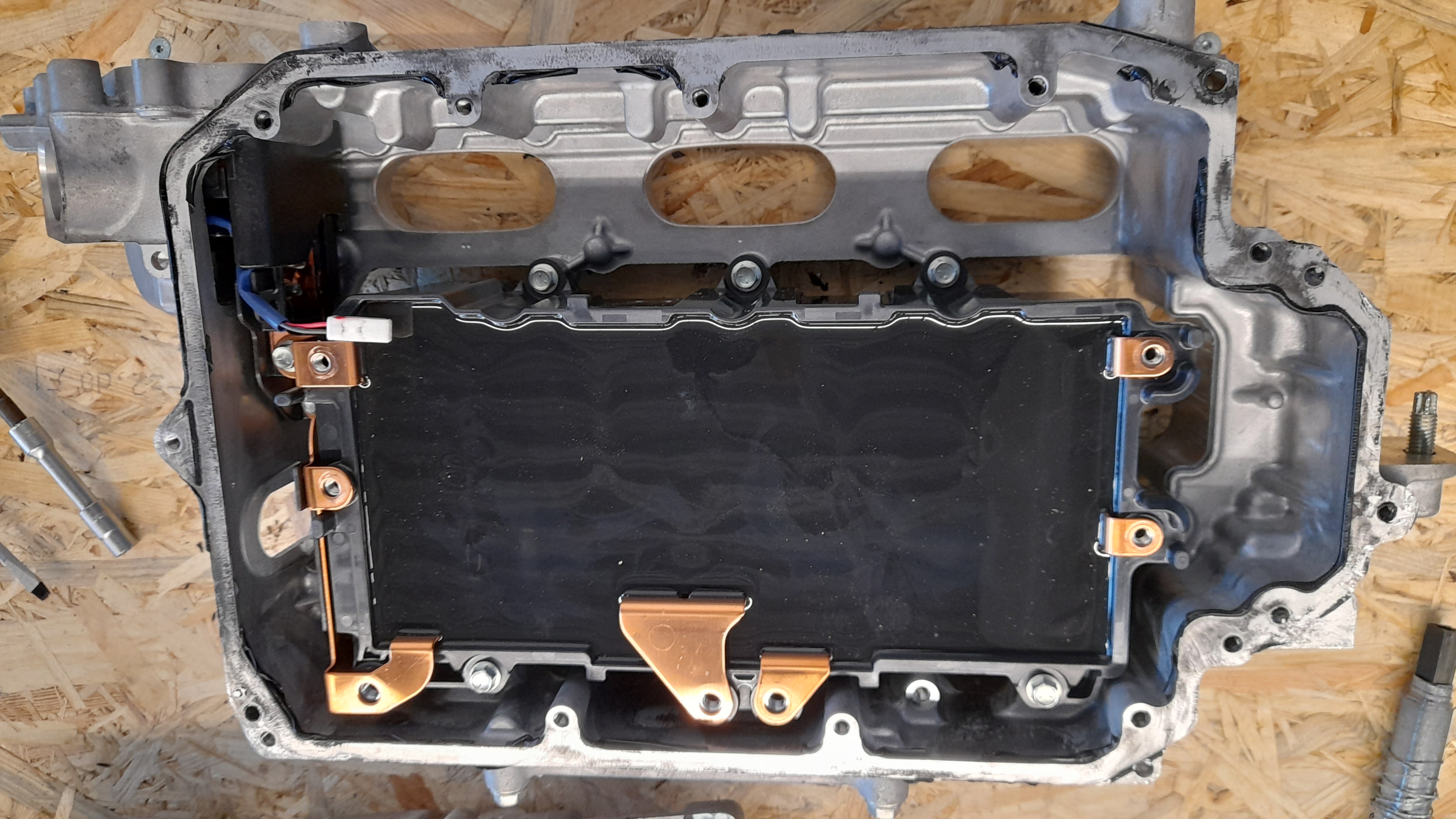

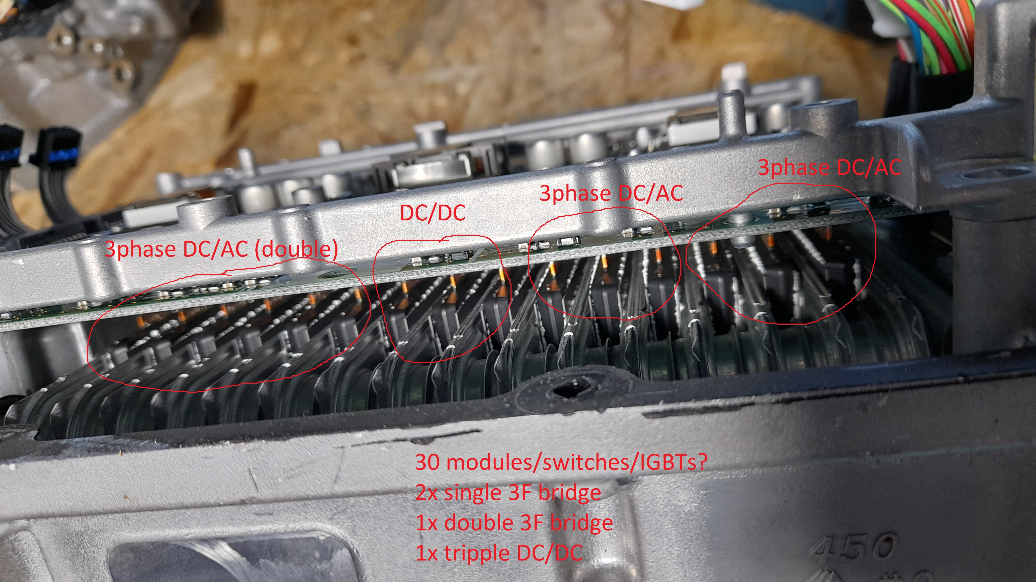

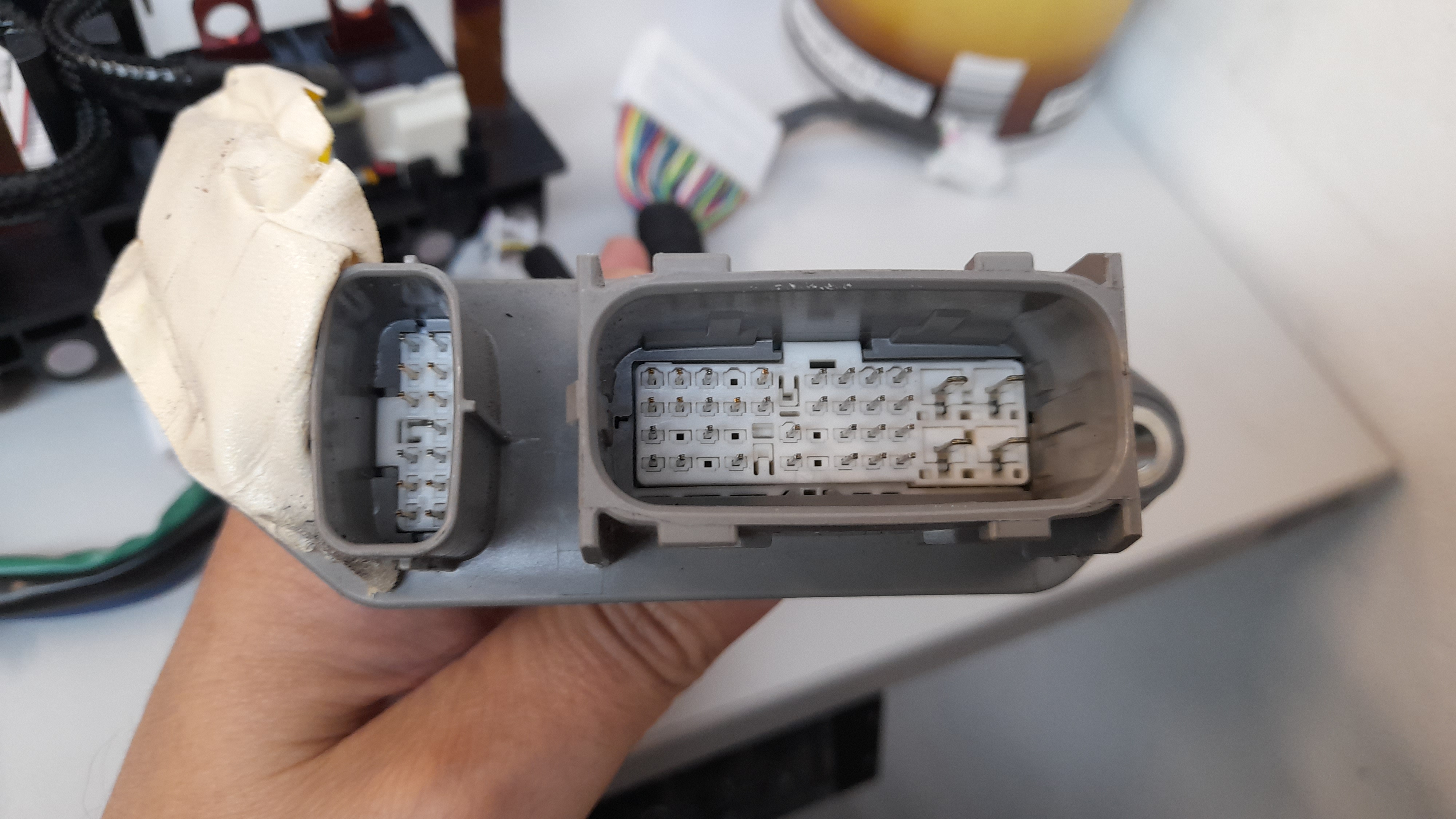

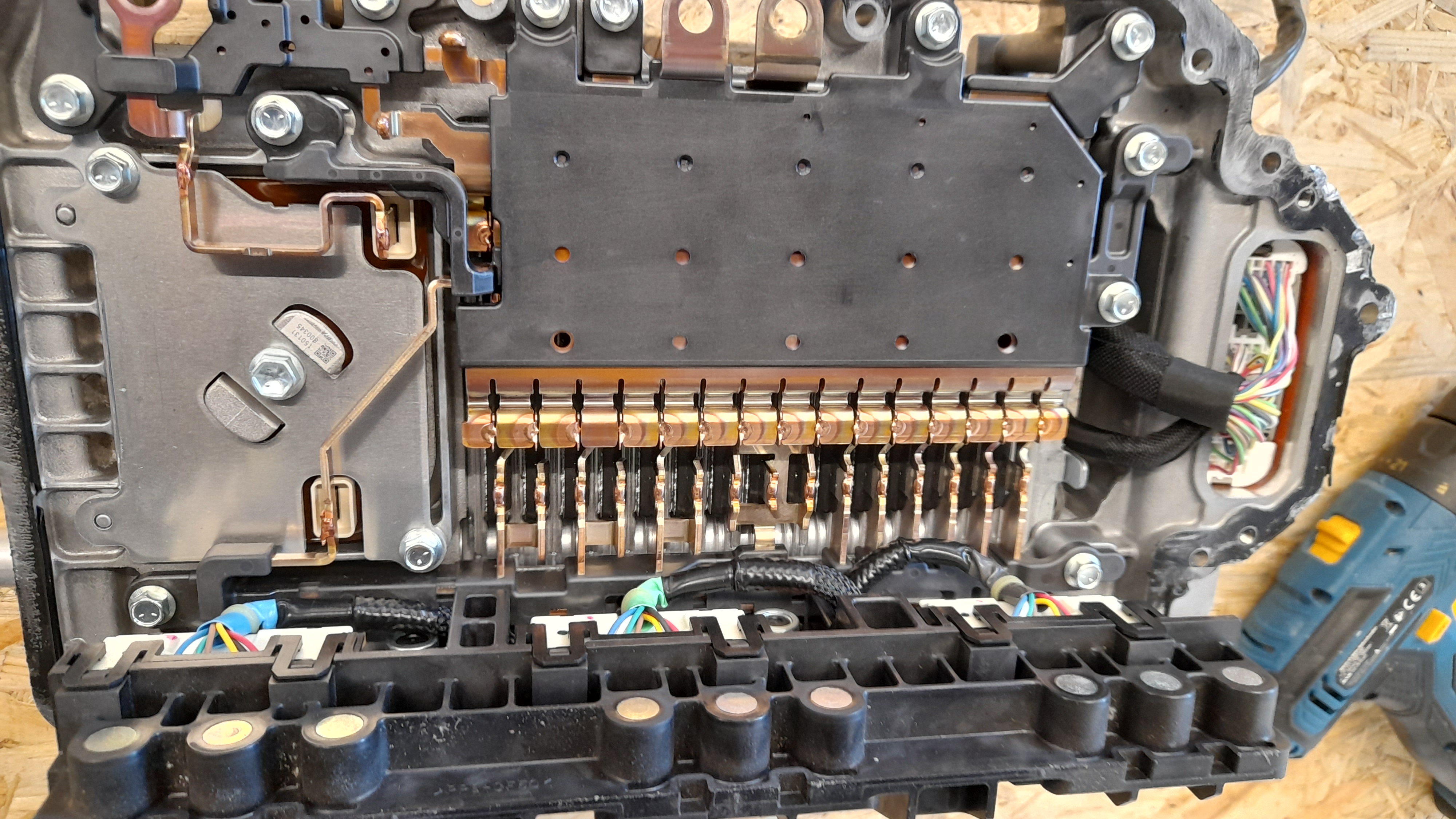

Hi guys. Im sending you a few pictures from disassembly of my RX450H inverter

Hi. Actually Im not sure that I will be able to control rx450h inverter with gs450h VCU. I have to try it! Control signals/pins are looking similar. So I suppouse there is a chance.
