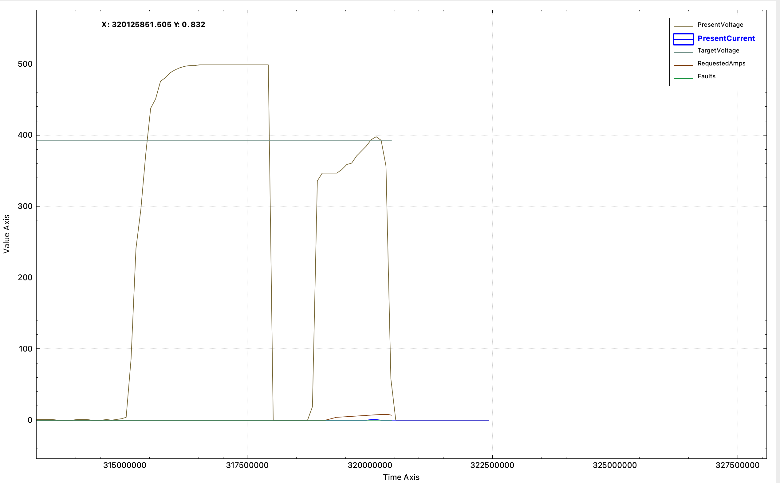

Took a bit of a trip today to test various fast chargers. At first none worked which was down to a quirk in the firmware (needs fixing in inverter firmware also!). With that fixed I tried various stations which did work but then found one that didn't. It's the same 60 kW charger that I have often used in Kirchheim but at a different location close to here.
Basically it would initiate charging including closing the vehicle relay. Now that I think of it the sound was a bit faint but I'm not sure. The environment was quite noisy. Then after quite some wait time it opened the relays again and showed attached error message "TESTVOLTAGE N REACHD (0...04)"
So then I thought I should do a CAN log. Nevermind the BMS messages also in there.
What I saw at first glance was a 135A output capability and then an increasing output voltage that creeped up 474V. Fits the error message quite well. So I wonder whether it failed to actually close the relays and then found itself charging into an open circuit.
Fast charges before and after this worked flawlessly and at full power, so I doubt it has much to do with the car.

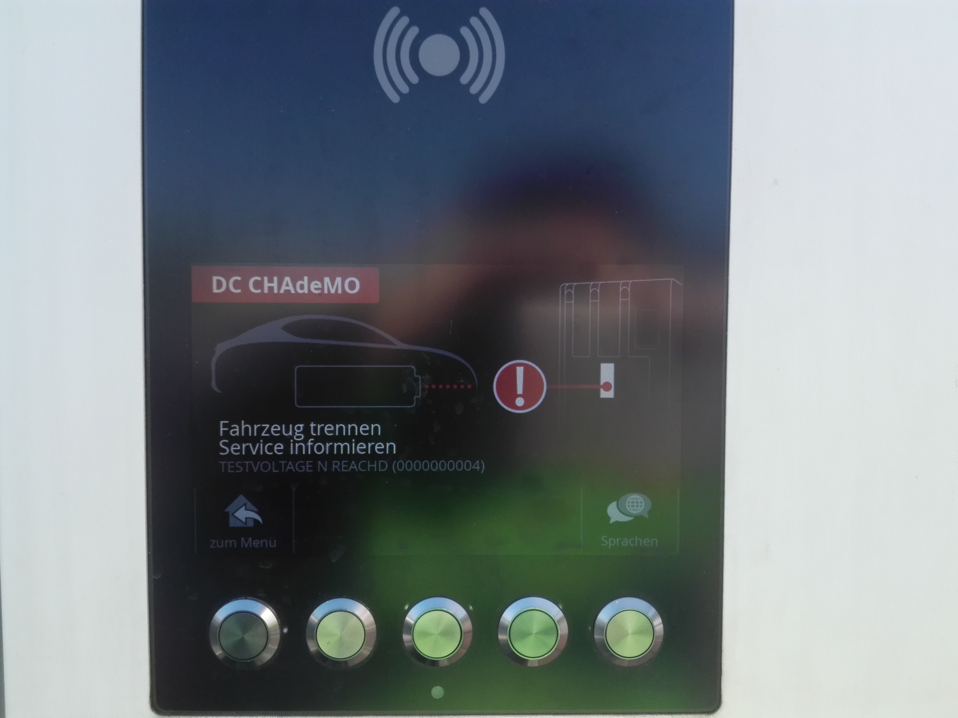

Please take a picture of the type label on the charger for future reference next time you are there.
I would judge it as efacec ?
- Posts: 5791
- Has thanked: 157 times
- Been thanked: 1024 times
Re: CHAdeMO fail (with CAN log)
Will do. Does this help in the meanwhile? https://www.goingelectric.de/stromtanks ... e-1/10838/

I've seen conditions where the voltage flys up to max if the contactors are not closed properly.
- Posts: 5791
So then that's probably what happens. Maybe they ramp up the voltage into the contactor or something stupid like that. The economizer charges up and the relay ends up not closing via just the 40 Ohm resistors.

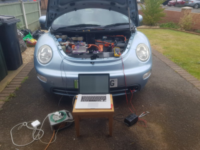

I think this is what is happening with mine, though not sure why, do you mean close then open again. Contactors are Gigavacs with built in economisers.Jack Bauer wrote: ↑Thu Jun 17, 2021 6:30 pm I've seen conditions where the voltage flys up to max if the contactors are not closed properly.
If I put 12v in pin 2 and gnd to 10 and 1 they close with a nice clunk.
At the station I also hear the clunk but there's obviously an issue, I don't hear them open again for at least 10 seconds.
I guess the first rise and fall is a test.09:15:11.824 -> JLD505: 347.265v 0.04A 29.1Ah 0.0kW 9.8kWh OUT1:1 OUT2:1 OUT3:1 IN1:1 IN2:0 CHG T: 52
09:15:11.824 -> CAR: Protocol:2 Target Voltage: 393 Current Command: 4 Target Amps: 50 Faults: 0 Status: 1 kWh: 9.82 Time:0:0:53.8
09:15:11.824 -> EVSE: Measured Voltage: 347 Current: 0 Time remaining: 5400 Status: 101 Time:0:0:53.21
09:15:11.936 -> EVSE: Measured Voltage: 352 Current: 0 Time remaining: 5340 Status: 101 Time:0:0:53.121
09:15:12.048 -> EVSE: Measured Voltage: 359 Current: 0 Time remaining: 5340 Status: 101 Time:0:0:53.221
09:15:12.122 -> EVSE: Measured Voltage: 361 Current: 0 Time remaining: 5340 Status: 101 Time:0:0:53.321
09:15:12.229 -> EVSE: Measured Voltage: 371 Current: 0 Time remaining: 5340 Status: 101 Time:0:0:53.421
09:15:12.303 -> JLD505: 357.567v -0.39A 29.1Ah -0.1kW 9.8kWh OUT1:1 OUT2:1 OUT3:1 IN1:1 IN2:0 CHG T: 53
09:15:12.341 -> EVSE: Measured Voltage: 378 Current: 0 Time remaining: 5340 Status: 101 Time:0:0:53.521
09:15:12.454 -> EVSE: Measured Voltage: 385 Current: 0 Time remaining: 5340 Status: 101 Time:0:0:53.621
09:15:12.530 -> EVSE: Measured Voltage: 394 Current: 1 Time remaining: 5340 Status: 101 Time:0:0:53.721
09:15:12.638 -> EVSE: Measured Voltage: 398 Current: 1 Time remaining: 5340 Status: 101 Time:0:0:53.821
09:15:12.751 -> EVSE: Measured Voltage: 393 Current: 0 Time remaining: 5340 Status: 100111 Time:0:0:53.921
09:15:12.751 -> EVSE:stop charging.
I guess I'm going to need to get even more sketchy and get the lid off my contactor box at the charging station, probably do some more driveway faffing again first.
Do people tend to use the 12v supply from the stations for closing the contactors? A pair of gigavacs will draw 3 or 4 amps to close?

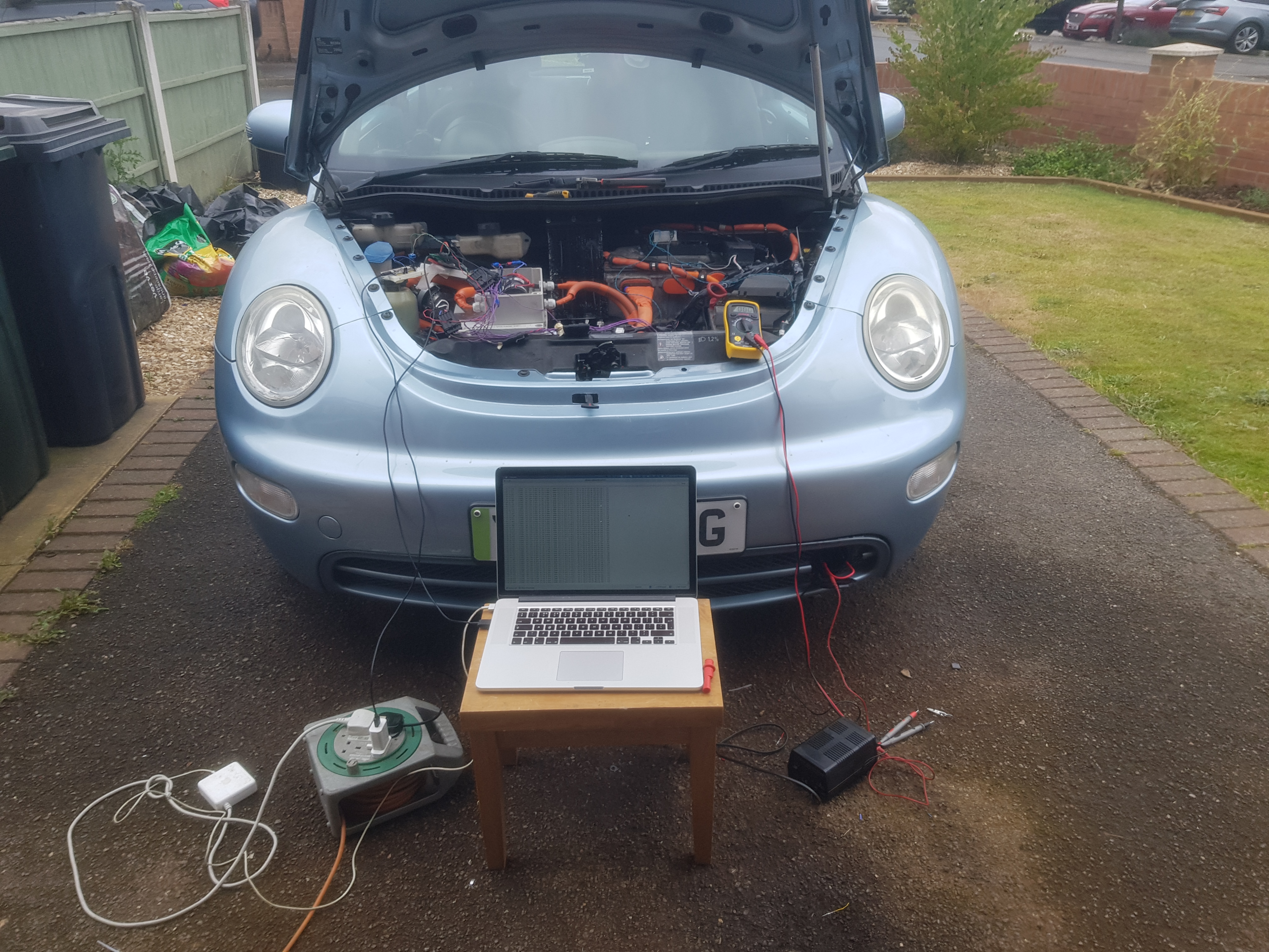

I've rewired so that the contactors are closed with the cars 12v and still the same issue.
Just while I debug, I have the car 12v going to the coils of the contactors and a relay, the MCU is the other side of the coil of the relay (OUT2, open drain)
The Start 1 and Start 2 from the station are just used on the MCU now, IN1 (start 1) active high, IN2 (Start 2) active low.
Happens too fast to monitor with the multimeter, but I put it across one of the contactors in continuity mode and did get a beep, but again the log looks like the contactors don't stay closed.
I had another multimeter on the socket side of the contactors and I saw the voltage climb and above my battery voltage, so it must have been the stations voltage.
Software is https://github.com/Isaac96/CHAdeMOSoftware that numerous other's have used, I've previously had a couple of successes with this setup, but no more.
Contactors stay closed with my 1.5amp 12v supply and savvycan sending out some can messages.
Pretty much out of ideas how to debug further.

Hooked it up at home again, sending can bus messages that match my voltage. Contactors stay closed. I've added code that monitors the internal switch in the contactors now, so will have that info in the log next time. Doesn't make sense, but maybe will narrow down where to look.
