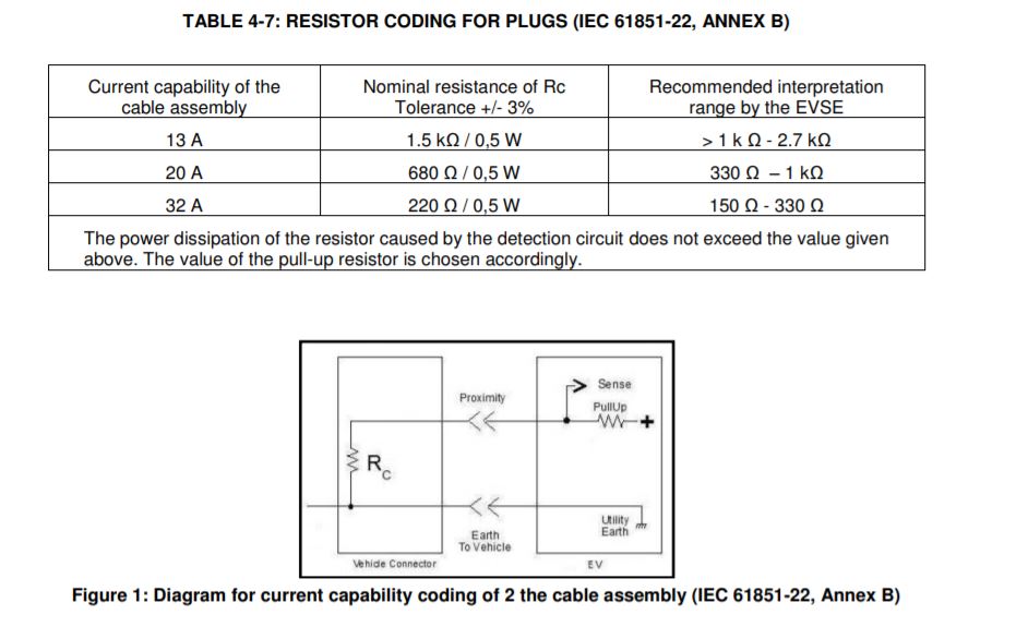

The main question will be will it work with all plugs. Can you measure the resistance of your plug from Proximity to ground?
Re: Simpcharge Always Proximity triggered
Hmm that is short sighted of me!
The resistance was 0ohms from plug Proximity to ground pin on wall plug.
I am not above having a ‘drop in’ resistor for different plugs to start but ideally I’d like a permanent fix.
What is the standard value for type 2 plugs are they not normally 0ohm?
- Posts: 2962
- Has thanked: 330 times
- Been thanked: 847 times
Here is a graphic with all the info on the resistances allowed on the type 2 proximity to ground.
Boy am I relieved!
I managed 0.5amps for 1 minute before I chickened out!
Thank you for your help!
