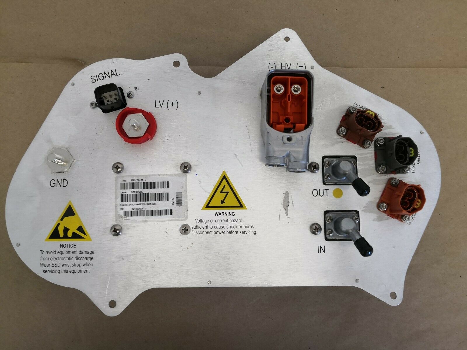

HI i am building a Toyota
mr2 mr2 1990 i am wiring it up at the moment ,i looking for pin out data for dc/dc unit .any help please .

tonyferrell wrote: Tue May 25, 2021 7:13 pm HI i am building a Toyotas-l1600.jpg mr2 mr2 1990 i am wiring it up at the moment ,i looking for pin out data for dc/dc unit .any help please .
I am using the same converter. Pin assignment and CAN massages can be found here.
viewtopic.php?p=22219#p22219
The battery heating in the tesla is controlled with this converter via CAN, with the later models it is a PWM signal
