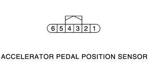

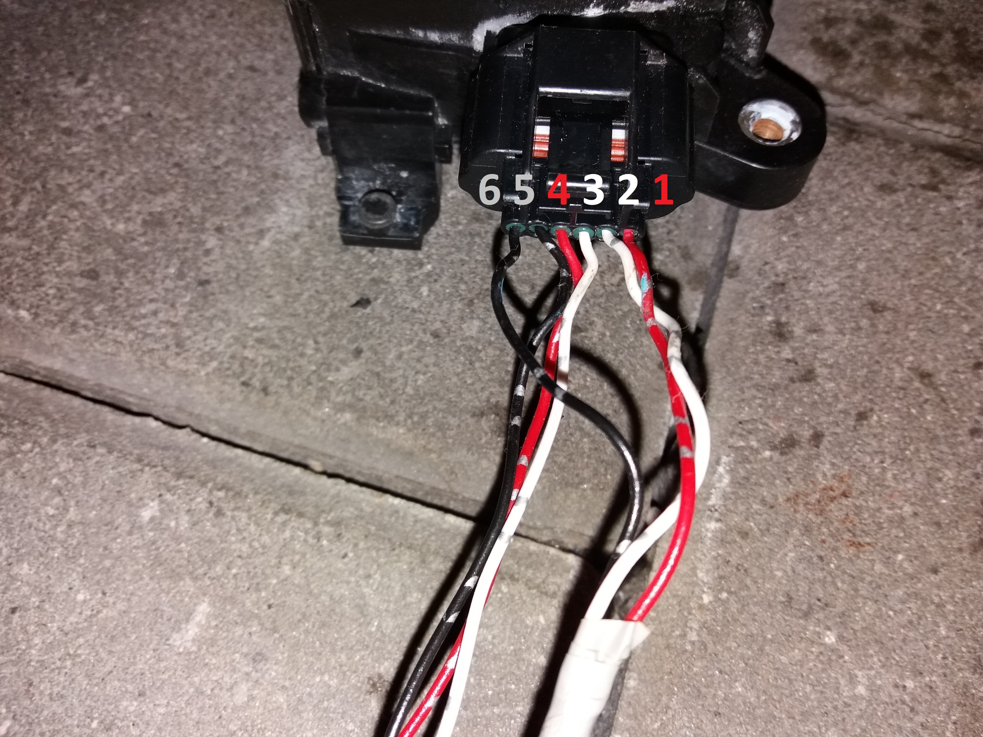

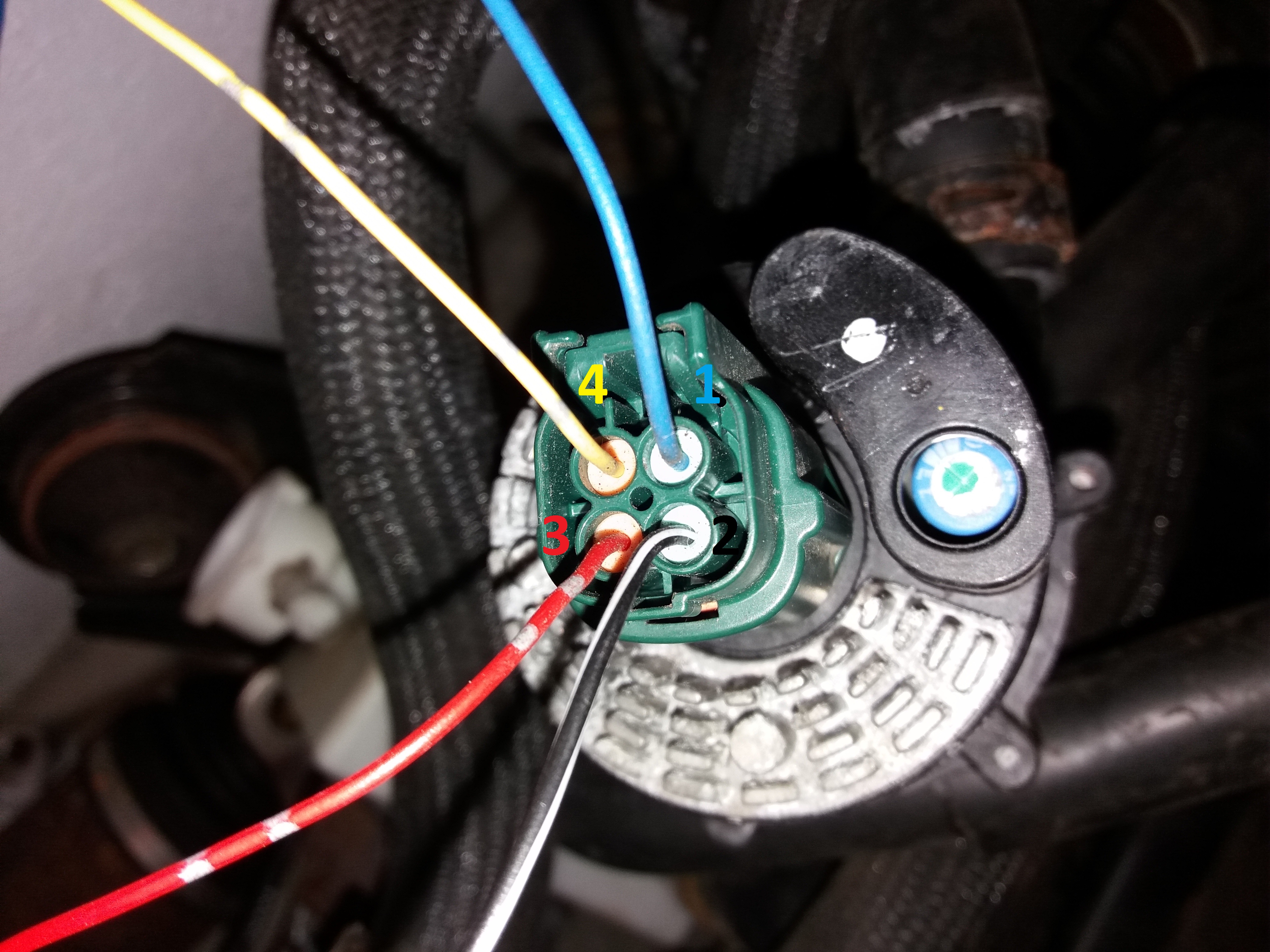

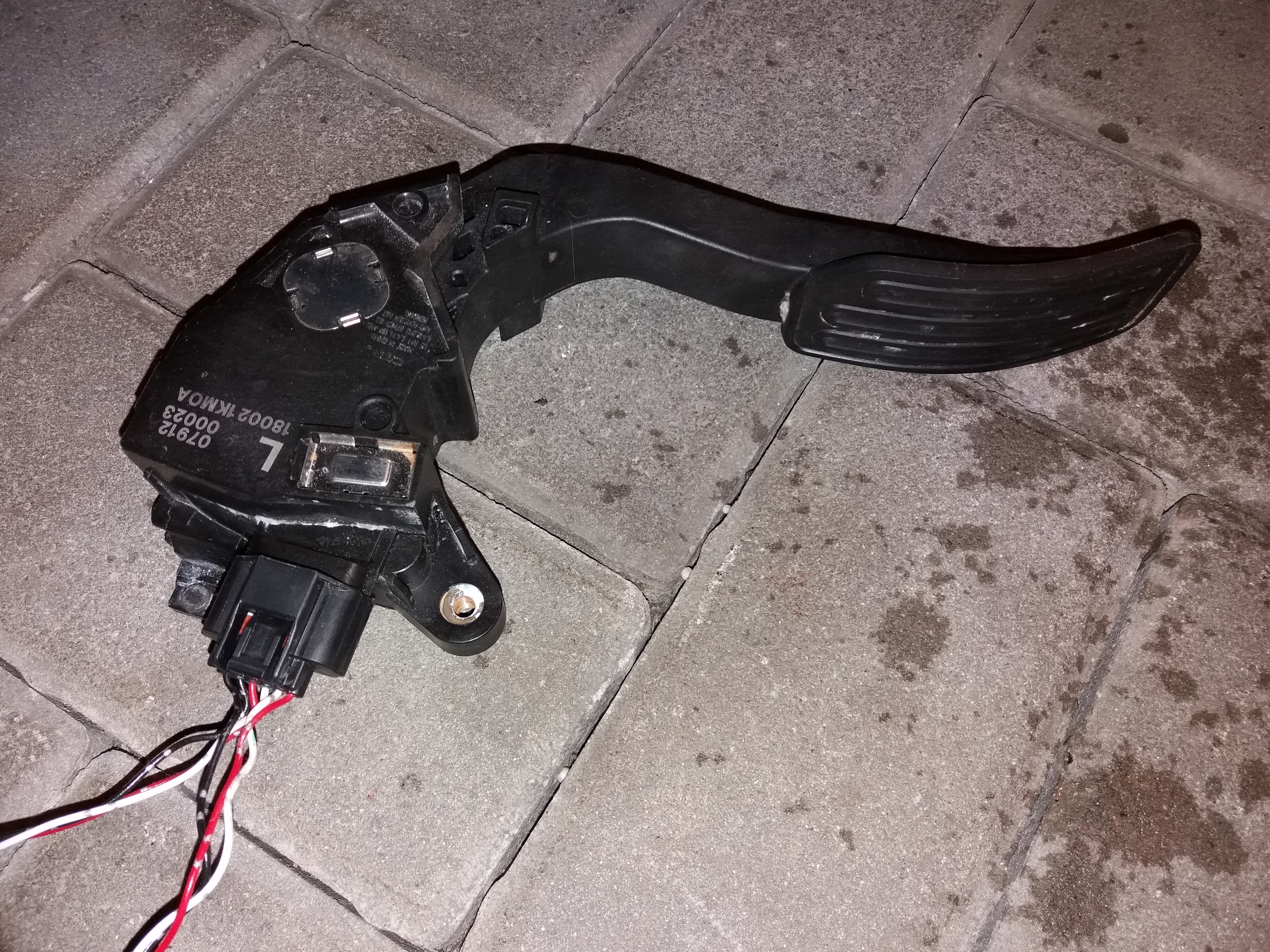

Do you know how to connect a acceleration pedal from Leaf I ?
Which pin is: +5V, -5V, sig 1, sig 2

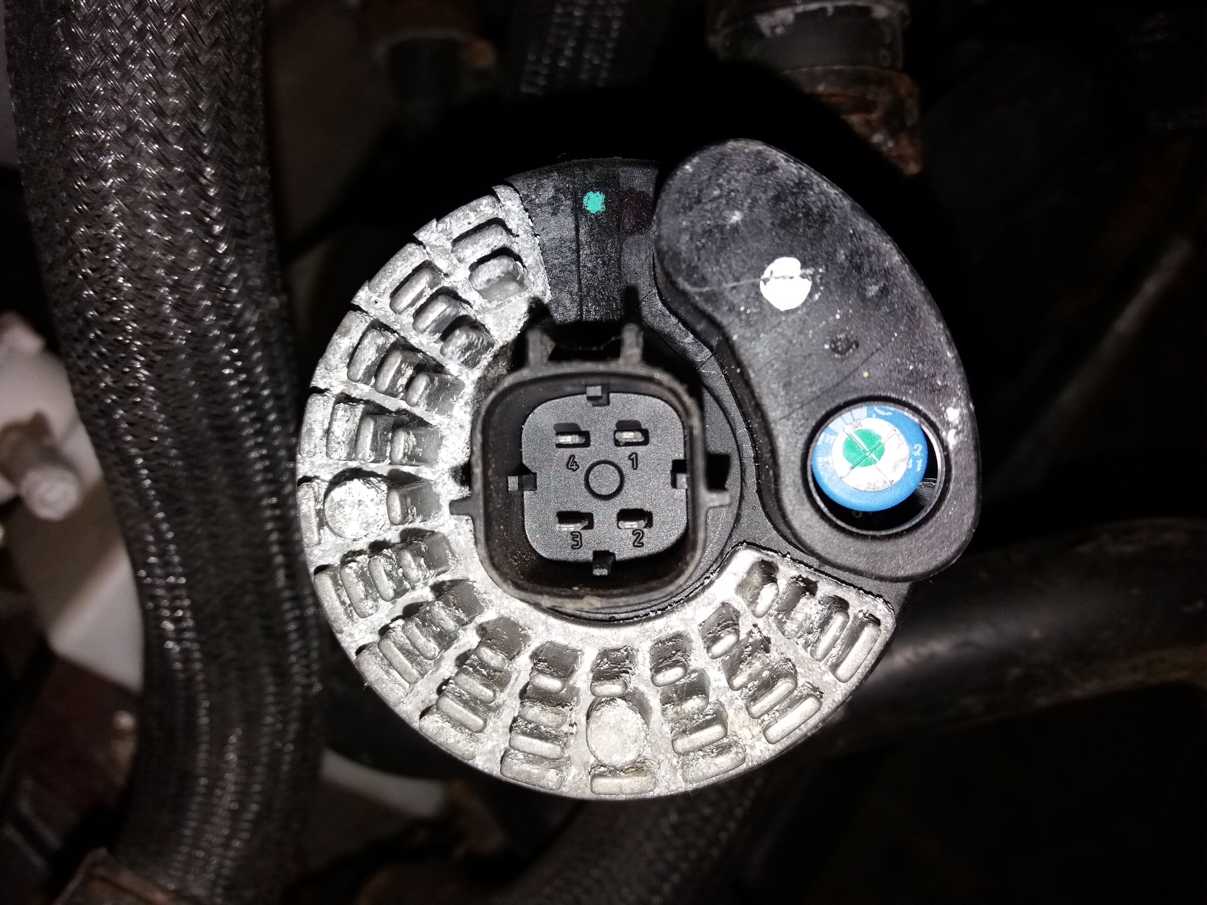

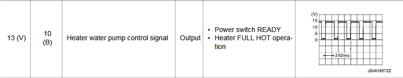

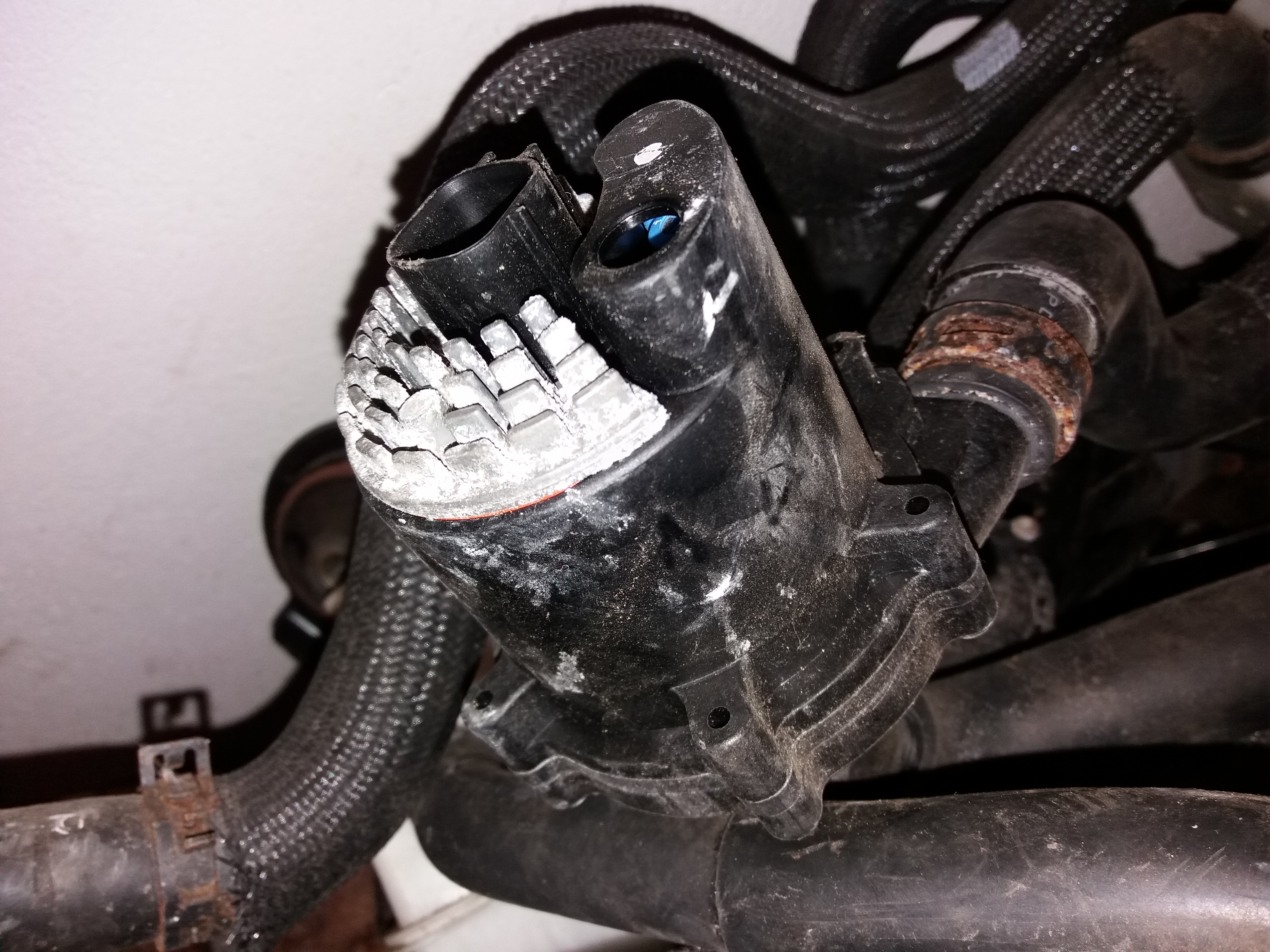

Do you know where I can find pin diagrams for Leaf I, for example liquid pumps ?

Hi!
I that's the nissan leaf water pump right. I've got my schematics at home, but just try connecting +12 mad ground to two of the ports untill it works. That's what I did

Post by damian.lo »

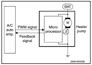

I have the same pump in my spare parts. It isn't PWM steering like on picture below?
PWM pump.jpg (18.23 KiB) Viewed 8755 times

Re: Throtle 5v
Post by PoloLbricolo »
The pump is pretty easy to drive. I'm not next to my my car so i cannot check to be 100% sure but you need to connect 2 wires together and apply 12V to the other 2. I tried every combination possible and it worked. The pump has a soft start and it will stop after 5 or 10 minutes if it doesn't have liquid flowing.
Given your picture i would connect yellow and blue together, +12v to red and ground to black.

Daniel wrote: Sat Dec 14, 2019 6:10 pm Do you know how to connect a acceleration pedal from Leaf I ?
Hi Daniel, did this part of the question ever get answered? I would like to use the original Leaf 1 throttle pedal with Damien’s VCU and it needs these 4 outputs to operate.

Post by james@N52E01 »

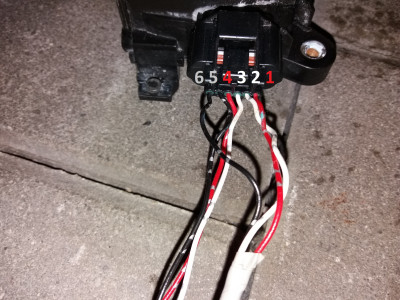

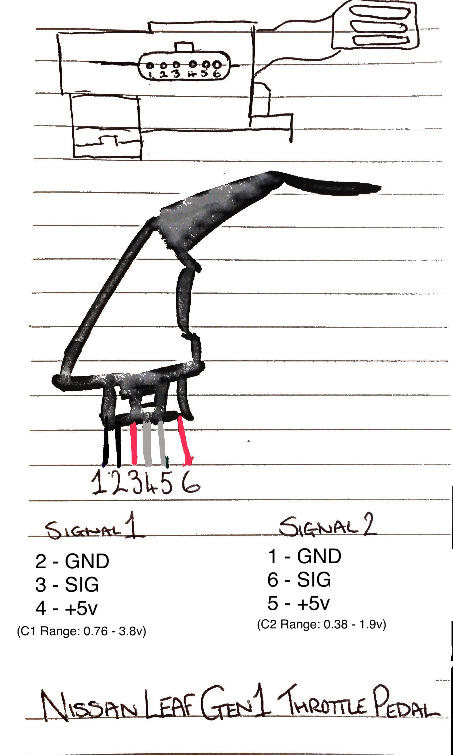

Just done a quick bit of testing. No idea what the reference figures should be but there was a slight difference in output voltage range between the two signals. Anyway here’s the results. Quality sketching I know...
Edit: sketch updated to correct values. See below.

james@N52E01 wrote: Sun Jan 26, 2020 6:18 pm

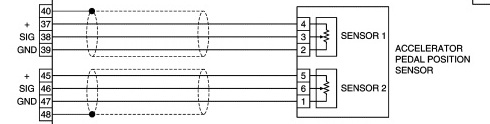

james@N52E01 wrote: Tue Jan 28, 2020 7:53 pm Just done a quick bit of testing. No idea what the reference figures should be but there was a slight difference in output voltage range between the two signals. Anyway here’s the results. Quality sketching I know...

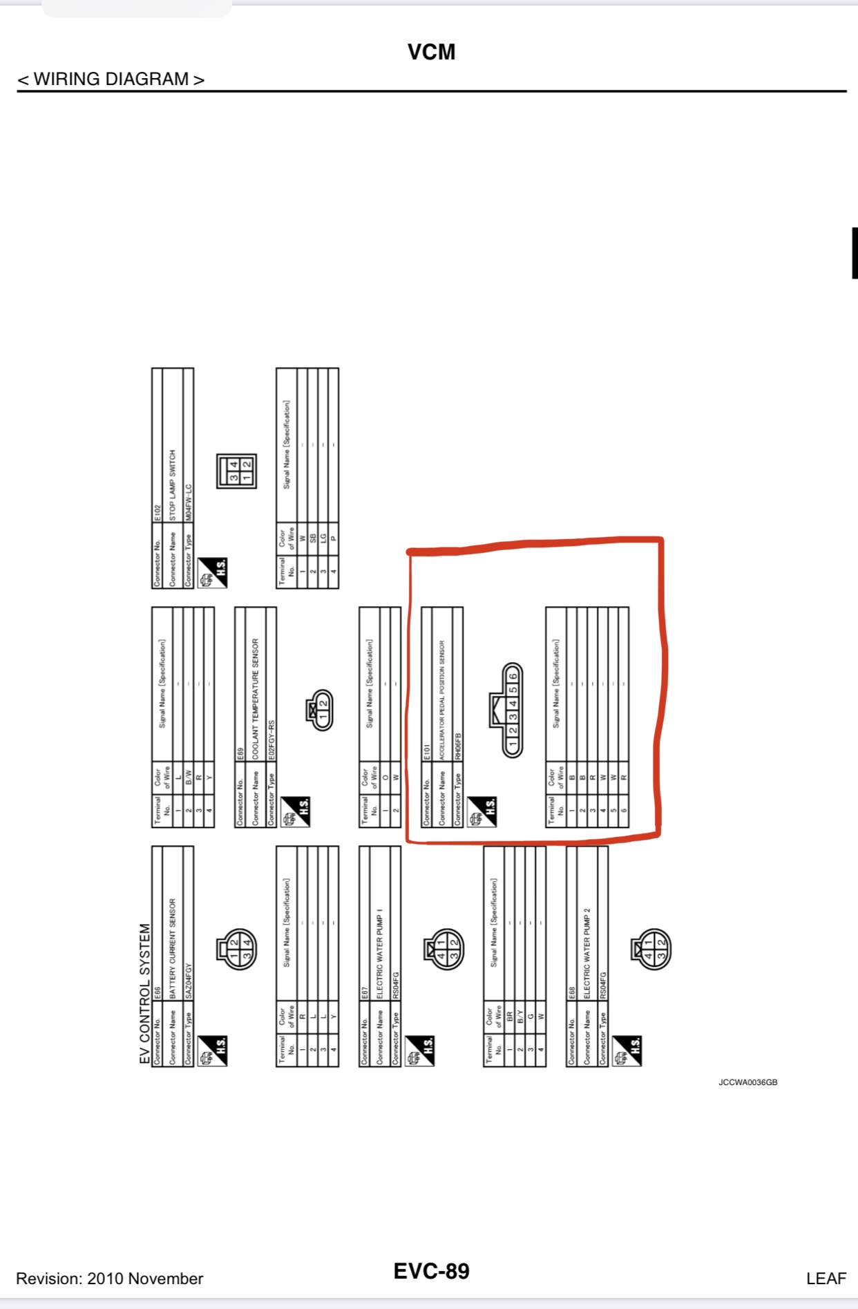

You made a mistake:
Correct connection:
1 -GND
5 - 5V
6 - Signal

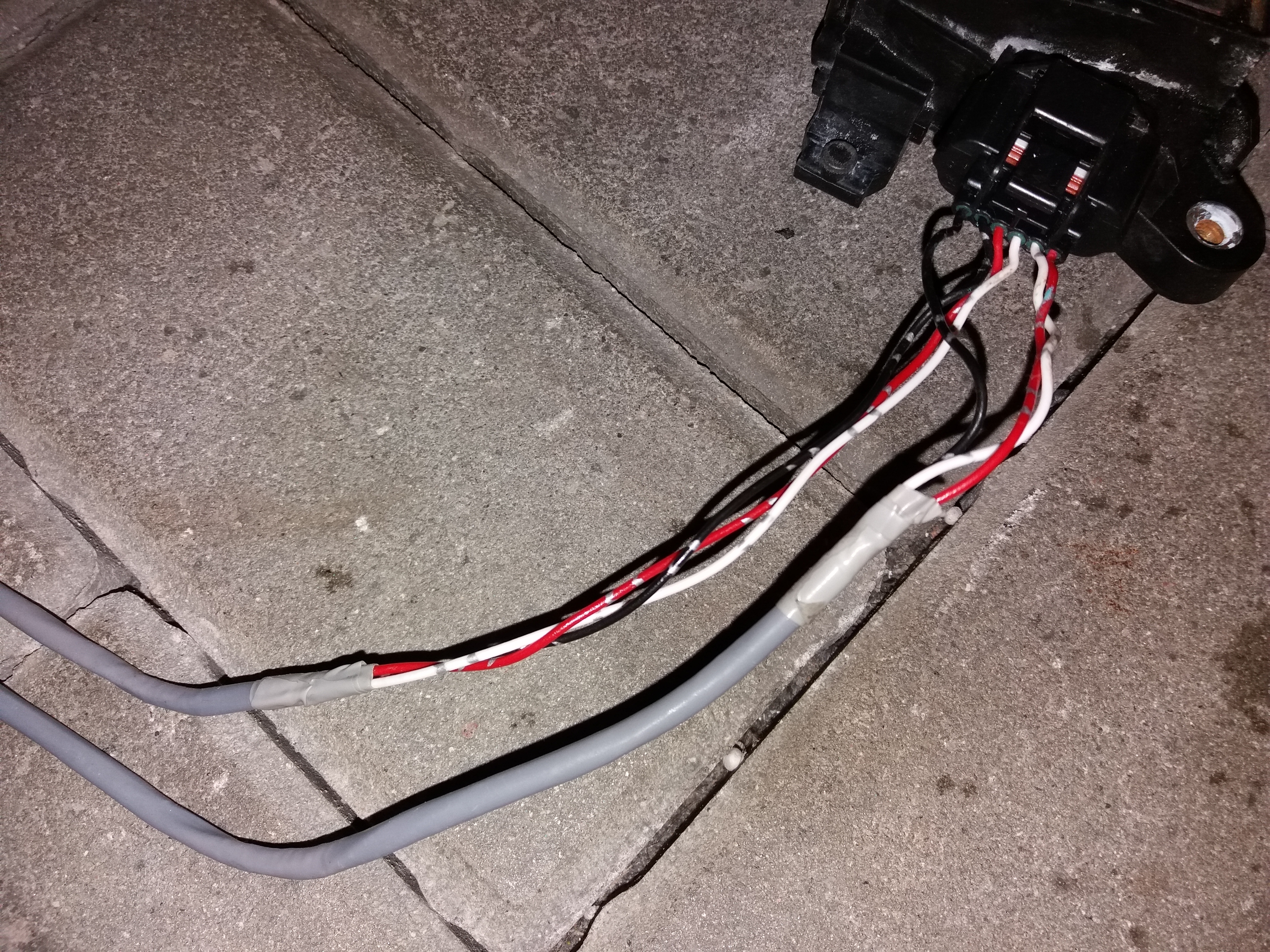

james@N52E01
Posts: 144
Joined: Wed Sep 18, 2019 7:02 am
Re: Throtle 5v
Daniel wrote: Wed Feb 26, 2020 8:11 pm
You made a mistake:
Correct connection:
1 -GND
5 - 5V
6 - Signal
With respect Daniel mate I don’t think I have. My drawing’s crap I admit, but the testing worked and I’ve just double checked the wiring colours match the information in the Leaf’s EVC manual (I used green for SIG in stead of white). Are you sure you have the numbering oriented correctly? Hopefully it’s clear in my diagram. Feel free to post your results and how you got to them so we can compare.
Daniel
Posts: 24
Joined: Thu Nov 21, 2019 7:21 pm
Location: Poland
Re: Throtle 5v
Post by Daniel »

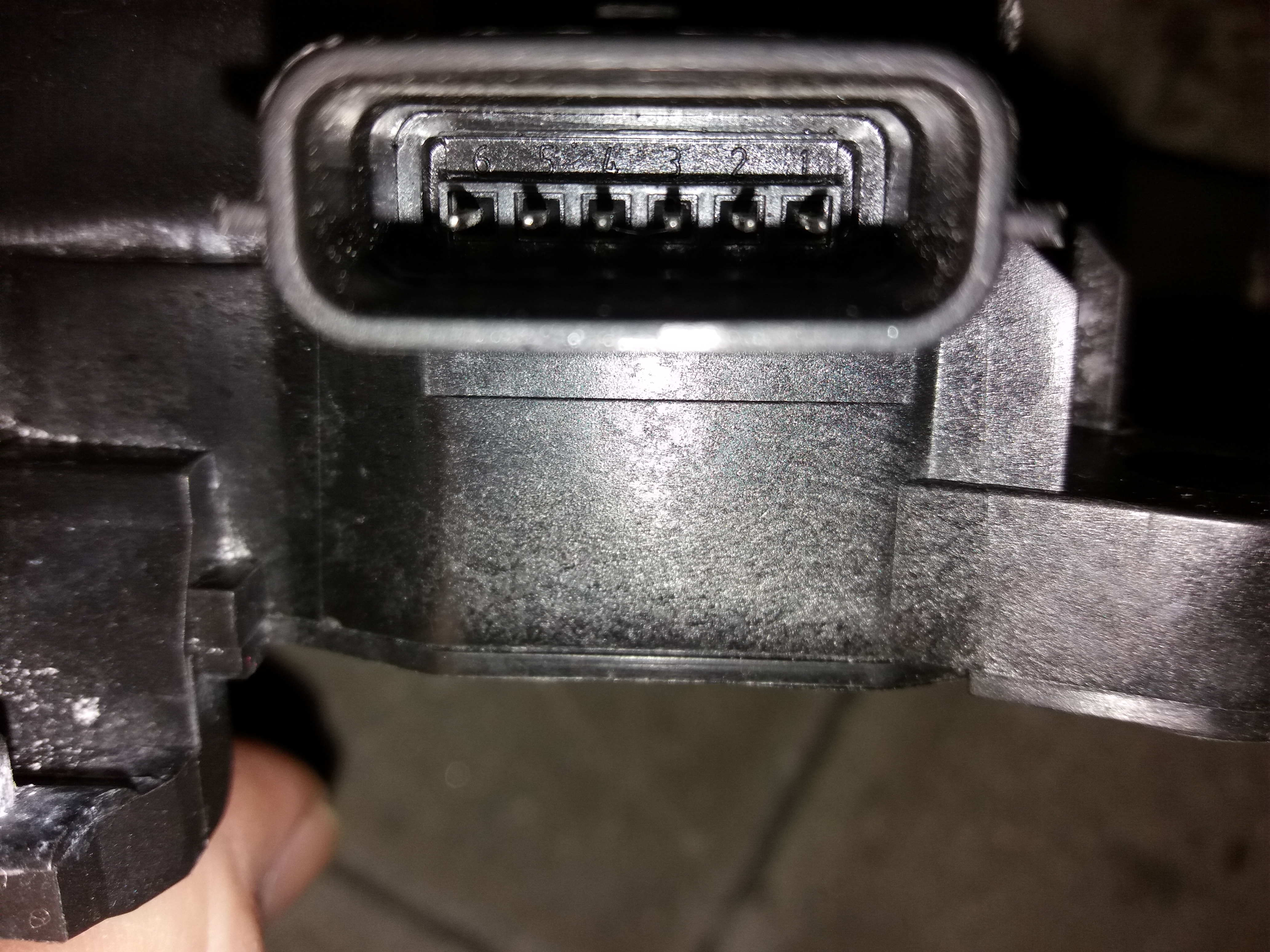

james@N52E01 wrote: Thu Feb 27, 2020 6:23 am With respect Daniel mate I don’t think I have. My drawing’s crap I admit, but the testing worked and I’ve just double checked the wiring colours match the information in the Leaf’s EVC manual (I used green for SIG in stead of white). Are you sure you have the numbering oriented correctly? Hopefully it’s clear in my diagram. Feel free to post your results and how you got to them so we can compare.
Look at the plug from the front, not the numbers on the accelerator pedal
james@N52E01
Posts: 144
Re: Throtle 5v
IT looks like the schematic you are using from the TCS manual shows the pin layout for the plug in the EVC manual (same as I drew in my sketch) which goes from the controller to that socket on the throttle pedal where the numbering system is reversed. It looks like the the white wires then are permanent 5v and the red ones are signal wires... ? Even stranger, when I test the signal output with permanent 5v attached to the white wires and signal from the red, I get a range of 0.76-3.8v on C1 and 0.38 - 1.9v on C2. Maybe I have a knackered pedal. Have you done any testing with your throttle pedal? What results did you come up with?

james@N52E01 wrote: Fri Feb 28, 2020 11:57 am Even stranger, when I test the signal output with permanent 5v attached to the white wires and signal from the red, I get a range of 0.76-3.8v on C1 and 0.38 - 1.9v on C2. Maybe I have a knackered pedal. Have you done any testing with your throttle pedal? What results did you come up with?
James
I just did a check on my Gen 1 Leaf pedal in case you thought your pedal was on the fritz and the numbers match up
C1 0.8v - 3.9v
C2 0.4v - 1.95v
Anyone know what the relation between them and the ThrotVal values here in Damiens Leaf VCU code? The values 145,620 are from the E46 pedal he uses in the Goose. E46 signal o/p from having a search are C1 1.64v - 4.64v and C2 0.8v to 3.8v, the latter being the same as the Leaf and Johannes' Touran pedal. Just want to be sure I calibrate the Leaf pedal correctly.

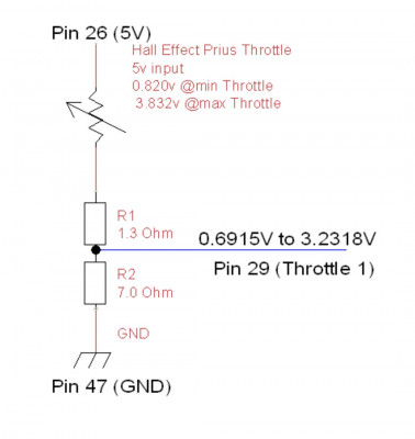

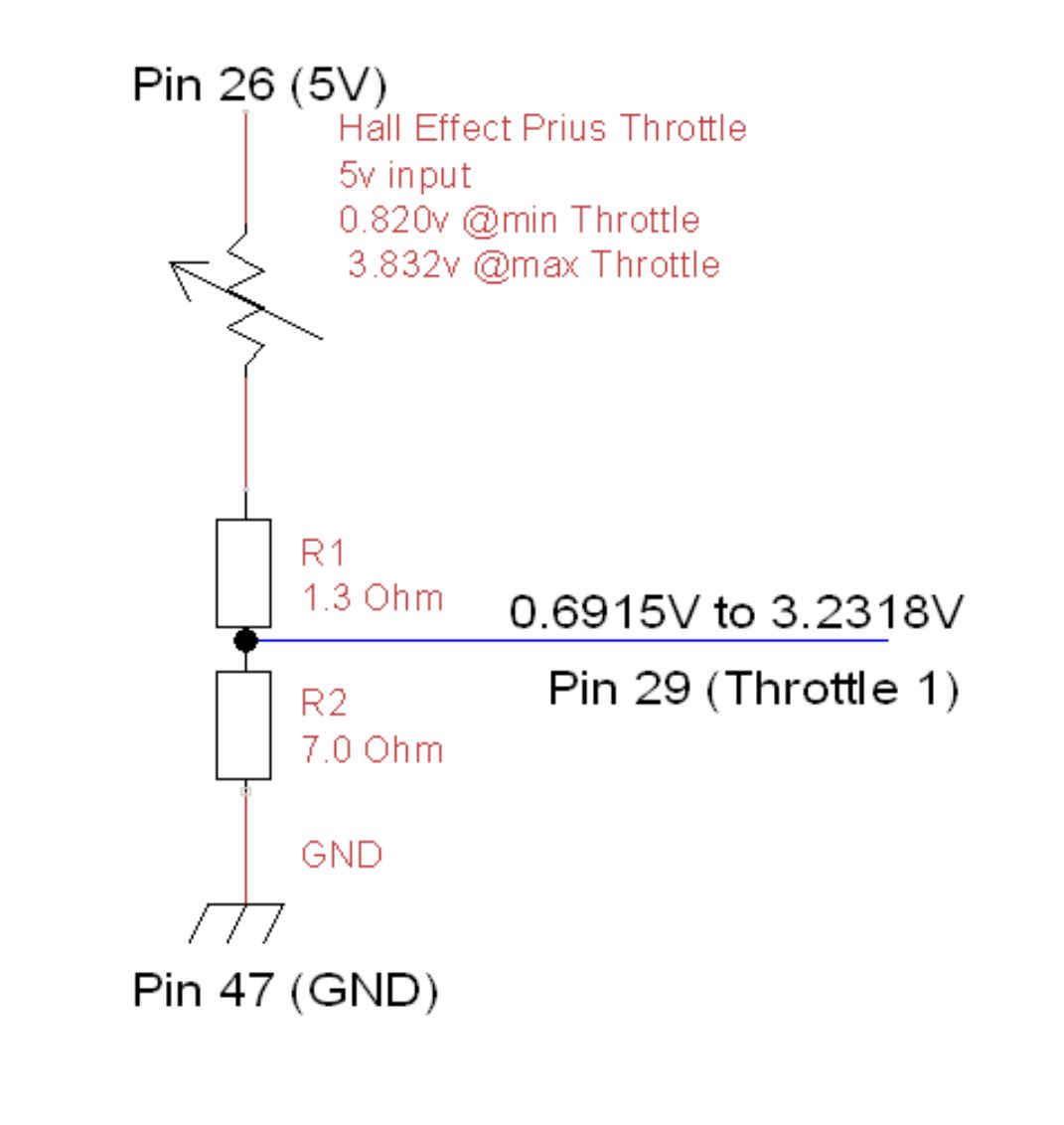

I am working on my Prius Throttle[1] for the Leaf. Can someone review this logic?
I understand it is limited to 3.2v max input.
What I found and the circuit I designed are documented in this picture.
Does this seem right?
Jerry Kauffman
jerryk48 at gmail dot com
Been thanked: 1913 times
Re: Throtle 5v
The circuit looks awkward. Hmm.
The 3V3 limit is not a hard limit, you could exceed it. You just loose the last part of throttle travel.
If you don't want that: the throttle inputs are loaded down by 10k resistors. So if you put, say, 2.7k in series with your 3.8V signal you will reduce it to 3.832*10/(2.7+10)=3.01V

johu wrote: Thu May 07, 2020 5:34 am The circuit looks awkward. Hmm.
Thanks Johannes, that makes it much simpler! :D
