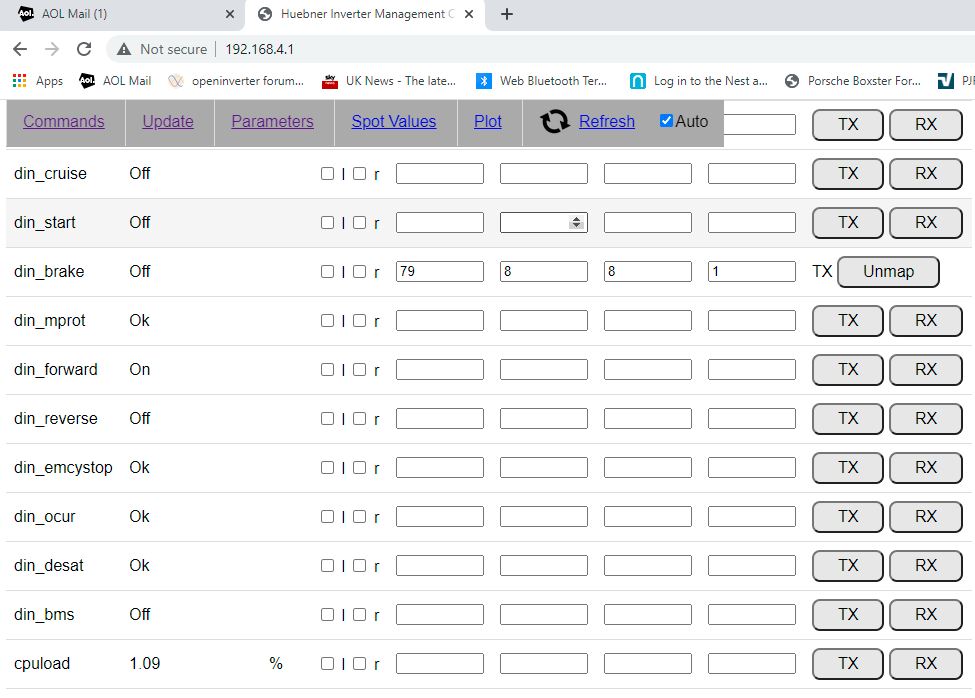

I'm having a few challenges and have spent the past few evenings fault finding to no avail. To help diagnose, here's what changed in the time leading up the current issue:
1) I updated the esp8266 to show the inverter parameter index (inverter.js, index.js, index.html).
2) I was working with Jon Volk adding some idlemode CAN commands via a Teensy 3.2
3) I had a mechanical overcurrent whereby the wheels shuddered and hit OC (this was expected as the Teensy idlemode code wasnt quite correct).
4) Returned tot he car a little while later and it's now refusing to run.
The issue is that when I pull a direction high, the inverter instantly hits overcurrent in software (doesnt even attempt at spinning the wheels). I can just hear a click from the inverter at exactly the time the OC fault is displayed.
See here:
I've since gone back to firmware v4.90R, but the fault is the same as it was with more recent release
DIN spot values at OC.:
Param file: I have removed the CAN set-up to more easily fault find. No change.
I'm trying to do every diagnosis I can before considering pulling the LDU from the car. Would appreciate some suggestions at what else I could test.

As soon as you switch to forward the PWM is actually started and will reveal blown IGBTs. Unfortunately on Tesla boards both desat and over current are reported as the same fault.
Looks like the idle experiment did some damage. I suggest next time you experiment lower ocurlim to something like 300A. Thats how I worked on the Leaf inverter.

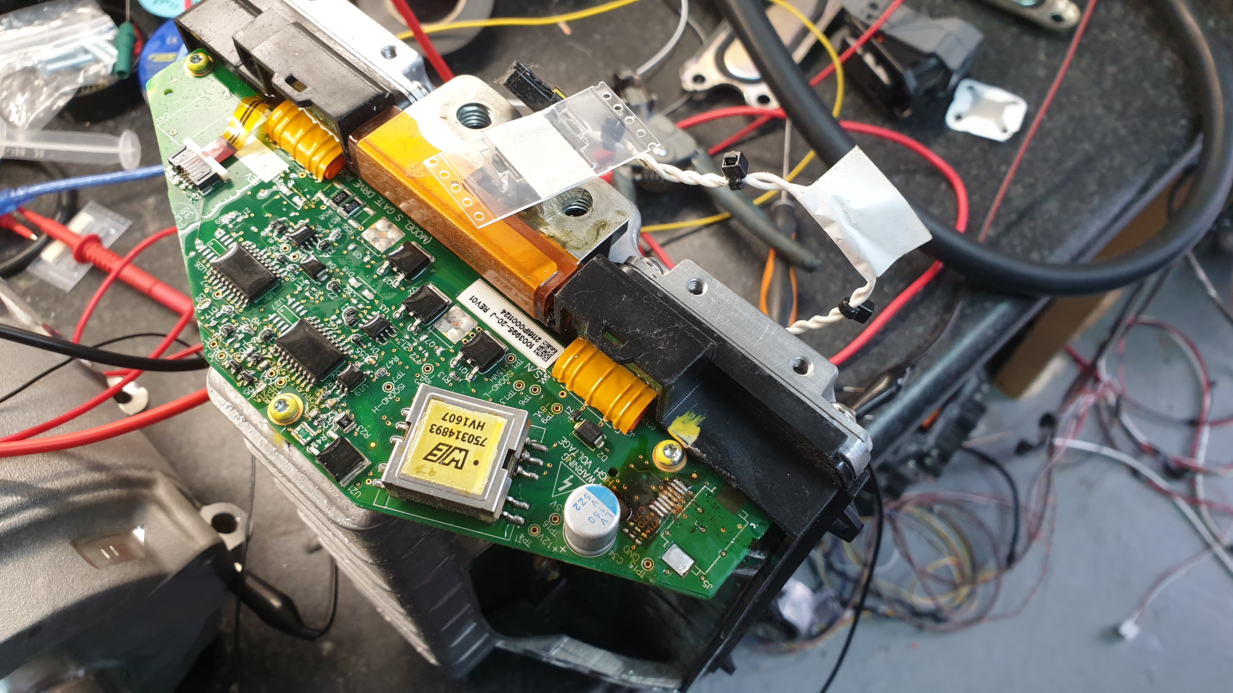

In other news, I pulled the DU yesterday afternoon and ran some initial tests. I believe I should be seeing a diode drop on each phase. However on one of them there seems to be a short circuit.
Can someone please confirm that I've tested this correctly?

Yea thats a dead igbt section.
Seen plenty of those on various drive units/inverters

it looks like the whole gate driver can be exchanged after loosening 3 screws and re-soldering 10 wires!Boxster EV wrote: ↑Mon Mar 29, 2021 4:02 pm Thanks Damien. That's really good of you. I'll send a PM.
Sooner or later someone has to deal with the renewal of the IGBTs, I would like to have the destroyed one to experiment with. I pay the postage, of course.
