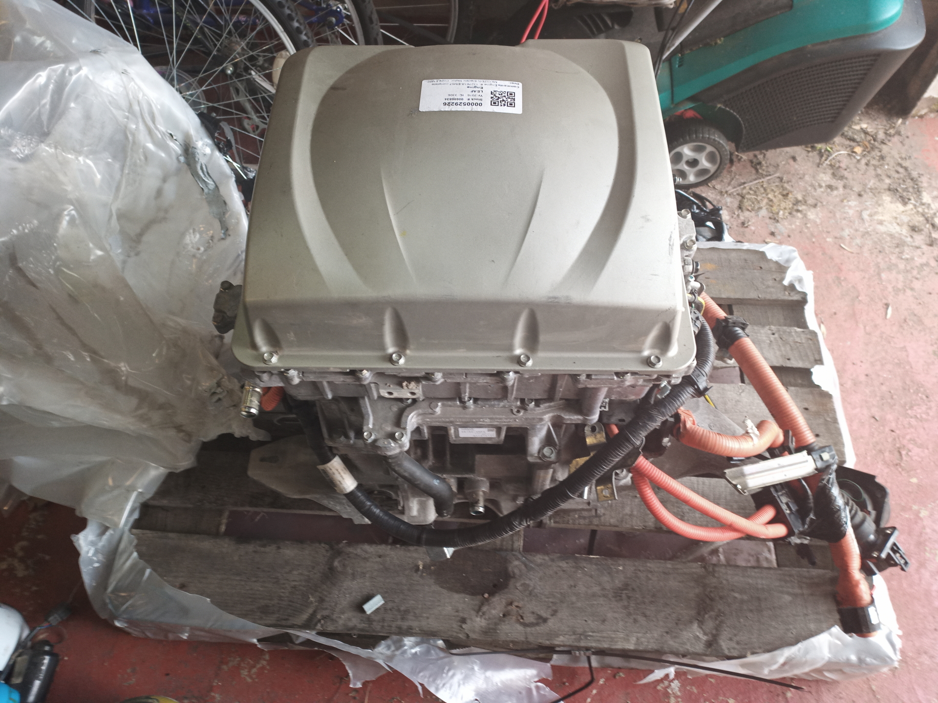

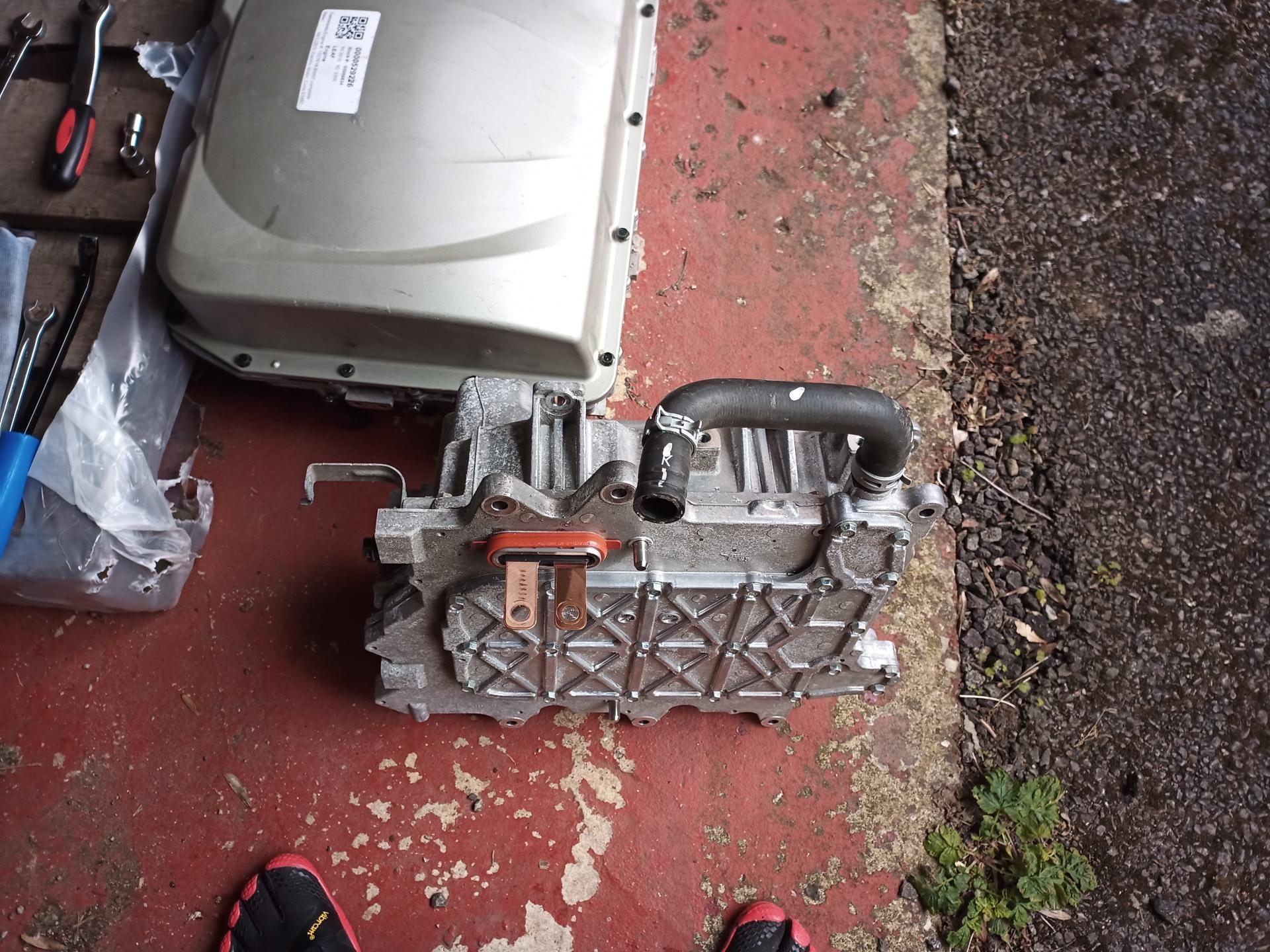

Well my leaf motor finally turned up today :), I think it still has the AC compressor attached too, lots of loom including the charge socket.
Intention is to get it working then pick up the best cheap RX8 I can find.

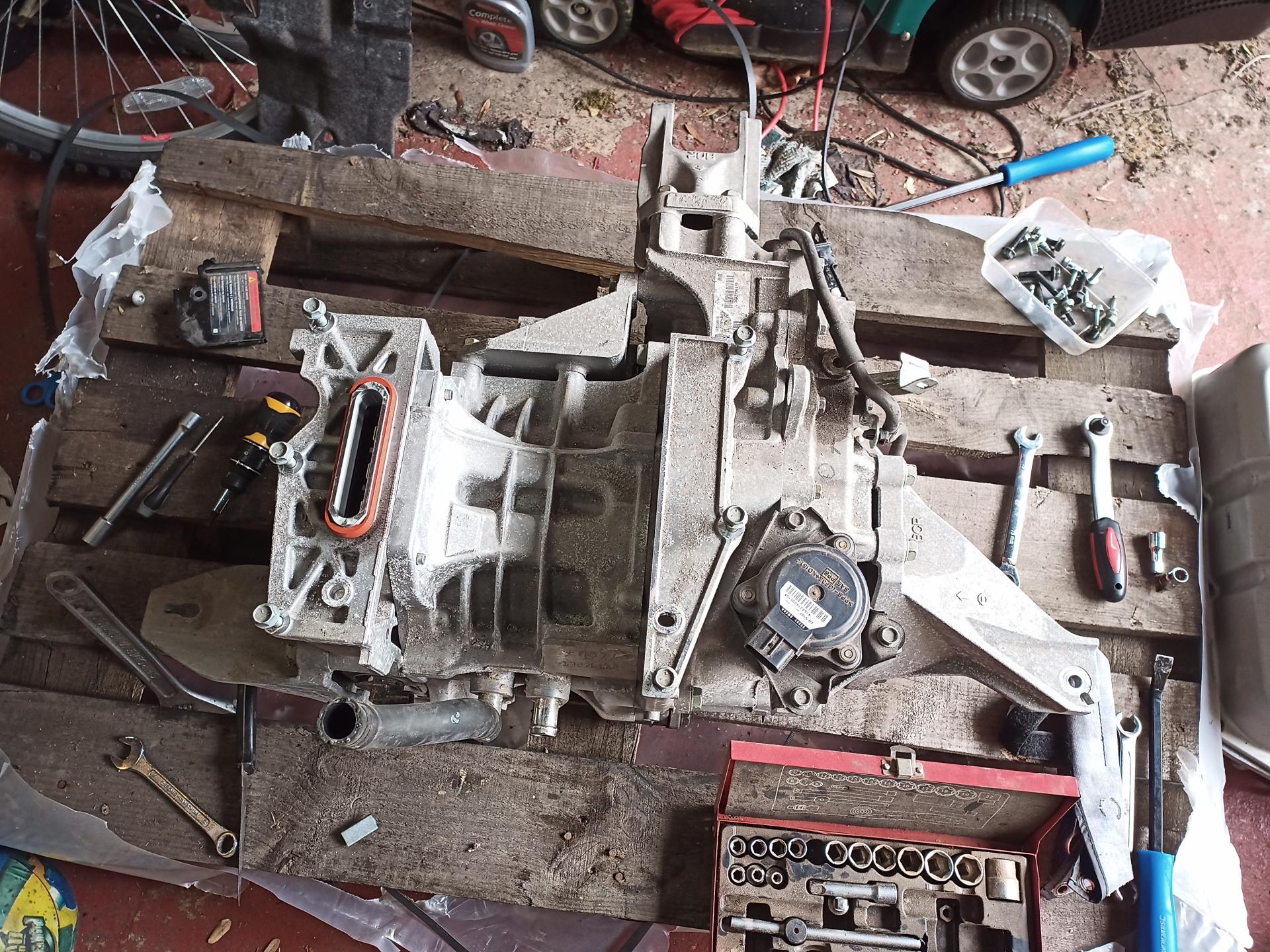

Well it all comes apart!
Has anyone tried using the 12V DC/DC converter standalone?

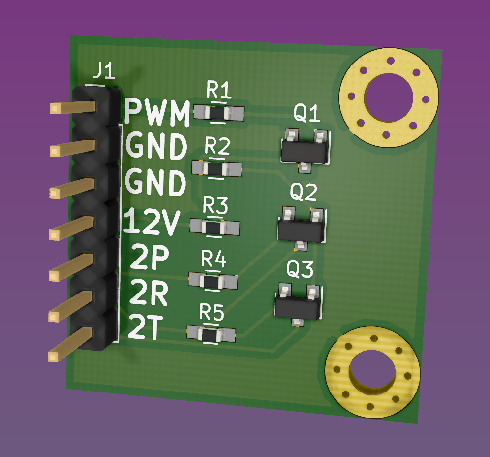

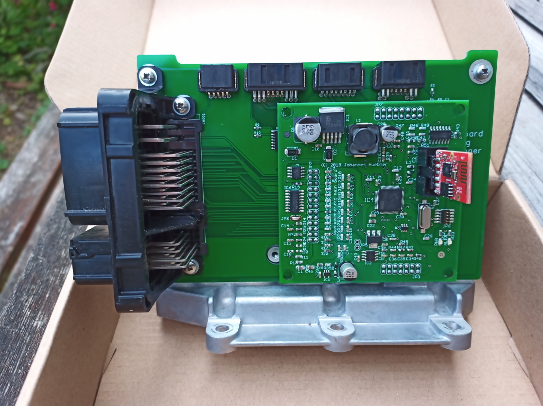

doobedoobedo wrote: Sat Jun 01, 2019 8:53 pm Has anyone tried using the 12V DC/DC converter standalone?
I hardware hacked the gen2 charger and DC-DC converter to work in my conversion. I didn't get the original charger brain board working by commanding it on CANbus, but in my tests I did manage to get the DC-DC to work using CANbus only.
I can dig up some notes if needed, but I don't have any of this in publishable format.
It's not a very complicated system to be honest, but I couldn't figure out what the charger was thinking. (and modifying the charge voltage and such is impossible anyway, and my conversion uses a 72S pack.)

Any info you are willing to share would be appreciated. If I can get it working I'll document it.
celeron55
Posts: 805
Has thanked: 38 times
Been thanked: 136 times
Re: Leaf powered ? (for now)
Post by celeron55 »
This is my notes of the PDM's internal connectors. The only thing is, it's mostly in Finnish, but other than that it's enough for remaking the entire brain board if someone has time to do so.

doobedoobedo

SMD adapter board with Brain Board
Should have it spinning soon

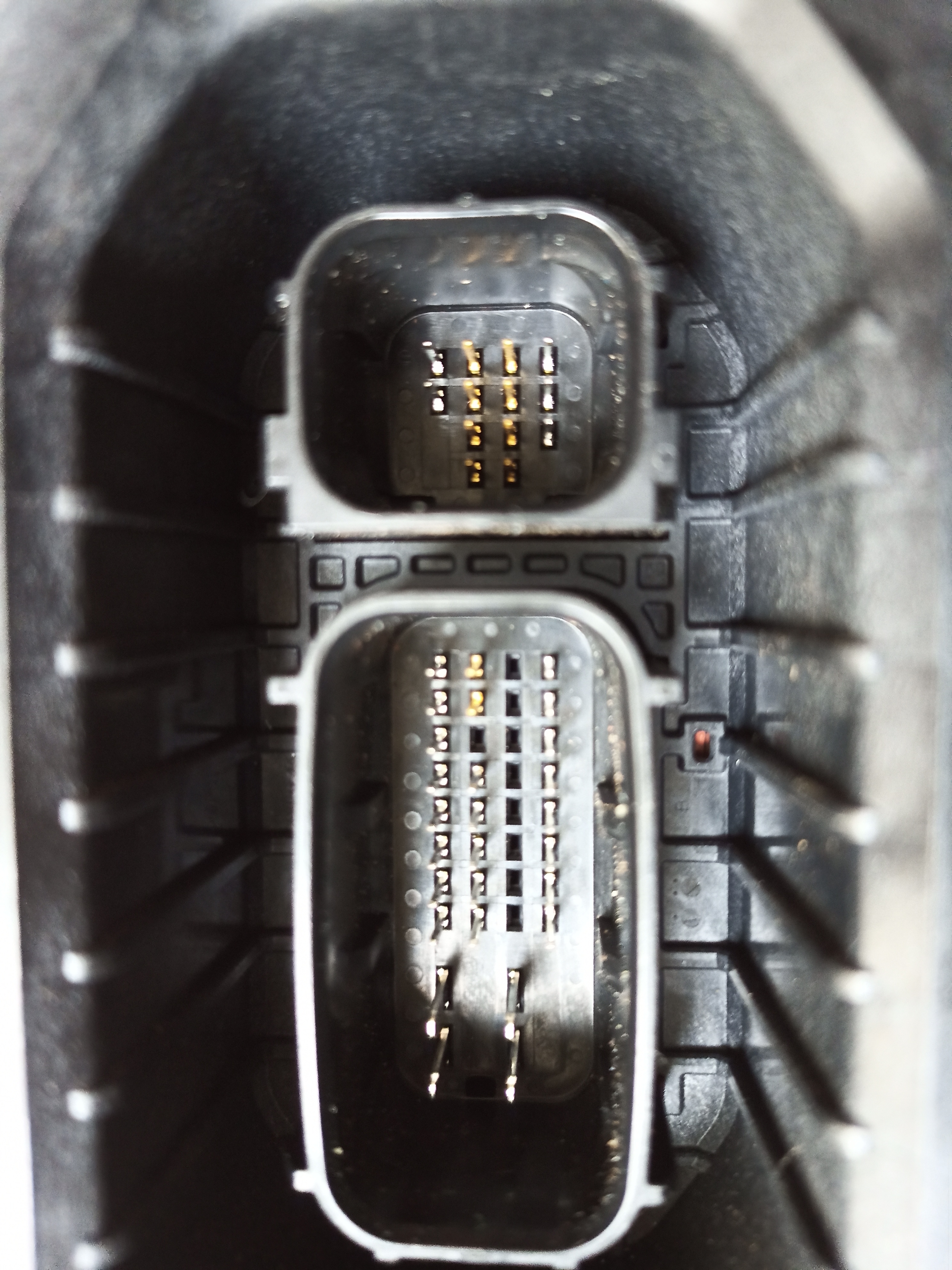

You do have to connect the wiring as described in the connector pinouts, or alternatively modify the original board to force the signal levels to the required ones that the board won't make for you by default.
Similarly to the other signals you can cut the i2c off from the Renesas microcontroller and add your own master on the i2c. This is what I did. It was a messy process and I mostly improvised it. I might have photos from some of it.
Of course doing something like this doesn't differ a lot from any other "mod chip" style solution that are used in game consoles and whatnot so it might be worth it to look into the optimal spots for cutting traces and attaching a piggyback controller board.
doobedoobedo
Posts: 264
Location: UK
Post by doobedoobedo »

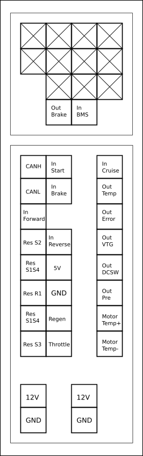

In order to avoid destroying everything before I've really started I thought I'd best do a pin map of the proprietary leaf connector coming off of the brain board adaptor.
Hope this helps anyone else with one.

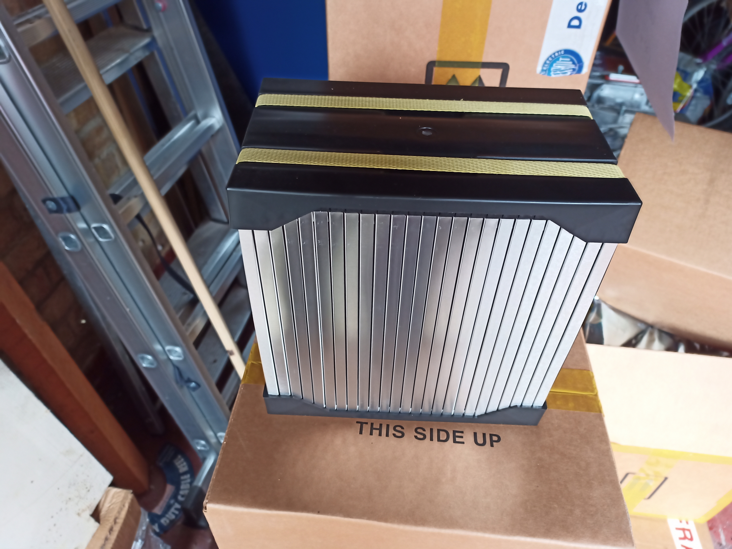

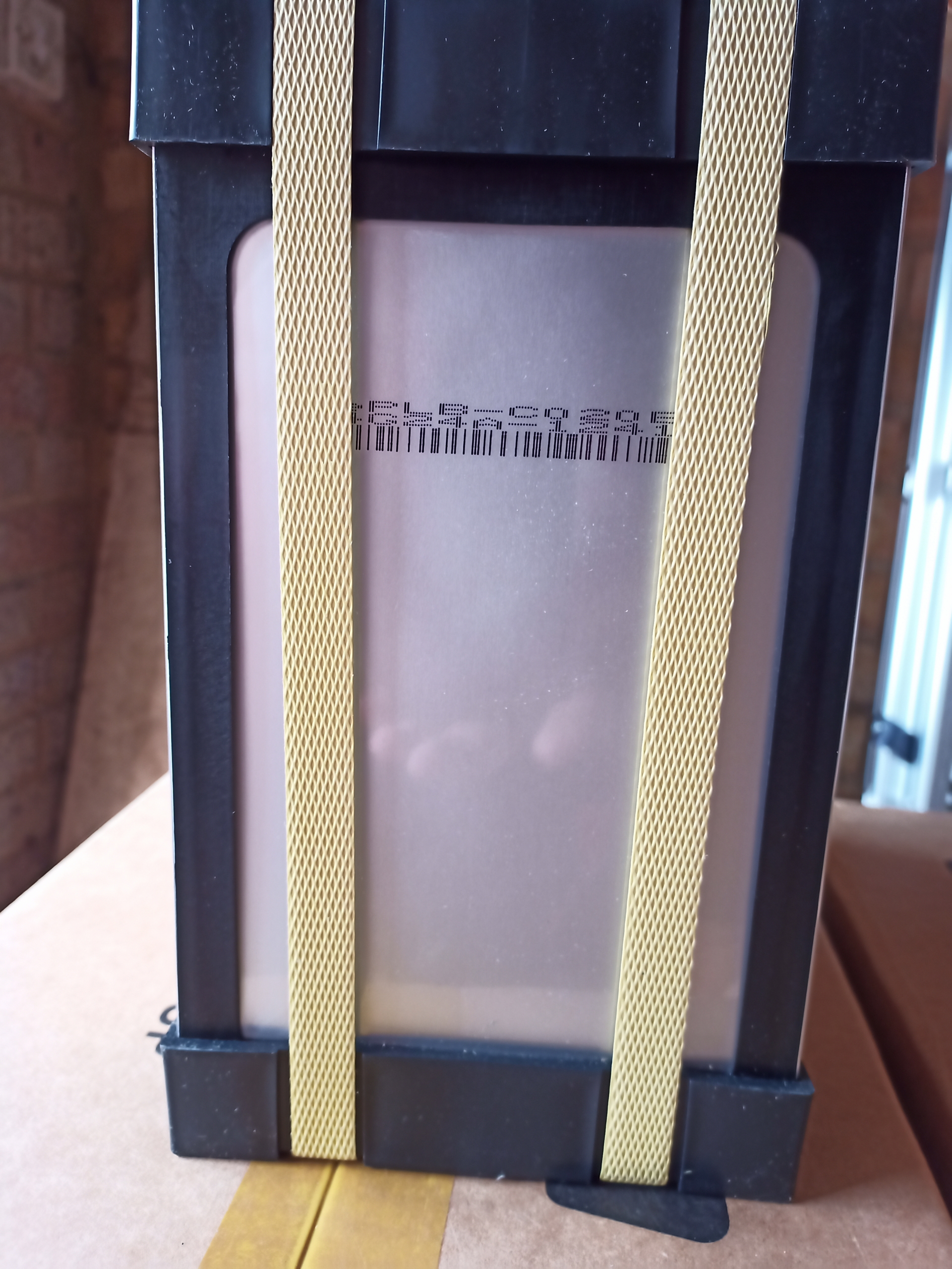

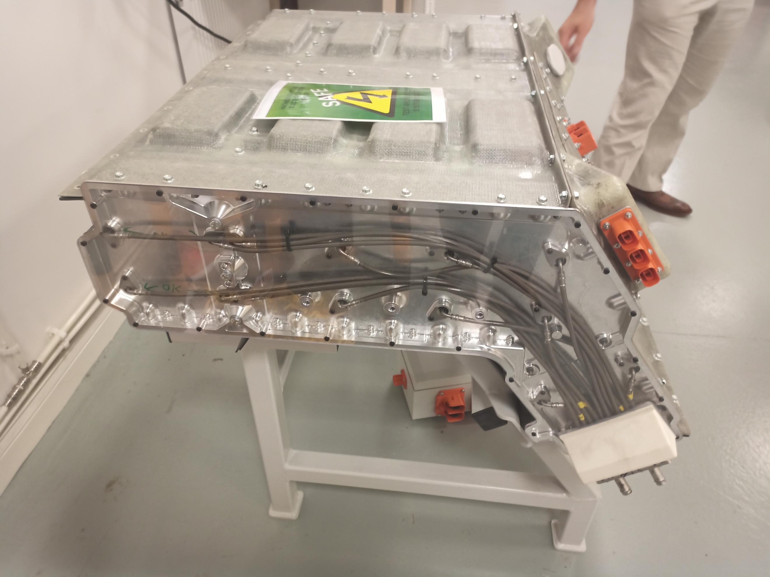

I have batteries!
I contacted Ben (in this thread viewtopic.php?f=12&t=193) and he put me on to the guys he got his cells from.
I'm now the proud owner of 500 EIG C20s, they threw in everything I need to make up 10 10S5P packs from them, and a BMS from MG Electronics (and a bunch of other stuff).

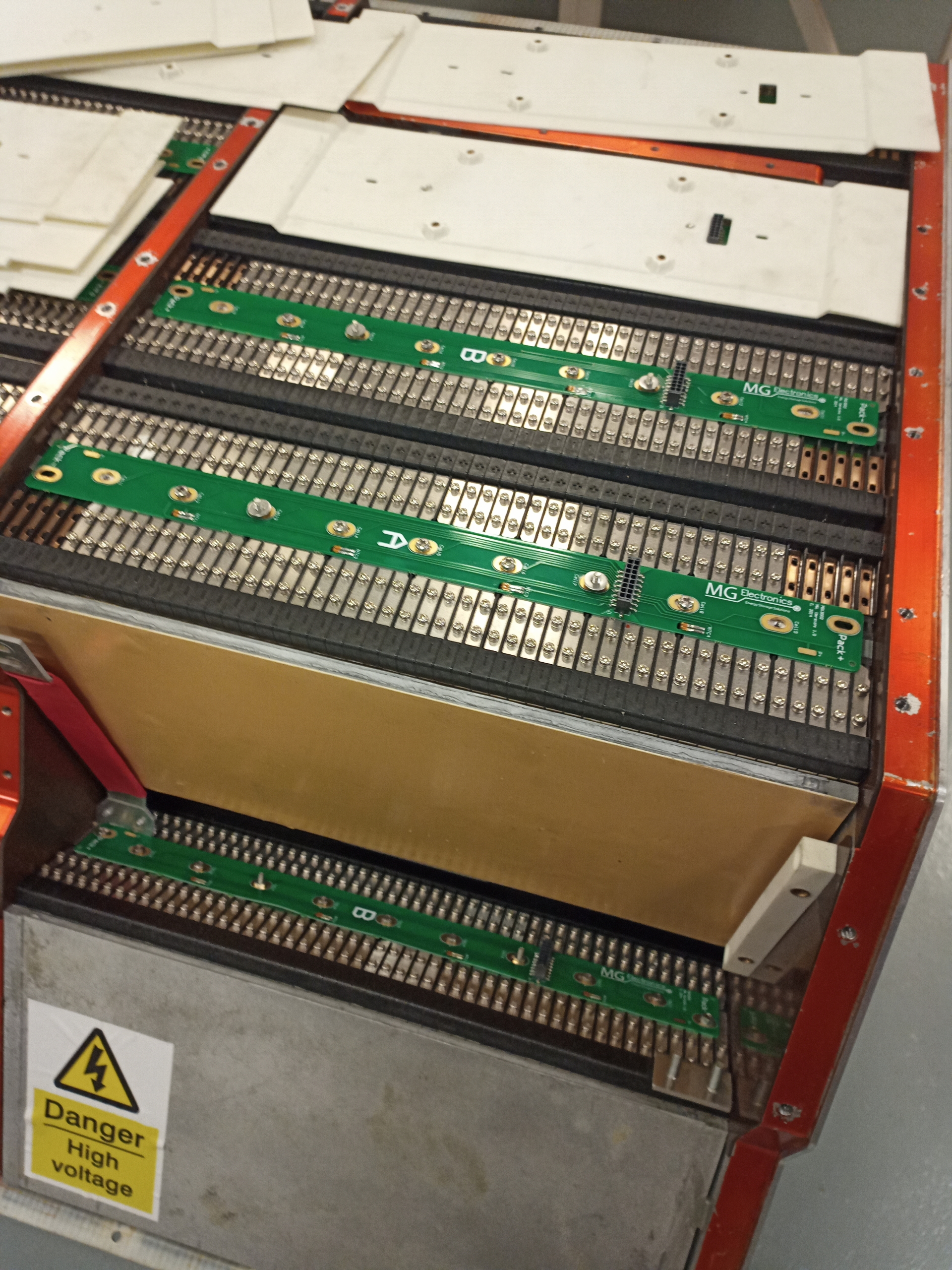

This one of their own packs, in the raw
and ready to go in a car

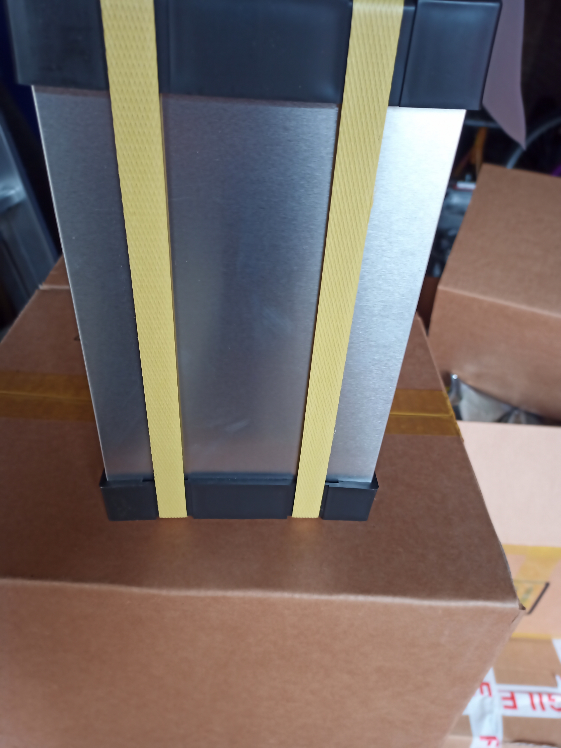

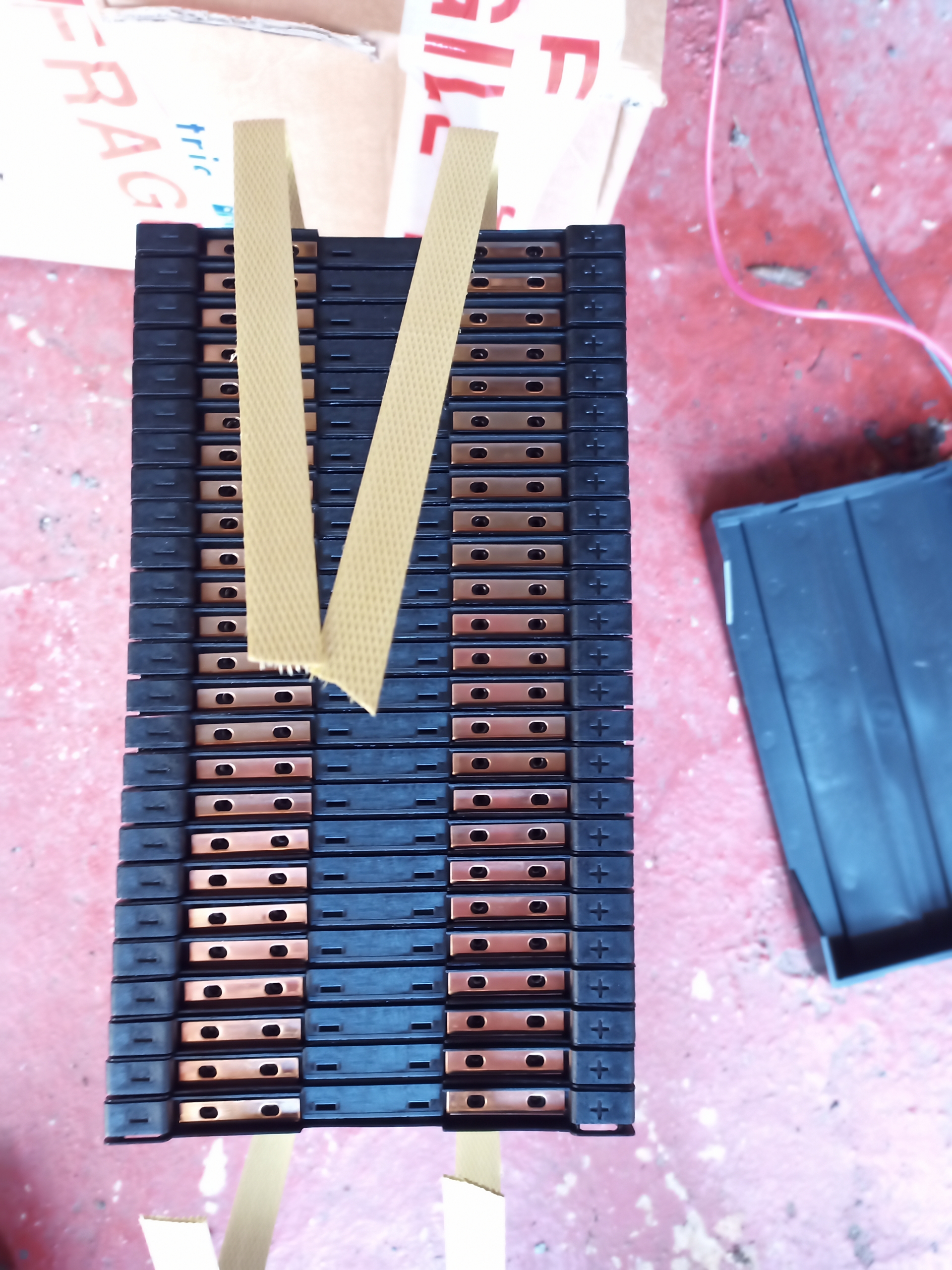

And how I received the cells
