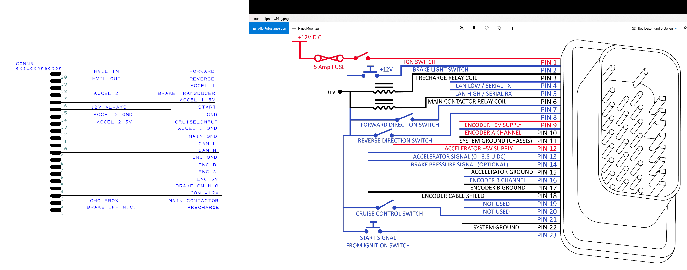

What does +rv mean? Trying to wire my tesla motor up.

Just dont know where all these wires should connect. It says hook them up to +rv. Google says it means variable voltage. Is it supposed to connect to throttle pedal or something, somewhere?

+RV -- looks like a typo, that's just +12V.

Isaac96 wrote: Mon Mar 08, 2021 11:47 pm +RV -- looks like a typo, that's just +12V.
I would agree too. I would like to suggest you feed it a contact +12V so only live if key is in contact / car is switched on.
