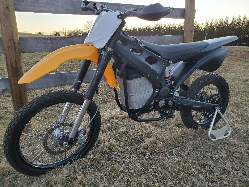

Alta Motors was a US company that produced about 1000 electric motorcycles 2017-2019. The company folded and the the intellectual property is now in the hands of BRP (Sea-Doo, etc). The bikes are very robust and powerful dirtbike/supermoto machines. Luckily they are pretty reliable and owners have been able to fix a lot of issues with no company or dealer support.
My project is a non-functional bike that was sold as an early prototype. It has most of the components of a working bike but I'm not sure any of them are functional. I am in the reverse engineering and component identification phase. It's a little different from most projects here as I have the whole machine on hand and don't need to do mechanical fabrication. I am, however, stuck with using all the OEM parts as they are all integrated.

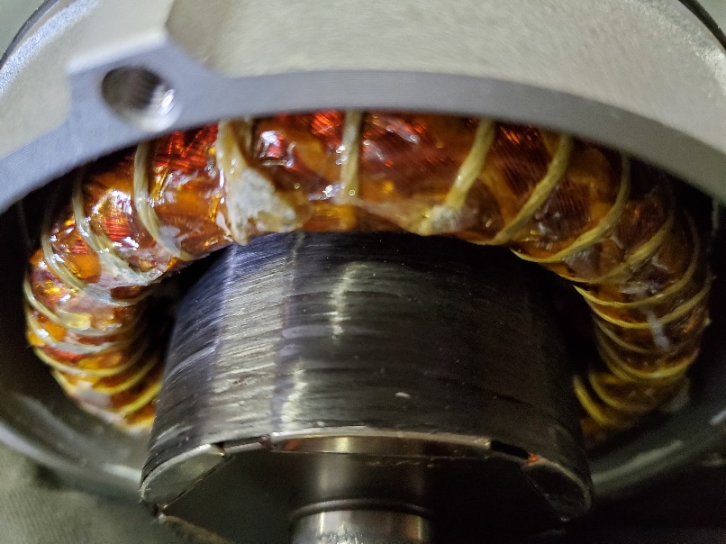

I think it is PMSM with absolute position encoder
AMS motor position sensor
https://ams.com/as5134#tab/applications
Motor also has temperature sensor, 6 magnets and 14000 rpm redline

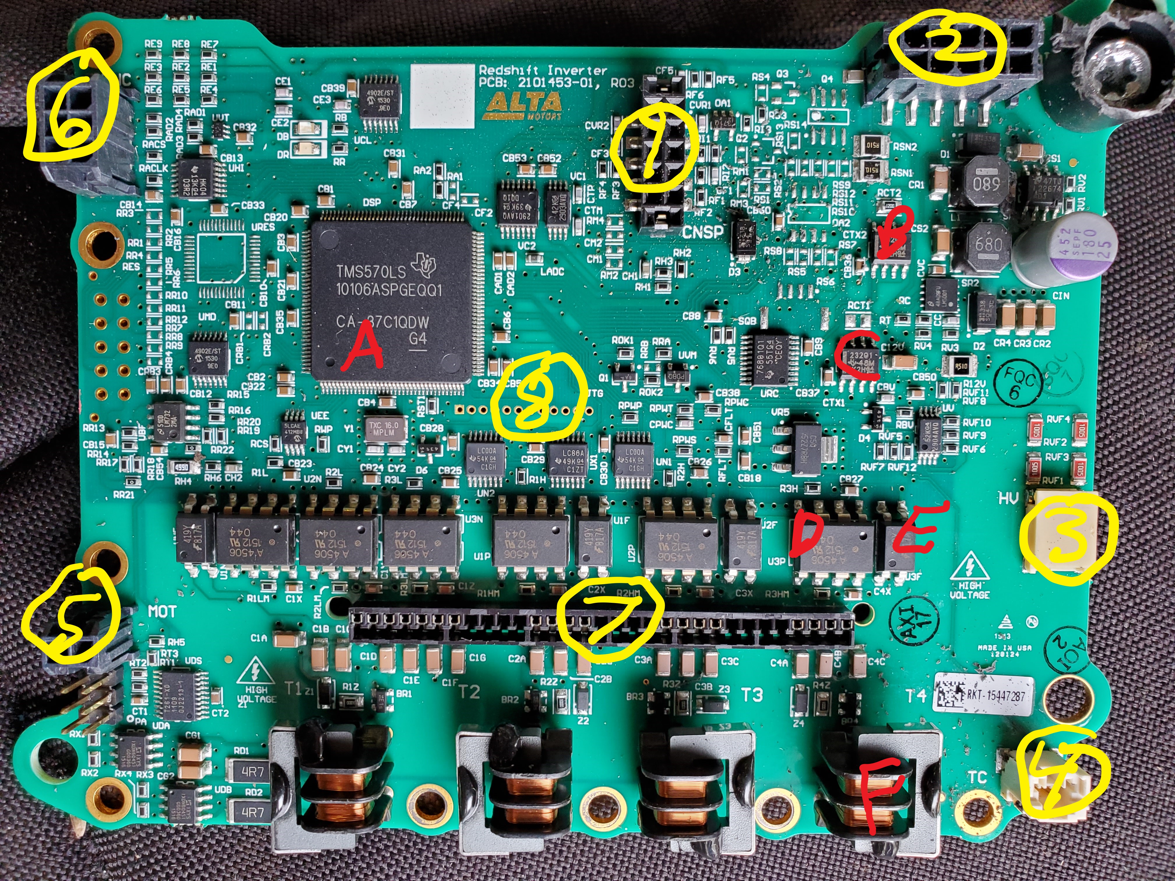

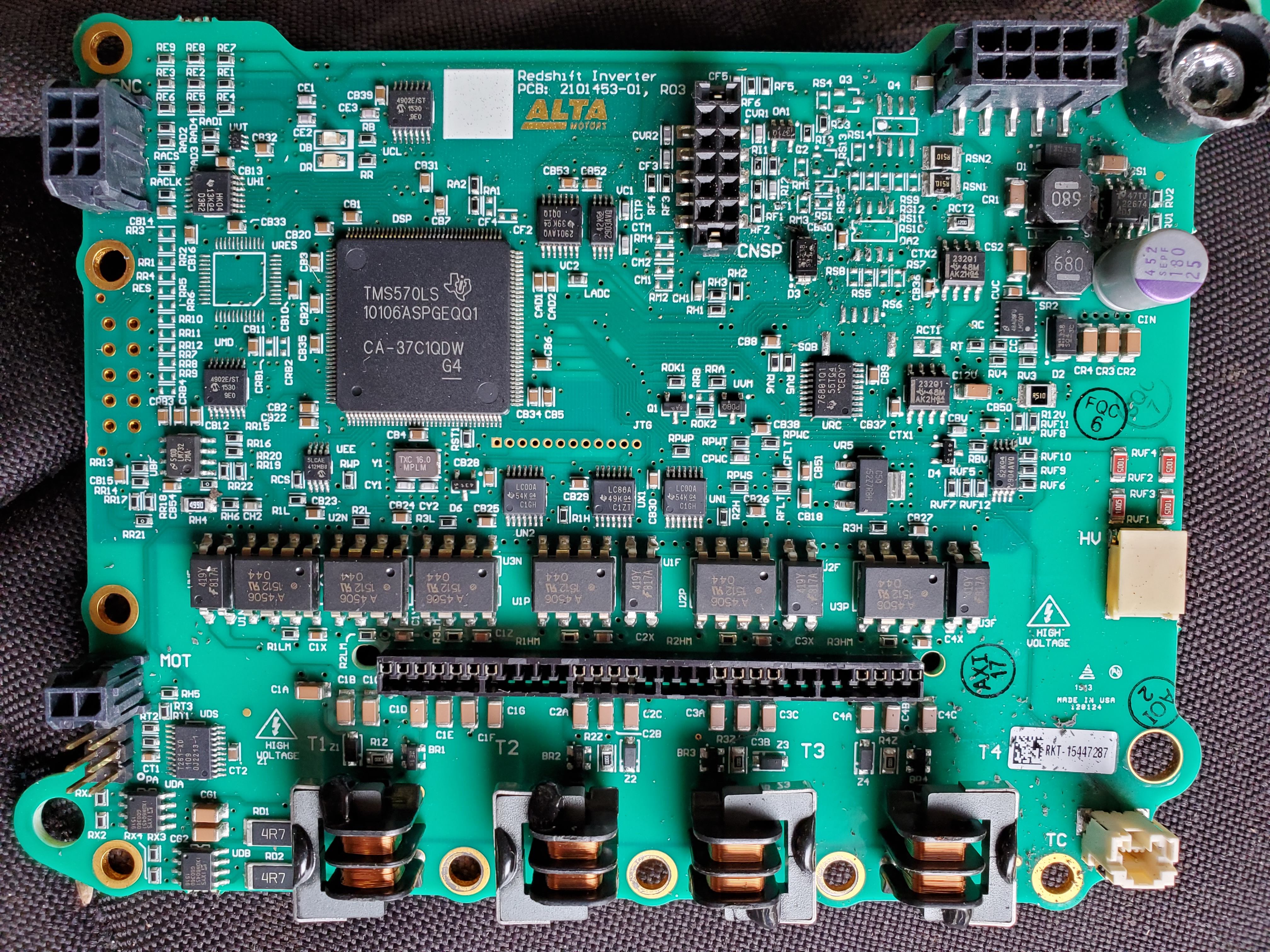

Connectors onto board:
1. Current sensor
2. "Main" 12 volt, CAN1, CAN2, Throttle?
3.tiny wires and connector to battery POS and NEG
4.Temps sensor near IGBT housing
5. Temp sensor in motor
6.Encoder. I'm told it is "SPI" as the traces are marked RACLK and RACS
7.This connector sits on top of all the pins coming out of the IGBT brick. The gate drivers live inside the brick
8. JTAG holes
Some of the devices
A. microcontroller , 144 pins
B. CAN2
c. CAN1
D. Opto isolator https://docs.broadcom.com/doc/AV02-1360EN
E. I'm told these are for "desat" protection
F. I'm told these are the power supply transformers for the gate drivers
My understanding is that the Openinverter board V3 will take care of everything above the level of the optoisolators (D). I'm hoping there is a way to disable the Alta microcontroller and connect V3 board onto this board. Is there a way to connect V3 board to this oem board above the optoisolators?
mjc506
Posts: 343
Has thanked: 30 times
Been thanked: 29 times
Re: Alta electric dirtbike OEM project
Post by mjc506 »
Looking good!
I'd be tempted to try finding/tracing the PWM signal - the IGBT brick will take 6 lots of PWM at something like +15/-5V (depends on the IGBTs) but somewhere this will be driven by a low voltage (+3.3/0V? maybe +5V), which the openinverter board can drive. I'd start looking at D - I can't quite read the numbers on the ICs, but there are 6 of them, always a good sign! You may have to hold the main ucontroller in reset, hopefully you can find a datasheet.
Another option might be to remove the stock controller board entirely and drive the IGBT brick with the openinverter board and gate drivers?

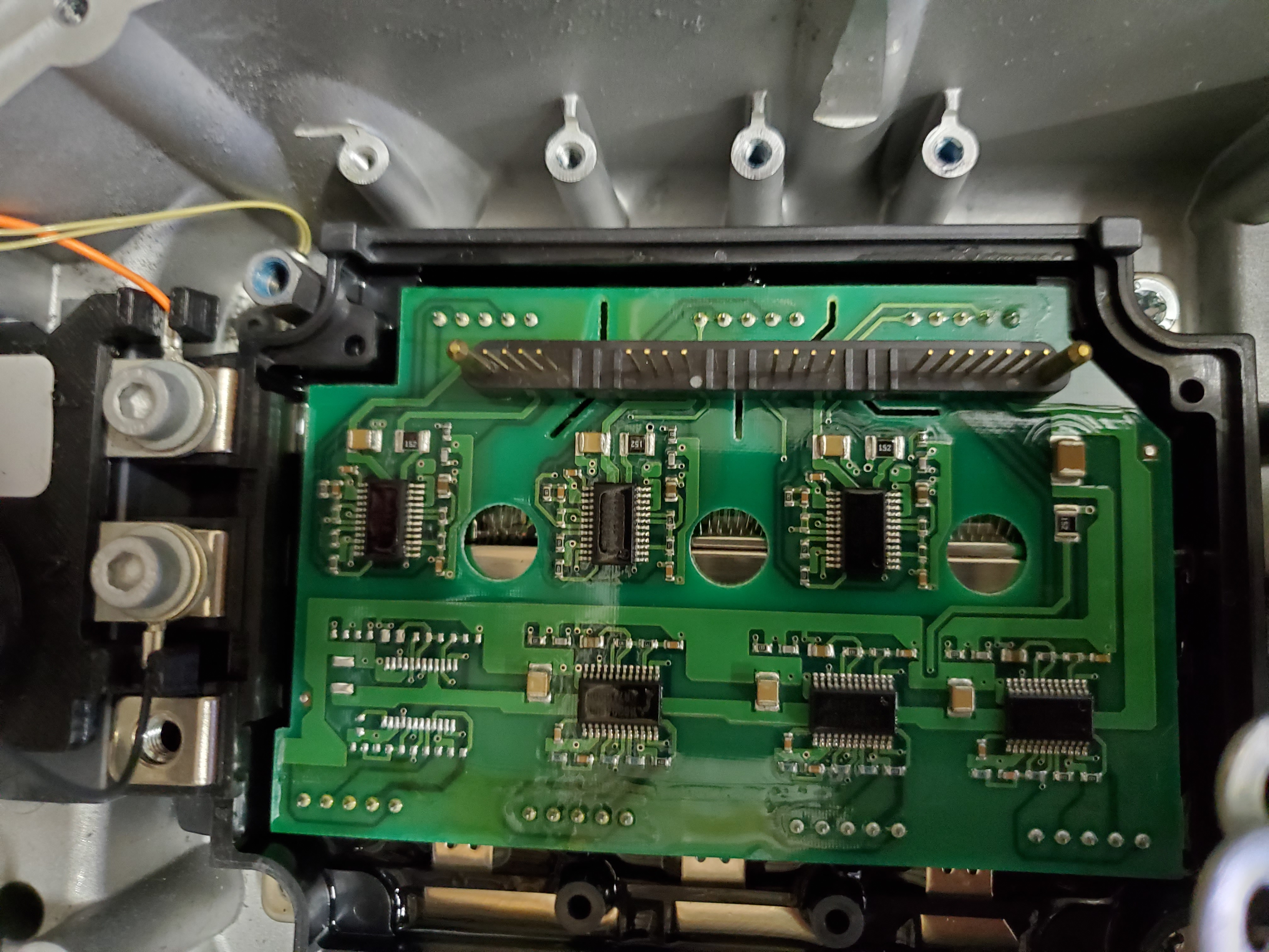

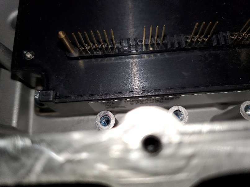

What I'm calling the igbt brick
The linear connector towards the bottom of the inverter board sits on top of these pins.
Under the bricks cover is another board holding the gate drivers
I'll edit the text in the previous post with some of the device info

Ahhh, even better then. The openinverter board should probably be able to drive that fairly direclty (although looks like the top board has all the power supplies etc)

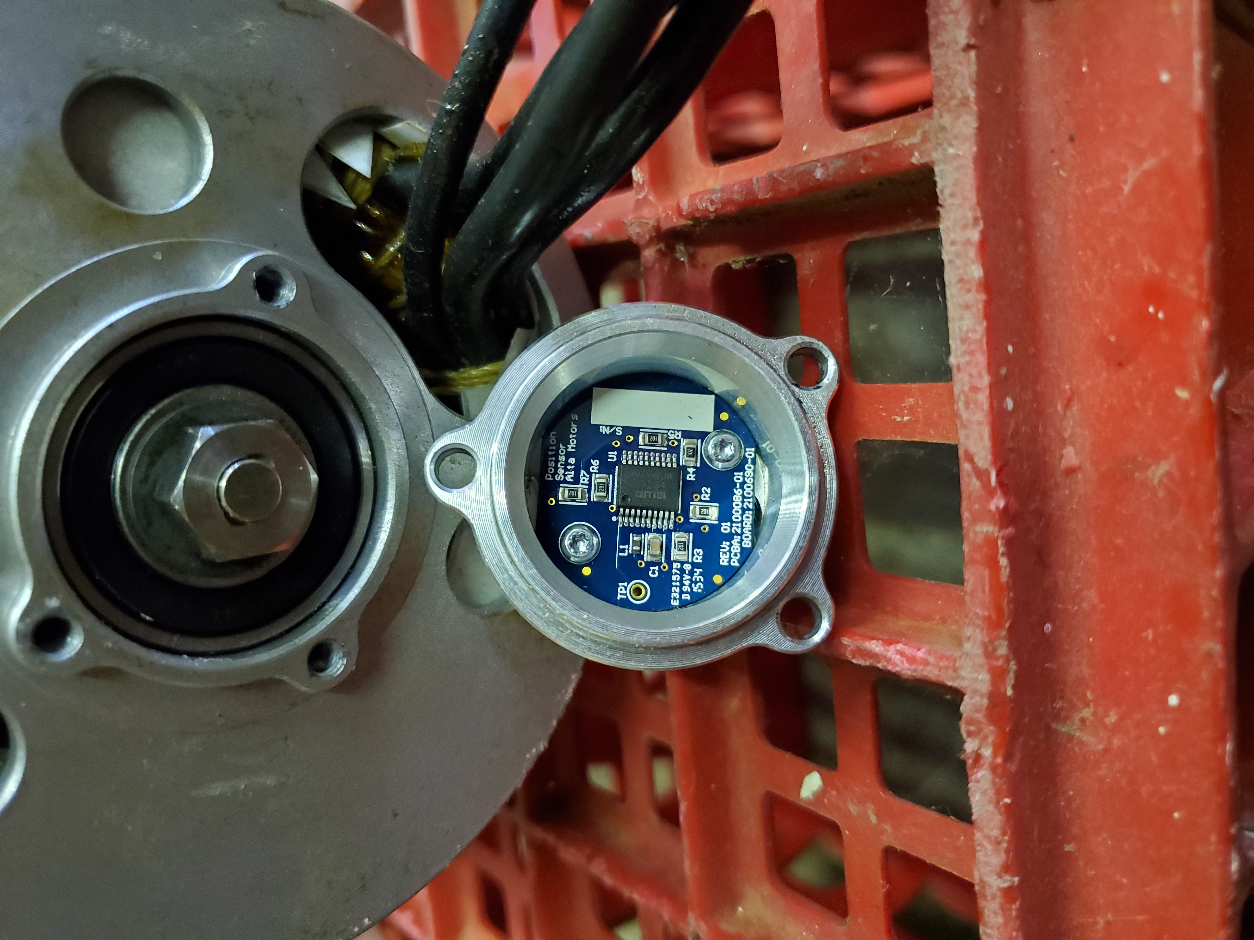

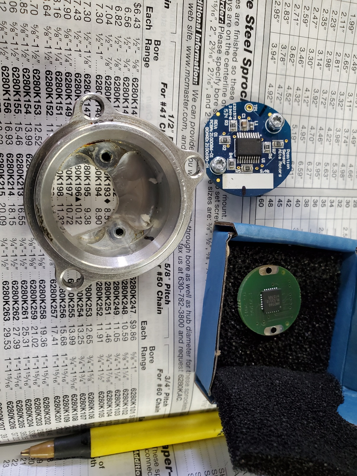

Position sensor situation. I'm pretty sure I have an absolute angle position encoder that is configured for SSI output. It is located on the end of the shaft and the housing is 26 mm inside diameter.
https://ams.com/documents/20143/36005/A ... 2749bdaa27
(The sensor chip itself is capable for "ABI" encoding which is the same as ABZ, but the pcb isnt wired that way and the chip might need different programming)
Is my understanding correct that openinverter will not work with this position sensor?

Hmm. It's a nice sensor, I'd be tempted to make it work. Openinverter will take an SPI encoder input, it would be worth finding the spec for this SSI output, hopefully there won't be too much of a change to the openinverter firmware to get them to talk nicely.
Worst case, its a great enclosure to make a board built around one of the Melexis sin/cos encoders for into!

That AS5134 looks rather similar to RLS module. I bet there is an annular magnet on that shaft end.
I see it is supplied from 5V, it can output UVW signal and can be set for motor poles. I think that would go with Lebowski drive very nicely.

mjc506 wrote: Mon Mar 15, 2021 8:34 am Hmm. It's a nice sensor, I'd be tempted to make it work. Openinverter will take an SPI encoder input, it would be worth finding the spec for this SSI output, hopefully there won't be too much of a change to the openinverter firmware to get them to talk nicely.
What I can gather as far as SPI vs SSI is that SSI has one wire for messages to go back and forth on and the SPI has two wires for carrying messages , one input and one output. The firmware would have to be modified to let the microprocessor send and receive messages from the encoder over a single wire somehow.
The next issue might be that the 256 pulses per revolution is too much for openinerter to handle?
Here is an interesting sensor that is already on a board that would fit into the OEM enclosure or cap. Might this be a possibility if it is set up for sin/cosine?
https://www.rls.si/eng/rmb20-rotary-magnetic-module
In order to see if the chip is putting out UVW signal, I would need to probe those specific pins with the board powered on and the magnet spinning? Would this be a good first oscilloscope for this and other reverse engineering stuff? https://store.digilentinc.com/analog-di ... er-supply/

The SPI encoder is already bit-banged so it'd be possible to change to SSI with some work on the firmware. 256ppr shouldn't be an issue. But yes, 'simplest' would be to replace that encoder circuit board, either the RLS module (I don't know it) or one of the Melexis sin/cos encoders. It'd need a new pcb, but would use the existing magnet and wire in to the openinverter board relatively easily.

I'm crawling through the learning process so it takes me a while to respond to all the help. Drilling down on the row of optoisolators on the board labelled 'D"
From left to right they are 1Low, 2L, 3L, 1High, 2H and 3H
(these are Avago "IPM gate drive interface optocouplers"): https://docs.broadcom.com/doc/AV02-1360EN
Tracing the input circuits i find that all six are fed signals through the three small square devices located just above them. These devices are "input positive NAND gates": https://www.ti.com/lit/ds/symlink/sn74l ... poasamples
I think these are some sort of buffers that the PWM signals flow through as another layer of safety?
Working backwards from these buffers or gates I found the six specific pins on the TMS570 mcu from which the PWM signals originate :)
mjc506
Posts: 343
Post by mjc506 »
Excellent :) You're doing well, it's a lot to learn all at once!
Yes, I suspect those nand gates are a form of hardware protection - it'd be quite easy to wire them up to some hw overcurrent/desat/etc output to disable PWM before the mcu even has a chance to think about it!
I would be tempted to try driving the pwm between the mcu and nand gates, this may not work as the mcu or other circuitry may inhibit. But if it does work you'll likely retain the hardware protection. Otherwise, drive after the nand gates, and tie the fault line to the 'desat' input on the mainboard (next best option)
Remember that both these options may be likely to upset the mcu - this may just set some fault flags you can ignore, or it may disable PWM overriding your inputs. Even best case, you may find that the mcu sends messages that other systems (dash, bms etc) rely on so these may not work. If the mcu stops PWM working, you could try holding in in reset (find the reset pin, tie it to ground usually).

I'm working under the premise that the OEM mcu is hopelessly locked up. My jtag hacker friend explained that we dont have the proprietary bootloader to do anything with the mcu. I'm not too upset about losing the other systems like the display/dash and the accessory control module.
If I can get the motor spinning (looks promising!) with openinverter, then the next task would be to try and get the BMS and charger to cooperate. I'll have to learn about can sniffing and deciphering for that crucial job. Luckily, I have a second working bike, a working battery and a CAN adapter.
You wrote "Otherwise, drive after the nand gates, and tie the fault line to the 'desat' input on the mainboard (next best option)" This is the strategy that I can mostly comprehend right now. This would entail plugging wires into the openinverter board header and soldering the ends onto the pads of the optocouplers on the Alta board? (The gate driver boards supplied with the V3 kit would then not be needed)

Yup, you've got all the gate drivers etc you need right there in the stock inverter, one would assume they're designed to drive the powerstage properly, so makes sense to use them :) I reckon just a rev3 mainboard and you'll be pretty set :)
