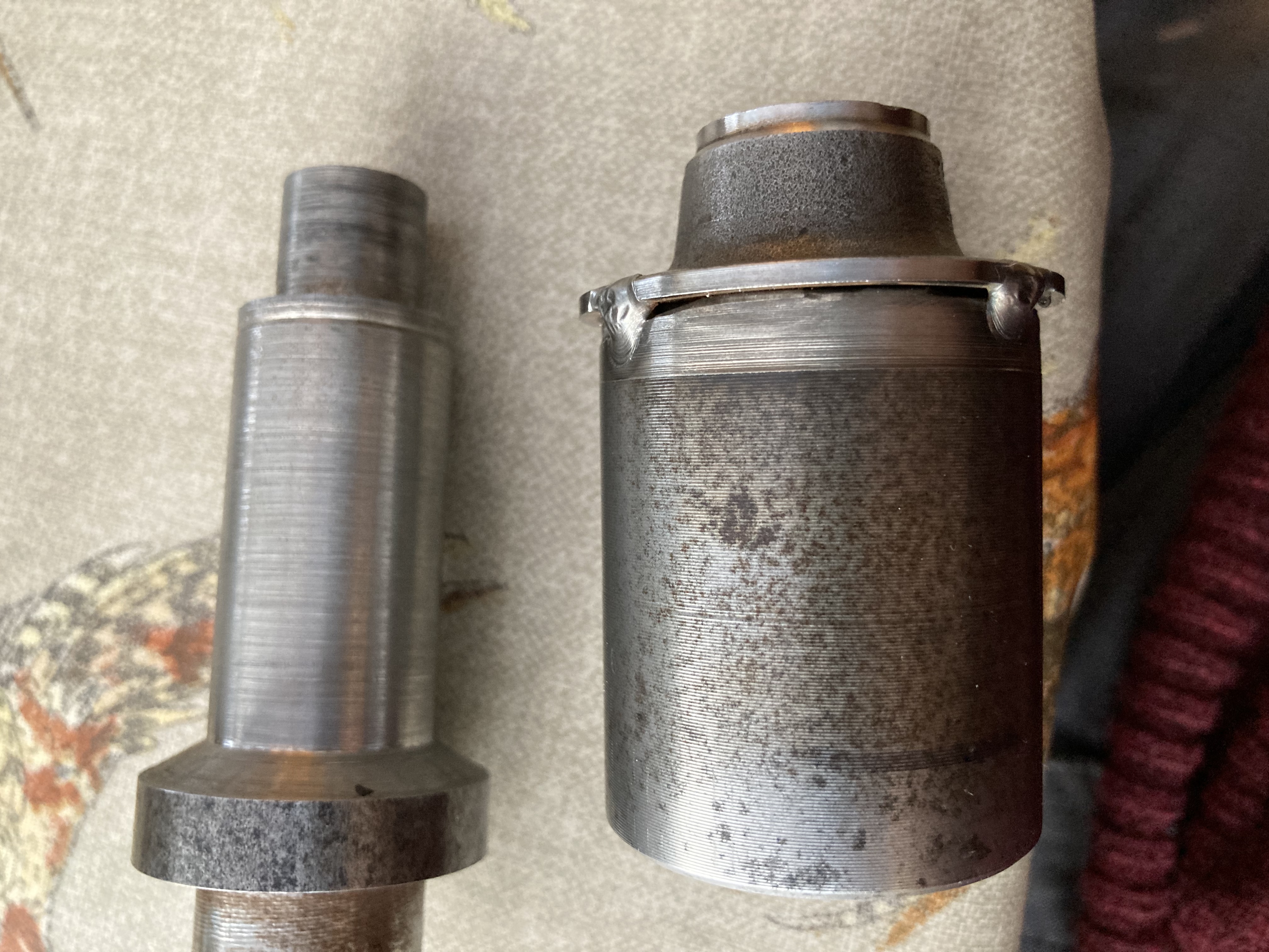

When I started out on the EV quest , it was with a mind to fit a 2cv van with a Toyota MGR which seemed like a good Idea , so bought a cheap (that word again!) Lexus MGR from Eastern europe . very quickly it became apparent there was a problem, the 2cv has inboard brakes fitted to the transaxle housing , and the MGR doesnt ...mmmm MGR is now a bench test pig but a cheap Citroen C-Zero (IMiev/Peugeot ion Meiden motor) that looked like it had been used as a boat anchor cleaned up great and spins smoothly on a 48v e-bike controller so a couple of hours turning a coupling from a 2cv clutch disc and a slab of 15mm Ali for the adapter plate and off we go !

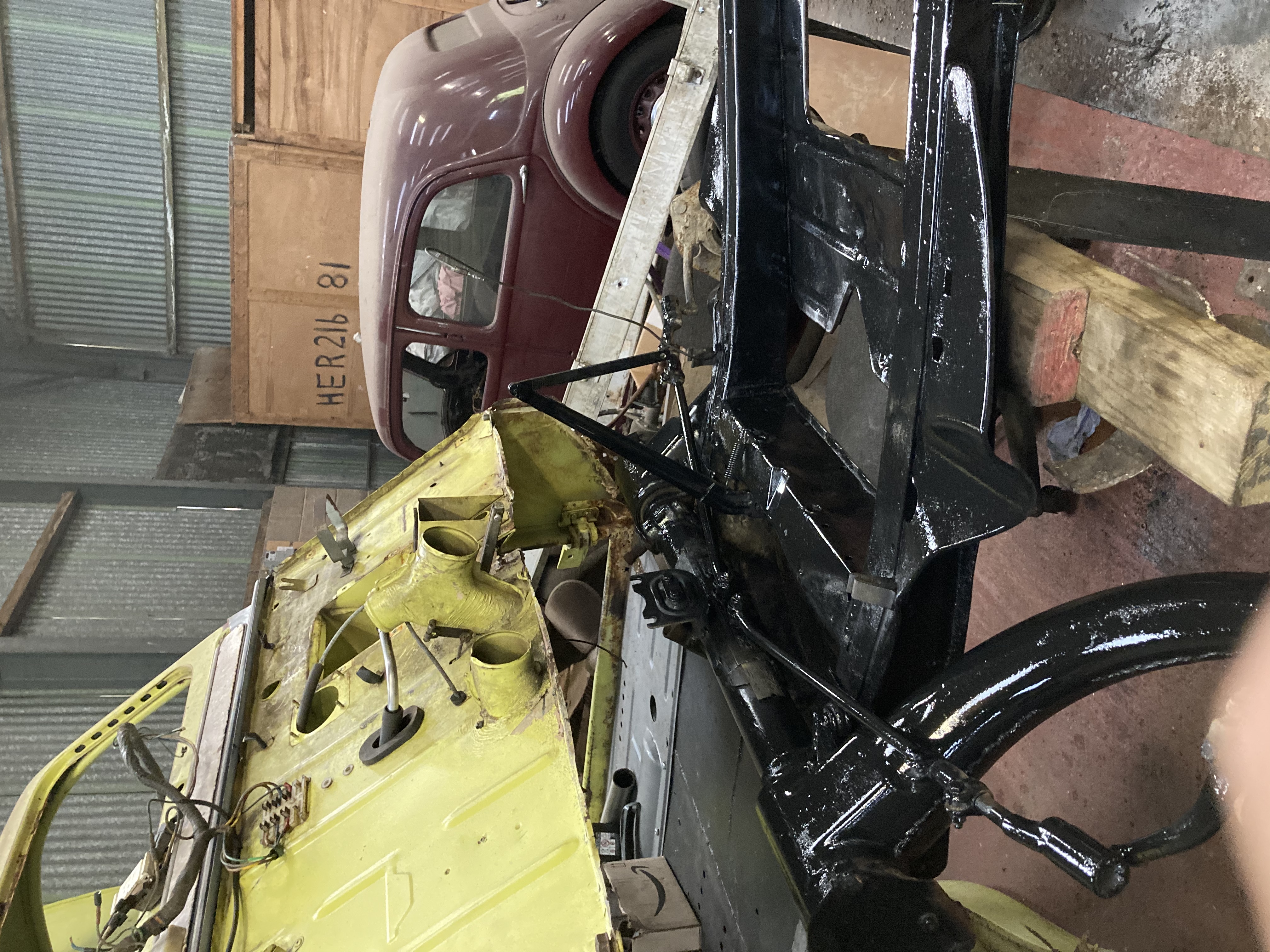

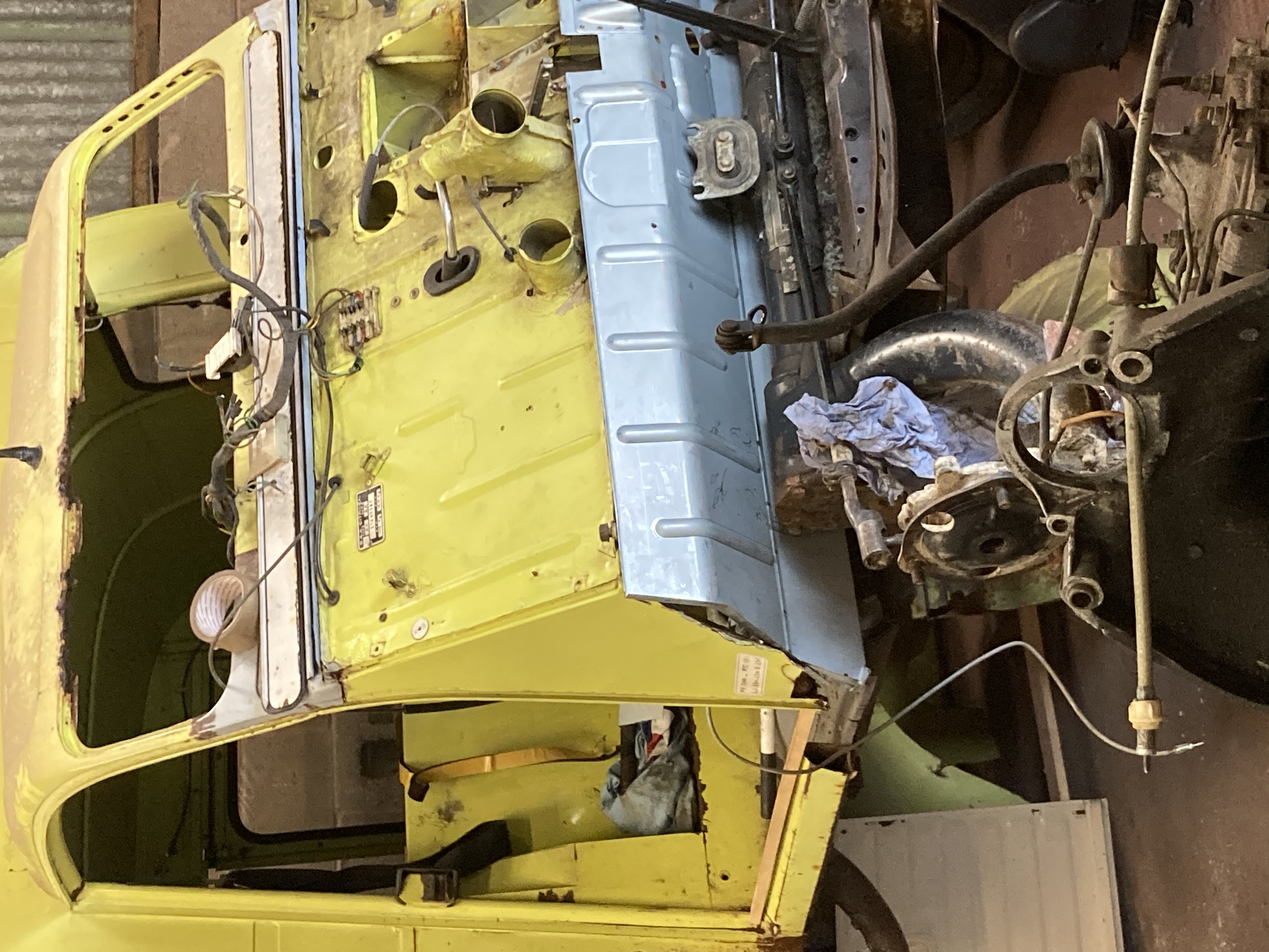

Finally got some time on the 2cv , having realised the motor was fitted to a GS disc gearbox that wouldn't fit the 2cv easily,I remade a splined adapter from a 2cv clutch , put in all new floors, and bought and fitted a disc brake gearbox . Still working on the OI brain in a yaris inverter
engine bay and front suspension all cleaned up ready for the new motor/gearbox
Made up a mandrel (left) to keep the imiev (big) splines and 2cv clutch centre (Smaller) dead straight whilst welding
2cv gearbox fits straight on to GS drilled plate on the Meiden motor
New floors / bulkhead progress .....

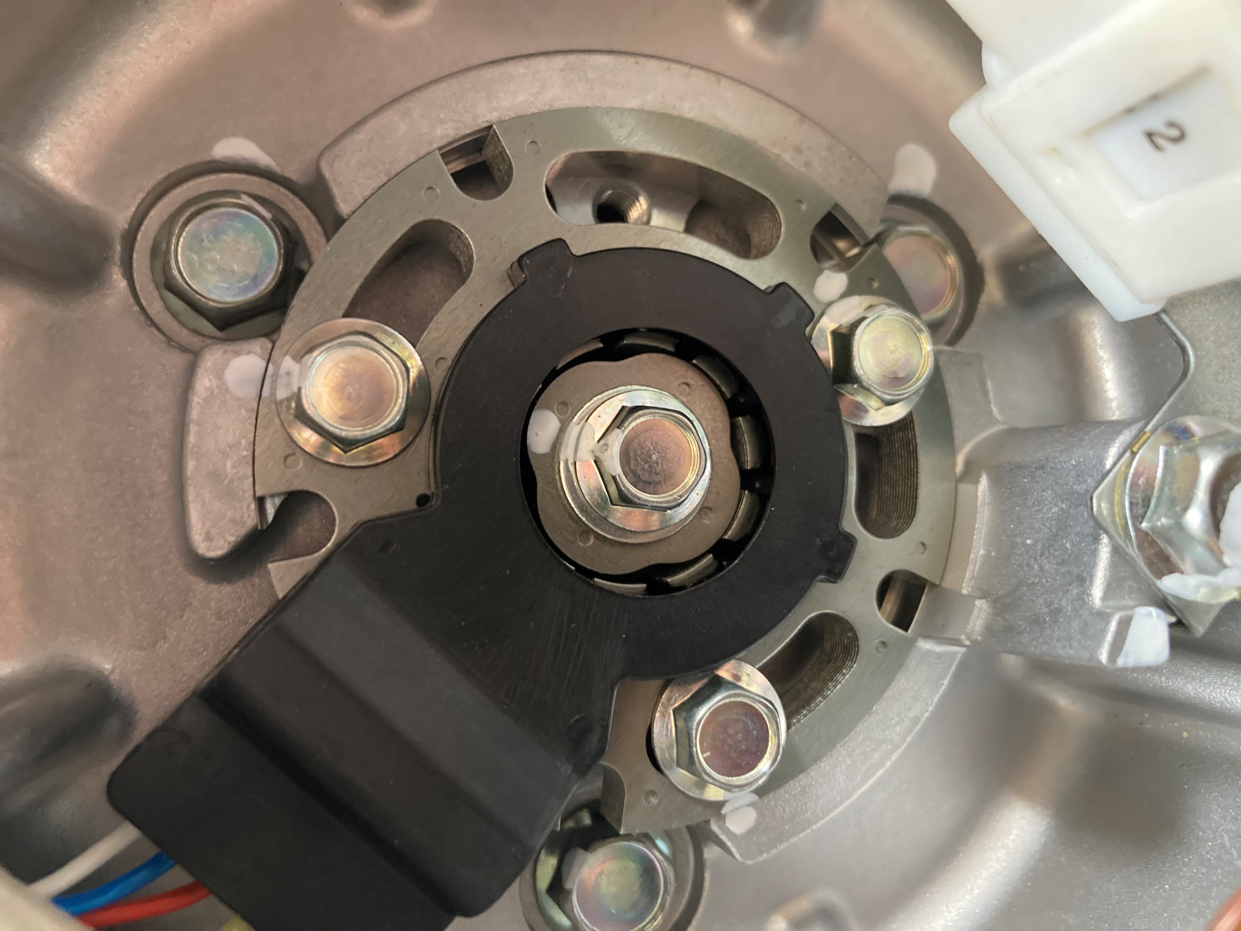

@ Markos ,Thanks for the link, I think he's going the CAN route with matching inverter and the whole rest of the car, I'm starting with a bare motor, I did manage to get it jumping about on the bench yesterday with my Auris + V1c inverter +75v in open loop but it's obviously not happy, just looking for why it's not spinning freely, it has turned ok on a sensorless bike controller @ 36 v . More thinking ......

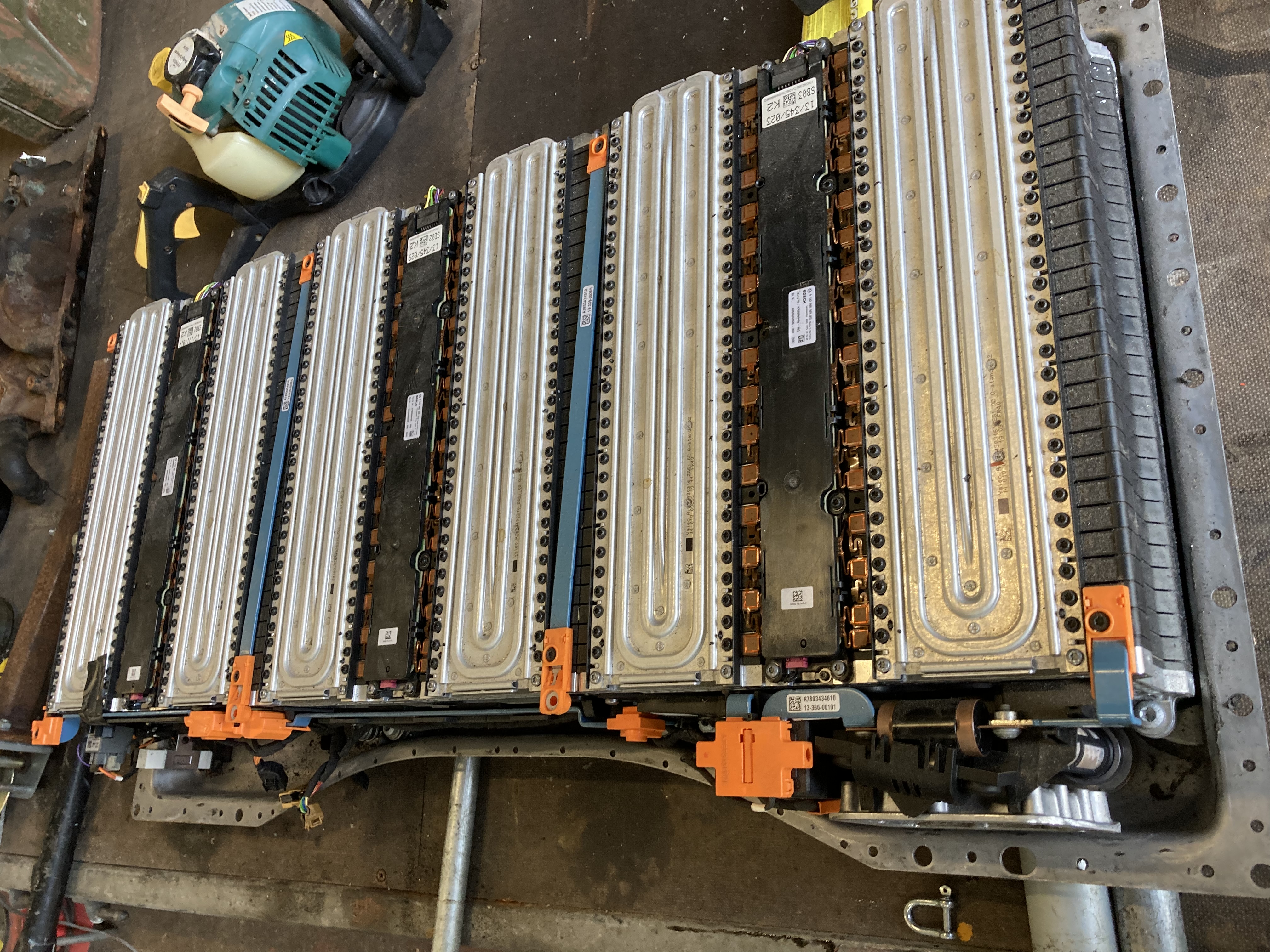

So , Happy new year everyone !
Having declared getting this 2cv to run this year as a new years resolution I have spent a little time nudging the project forward .

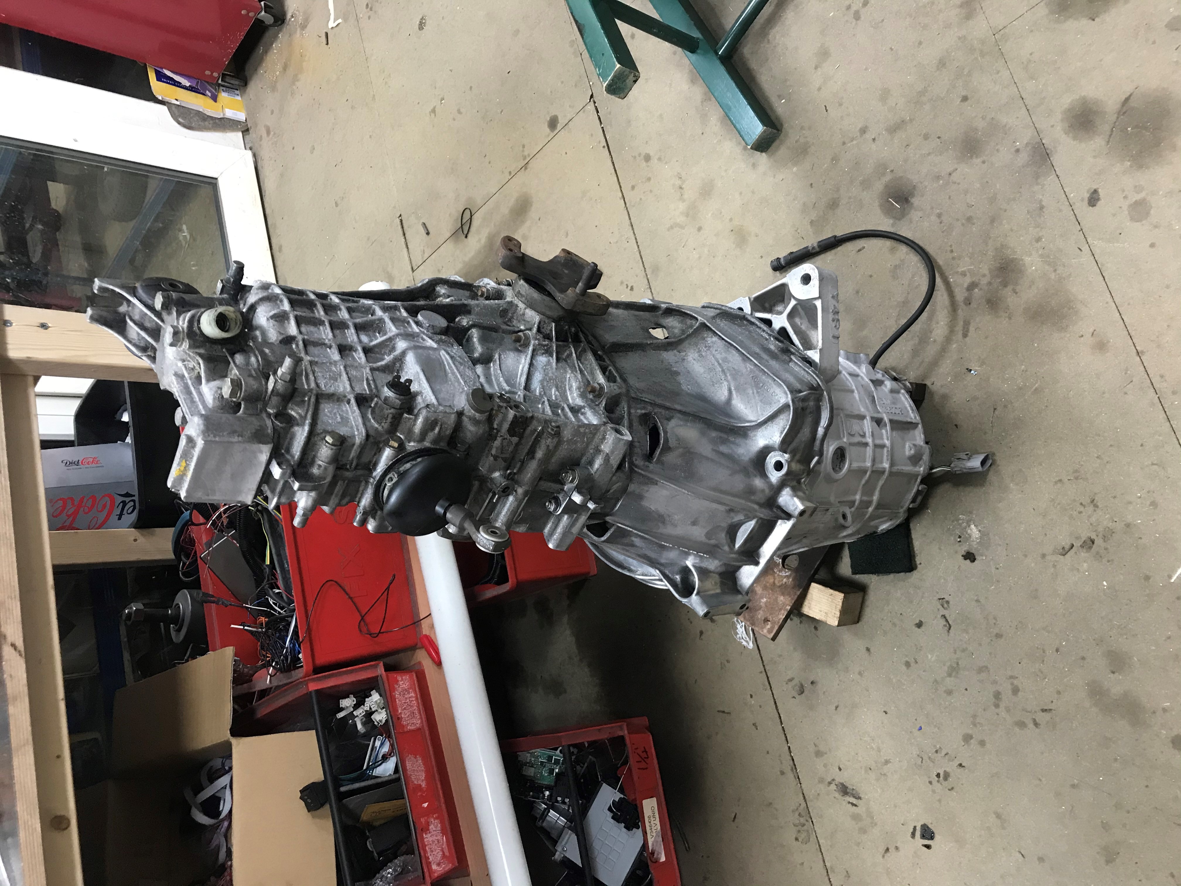

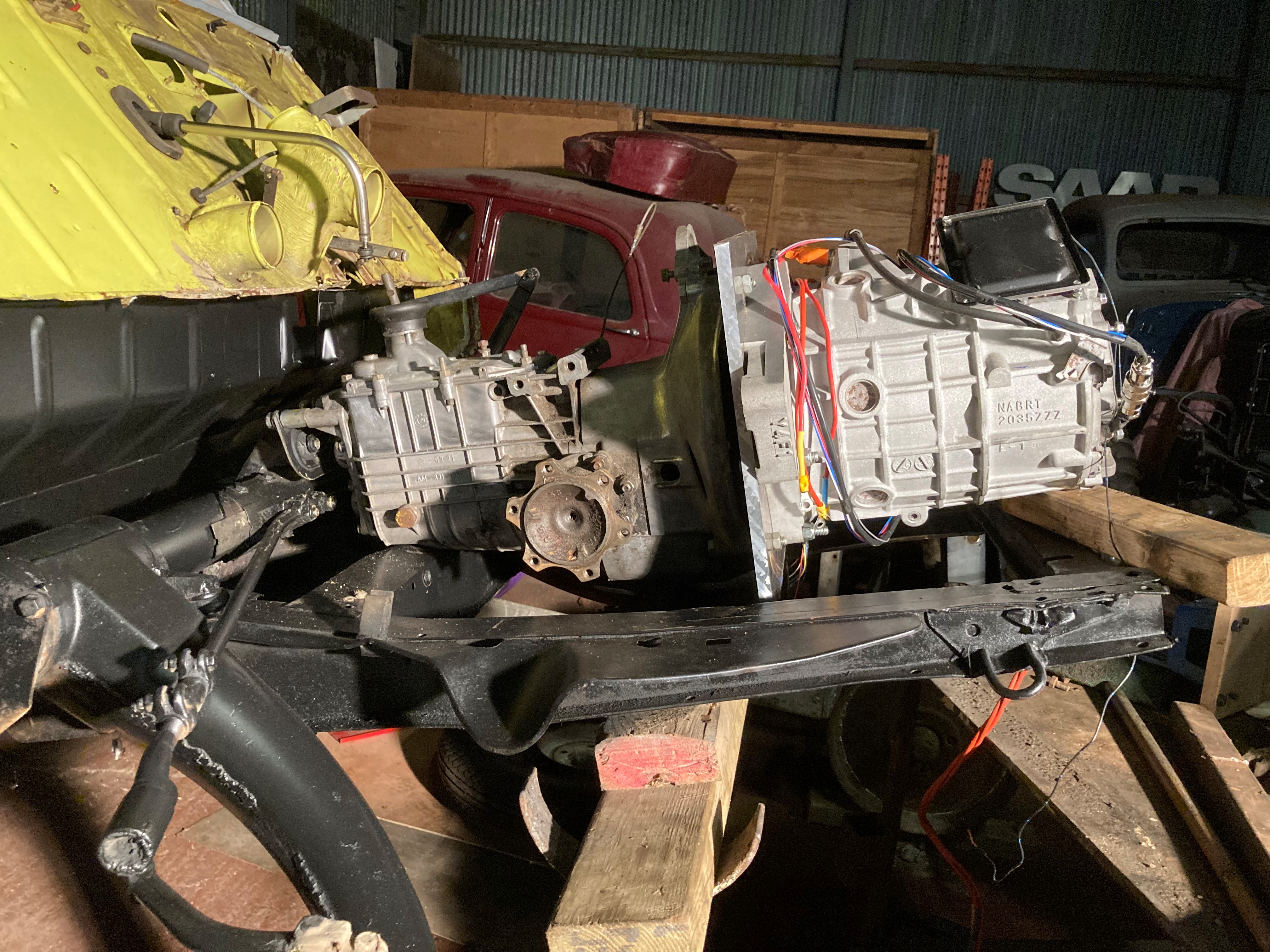

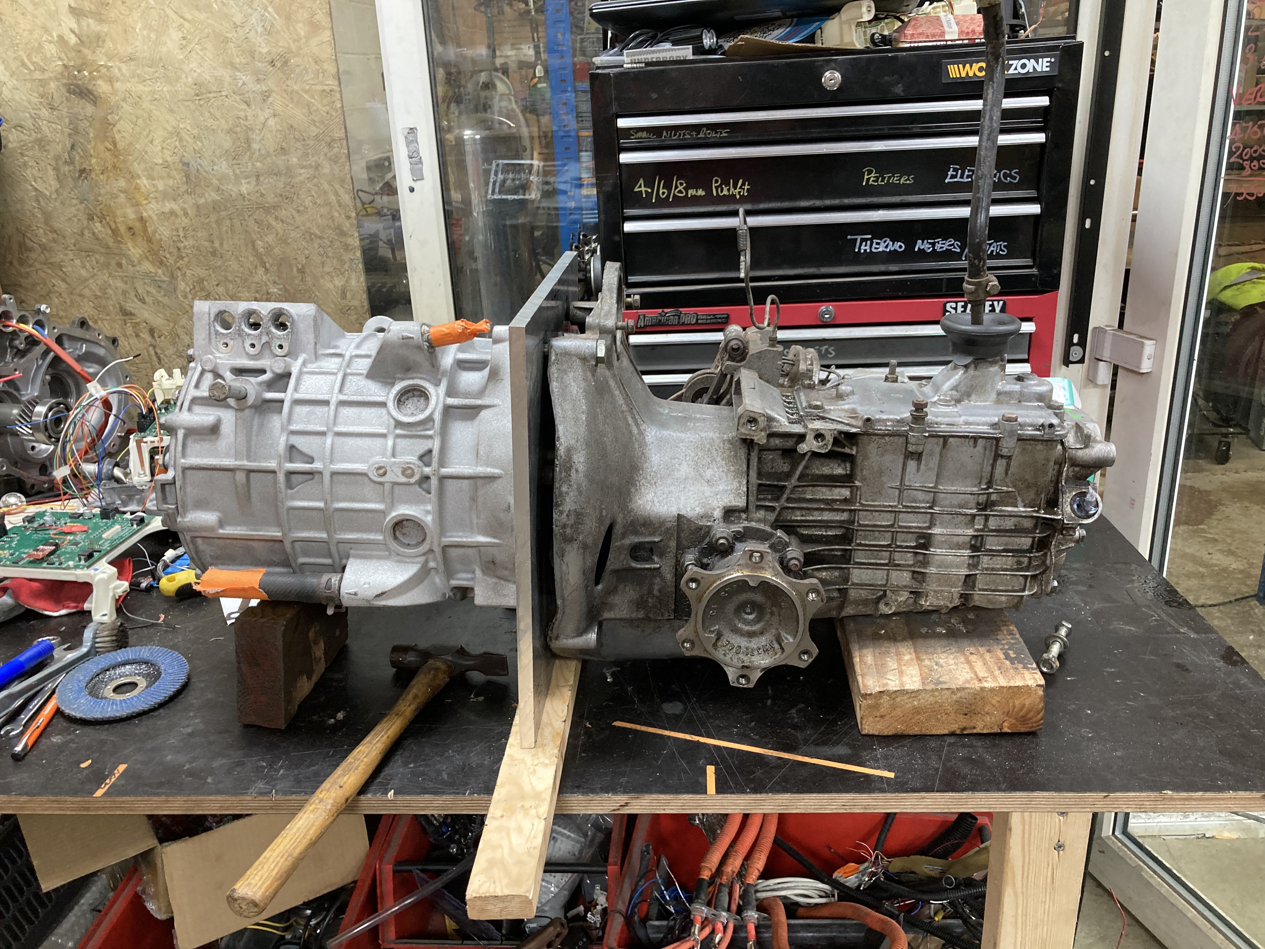

The Smart pack has now been torn down and yielded about 40 useable cells , giving me about 160 v but as the miev moptor will work way above this I'm considering either adding useable bits of another Smart pack to give me 144v each side where the fuel tank and spare wheel used to be or tearing down a cheap 2019 Outlander pack and hiding modules around the place... mmmm
I also managed a couple of hours trial fitting the motor and 2cv gearbox

Is it just me or is the 2CV transmission tiny compared to the (not so massive) Meiden motor?
I mean it's around 25cm x 35cm, right?
