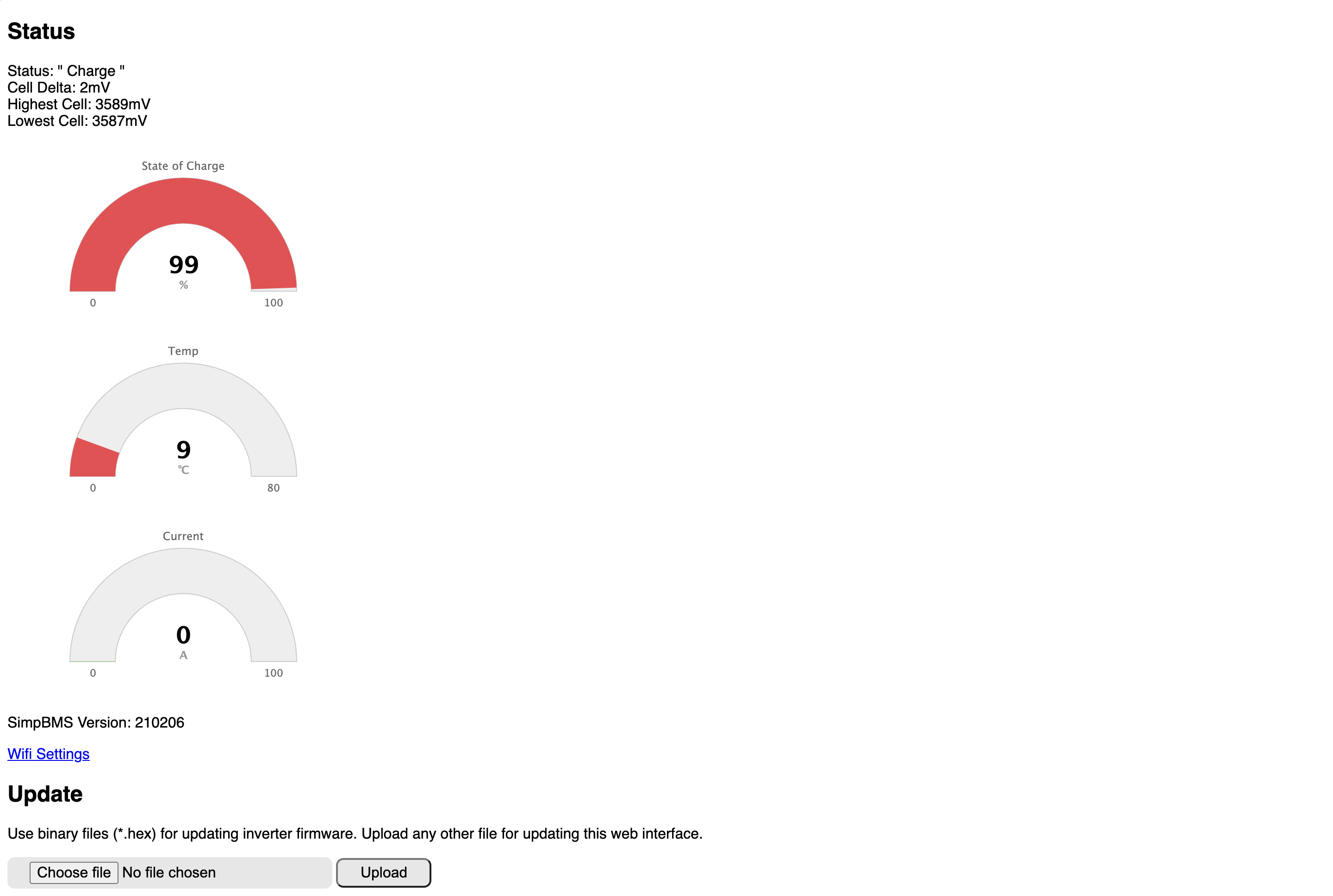

On my current crusade to put a web ui on everything, I've got a rough and ready web UI started for simpBMS
Very early days, but just stuck the Serial2 (pin 10) usually used for the nexton display to the rx on a D1 mini
https://github.com/jamiejones85/SimpBMSWebUI
Currently only 1 way communication and just dumps the output to screen for now. Pretty gauges to follow, unless someone else wants to make a start.

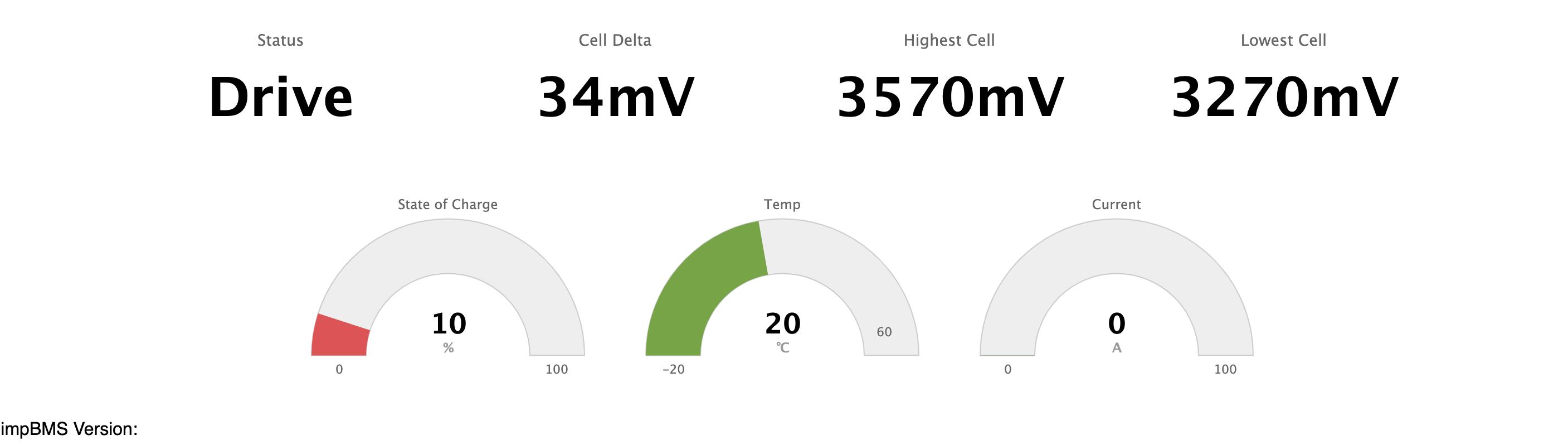

Re: SimpBMS WebUI
Updated with some gauges.

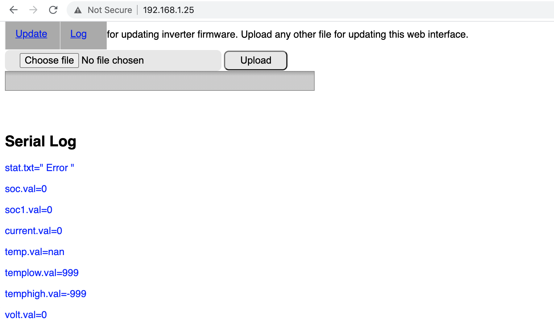

Re: SimpBMS WebUI
Just made some visual changes.
