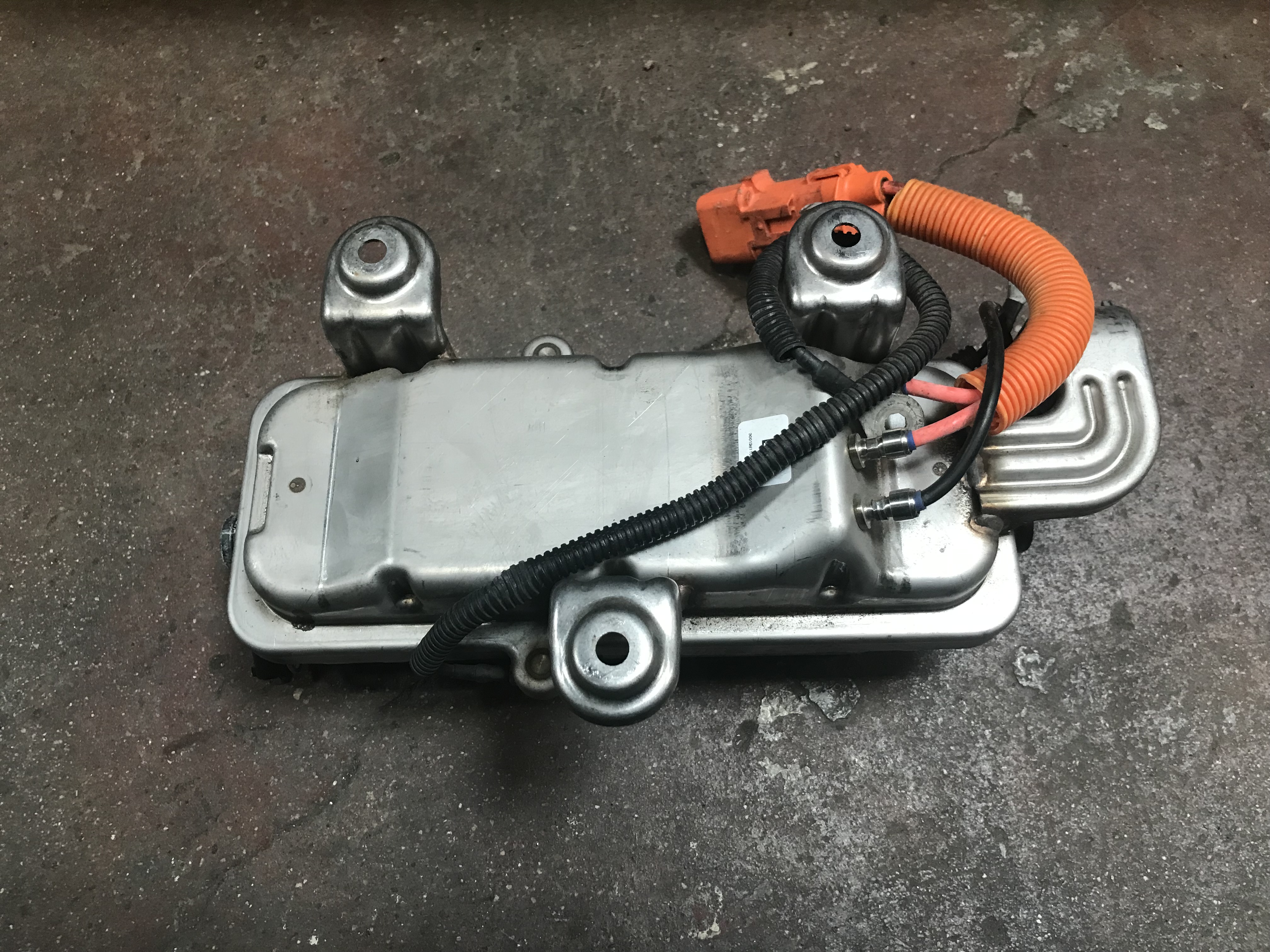

Gregski
Posts: 3159
Has thanked: 631 times
Been thanked: 1607 times
Re: Chevy Volt Battery heater
Post by Gregski »
is this the animal you speak of, I had one in my hand the other day while searching for a DC to DC converter high voltage orange wire harness, neither I or the seller could tell for sure what this thing was, it appeared to have been made in Germany
Posts: 3795
Been thanked: 411 times
Gregski wrote: Sun Jan 30, 2022 1:43 pm is this the animal you speak of...
No that is legitimate EV 5kw eberspracher heater. It is operated by SW bus which is a different thing from LIN bus. I have one at home and i havent yet been successful with it. I would need to make sw can circuit...
The one we were talking about is 750W wire heater which is also dispayed in the video.
