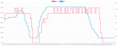

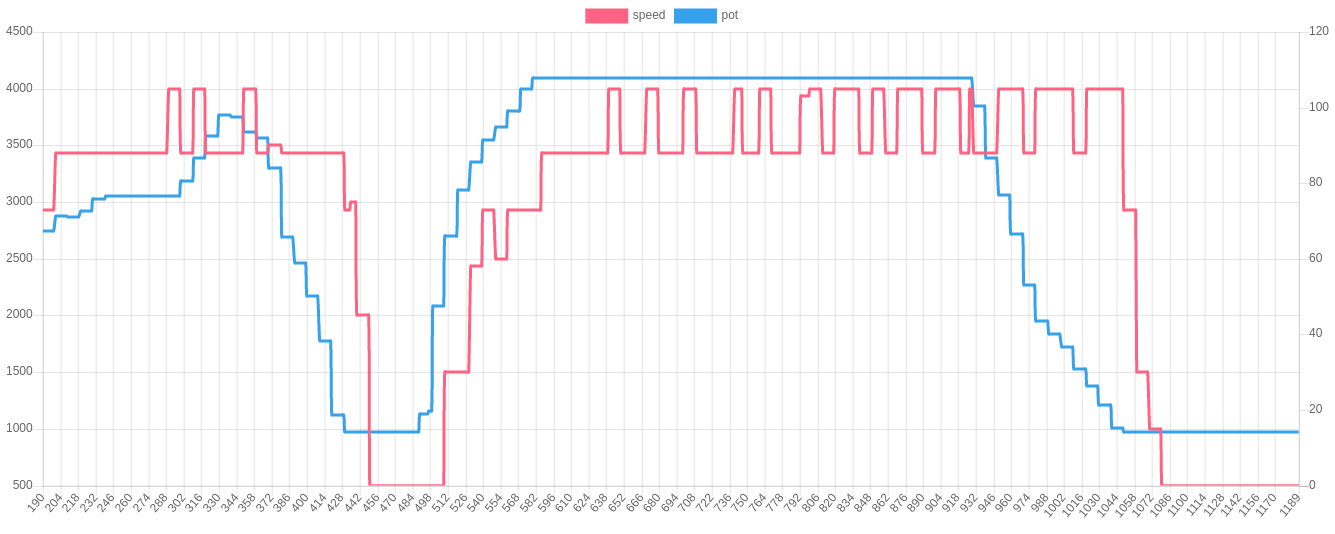

Strange - the maximum that I can overclock the engine on this firmware is 6 hz 88 rpm. https://openinverter.org/parameters/view.html?id=20 In the inverter configuration, the previous firmware is 4.97.R-sine. She works!

Yahha777 wrote: Fri Feb 19, 2021 3:07 pm Strange - the maximum that I can overclock the engine on this firmware is 6 hz 88 rpm. https://openinverter.org/parameters/view.html?id=20 In the inverter configuration, the previous firmware is 4.97.R-sine. She works!
Everything worked out! Changed Potmode settings to DualChannel and it all worked! 8-)
https://openinverter.org/parameters/view.html?id=21
