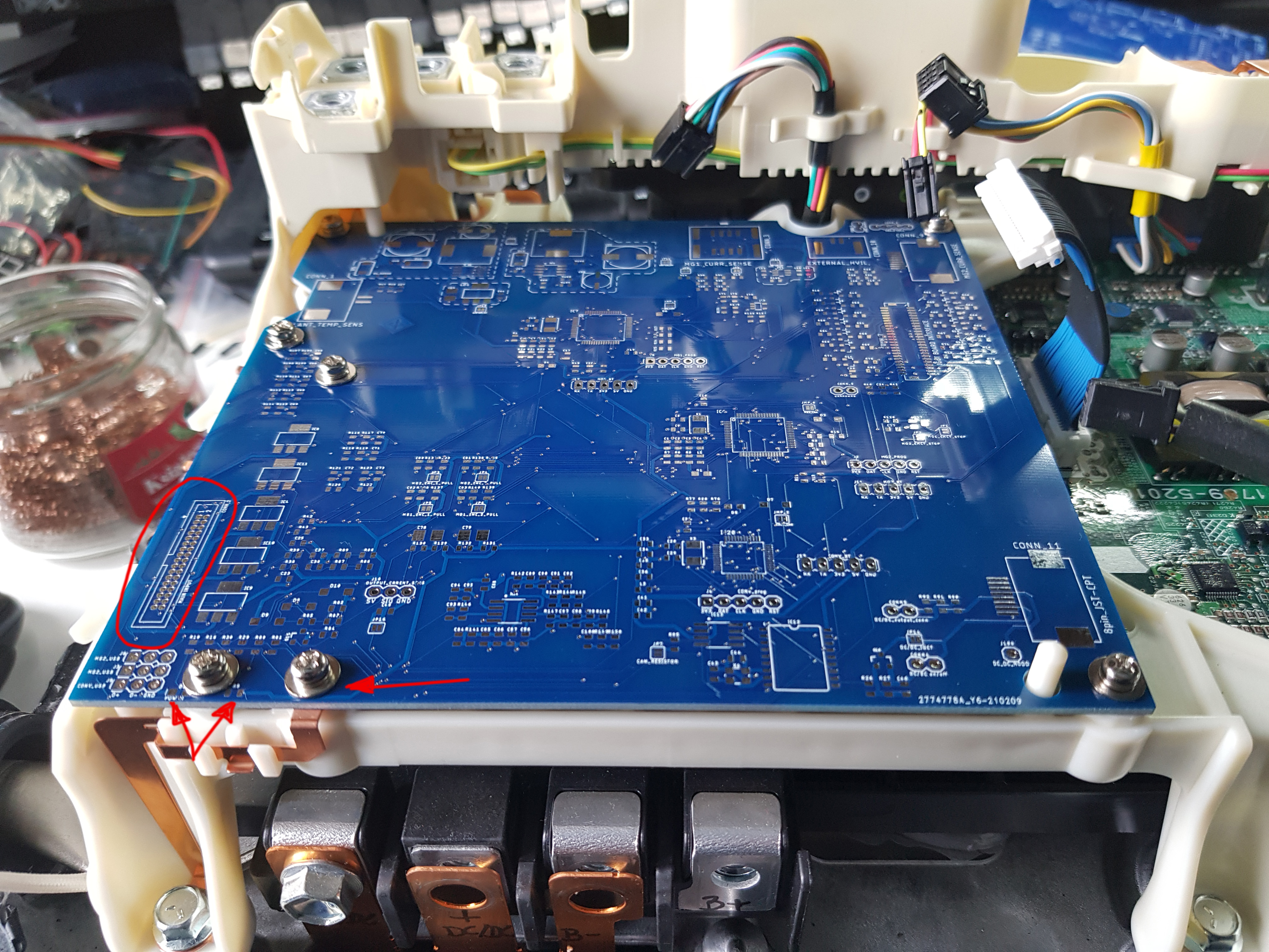

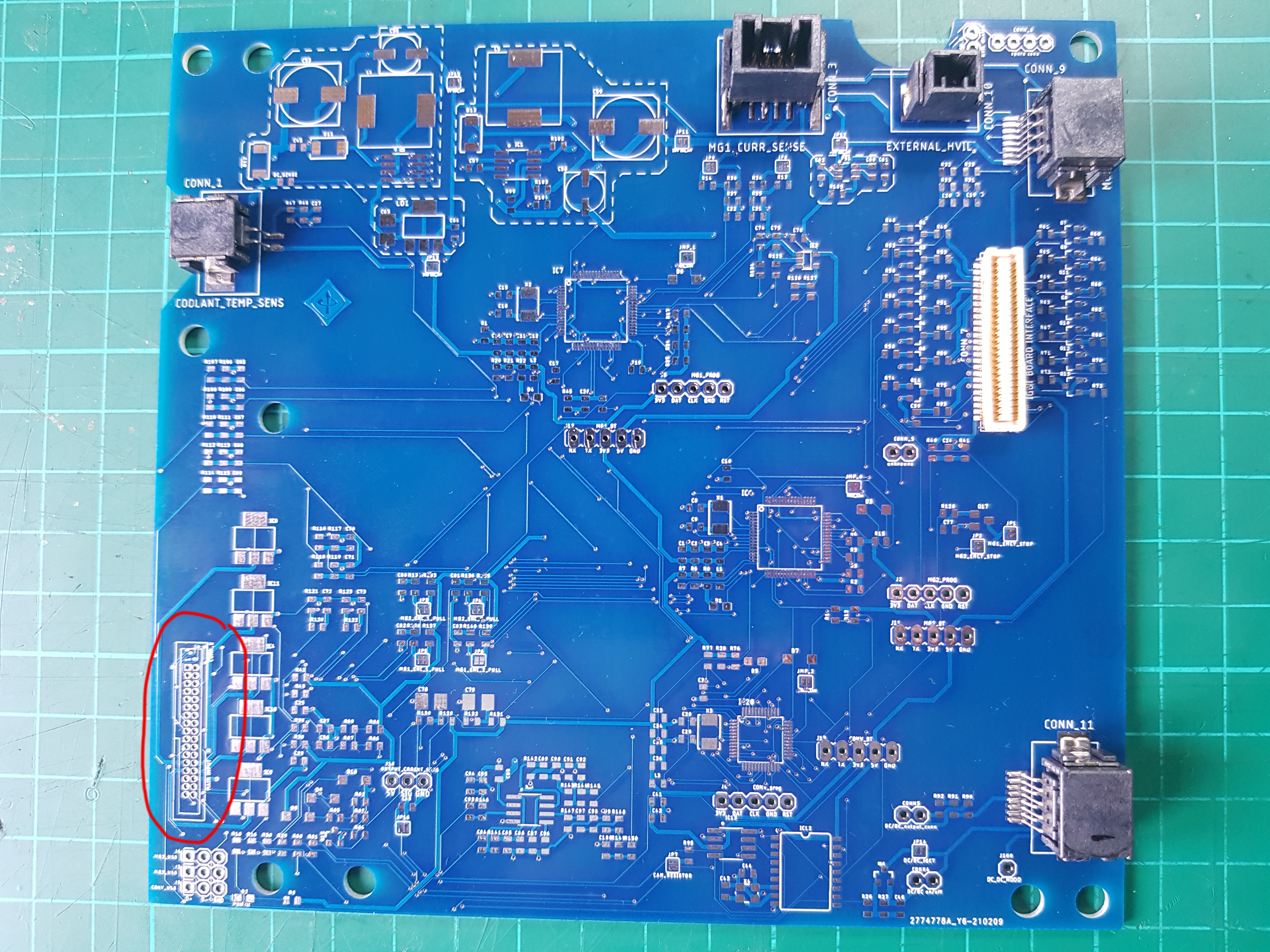

Today I've received PCB's.
Things that came up:
1. naked vias -no silkscreen. Manual painting needed.
2. main connector half a size -I don't know whose design it was, but now I'll have some precise soldering lesson. LOL
3. some parts around the nuts needs to be rearranged, but nothing tragic.
Fitting in Yaris inverter is perfect.
I will need to design ground pads for bottom layer for ground connection.
Two bolts have special tabs for ground connection to the chassis.
Common GND is important to omit most connection problems.
Posts: 4007
Been thanked: 1139 times
Re: VESC-like Toyota brain
Looks great:) You probably got the 1.27mm pitch version of the 34way connector.
zilion
Posts: 58
Joined: Tue Feb 02, 2021 7:50 am
Location: Poland
Post by zilion »
Jack Bauer wrote: Mon Mar 08, 2021 3:57 pm You probably got the 1.27mm pitch version of the 34way connector.
Yep, that's my case.
I was so confident, that I haven't printed on paper before ordering.
What can go wrong? XD

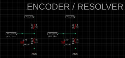

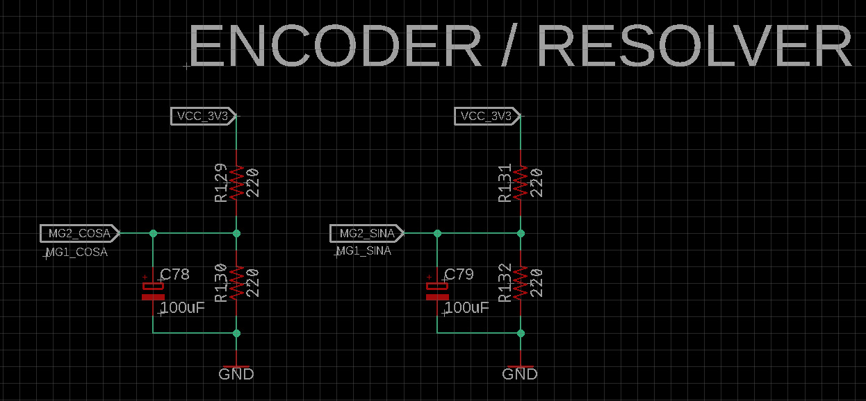

I'm having doubts about resolver schematics.
C78 and C79 are getting slightly warm, board is taking 100mA more current and there are no shorts.
Should I rise values of resistance in this voltage dividers?
zilion
Posts: 58
Location: Poland
Post by zilion »
Well, I've raised all resistors to 2.2kOhm, and now its fine.
But I'm worried if resolver will get enough current :)

Been thanked: 1918 times
I'm a bit surprised about 100mA from the resistor bridge. Because 3.3V/440 Ohm = 7.5mA. Times 2 15 mA. Hmm. The bridge is only loaded by ADC input impedance, so I think 2k2 will also be fine.

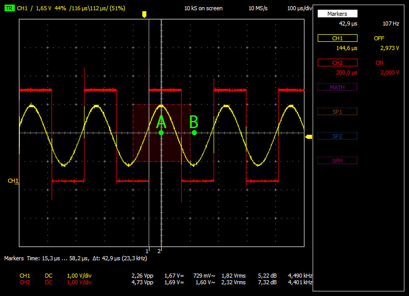

I'm still struggling with resolver.
I have some questions, that maybe someone can enlighten me :)
1. I can't configure injected ADC readings with DMA. Looks like STM32F1 doesn't support this, but only in interrupt mode.
Regular ADC can work with DMA, not injected.
2. I can't probe sine twice in one PWM cycle. I fire ADC reading with TIM3.CC4 for point "A" (on picture below), and then I must change TIM3->CCR4, but it will be loaded in next PWM cycle. It's written in shadow registers witch are updating at the beginning of the next cycle.
So in every cycle I can read at point "A" or "B", but not both.
But should I even worry about this? Maybe I don't need such resolution and just read at one point?
Real quick: no, injected channels do not support DMA. On the other topic check the existing code. Thats why resolver frequency is only half pwm service frequency

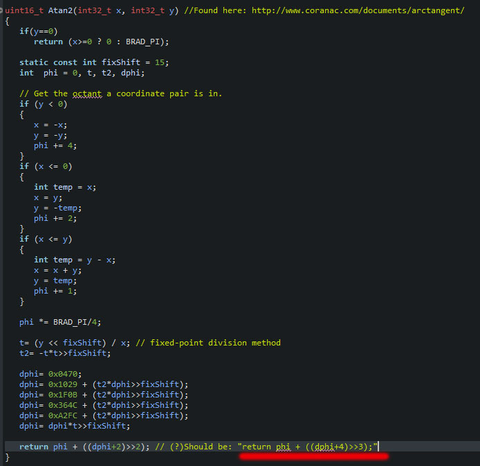

I'm trying to understand Atan2() method, and I've found some inconsistency with the reference document.
I don't know yet how big impact it makes, but maybe someone could explain this change to me? :)
In the original implementation 2*PI was represented as 32768 whereas in my variant it is 65536. Sorry about the magic numbers :roll:
