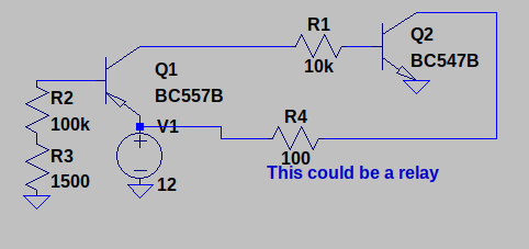

I'm trying to get around a microswitch for reliability reasons. Toms solution is super cool but does a bit too much for my needs. I already have Damiens Tesla charger board handle CP signal conditioning and interpretation.
Using the PP resistance spawned an idea: R3 is the resistor in the charging cable which is at most 1k5.
Would work likewise with just a strong P-channel MOSFET and no relay. But somehow I don't trust MOSFETs.

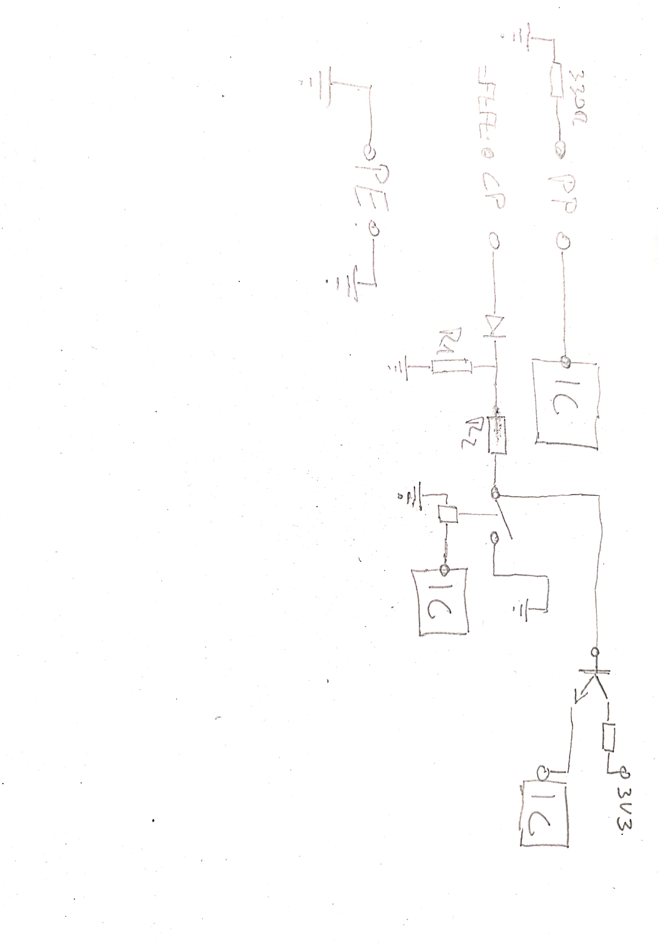

Re: How to detect a Type-2 EVSE connection

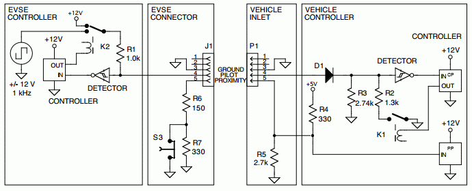

Looking at this picture
I think this might work
Should make the charging station output 230V/400V AC and then use a relay, as before.- johu
Ah well, that does all the signalling back to the EVSE but that part is already in the charger.
I simply want to switch on a relay as soon as a Type-2 connector is plugged in. To power the charger in the first place.
But yes, low pass filtering CP is also a good approach. So basically your design minus R1 and R2 would actually be a relay with the other end connected to 12V

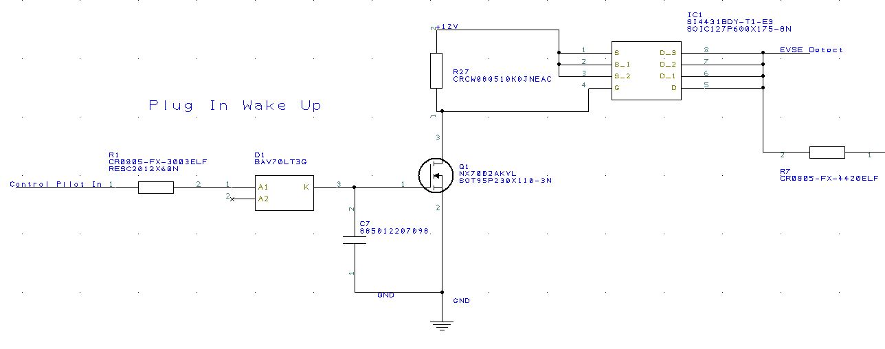

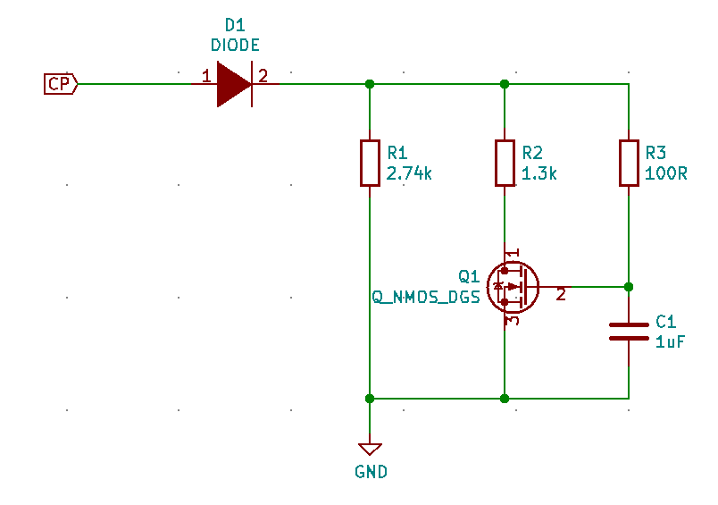

So if you just want to wake up on CP.
Quite a simple circuit, has worked will for me so far in most applications.
Awesome, thanks!
Just one question: how does it disengage? I mean how is C7 getting discharged?

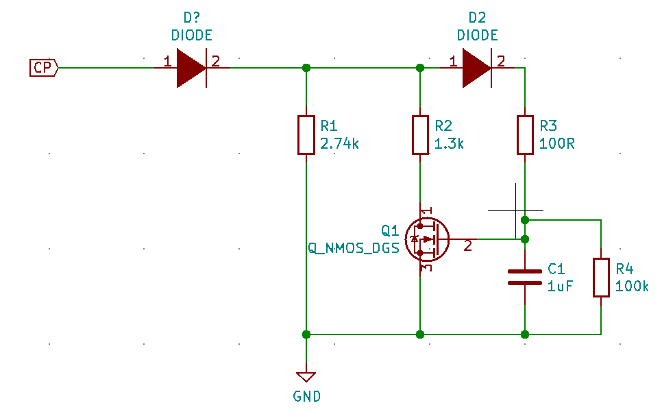

- Posts: 6709
- Has thanked: 368 times
- Been thanked: 1536 times
It's Toms design from 5 posts above. Just added a high value (2M7) resistor in parallel to C7.
Feeds the pulsating CP signal through a diode so it can only switch ON the nfet, not off. C7 makes sure it stays on during the off-state of CP. The nfet switches a pfet (could also be a relay) that supplies the loads (pump, charger,...)
I've made one of these, but this causes the EVSE to close the relay, probably not the end of the world, but I'd rather it didn't but I can't think of a way to achieve this.
At the minute I'm using the even poorer mans method of leaving the key in the ignition so the charger/DCDC, BMS etc get powered upBMW E91 2006
Like i said i use PP to pull down IC pin x and signal EVSE is conneceted.Bigpie wrote: ↑Wed Aug 11, 2021 8:16 am I've made one of these, but this causes the EVSE to close the relay, probably not the end of the world, but I'd rather it didn't but I can't think of a way to achieve this.
Then i connect CP through diode and R1(2K7) to GND directly. R2(1K3) is connected through relay to GND so it forms a divider on connection. IC is managing the relay. Then i connect small Nmos gate to R2 so IC can sense PWM. I still need to sort out the code for PWM duty sensing but everything else works.
Important difference with using PP signal for sensing is i can use it passively without anything connected to CP pin. I can also delay connect condition and start pumps and DCDC in any order i choose. For example Your circuit wouldnt work well with Outlander charger. There may be other devices also...
I could build RC filter and sense resulting voltage with analog pin too, but then CP result becomes unstable...

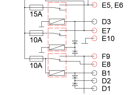

i use three relays and a button behind the fuel filler flap. The button is on D2, B1 is switched by the charge controller and holds the relay. F9 supplies the charge controller, E7 supplies cooling and BMS. D3 is connected to ignition. If no charging takes place for a certain time after pressing the button, the charge controller switches itself off again, just like after the charging process has ended. E8 is the power for forward, and reverse switch and so the car is imobylized during charging, D1 is read by the charge controller (pulled up to 5V) and ends the charging process prematurely. E5 / 6 corresponds to ignition and is not necessary for most

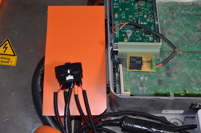

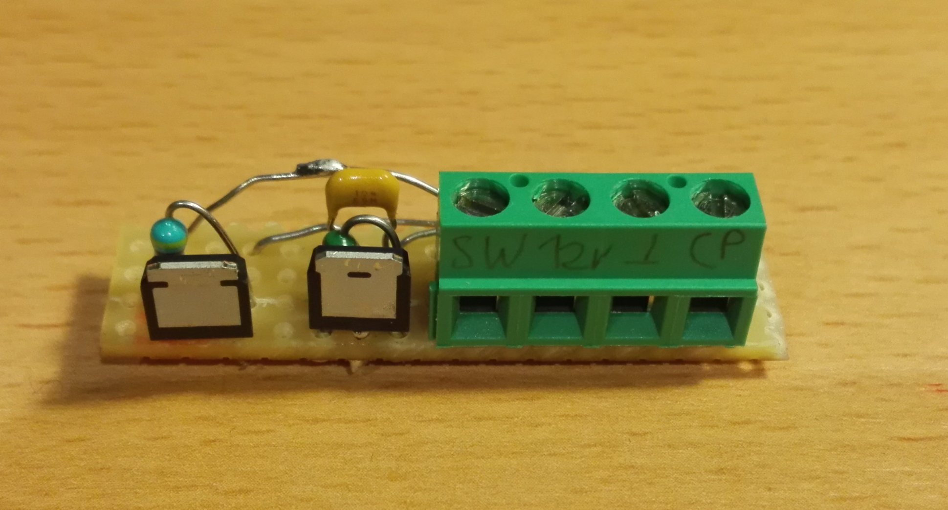

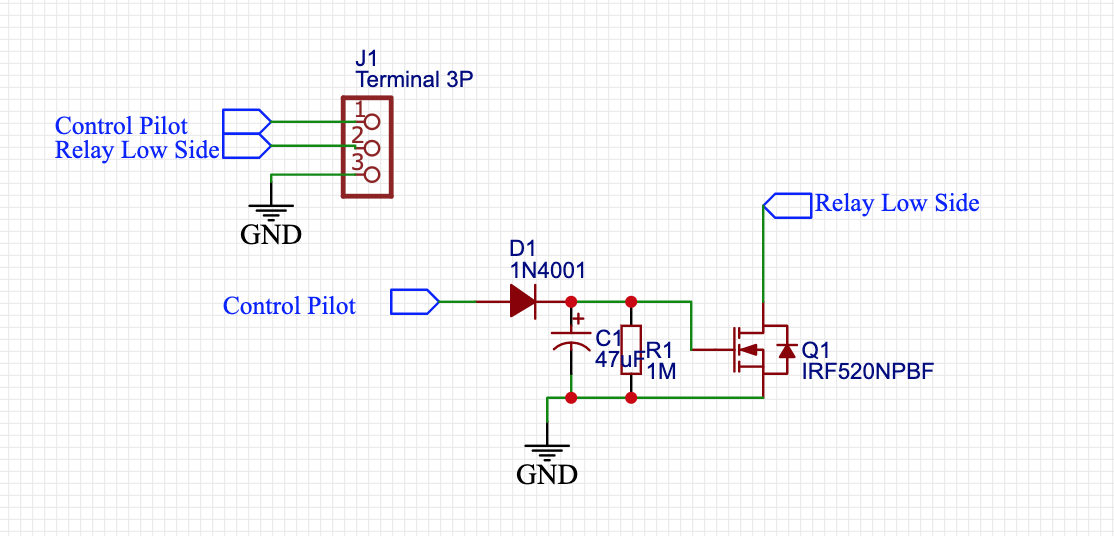

I have integrated above circuit into a Gen2 Tesla charger. So now permanent 12V can be fed in via Pin B12 which is otherwise unused. Its traces are beefy enough to carry the current. CP and GND are stolen from the control board as well. Switched 12V is then send back to what is usually the 12V supply input. So as soon as CP is detected the charger turns on and with it the DC-DC converter, BMS, contactor supply and water pump. In the Volvo conversion 4.5A are consumed and the traces are holding up.
Here's a picture. Red cable not yet soldered to the correct pins, should be on the two bottom ones

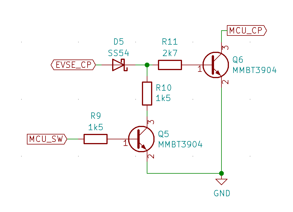

Just for anyone interested, this is my setup for type 2.
It works well but obviously relies on a MCU. Without a MCU, it probably wouldn't be appropriate, as the CP line is PWM, so I guess you already reached the conclusion that this would be better achieved using PP.
It applies 2.7k to the CP line, which wakes up the EVSE. It allows 12V on CP to be detected by a microcontroller, and allows the controller to apply 1.5k to CP which instructs the EVSE to close its contactors.It works well but obviously relies on a MCU. Without a MCU, it probably wouldn't be appropriate, as the CP line is PWM, so I guess you already reached the conclusion that this would be better achieved using PP.
- Posts: 6709
Alright yes, basically the Tesla charger board pulls down CP and the circuit I added tries to not alter the CP signal at all but just "reads" it
