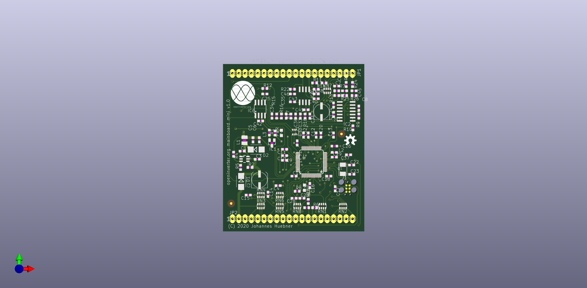

I found it was time to do a new main board that nobody was asking for
I have shrunk the outline from 80x80 to 60x70 and completely changed the header design. It's now single pin headers.
I found JLCPCB has res nets in basic parts so I used quite a few a these to save space. I have also switched to the improved resolver excitation design that runs straight off 5V.
I have also ditched the ULN2003 as it wasn't appropriate for many applications and you'd end up adding an external relay or FET anyway. Now the board just exports 3V3 outputs via 470 Ohm resistors that you can use to drive an NPN transistor or FET.
Also removed the Olimex header as that adds to the profile quite significantly.
It is mainly intended to be used as a daughter board. Will see what for.

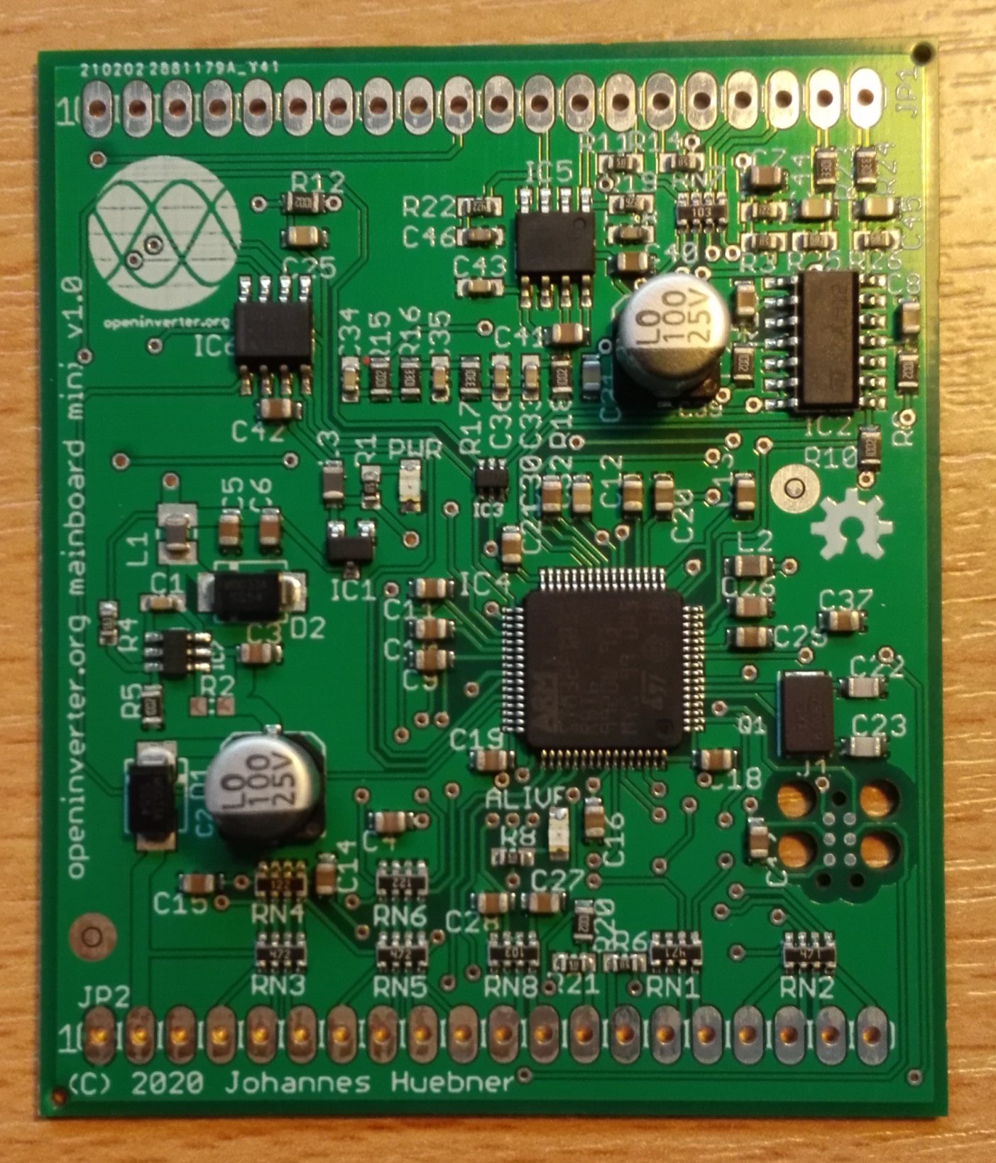

It has become physical

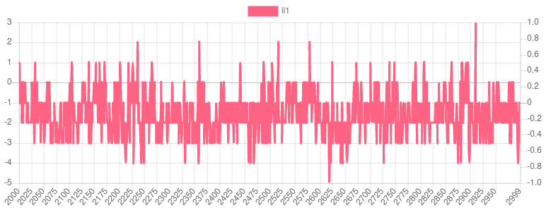

Tested it on the i3 inverter and it seems to work. It also seems that ADC readings are less noisy, like 8 digits jitter as opposed to 25 digits on the larger main board. But this can be easily back-ported: I replaced the LC filter with 100 uH/10 uF as opposed to 10 uH/1 uF.
I have also decoupled the CAN transceiver and the wifi module is no longer on board and must be supplied by an off board regulator.
I think I'll base the i3 drop in board on it.

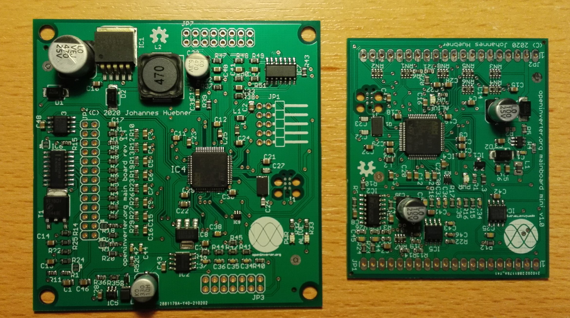

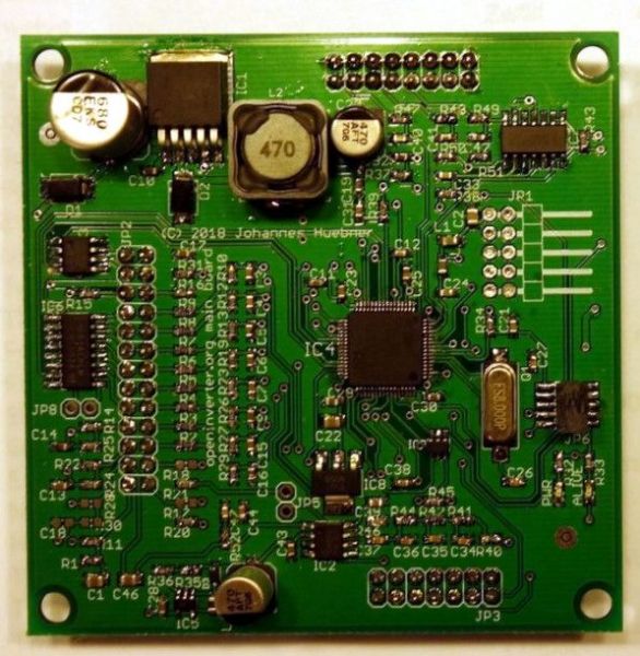

Re: Mini Mainboard
For the audience of the forum, I will attach files, a visual comparison of the motherboard Rev 3 and restyled unified motherboard-mini V1.0
- Posts: 5788
- Has thanked: 157 times
- Been thanked: 1022 times
Re: Mini Mainboard
Good idea, I will improve it a bit:
