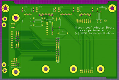

Hello forum, my first post.
Have anyone had any luck with this board in a Gen 1 inverter?

Well if you can help out with pin mappings etc. it should be quite easy to make a replacement card. I will publish the Gen2 files, they are done in a program called FreePCB. Maybe you can even make a design yourself. The adapter boards only route the various signals to the headers. All the logic stuff is handled on the V3 board: https://openinverter.org/shop/index.php ... duct_id=58

I've released the design file for the Leaf Gen2 adapter board: https://github.com/jsphuebner/inverter- ... dapter.fpc
It is made with FreeePCB: https://www.freepcb.com/
If anyone feels like porting it to a more standard tool (that also shows a schematic), please do. Maybe it also helps doing other adapter boards like the Gen1 Leaf.

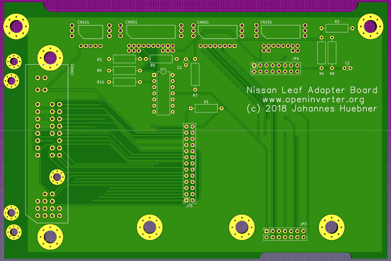

OK I've got a schematic, could you confirm the values of r1 and r9? There are no units in the fpc file.

I've attached a pdf. It's not beautifully laid out I'm afraid. The pin numbering on the leaf connector (CN001) on the fpc was a major pain. I'd recommend having a check over it to make sure I've not cocked anything up.
I still need to do the pcb layout. When that's done I'll zip up the KiCad project for you to do with what you will.

Still tinkering with the schematic.
Board outline ,all connector positions and mechanical holes are from the gerbers I generated from the other tool and imported into KiCad. Holes are sized for m3 and m5 fasteners.

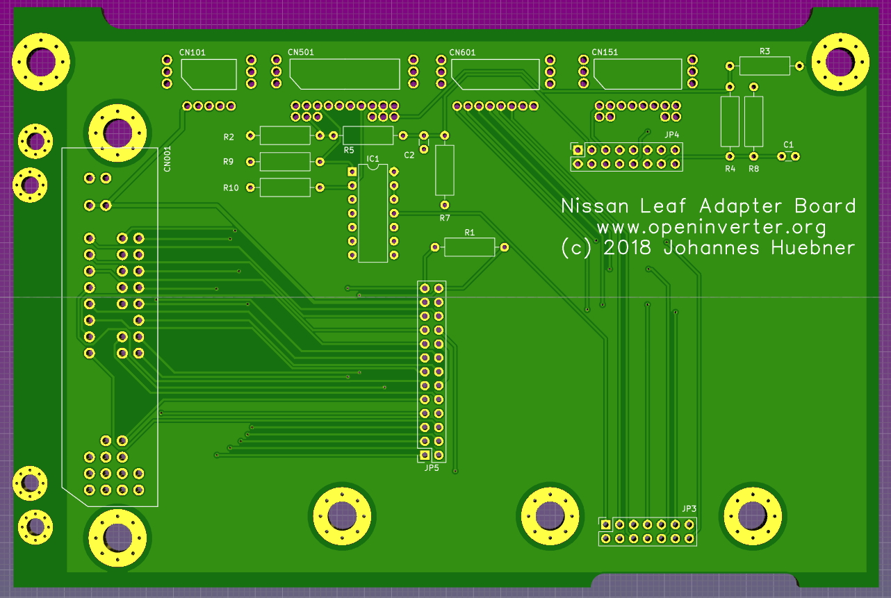

Are you sure the screw holes for the connector are correct? I think one is missing and the others look out of place.
EDIT: yes there must be one between the two pin groups

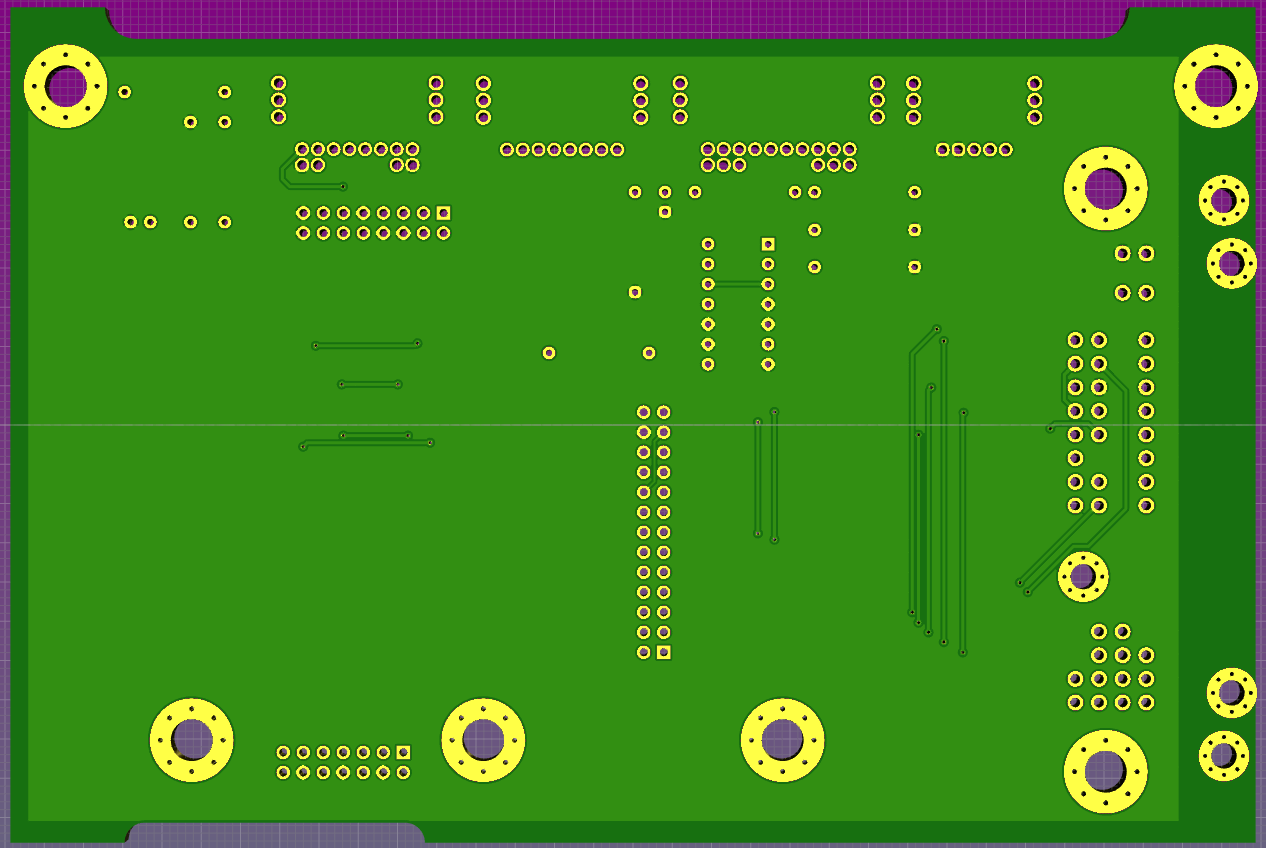

EDIT2: on the original design I tried to minimize connections on the bottom layer to make the ground plane as solid as possible, maybe you should consider that.

Good spot on that hole, I'd completely missed it. There's not much on the back, I've re-routed one track. None of the mechanical mounts are connected to ground, but I could change that?

I think on the original board the top right hole (front view) might be grounded.

Cool. I've connected it to ground. I wasn't sure on the original as it appears to be just a drill with a cutout in the 5V plane. Ground connections go out through the various external connectors too - but you already know that .

I've attached a zip of the kicad project. If you open the project in kicad it'll ask you if you want to recover the schematic/pcb layout when you open the relevant editors. Say yes. I've tested that this works in a different OS VM.
I might setup a github to host it and the various footprints (including the proprietary leaf connector) if I have the time and/or inclination.
Edit: re-uploaded the zipped file including generated gerbers and with zero-length tracks removed.

Now I have an original board in front of me I can tell that some of the mechanical mountings are a fraction out so I'm going to redo the proprietary connector footprint to get it more accurate.

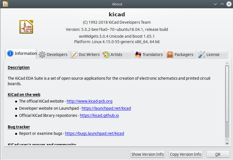

Unfortunately the KiCAD version that comes with Ubuntu is too old and it doesn't load. Gotta change to another Distro, I frequently run into really outdated software

I think I might be using kicad's own repository: http://kicad-pcb.org/download/ubuntu/

Yes, I had version 4.something
