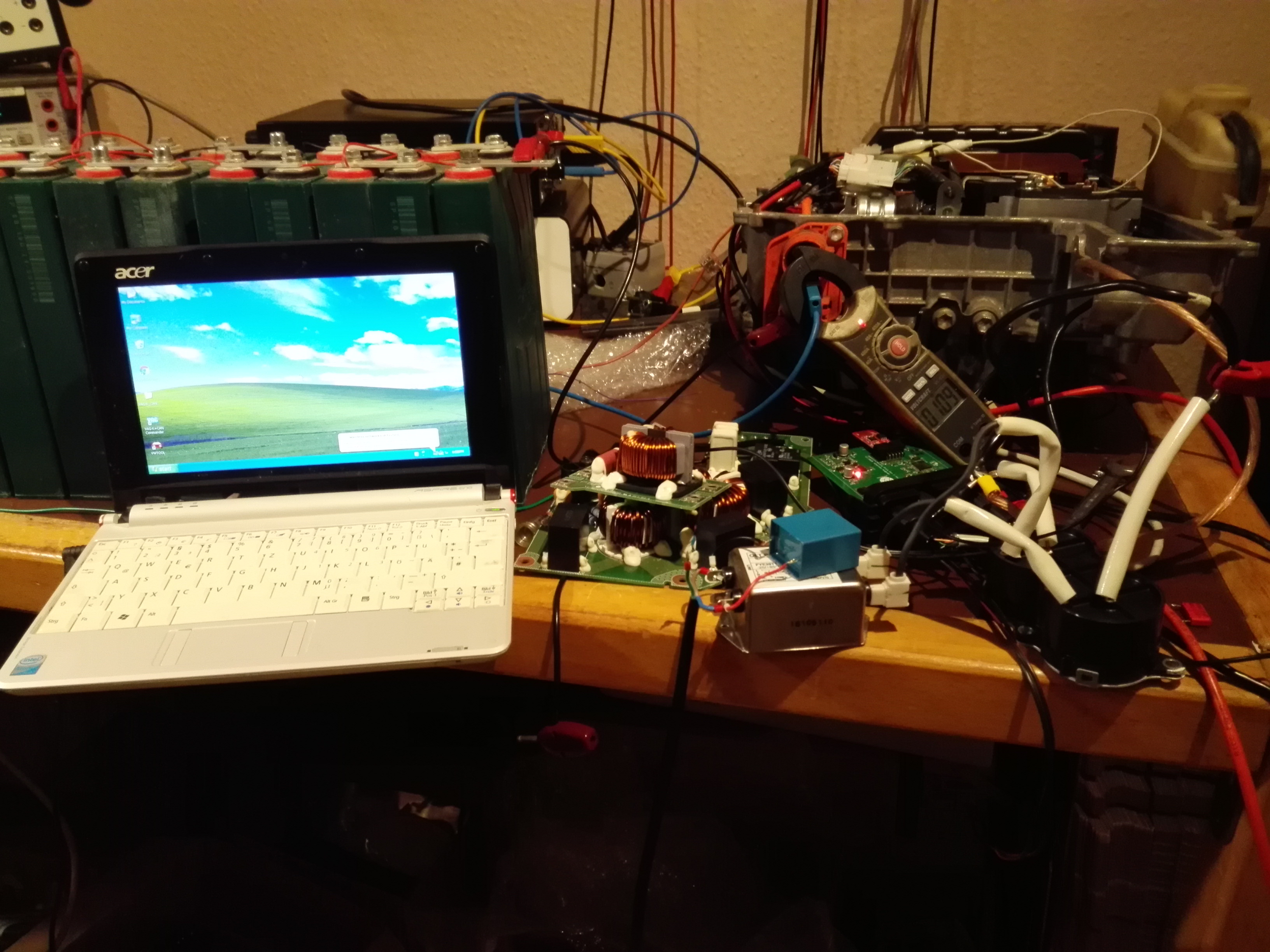

Got some new code for you: https://github.com/jsphuebner/stm32-island
So I did the obvious: hook up a 40V battery to the Prius Gen2 DC input, run the boost converter to give us about 300V DC and then run two phases at 50 Hz to give us 230V AC. Feed all that through a filter and run your appliances on it
I tried:
- an 850W coffee machine - check
- a jigsaw - check
- angle grinder - check
The most drop was caused by the coffee machine, 210V but I think thats because the battery pack couldn't keep up. The DC bus is PI controlled while AC is not controlled.
Video coming soon.
This is running on a Prius Gen2 board as is. To run it on a Gen3 Prius board you'd need to wire the buck/boost converter to the STM32.
The point is obvious: you can use MG2 to run your motor and MG1 to run your power tools. Or to make coffee.
I will change to layout to have TIM4 run the boost converter and therefor have TIM1 available to also make 3-phase AC.

What I've learned today: don't connect more brittle electronics to it. Blew the fuse in my laptop power supply. Screwless, pita to open
So robust output filtering is a must, ya know common mode chokes and such.

So, as most of you already knew: more filtering - more better.
I added a twin inductor that I found in the Nissan PDM (I think it was part of the boost stage) to the output path. And a 15u cap. Also kept the EMC filter. Immediately the voltage drops from 245 V to 210V (290 V on DC bus) denoting that we are pretty close to a clean sine wave (which would be 290/sqrt(2)=205 V).
I don't have the equipment to scope it but I bravely connected my old laptop to it and it ran just fine. Also ran a 2 kW hair dryer. That pulls 55A from my poor test pack and also runs well. It does reveal one weakness: Even though the bus voltage is kept pretty much constant, the AC voltage sags quite significantly to 180V AC.

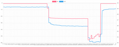

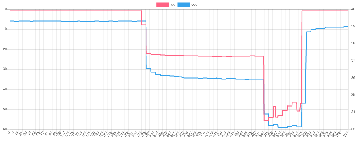

So, played a bit more. I cleaned up the wiring, most of all removed the crocodile clips.
Bottom line: the higher the load, the lower the efficiency. That is probably down to the filtering inductance being too high?
Also the higher the input voltage, the better the efficiency. Best figure was 91.8% while making 422W AC. Couldn't test the full 2 kW because then my power supply overloaded.
