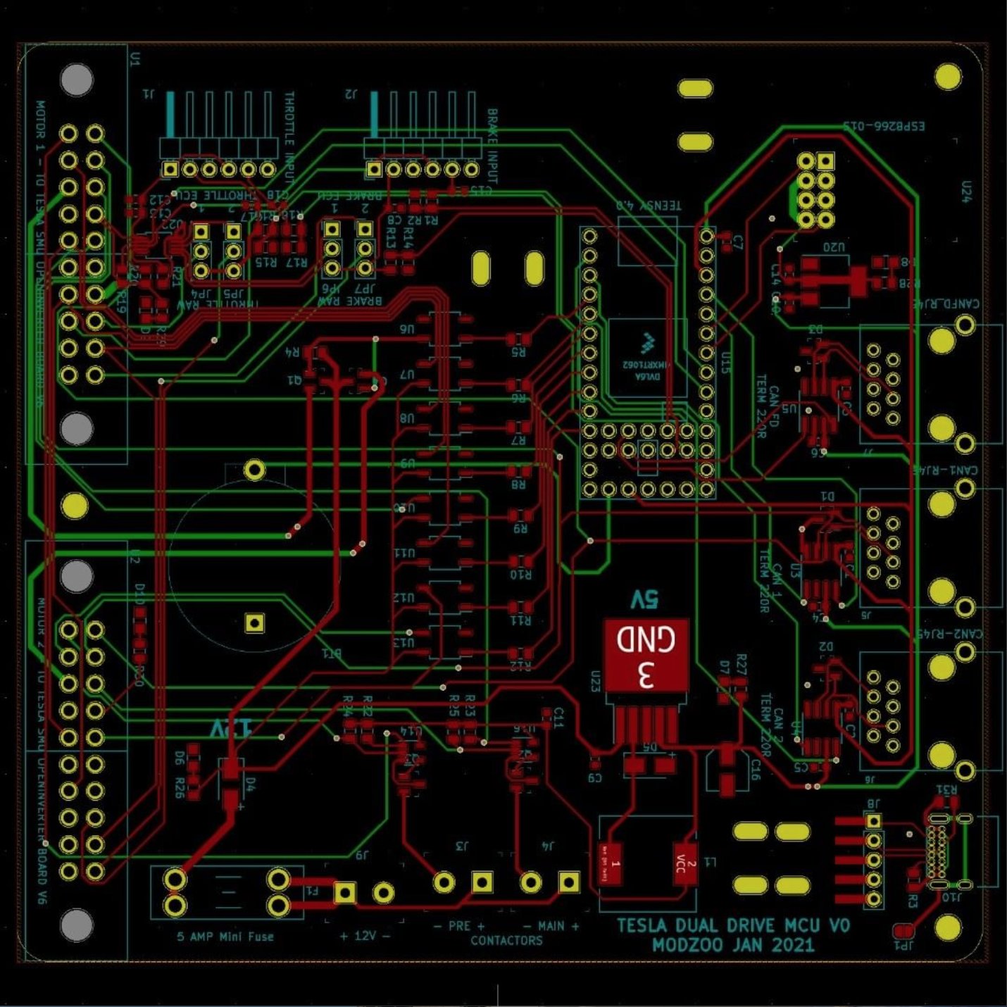

Yes. I'm running SDU front and rear with a long range Model 3 pack. I have my own control board that processes throttle and brake inputs and coordinates motion between the two. Currently testing traction control and adaptive AWD. It uses front motor during low acceleration and 50/50 split during high acceleration. I also have "drift" mode that uses rear motor mostly and checks if the angle between vehicle heading and direction of travel is getting too large, in which case it bumps the front motor (either forward or reverse) to get me back in line.
It also handles contactors by comparing the logic output between the two openinverter boards and only turning on main contactors when both are ready (with a timeout). Most of it is analog because I wanted to use it with the default firmware. The board would be much simpler when I switch over to full CAN control, but it works for now and I would rather work on control algorithms at the moment.
