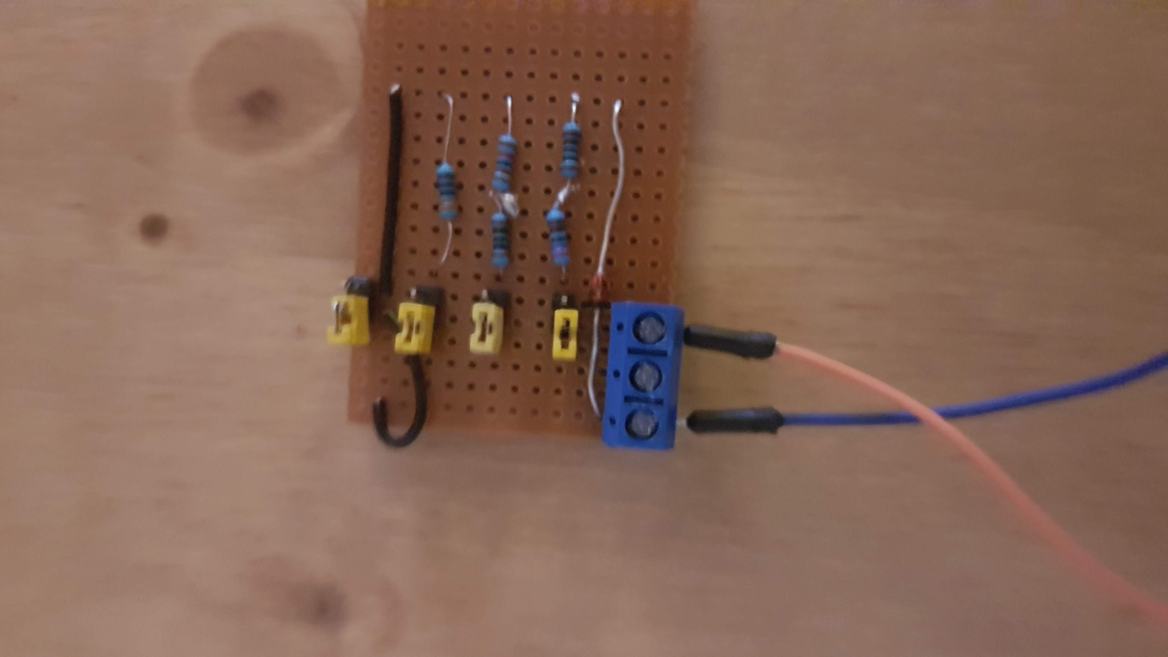

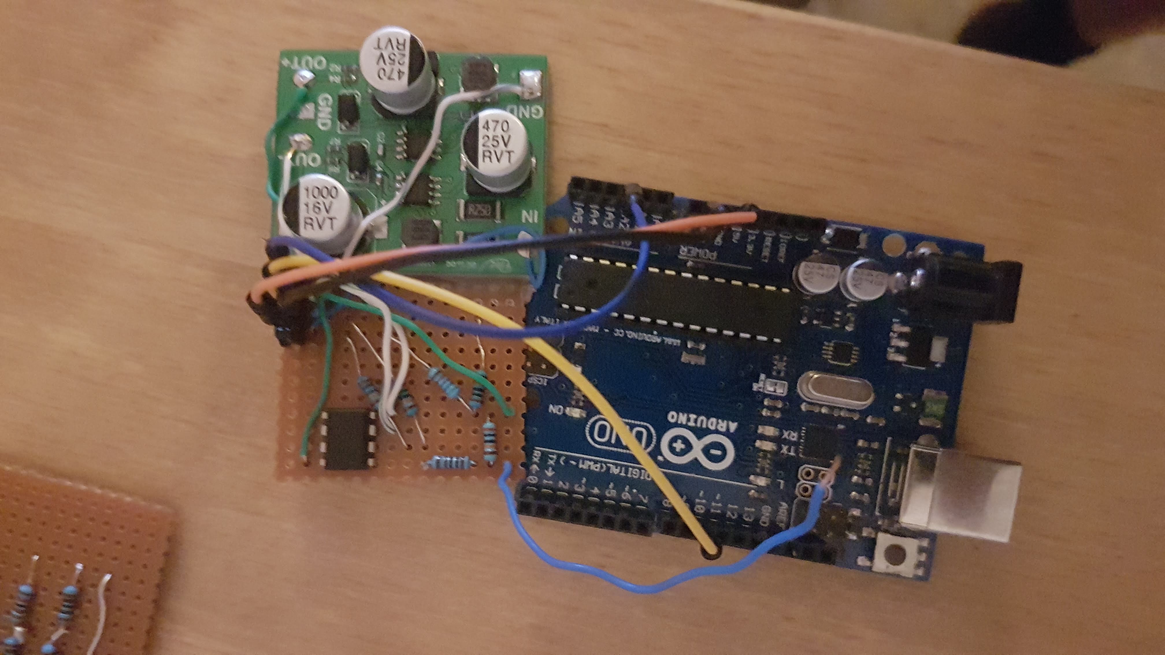

I don't have an EVSE at the moment, nor a car to charge, these are working progress.

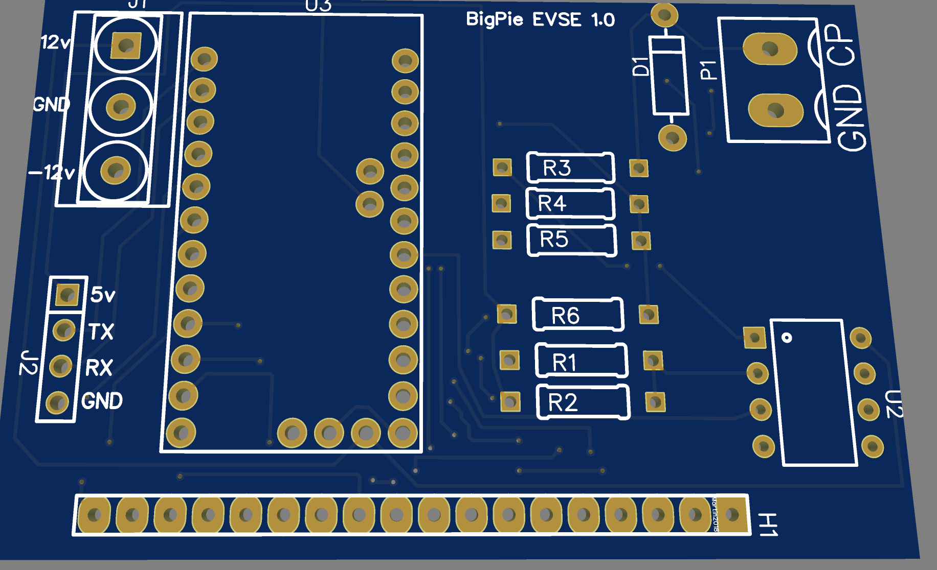

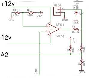

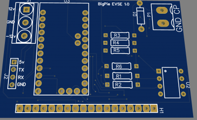

I've thrown together a some Arduino code to generate the Control Pilot signal, without any of the safety checks as a learning experience.
Schematics, code and gerbers in repo.

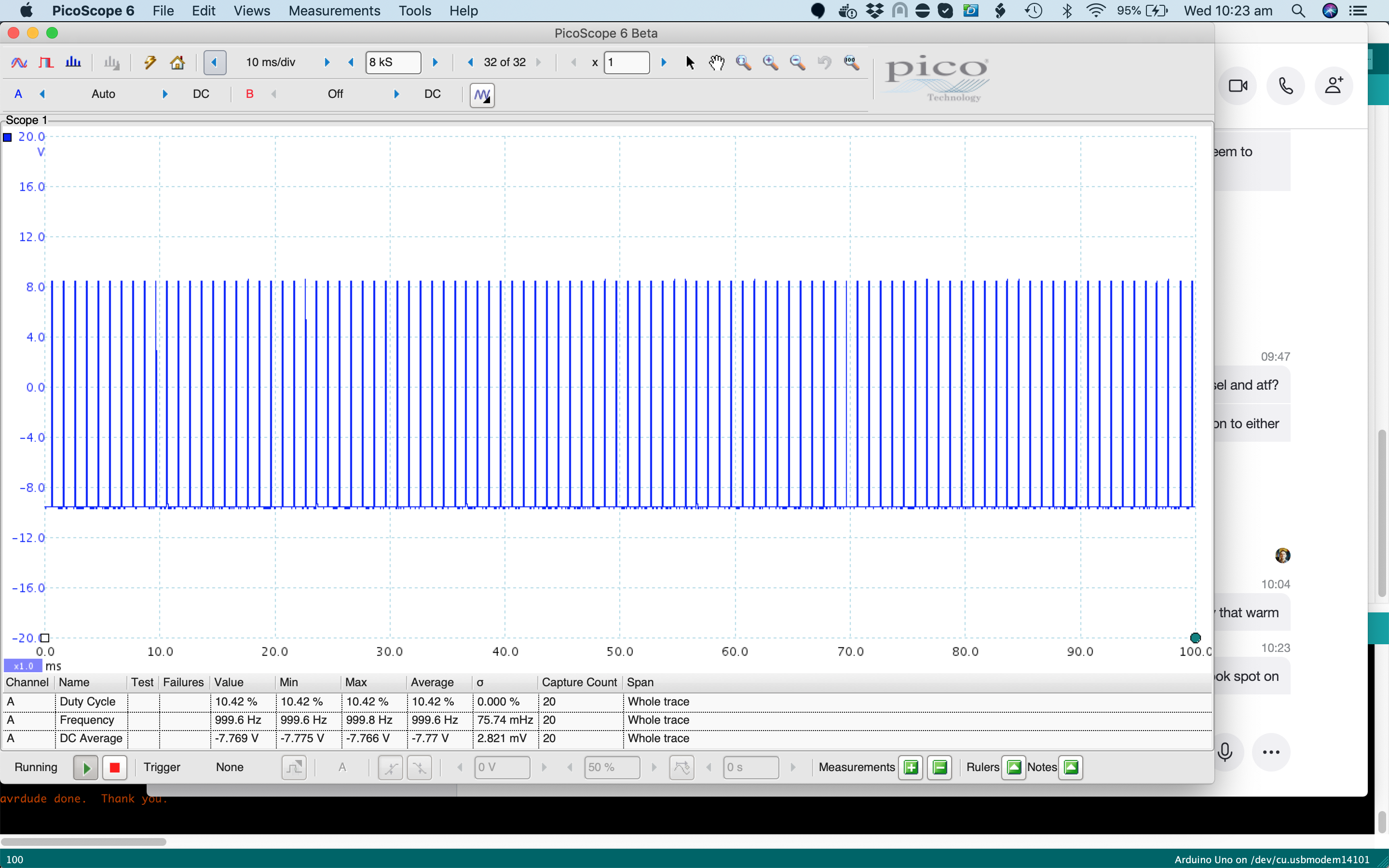

It seems to work on my EV simulator
Hard coded for 6 amps for now.
