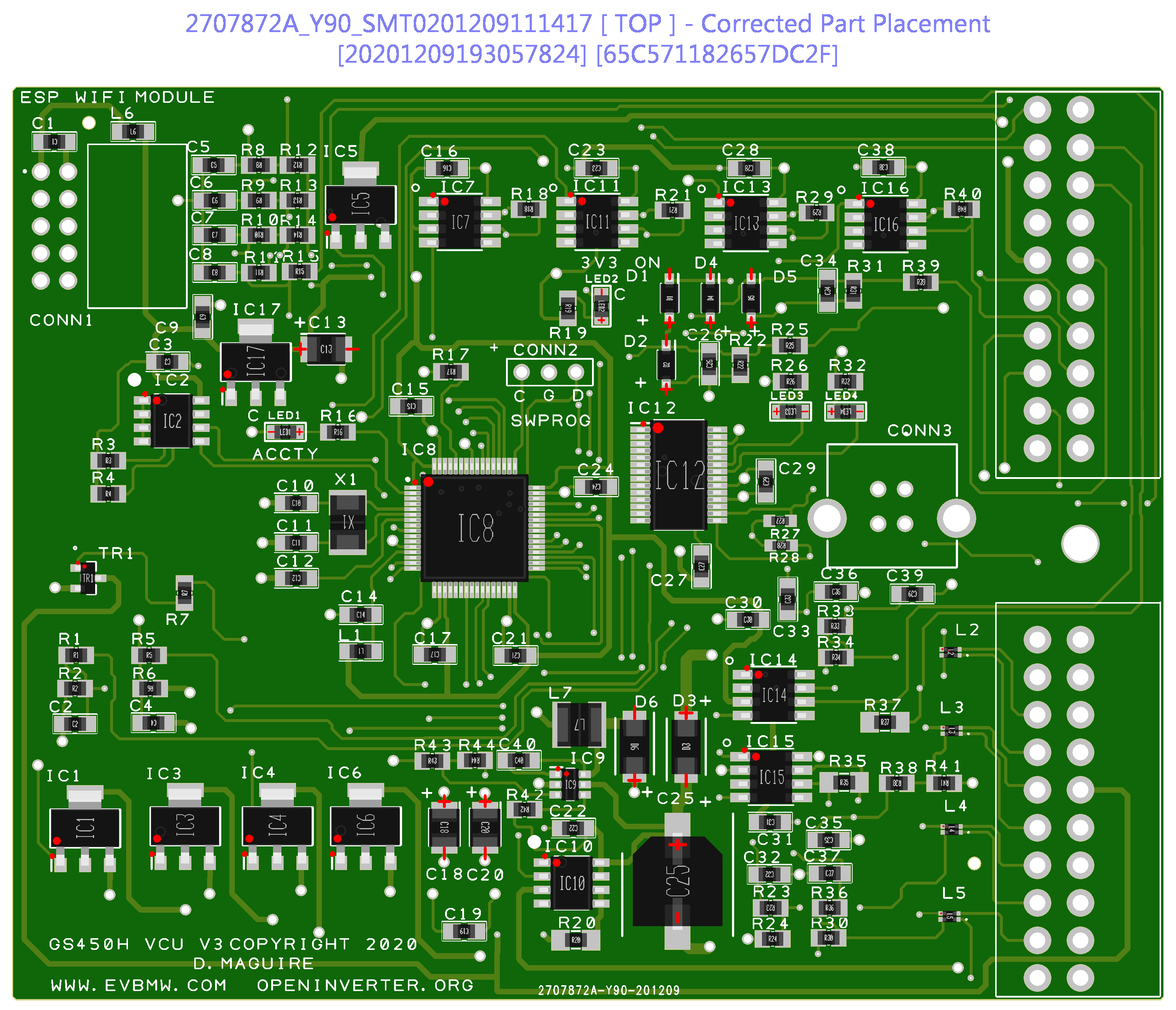

Recently while ordering some VCUs based on the SAM3X8E (Arduino due microcontroller) , JLCPCB informed me they do not intend to restock on this device for at least 6 to 12 months. This has forced me to order boards without the micro fitted and then fit myself in order to fullfill orders. Obviously this is labor and time intensive and not sustainable for any length of time. So, to combat this I have taken the step to begin migrating all SAM3 based VCU kits to the STM32 platform. In the case of the Lexus VCU this will be the STM32F105RB connectivity line device. As the SAM3 code is not compatible with the STM part this requires a code migration as well as hardware. The hardware is now done and prototypes ordered just leaving the software. Sadly I am not in a position to perform this task and so I am proposing the following possibile solutions to the community :
1)The Openinverter community take on the task and migrate the code. To support this I will provide (up to a maximum of 3) complete V3 kits free of charge to those doing the primary work. Such kits will only be provided if the person or persons involved have a track record in opensource software development and / or are contributing here on the forum. I will also assist in testing code in the E65. Should this option be chosen then both hardware and software will be fully opensource AND I will be in a position to reduce the cost of the kits in the future. A hard deadline MUST be agreed by all parties for this option to proceed.
2) I have sought out several quotations from freelance developers for the task. The best of which is priced at $800USD in a 10 day timeframe. The Openinverter community could chose to fund this cost in whatever manner (e.g. crowd funding) and forward the money to me. At which time I will engage the developer, manage the process, verify the code in the E65 and release noth hardware and software as opensource. Kit prices will remain the same in this case as it will require further input from me. Note I will not manage the crowdfunding and will only deal with one apointed member.
3) My least favorite option is where I fund the developer, manage the process and verify correct operation of the vcu in E65. If this is the choosen path then only PDF schematics, gerbers and binaries will be released. Sources will be available via patreon only and no kit price reductions will take place. This is similar to where the V5 Tesla Gen 2 charger board ended up going.
I'm placing a deadline for a decision on this topic at 2 weeks from today (23/12/20). Should there be no consensus by then option 3 will be the default. We have over 1000 members here folks. Lot of talented people. Let's try and prove opensource driven development can work:)
https://github.com/damienmaguire/Lexus- ... 3/HARDWARE

There is no impact on V2 boards as I stated above I am ordering them without the micro fitted and then fitting it myself. This is not something I can continue for much longer.

As I mentioned in the original post if we agree on community development I will provide up to 3 full kits totally free of charge to the developers. Boards expected in about 10 days. After that I would like to see code in a 2 week window. Obviously not to finished standard but progress being made. My personal preference would be libopencm3 but that's up to the coders:)

I'll advice once hardware arrives. At that point a decision needs to be taken on what option is being adopted. Thanks everyone who has responded.

The issue is that the board doesn't necessarily translate to what JLCPCB has available - hence why we're not using the STM32F446RE (which I have the cheap Nucleo board for) in the Tesla Charge Port Controller board, but a slightly different variant which is cheaper but does basically the same thing.
You are right that the functional requirements should be defined.
So far GPIO, CAN, and SPI, debug/wifi USART are the items that I see.
-Matt
