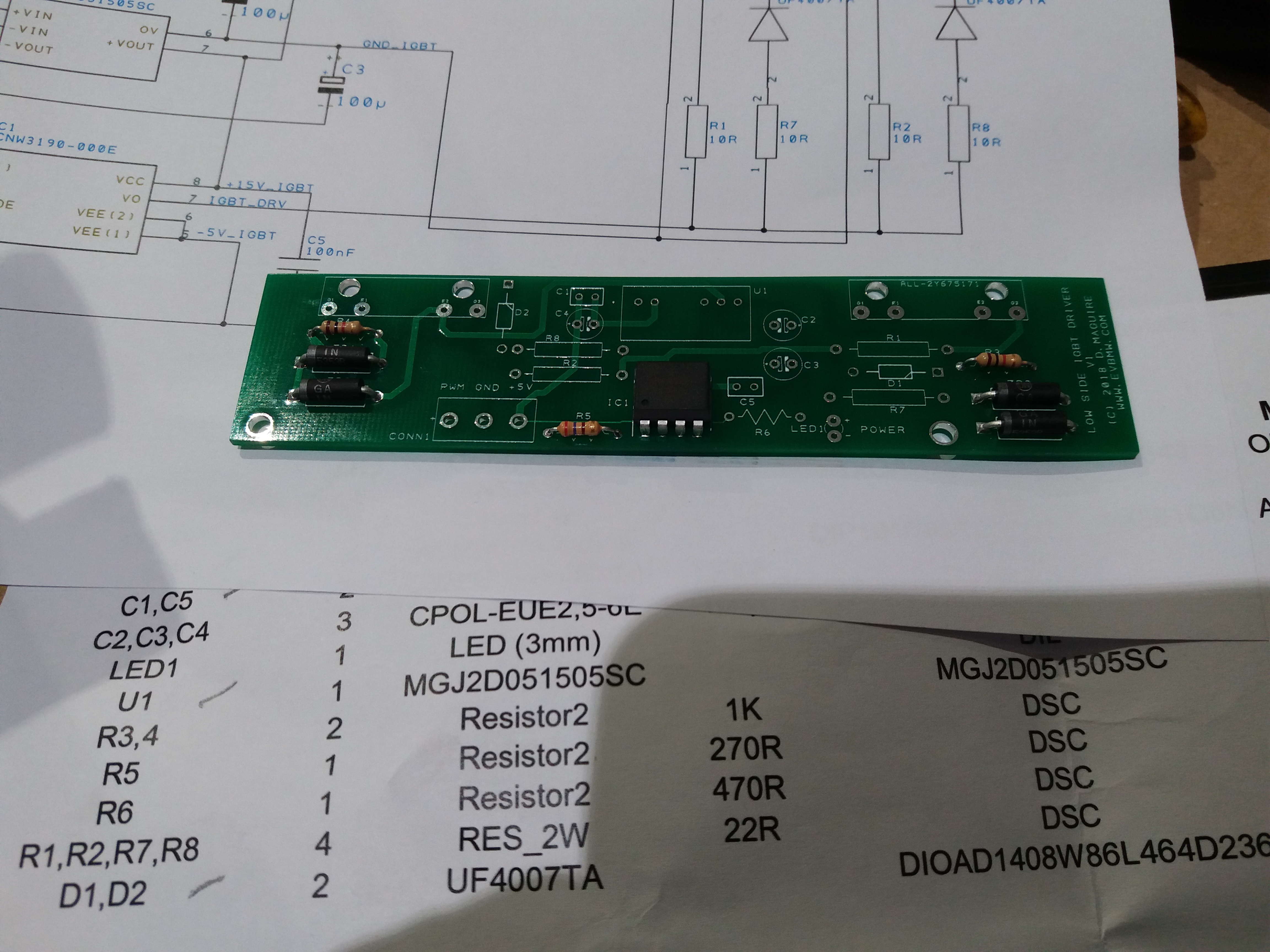

Hi
Need help
I am making igbt bord now , components list R1 R2 R7 R8 resistance 22 oms 2w but on schematic pdf its 10 oms
What is the exact value resistance ?
Thanks you
Regards
Sri

Re: Damians github controller
Depends what igbts you are using and how fast or slow you want to switch them:)
Thanks Jack bauer
I am using igbt mbm600gs6c for motor 24vdc
Best regards
Sri
Best regards
