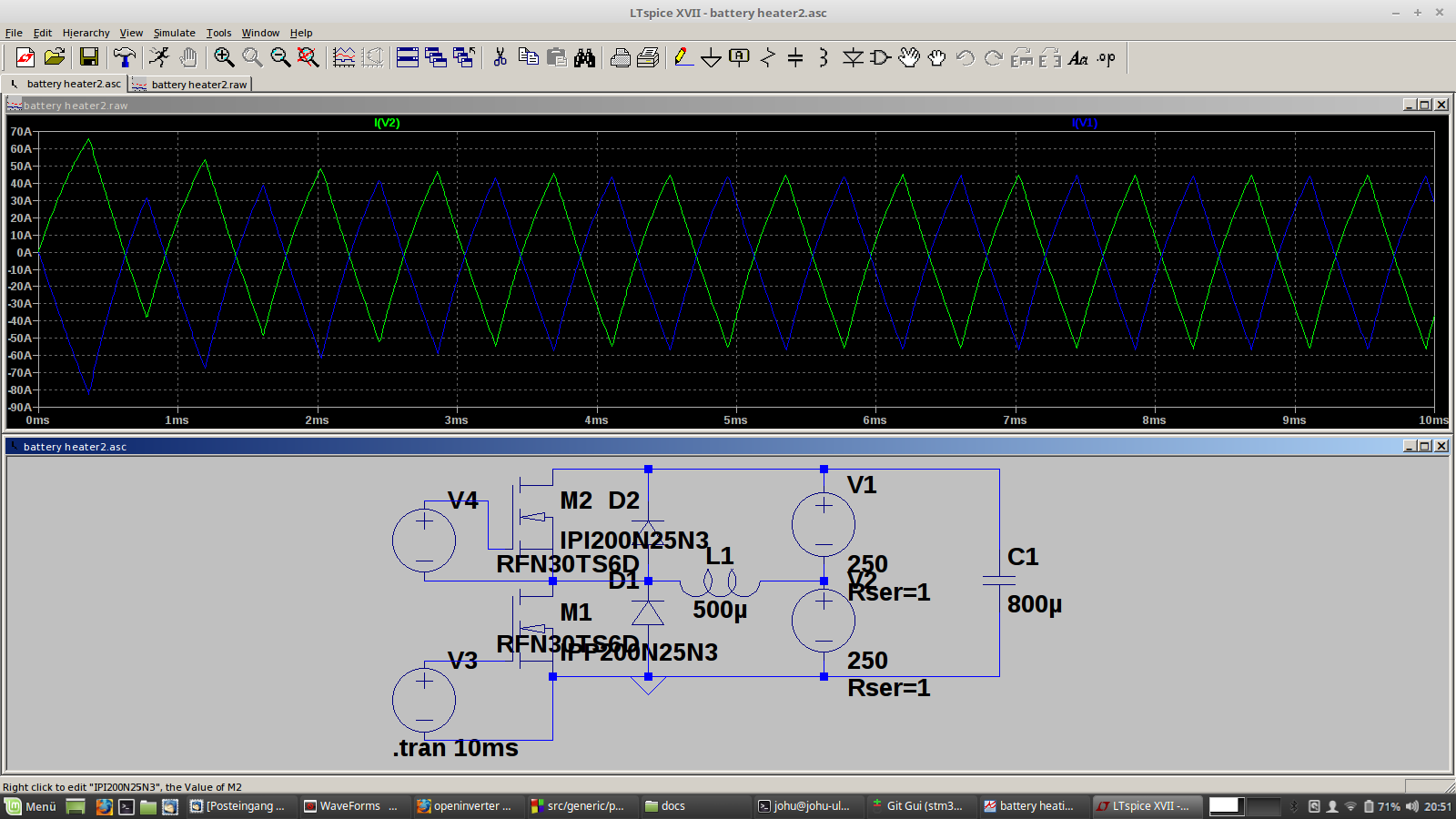

@ PRB617: i think you misunderstood, the point is to use motor windings + inverter transistors to excite current flow through cells while stationary.
That way one could sit in a car turn on seat heater and/or Webasto and wait some time for battery to raise temperature. It is ingenious and if it is successful you can sell the concept to new EV aviation industry. There every gram counts
However i am concerned with some of the details @johu
1. In case of BLDC motor will it not try to move if there will be alternatively polarized force applied to 1/3 of stator winding?
2. Wont the DC link cap interfere with the pulses? I bet the actual pulse will be more like a slope of a hill?
3. Will cells really heat up from its own energy appliead in short jolts? Did you measure the actuall dT/dt on 2S wiring?
I have 4S cell 10Ah LiFe configuration here. Also i have 600uH inductor taken from 5KW UPS and a 4700uF cap. Would you send me a simple wiring for a halfh bridge IGBT and inductor. I could use your R1 main board for a brain board. Cells are so small i bet i could measure dT soon. I would use 6mm2 wires.

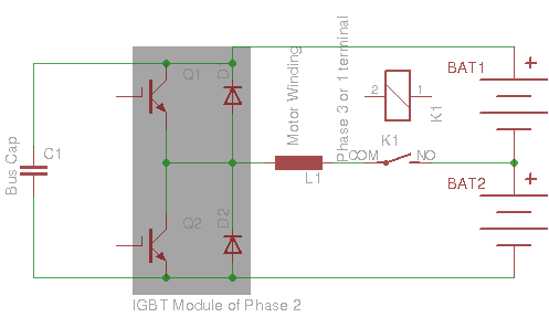

I made a schematic how you would connect the battery. Like in charge mode phase 2 is used for switching.
Software-wise you have to put the inverter in opmode 6. Ampnom controls the the strength of the heating pulses, so to say. Below 20% nothing happens, then it current starts to increase. No regulation yet of any kind.

1. I will have to find out. A sync motor might spin a fraction of a turn but I don't expect it to actually spool up. Induction motor will not move.
2. Yes the bus cap actually sucks away about 50% of the current in my simulation
3. I expect the internal resistance of a cell to actually react like a resistor. It heats up according to P=I²R. So if we generate 20A RMS and assume an internal resistance of 8mOhm (in my Polo the battery sags by 100V at 80A and -5°C - so 100V/80A/152cells=8mOhm) we would generate 3.3W per cell or 500W for the pack.
Would be awesome if you could make a small test setup and report back. For a 4S pack you would need something like 10µH, otherwise the current will be too low. And capacitor should be film similar to what is used in OEM inverters.

- battery heating.png (4.72 KiB) Viewed 5823 times
