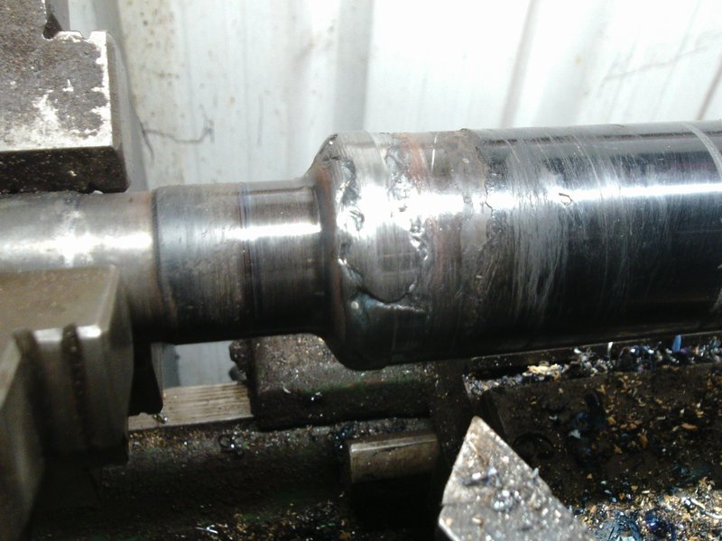

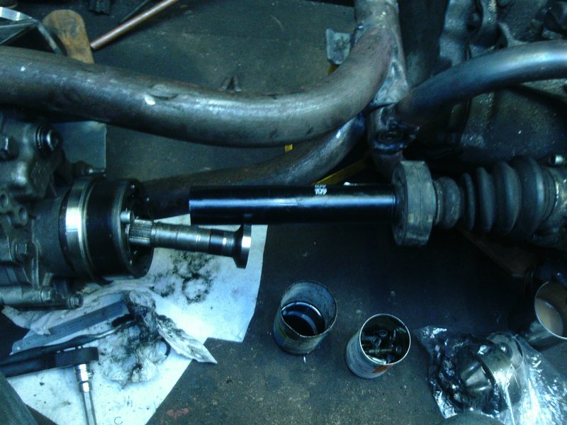

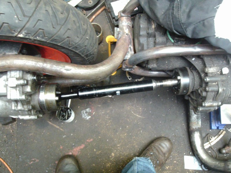

I've joined shafts for the Diesel motorbike project.
When I asked about welding shafts I was met with negativity and much sucking through teeth. So as usual I just got on with it taking as much care as I could.
It's been in use for about 4 years and still going strong with much shock loading from unexpected dumping of the clutch when sorting out other parts of the gear change mechanism.
The welding shop managed to sell me a packet of high tensile rods or similar. I'll try and find what they were later on.
I preheated the rods to make sure they were dry and practised on some scrap to get the current right as advised by the welding shop.
And if anyone was wondering I don't consider my self anywhere near an expert but did do an NVQ level evening class in welding and none of my bike frames have snapped in half yet.
First job was to mock up the lengths so it fitted in the available space.

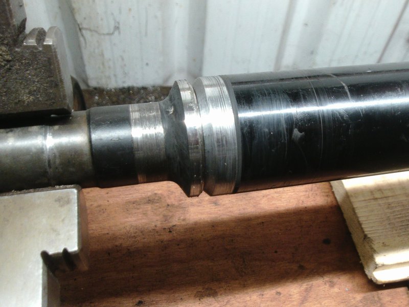

Then trim to length using the lathe. Lucky my Chinese lathe has a wide throat and could take the hollow shaft.
Checked for length again over the full range of suspension movement.
There was an internal shoulder that held the parts concentric. Holding it all tin the lathe ensured I had a fighting chance to get it welded straight.

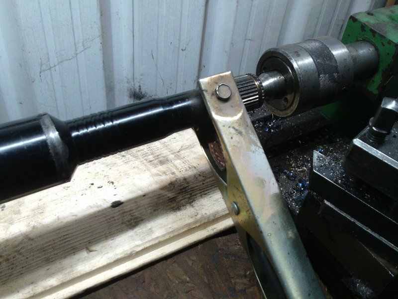

Lathe ways were covered with wood to protect them from splatter.
Earth clamp on the shaft it's self as no one want to weld through their spindle bearings
Finished weld trimmed as it was a bit lumpy

Hm... no internal pin to transfer torque across? At least you made it larger. Though i would recommend you anneal (heating the material until glowing for a time and slowly letting it cool to room temperature) the welds so you dont get stress fractures inside weld.
