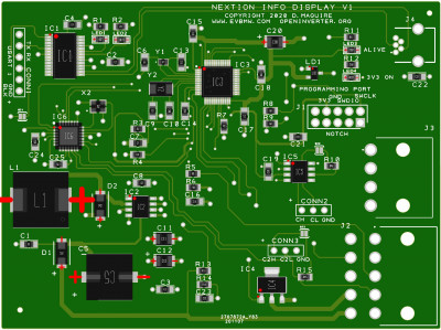

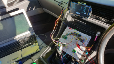

Not really sure what to call this or where to put it so putting it in bms area for now but will apply to a lot of things. I started playing with a 4.3" nextion display and Tom's simp display software. Original plan was just to use it with simpbms in the E31 but of course that would have been too easy. Also wanted to get serious with learning STM32 so started getting a blue pill to send serial data to the display using both the Arduino STM32 core and libopencm3. Figured I could ease myself in with duino. Yeah, that was fun. Also bought a book on STM32 assembler :
https://www.amazon.co.uk/STM32F103-Arm- ... 1970054018
This I could get used to. So been working on this in my "spare time" and finally bit the bullet and designed a board and of course ordered 10 from JLCPCB because Damien designs always work first time
Features :
-12v power
-Fits behind 4.3" nextion display and fits a dash phone holder.
-Molex mini fit jr connections (ripped off from Tom)
-2 CAN channels. One based on the onboard STM32 controller , the other using a SPI MCP25625
-I 12v digital input
-1 low side switch output
-Measures 12v supply via adc
-USB on Serial 1
-Nextion on Serial 2
Uses :
-General purpose interface and display for all VCUs (leaf,gs450h etc) over can. As the Nextion is a touch display it allows for sending data to a vcu as well as receive. e.g. changing power settings.
-Display for Openinverter BMS. This is a major design goal as it will be going in the E65 very soon.
-Display for any CAN based bms e.g. volt and bmw.
-Controller for openinverter boards via can. Going in the E31 for this purpose.
So there it is. Will be opensource on github once I get the bugs out.

Can I use this to get SimpBMS and M3 mod board to have fun buttons and data on the same display??
Or would I be better to adjust from raspberry pi based device with touchscreen display? Both I have. I dont want to adjust and mess the inverter allday and all night, just have like few options configured first and then toggle them on/off or slide to adjust for later..

Hi Damien. Glad you have gone the Nextion route, I can add this to my 7" I use as my dashboard. Keep up the great work. Peter

Well over 20 years ago now I did my first can project with a PIC16C84 and about 3k lines of assembler. I like to get to know the thing from the ground up I guess. Never having been thought any high level languages it can be intimidating with the amount of possibilites these days. Anyway, boards in production at JLC:)

The Thingy is now available on the evbmw webshop as partial board or full kit :
https://www.evbmw.com/index.php/evbmw-w ... on-partial
https://www.evbmw.com/index.php/evbmw-w ... extion-kit
Full sources on Github :
https://github.com/damienmaguire/Nextio ... fo-Display
Features :
STM32F103C8 MCU
2 CAN busses with optional termination
USB port connected to USART1
Dedicated USART2 connection for Nextion
Power Via vehicle 12V or USB
Ability to Monitor 12V supply voltage via ADC
STLINK Programming port (SWD)
One Low side driver output
One 12V digital input
5V output for BMS slaves
Time to kick back and watch those orders roll in and my Lanzarote retirement fund grow

Price is the same in the description for kit and partially built.Jack Bauer wrote: ↑Fri Dec 11, 2020 12:37 pm The Thingy is now available on the evbmw webshop as partial board or full kit :

Does the board attach to the back of the display? What's the depth? I wonder if it'll fit in https://www.thingiverse.com/thing:1527472/files or require a tweaked design to make a nice permanent install.

Hi Damien. Any progress with the board? I am trying to run the board, what .bin file you are using to start with the board.
I am connected to the board by ST link, can upload some .bin files as a bootloader but there is no connection by onboard USB port from arduino.

You need to upload the bootloader hex and firmware hex via st link. Not the bin. You should then have the led flashing.
