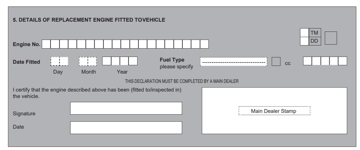

Tax was the next on the list. This so far I have yet to succeed in getting as point 3 is a little vague. I have the engineers report but I am unsure as to what this 'form' is. There is the RF111 Change of Particulars form available from the motor tax website or office but, this has no reference to change of drive train, only change of colour or body type. I called the motor tax office and was met with, we have never heard of anyone ever in the history of the free state ever doing this... we cannot help you... why are you trying to do the state out of motor tax revenue... In fairness, they were very helpful, as much as they could and were willing to find a solution. So, for this step, we just need clarification on what this form is to send back to the Revenue with the engineer's report.

The form you want is RF111 :
https://www.motortax.ie/OMT/pdf/RF111_en.pdf
Section 5 Change of Engine.
You'll need your engineer to complete and stamp this section.

Ok. Thanks. What section of Revenue do you send it to then if not the motor tax office so to avoid this main dealer nonsense.

Ok, good day today. After the local motor tax office in Wicklow holding onto the paperwork for almost a month, I got the call today from them to say they finally got around to paying a bit of attention to my file and they gave it the thumbs up. Rubber stamped. The Audi 8e is now an EV :D
The last piece of detail they needed was just the serial number from the Leaf motor and that was it.
So, here are the steps to a successful end to end process to get your conversion legal and on the road in Ireland.
  • Get in touch with a local accredited Automotive Engineer and have them look at your build when you are at a point before you are ready to go cut and weld parts to the chassis. This will enable him/her to discuss and review the placement of key components, integrity of structural components (motor mounts, battery boxes, etc), and weight distribution. Ideally, try and get the use of corner scales before and after the build.
  • The engineer will primarily be interested in answering the question of whether the vehicle is safe to put on the road. If the Engineer is unhappy with any aspects of the build, they will request modifications and another inspection will be required to verify action has been taken.
  • If the advice is followed however and the Engineer is happy on the second visit at completion, they will complete a final engineers report signing off the build. Request they complete Section 5 of the RF111 Change of Particulars form complete with date of motor change, motor serial number and finally, signed and stamped by the accredited engineer - pic below
  • Worth asking for an RSA Modifications Report also for when the time comes for the NCT
  • Written report by Automotive Engineer is received in ~7 days.
  • Documents to send to your local motor tax office
    • Automotive Engineers report - signed and stamped
    • Completed RF111 Change of Particulars form - Section 5 - signed and stamped
    • Vehicle Registration Certificate (VRC)
    • Cover letter outlining you and your project, the how, why, where, etc.
  • Change of taxation class to electric is delivered, usually in around 7 days.
  • Tax vehicle (currently €120)
  • Insure Vehicle - This was actually possible once you had the completed engineer's report
  • Test vehicle (NCT) - Bring all documentation submitted to local motor tax office as well as the RSA Modifications Report
  • Drive off into the electrified sunset...
A couple of notes on this process for me. Submitting to Wicklow for me took a month and you may find this in some counties where this has never come across their desks or they are leaning on stricter new rules in the last 5 years. There is a chance they will look for a main dealer stamp. This is obviously an impossibility as no main dealer is going to sign off on a non own OEM part being installed. Reach out to a main dealer of the main vehicle and simply ask them to, in writing, confirm that they will not certify non OEM parts fitted to their vehicles and that is what an independent accredited automotive engineer is for. I found the main Audi dealers to be very helpful and supplied me with a letter outlining the facts. It's all just to make it as easy as possible for the officials who see will likely never see something like this appear in the inbox and to remove any suspicion it's some sort of tax dodge :lol:
I hope this helps and if there are any changes you find yourself in the process, please add them in here, as I will as I get to the final hurdle of the NCT.
Can this be put in the Wiki now by a moderator who moderates? Thanks!
