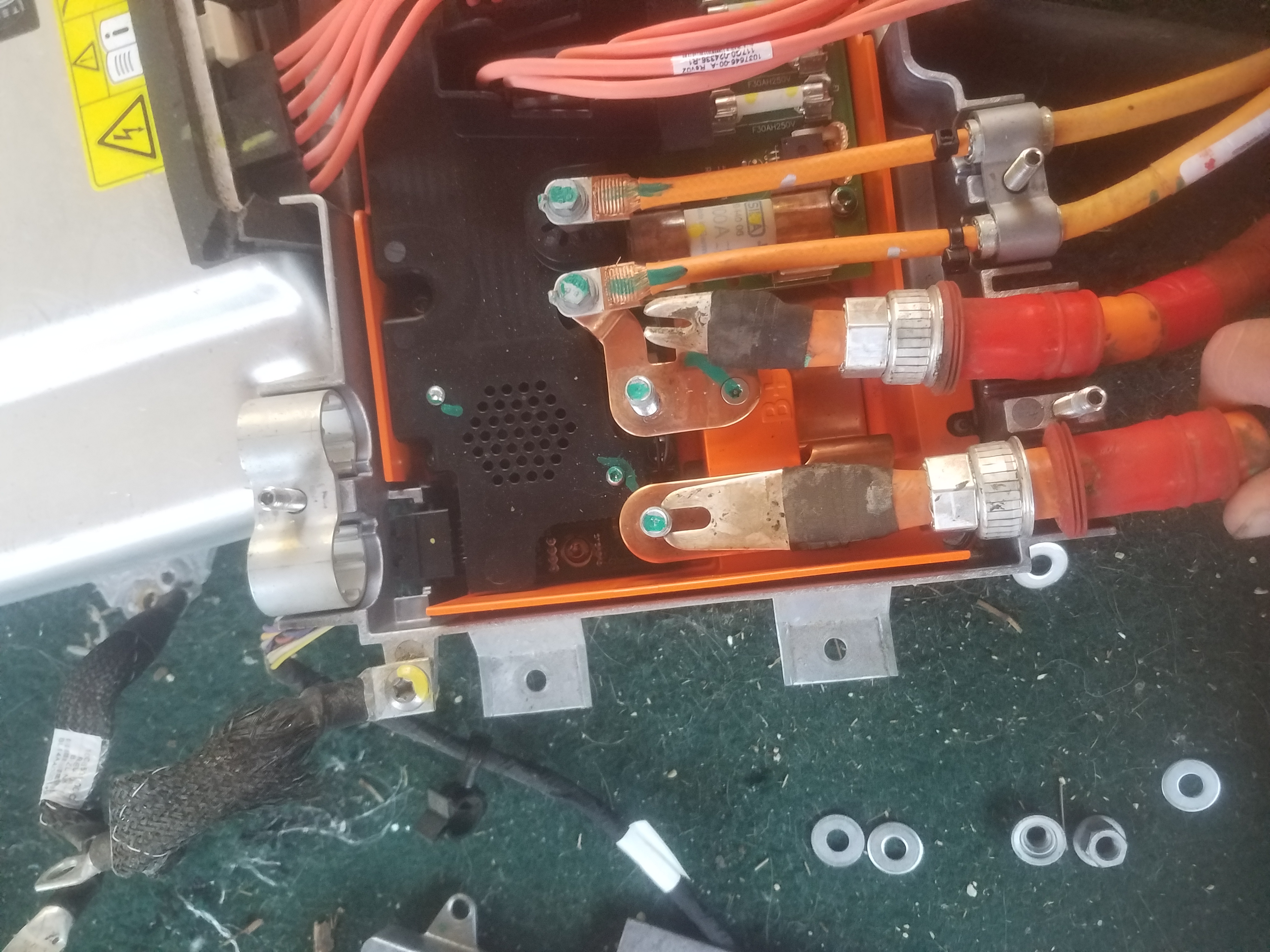

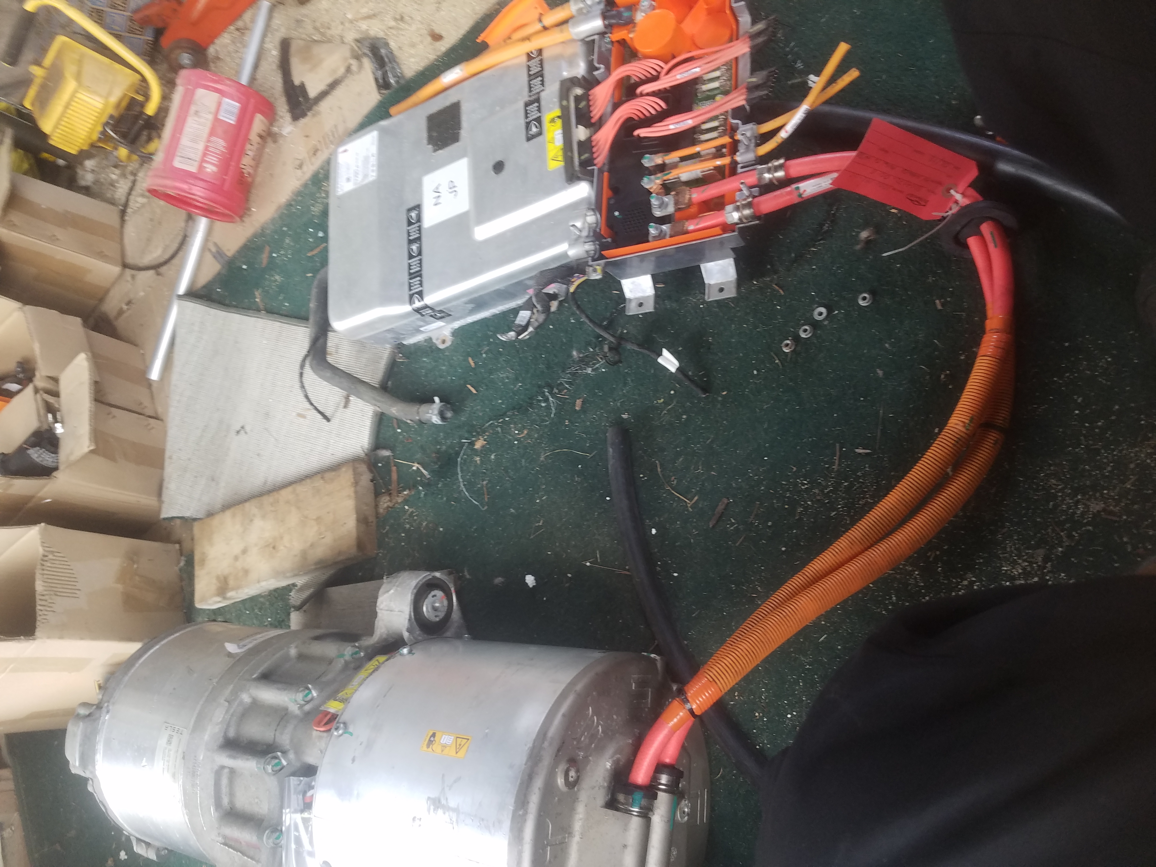

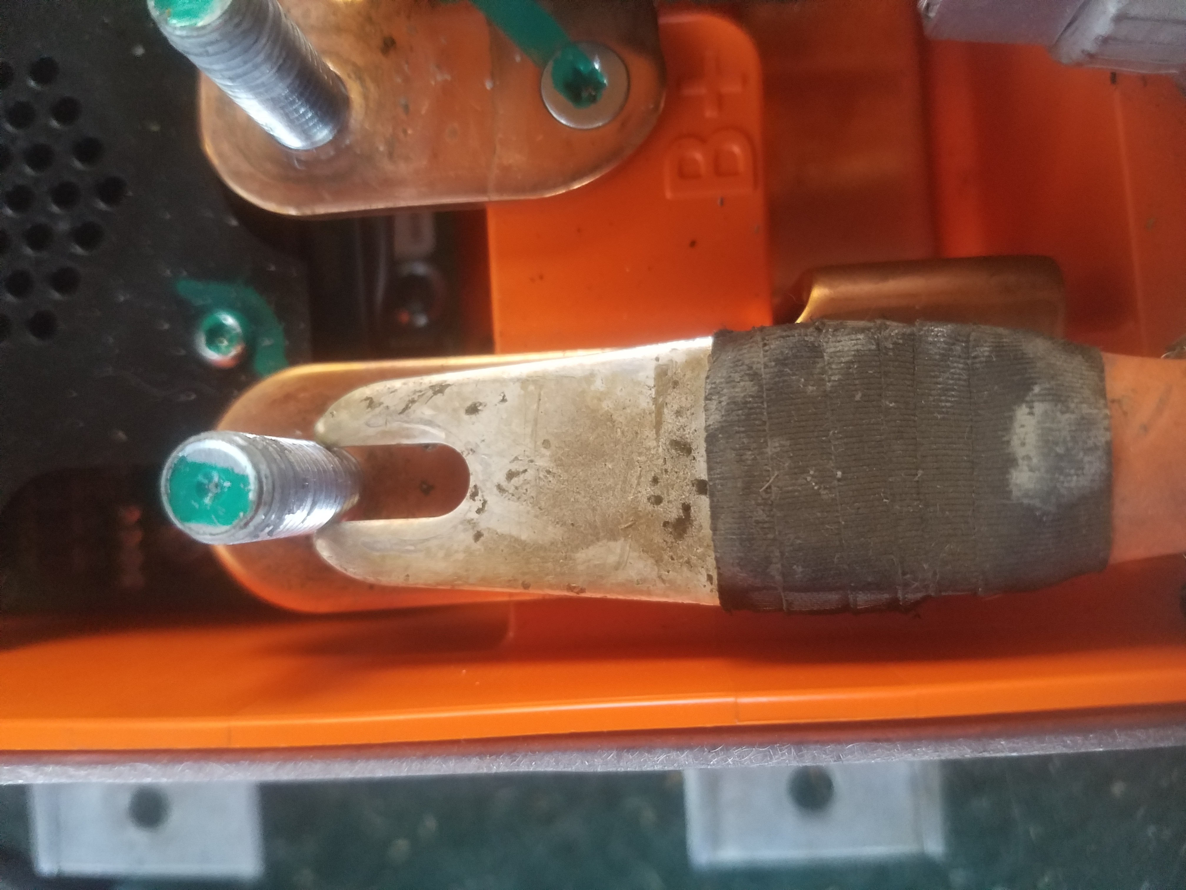

So I am trying to connect my Gen 2 High Voltage Junction Box to my 2016 Model S Gen 2 Front High voltage Junction Box.

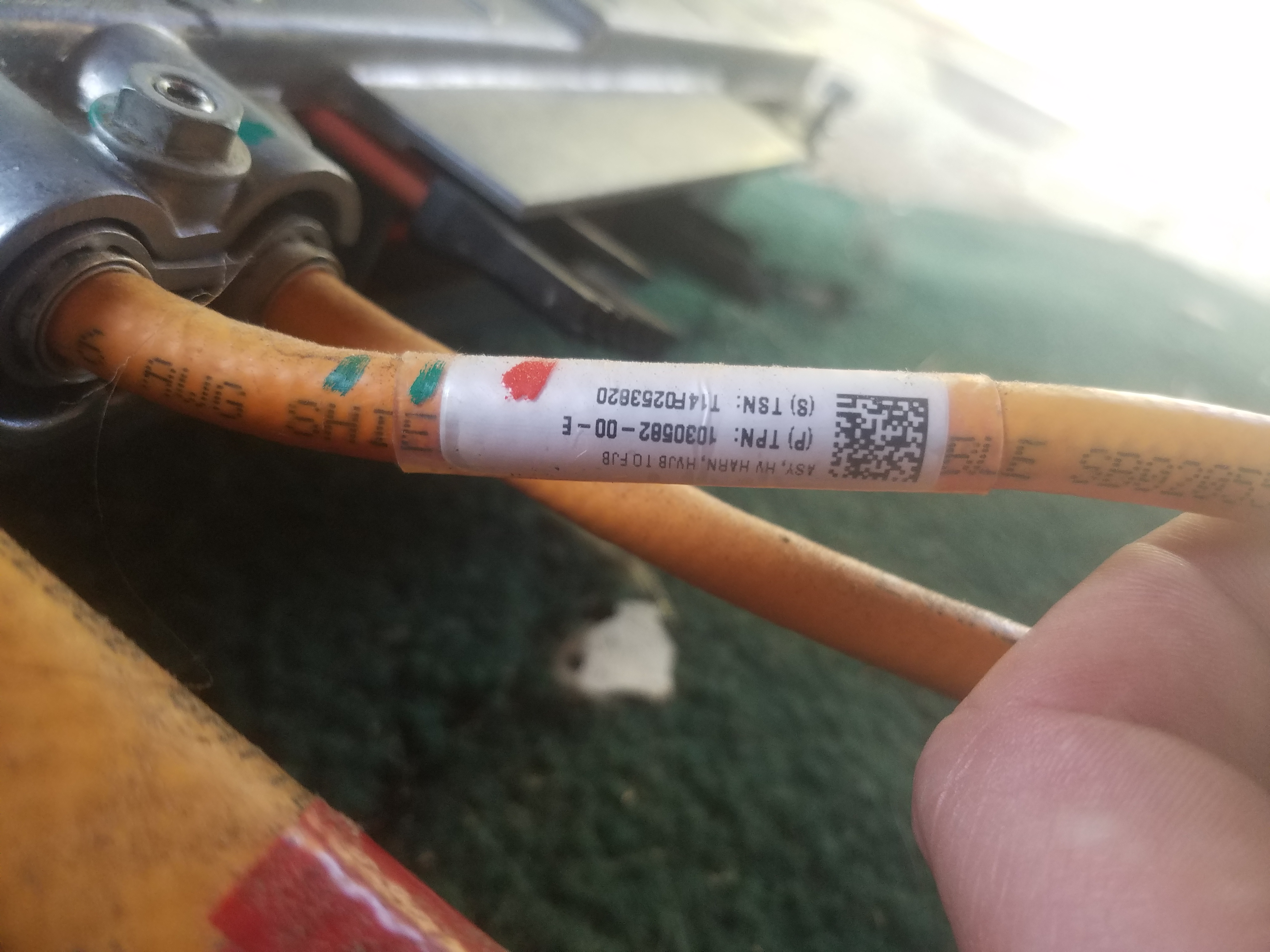

This is what I have left over from the guy who cut out my hvjb. At least I have a part number and the tesla description from the factory.<br /><br />This is the same cable that was in the hvjb from the factory I found on ebay.<br />https://www.ebay.com/itm/14-16-TESLA-MODEL-S-HIGH-VOLTAGE-HARNESS-HVJB-TO-FJB-GEN-2-1030582-10-G/143164331964?epid=21030187894&amp;hash=item21554257bc:g:xu0AAOSw3Ohcguih
https://www.ebay.com/itm/14-16-TESLA-MODEL-S-HIGH-VOLTAGE-HARNESS-HVJB-TO-FJB-GEN-2-1030582-10-G/143164331964?epid=21030187894&hash=item21554257bc:g:xu0AAOSw3Ohcguih
The second set up on the right side are the cables I need.

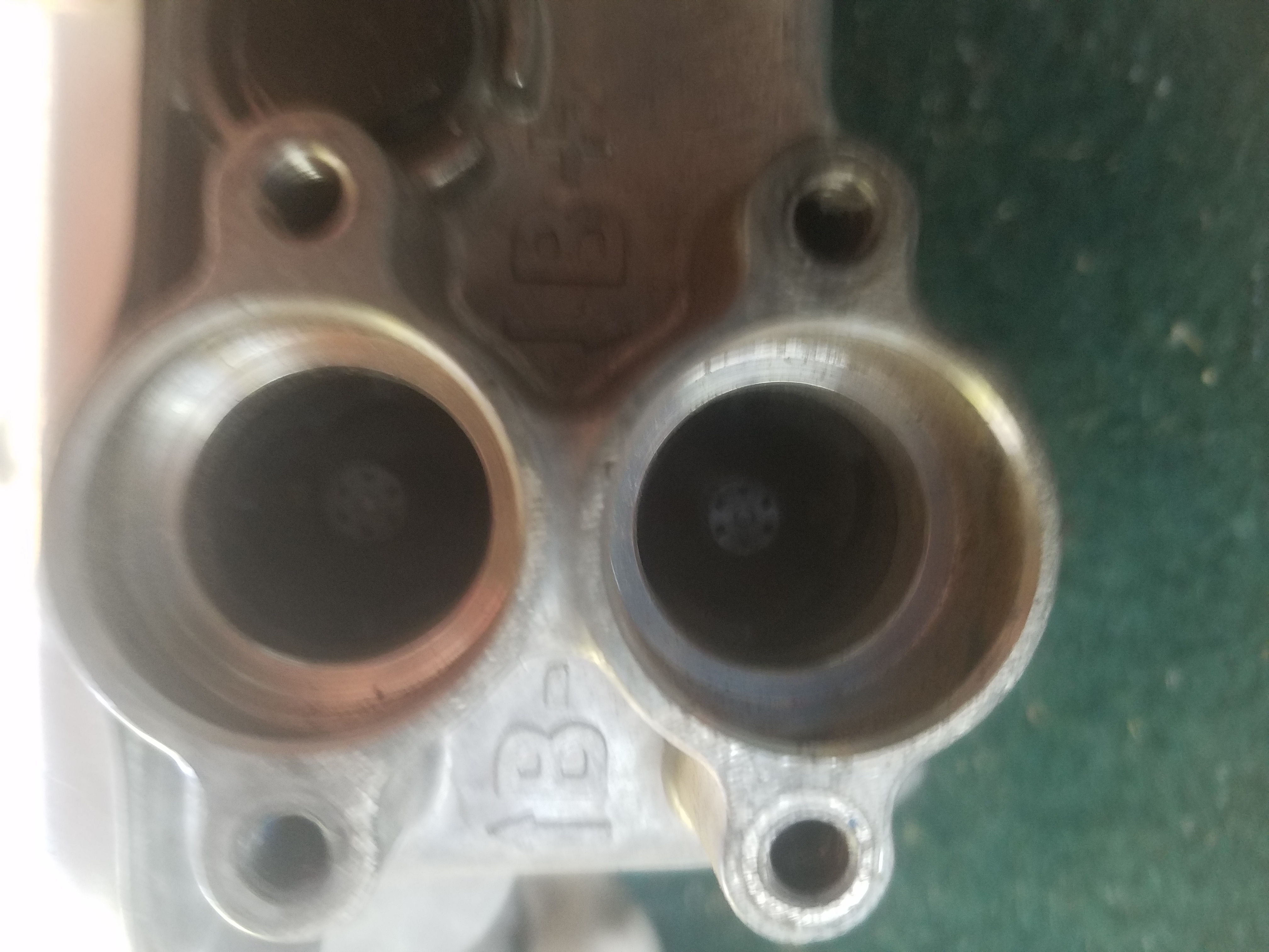

Special connector for this HVFJB. Do I need a rapid splitter set up?<br /><br />Here is the one I was gonna try.<br />https://www.ebay.com/itm/Rapid-Splitter-Cable-Wire-Module-Unit-Assembly-1054500-10-C-Tesla-Model-X-2016/303155901052?hash=item46957ff27c:g:bJ4AAOSwRg1c3GyD

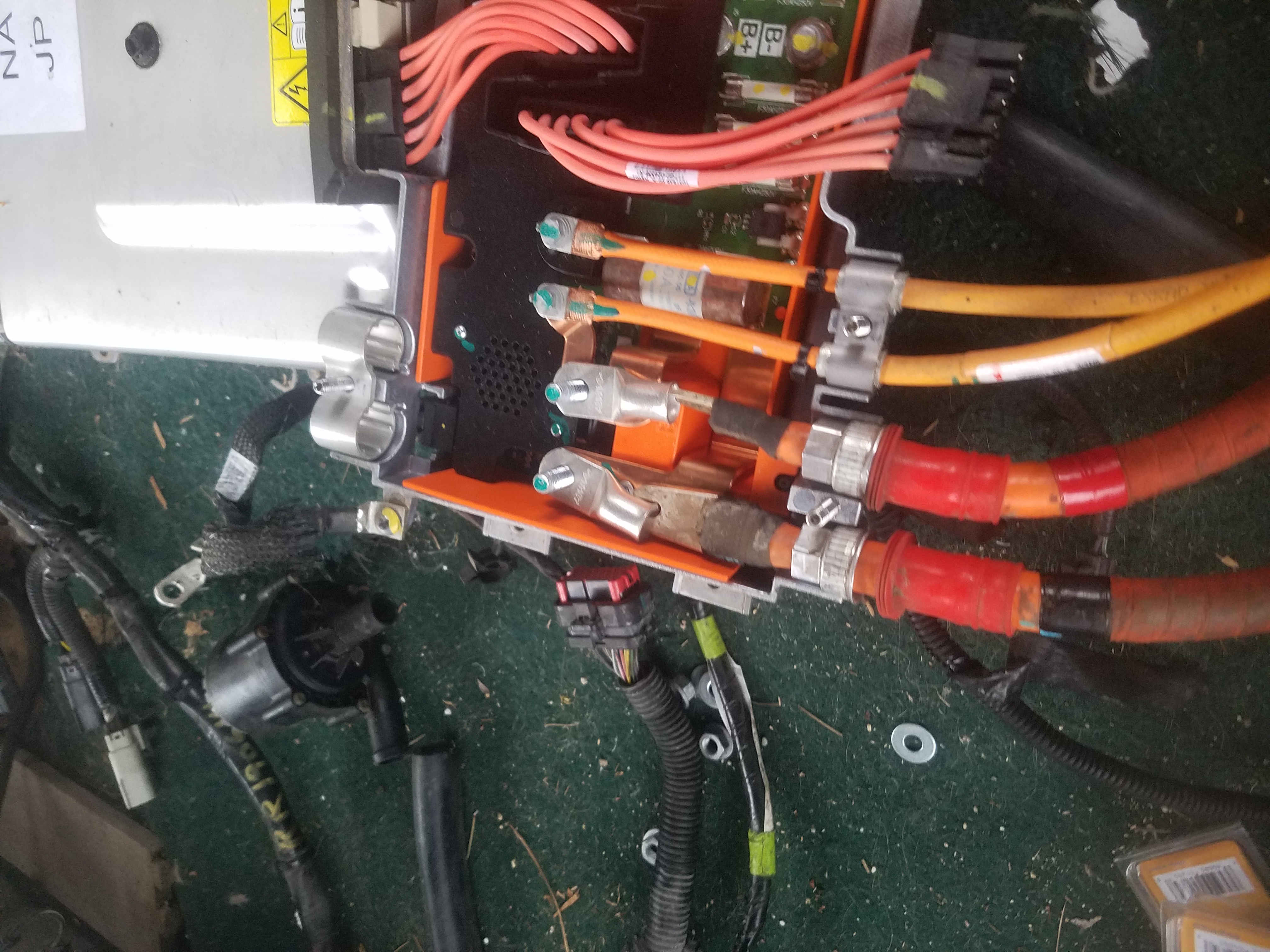

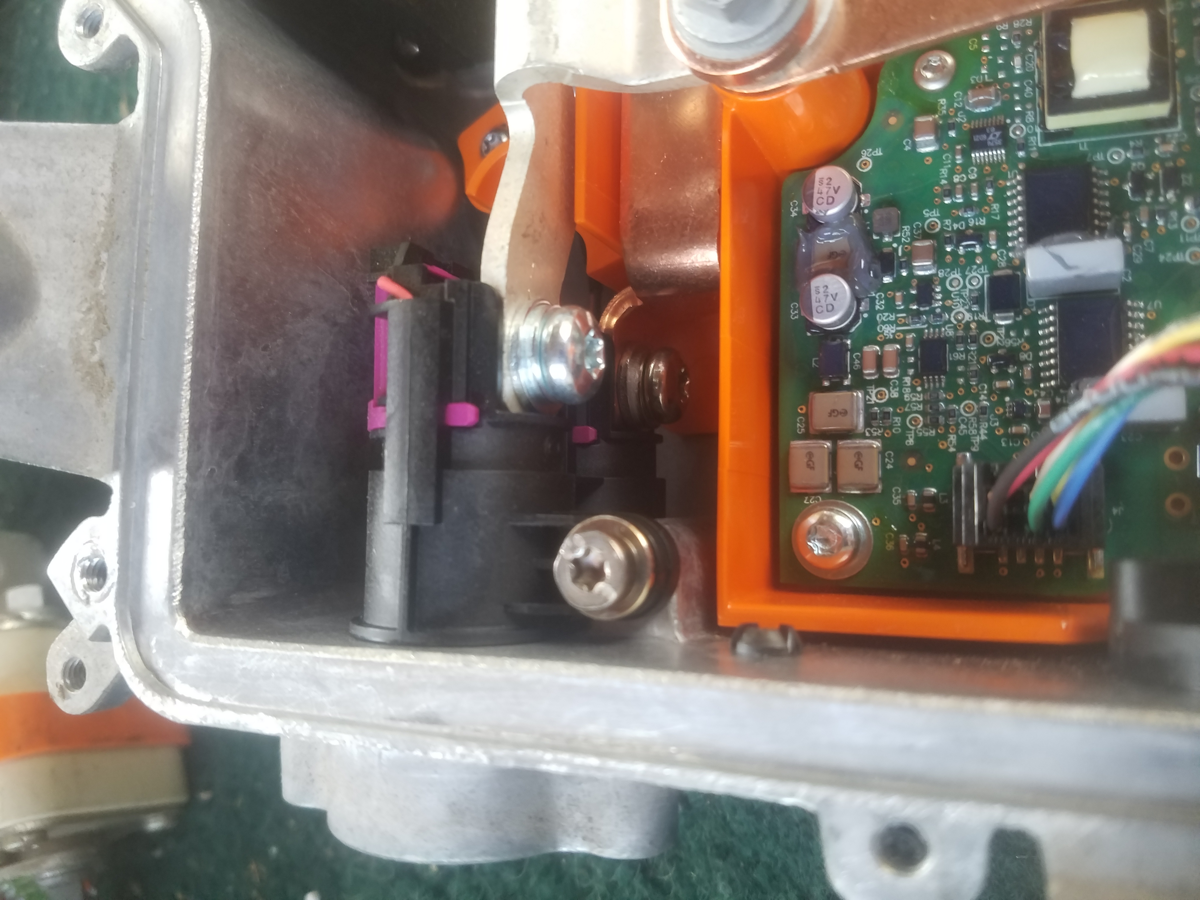

Or can I just ditch the rapid splitter idea and the twisty connector thing and just use the regular cables that go to the older style front junction box. Looks like after I remove the connector from the hvfjb I can probably just bolt the older style right to the two copper busbars.
This is inside the hvfjb. Looks like they easily unbolt from the busbars.

anyone know if the splitter will work with my gen 2 hvfjb and hvjb if it is from a model x?

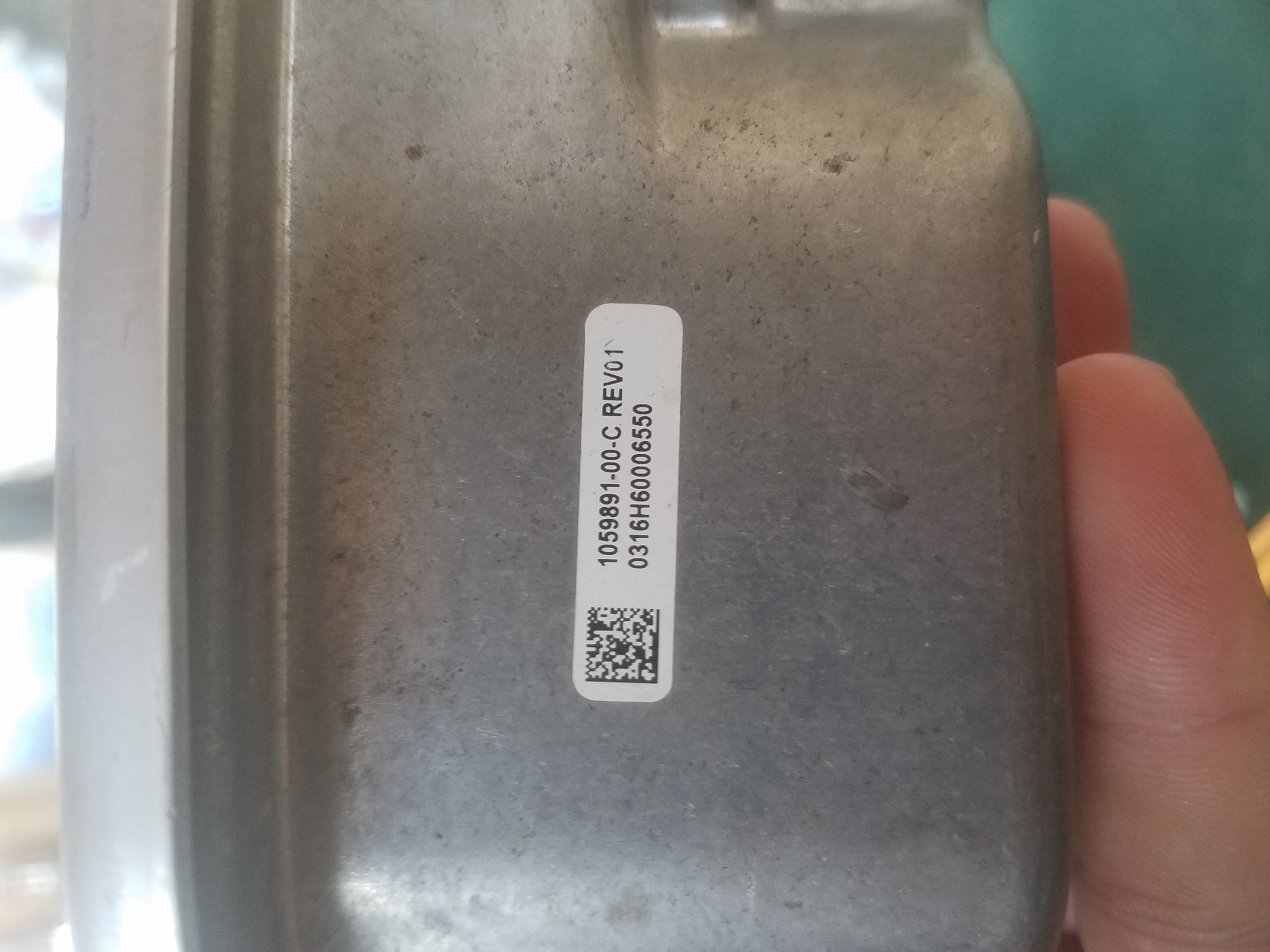

aaaa I typed in my part number for my hvfjb and the russian website (https://elektromobili.ru/parts/tesla/mo ... converter/) says that my hvfjb is from a model x. I just bought the splitter from the model x and am gonna give it a try. If I have a few extra parts I don't need I can just put em on ebay I guess...

Kinda want to run another large drive unit up front someday but I probably will need 2/O cables.

Ended up just getting a model s rappid splitter.

Hmm doesnt exactly fit. Wonder if I can make it?

Those boltable "ear" connections look allot on the rear small drive unit DC cables.
