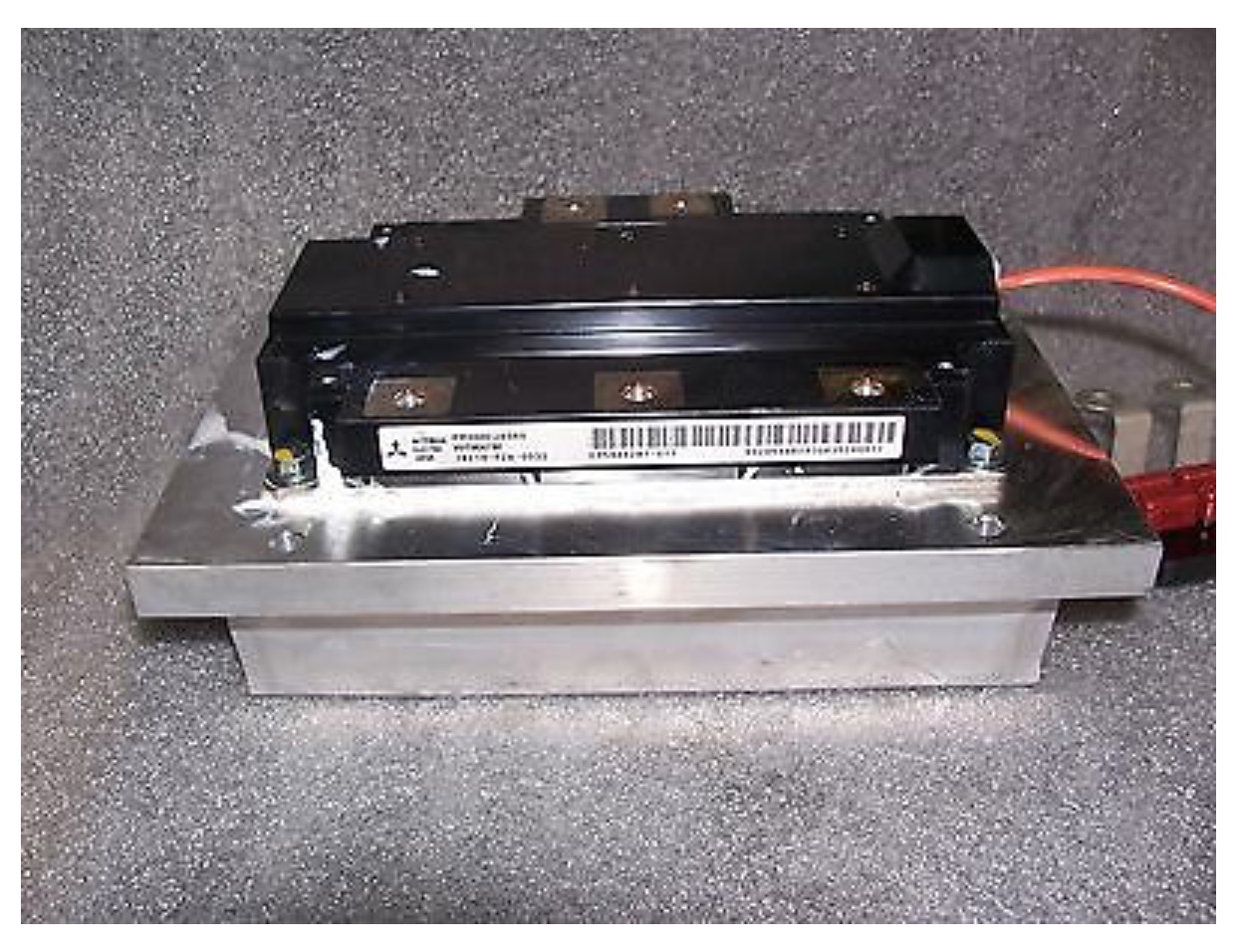

No need for a complete power stage, if I’m going to go that route I have an IPM from a Civic hybrid that I can use, I’d just need a 3-phase controller for it.

Even better. I remember Tomdb made some effort to spin Remy motor with lebowski brain. I think his design is still on his github.
Yes I think this is viable. You will need to test current sensors though. If they are too coarse you will need finer resolution.

Sensors shouldn’t be a problem, as long as I can start and stop the compressor on command it’s going to work. Originally I wanted speed control as well, but I don’t think I need that feature anyway. Removing heat from those tanks means the system will likely be running at full capacity for at least a few hours, so speed control isn’t a design priority so much as getting it pumping in the first place. I suppose I can always revisit it later if I need to.
Can you suggest a suitable controller for the Mitsubishi IPM?

Hm, Lebowski controller has limited acceleration and RPM. You set it inside interface.miniman82 wrote: ↑Fri Sep 25, 2020 11:39 pm Sensors shouldn’t be a problem, as long as I can start and stop the compressor on command it’s going to work. Originally I wanted speed control as well, but I don’t think I need that feature anyway. Removing heat from those tanks means the system will likely be running at full capacity for at least a few hours, so speed control isn’t a design priority so much as getting it pumping in the first place. I suppose I can always revisit it later if I need to.
I definitely recommend Lebowski inverter for sensorless motor run.
PM me or post here which inverter you have. I have here outlander rear inverter.

I don’t have it in front of me, but if memory serves it’s the Mitsu PM300CJA060. Looks like the attached pic. I found a PDF from Mitsu outlining their IPM line, and while this one isn’t specifically called out if you go by the part numbers it should be a 600v/300A unit.
https://www.mitsubishielectric.com/semi ... mos6_0.pdf
I’ve done some playing around with both the Prius inverters and the Mitsu one, I believe that I discovered the Mitsu inputs work opposite the Prius one. For example if the Prius inverter expects a phase input pulled low, the Mitsu one wants logic high to enable. Hopefully that’s not an issue in hardware.

Oh, it is not a complete inverter, but a IPM module.miniman82 wrote: ↑Sat Sep 26, 2020 2:41 pm I don’t have it in front of me, but if memory serves it’s the Mitsu PM300CJA060. Looks like the attached pic. I found a PDF from Mitsu outlining their IPM line, and while this one isn’t specifically called out if you go by the part numbers it should be a 600v/300A unit.
No dspic30 has cmos outputs. It can drive anything 5V level. Maybe 300A is a bit overkill. But is a nice unit to learn IGBT basics.
Do you have datasheet or application instruction. You will need the connector pinout.

Read through the link I posted, it has a lot of application notes in it.
Oh it’s total overkill for an 1800w A/C compressor, but I already have it so I may as well use it. I don’t recall if logic signals are enough to drive it, I just remember being able to probe the various pins on the connector and getting the phase outputs to change state. I think I wrote down whether it was positive or ground application that caused state changes, I’ll have to look through my binder of notes.
