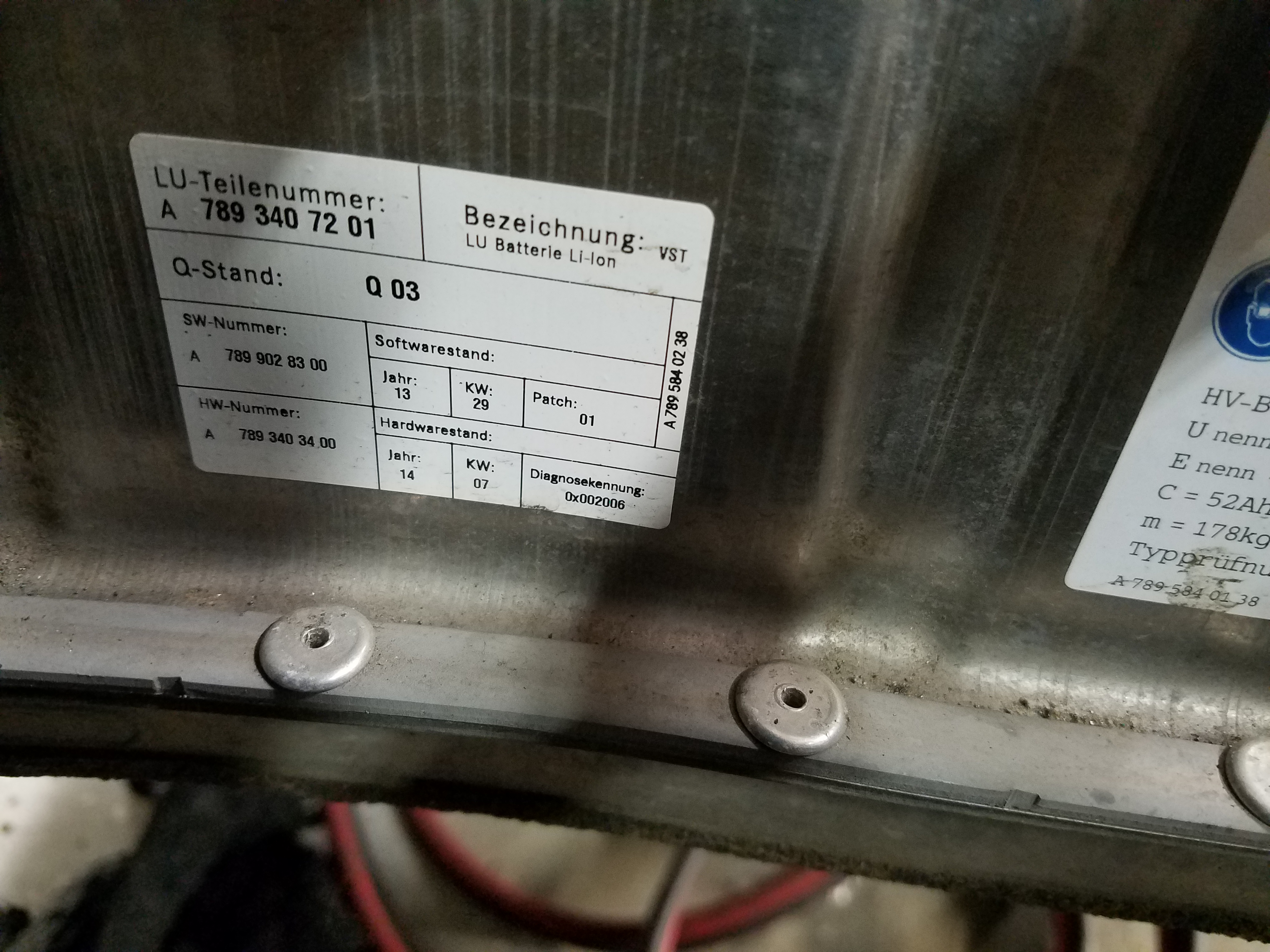

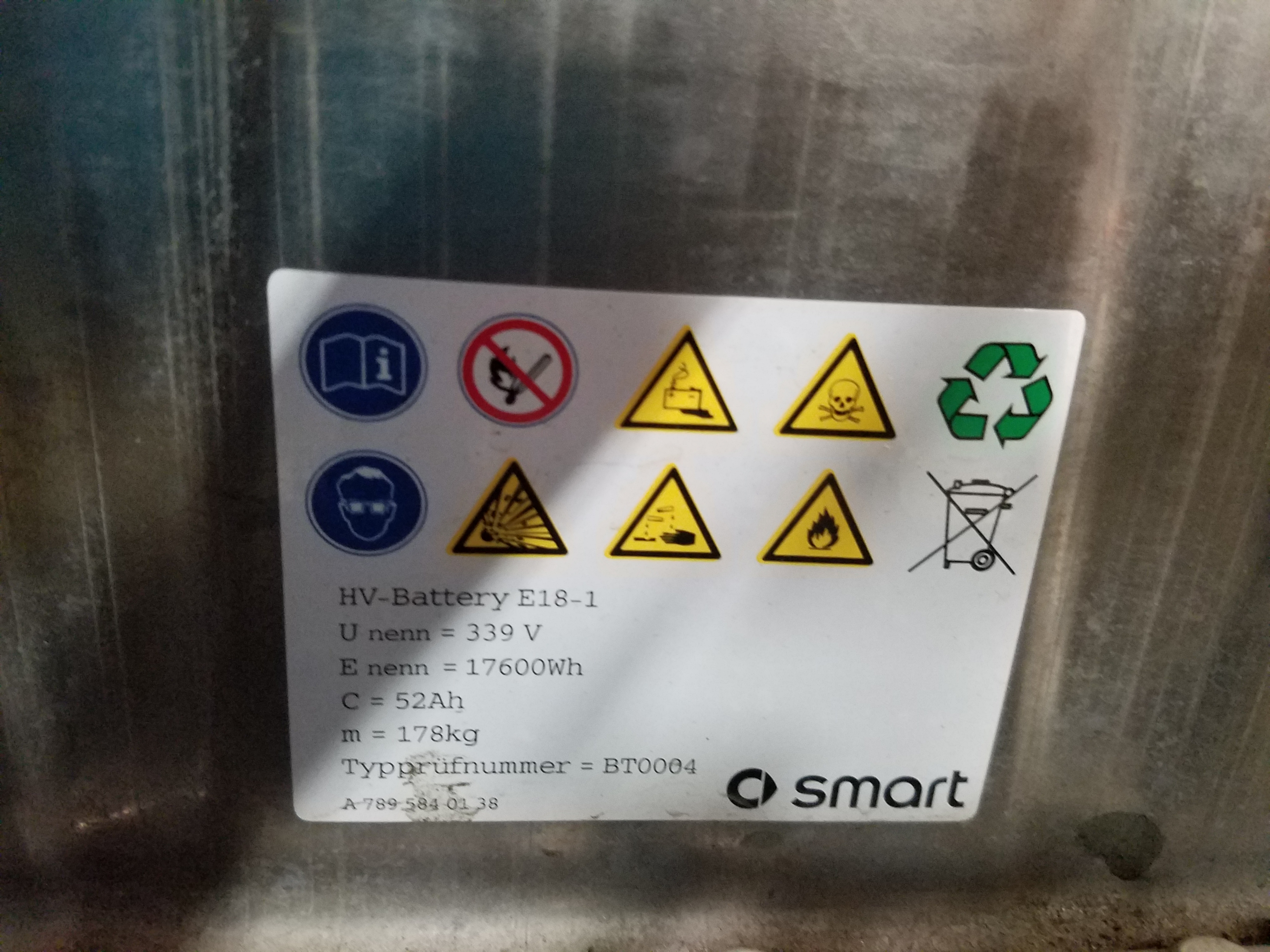

Ok , I have come to realize using a Smart car drive system was the worst idea .
Now I am wondering if there is a way to use the 17kw Smart battery with a TESLA drive motor and some other charger . Has anybody here played around with the Smart B.M ? Please and thank you in advance .

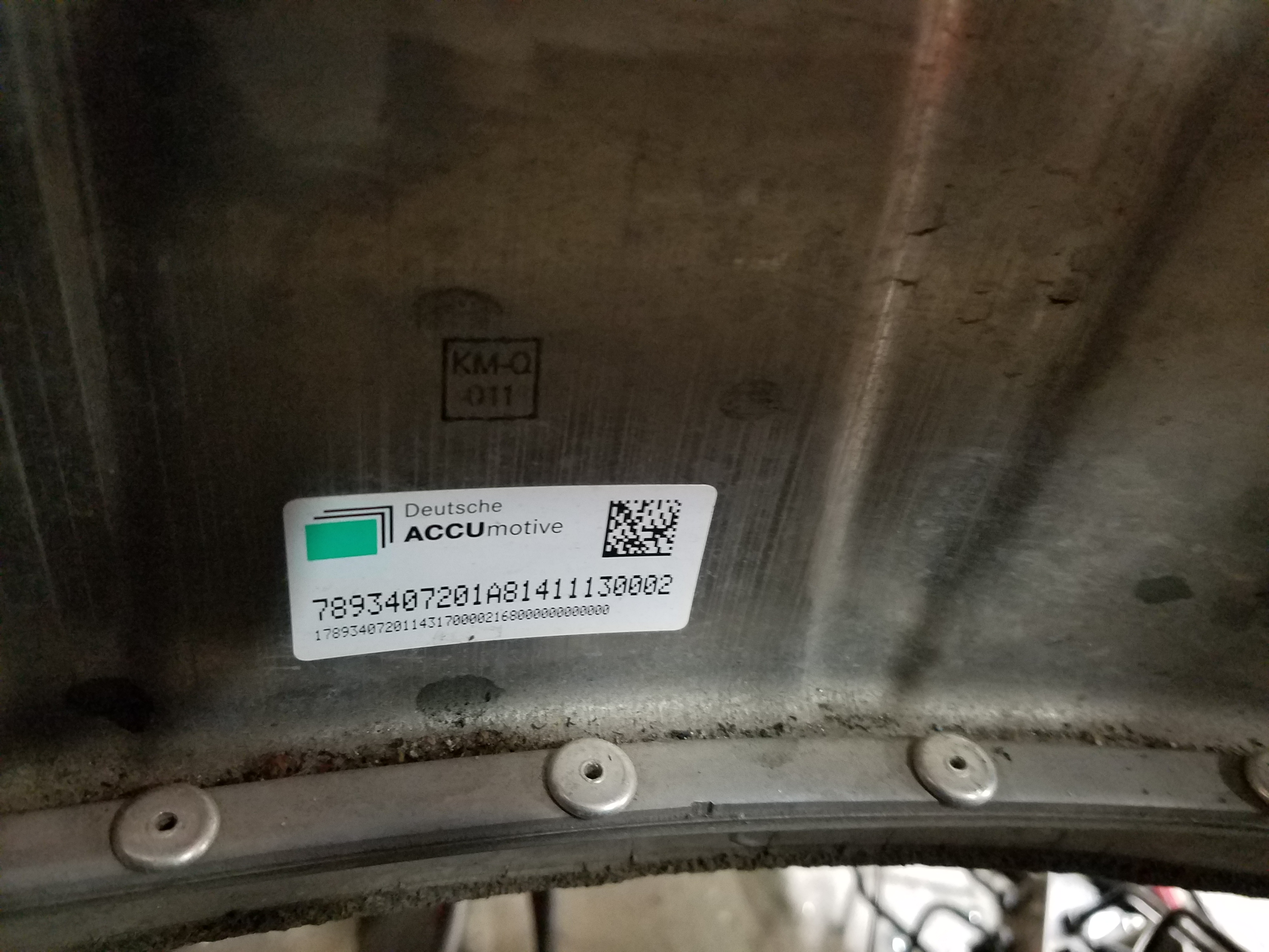

In the 2015 Smart they used a Accumotive battery and after doing a Google search I found out they are just a division of Mercedes Benz
Has anybody here played around with the batteries or the BM instill the battery case ?? I am trying to activate the battery without opening up the case but it looks like I might just have to drop it and drill out the crap load of rivets

The bms in these situations typically uses CAN and hardware lines to enable. I'd say your only option is to open it up. Sorry.

Smart battery is assembled like a swiss watch with no user friendly bolts, nuts and connecting straps. Instead the cells interconnect with crimped/riveted/whatever making it difficult to swap out dead cells. This is not an avenue to pursue imho.
Better to create a logic board for the Smart inverter (wish upon a star) or else squeeze the prius gen3 inverter into the car and run it with the open logic board (which is what I'm attempting).
